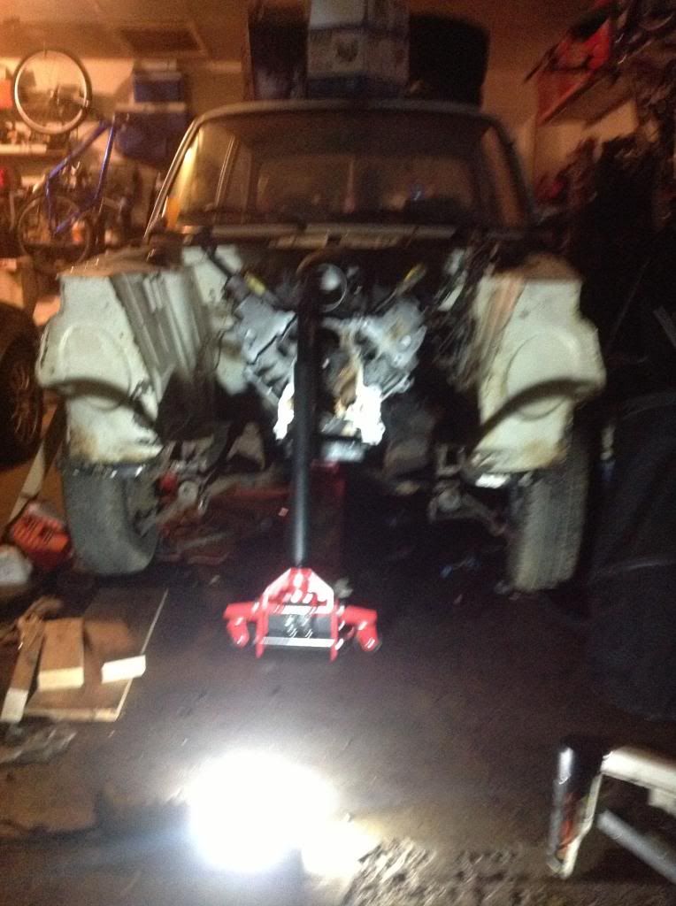

    its a tight fight but works i still have shave a couple of areas and lower the engine 2 more inches give or take.
    ls1 inside, just started making mounts :) and will use the stock steering box.

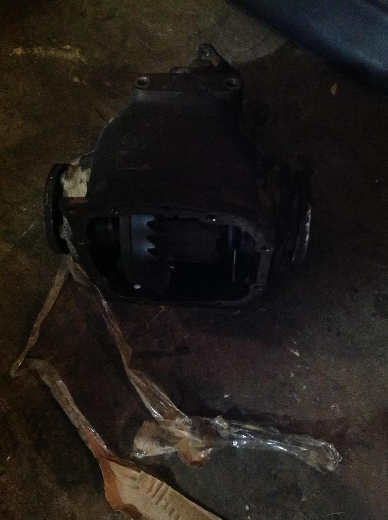

    i also picked up a complete e30 rear end and yoshi is going to help me build the diff plann is 4 clutch packs with 60 or more lock, duno

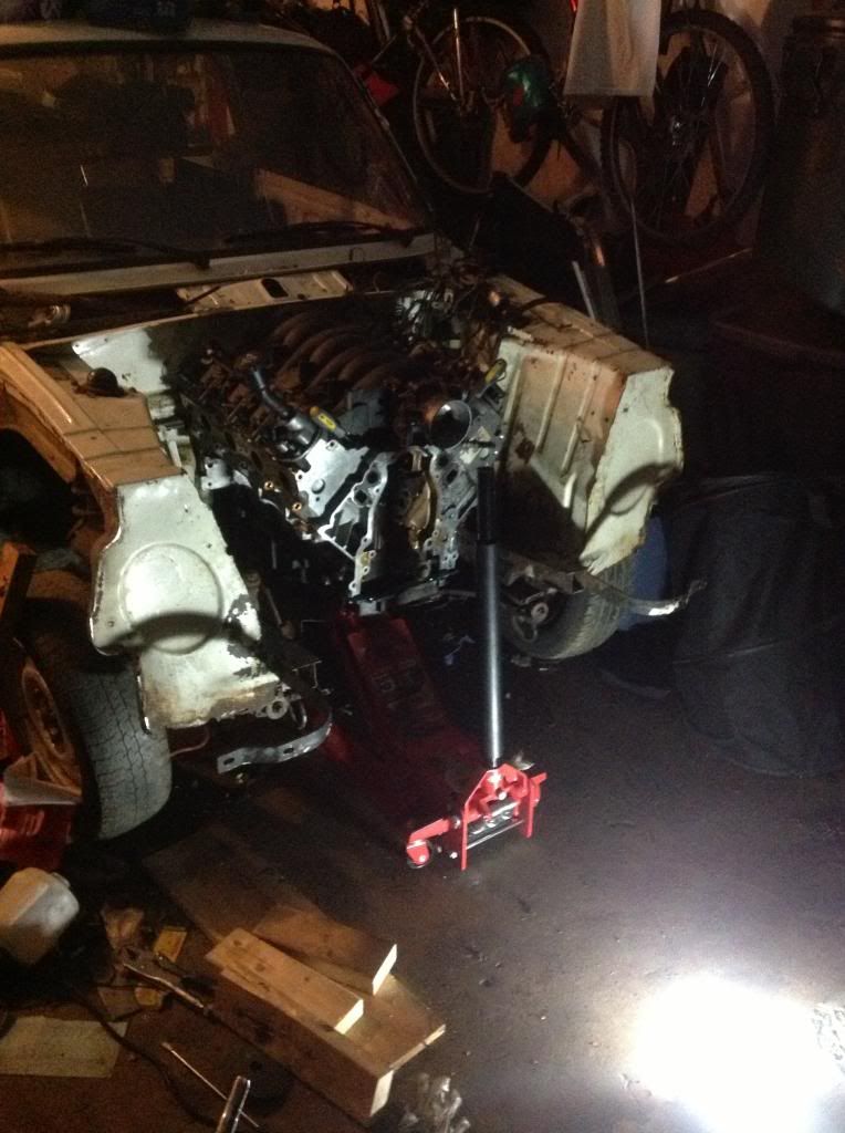

      updates updates....... been a while and things changed
      was going to a ls1 route but the machine shop offered me money for the longblock for their drag car so i couldnt refuse and sold the ls1
      ripped this bitch out cuz its blows like da sum ass

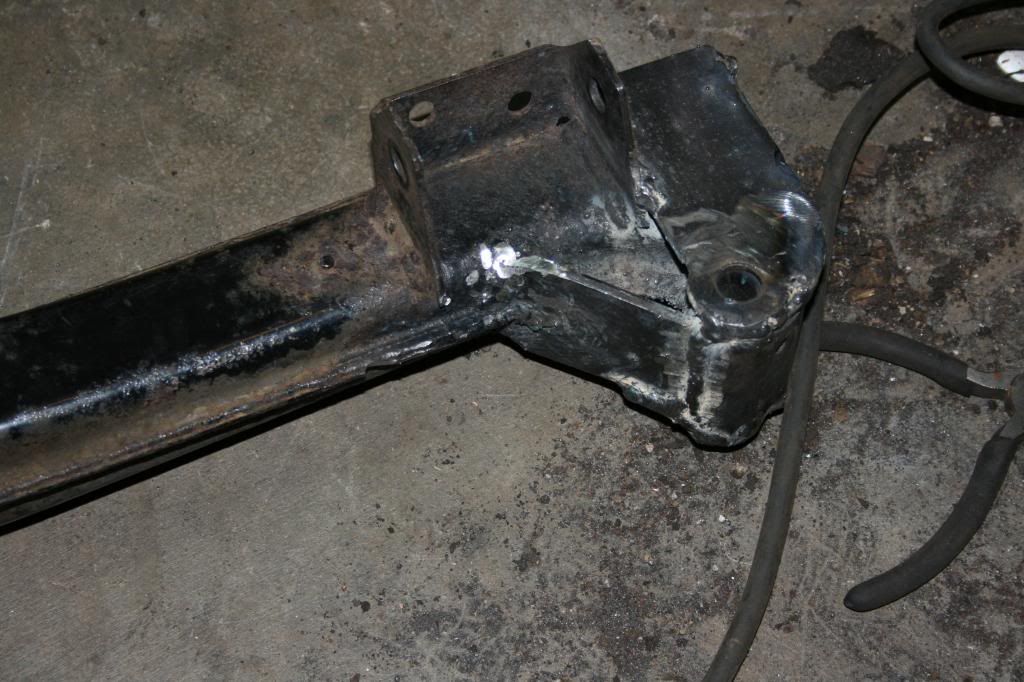

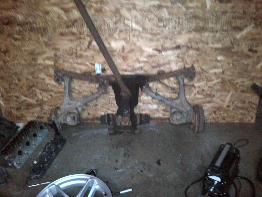

      modify the e30 rear subframe to fit the 02 stock mounting points.... was a bitch but got it centered

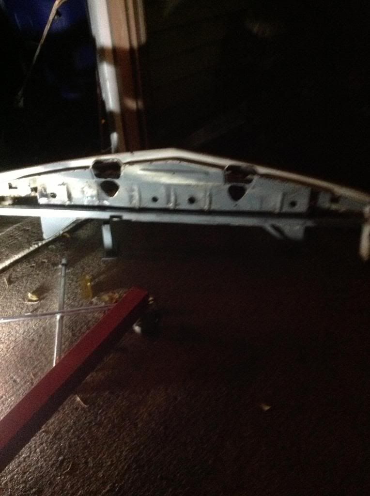

      started making mounts to hold the front bumper
      okay now fast forward more.....
      subframe mounted so far... see goes into stock mounting points

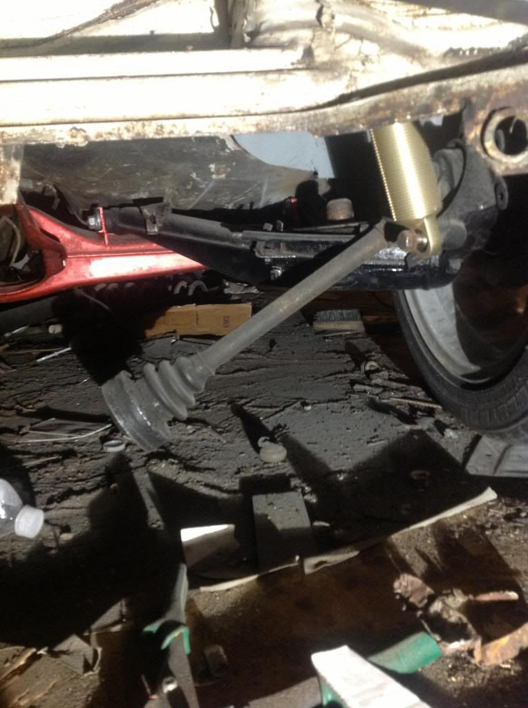

      also purchased ireland engineering full rear coilovers also i welded on camber and toe adjusters in the rear.

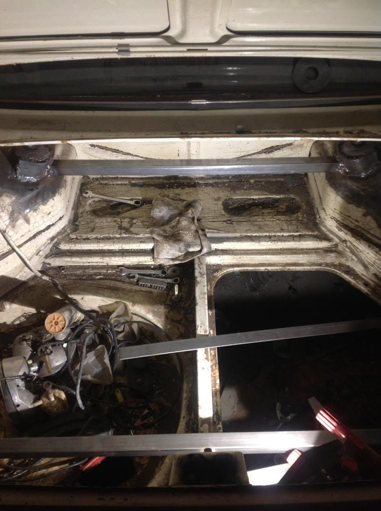

      welded the strut towers together because 02 chasis are weak sauce and like older than me

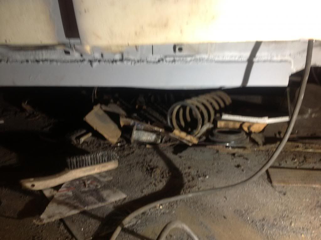

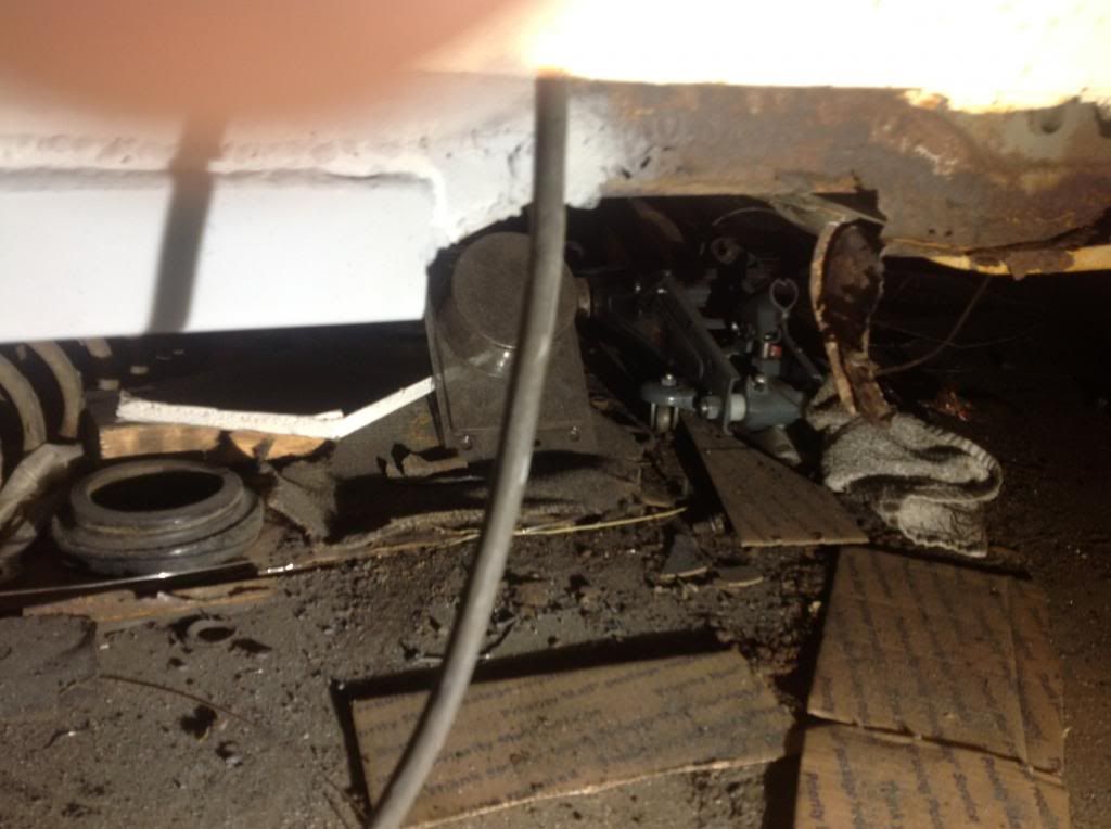

      started to fix the rocker panels with new sheet metal and reinforced angle iron still got more to do UGH

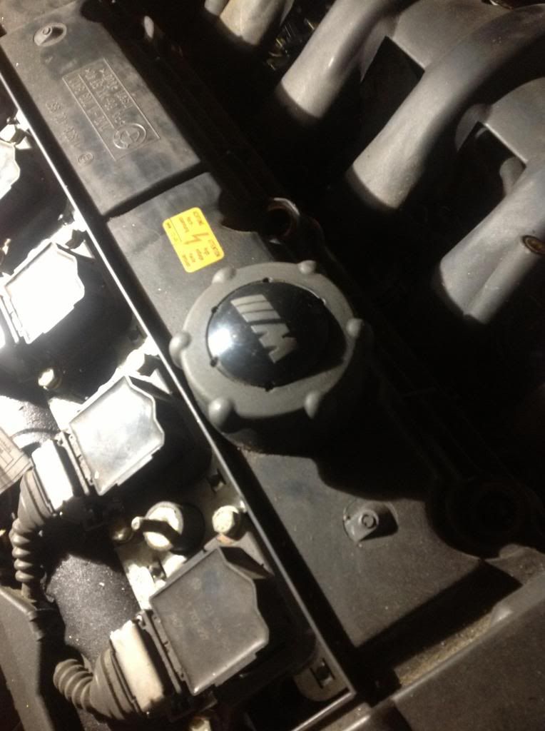

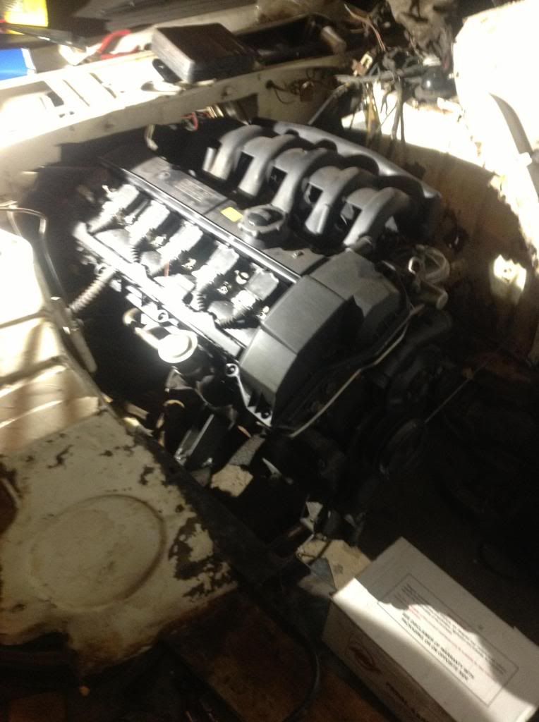

      then i picked up a s52 with 80k miles.... yea i know low!!! just how i like them :)

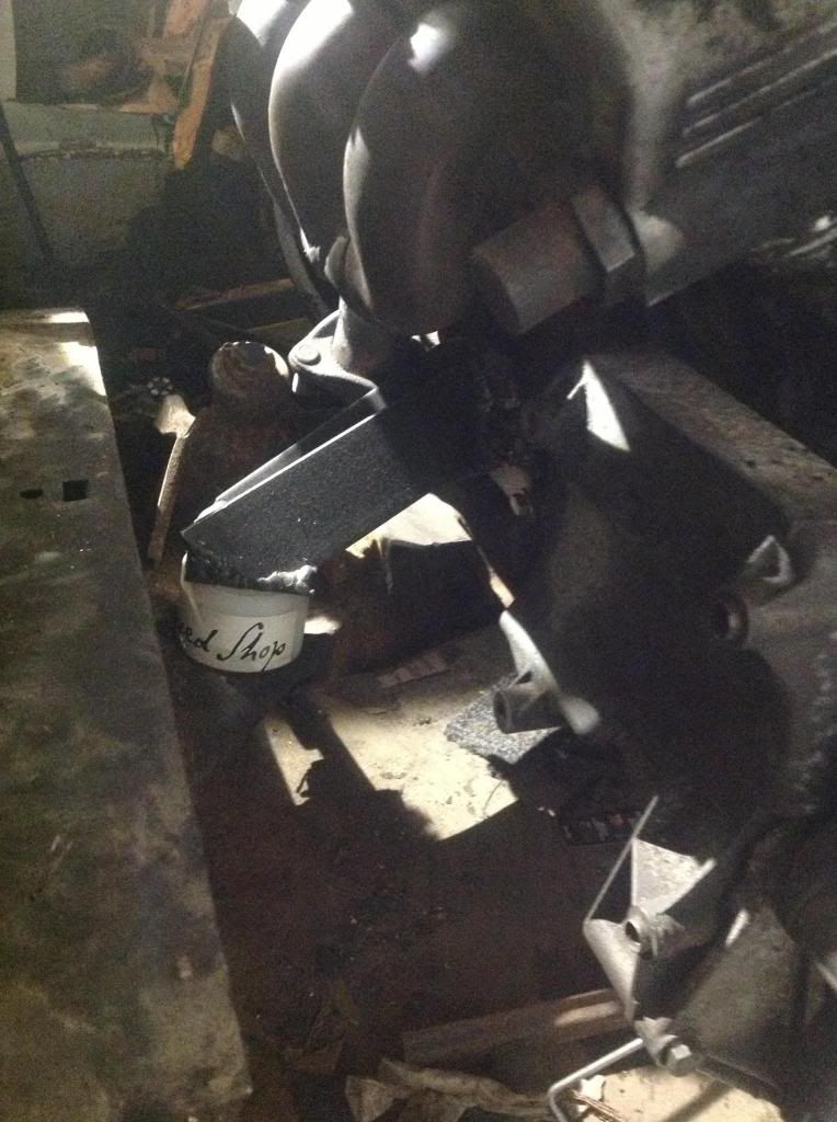

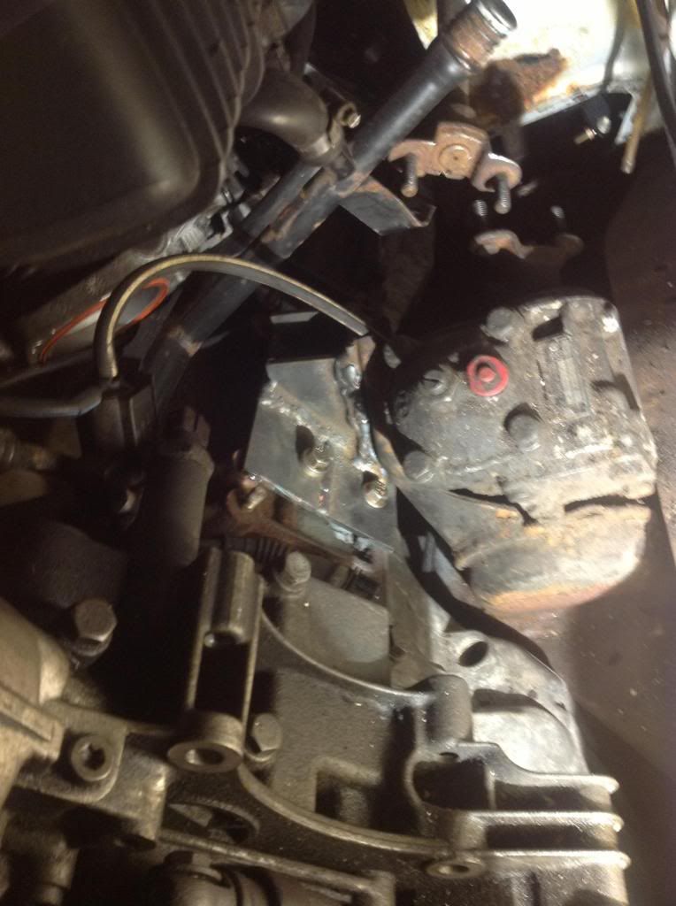

      then one day i was like lets mount this bish i pushed the engine 3 inches back so weight distribution should not be tooooo bad, hatters suck on my nut (no shits given):eyebrows

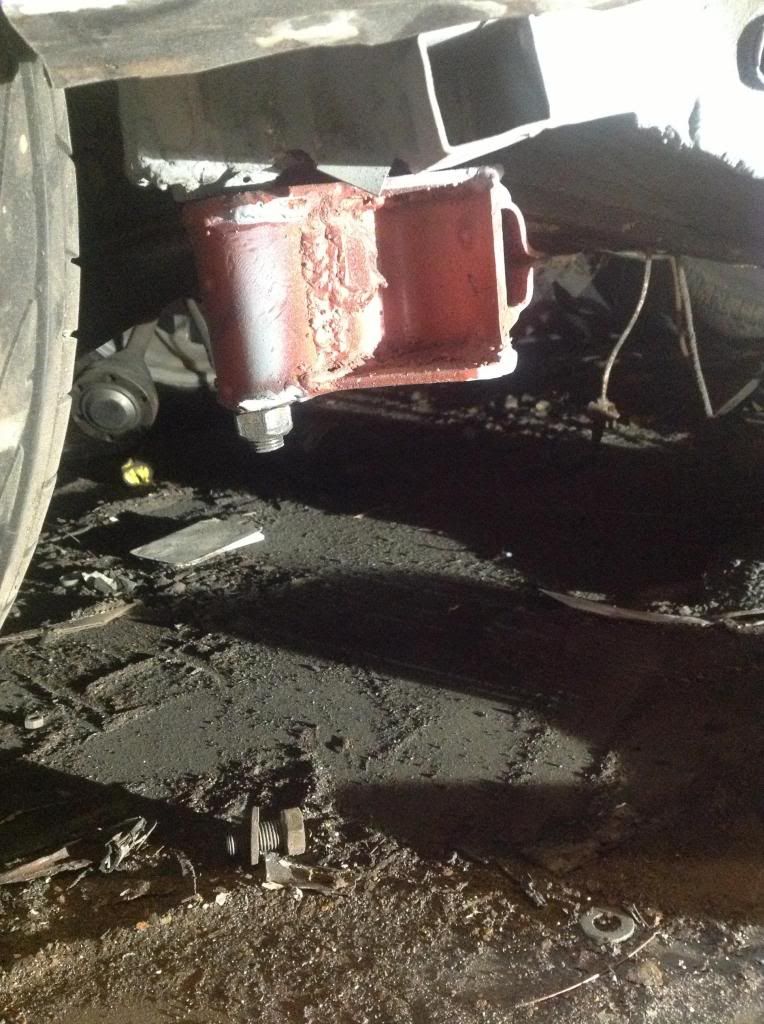

      made some mounts and use a m20 condor speed shop solid mount
      used stock m10 mount located but solid mount

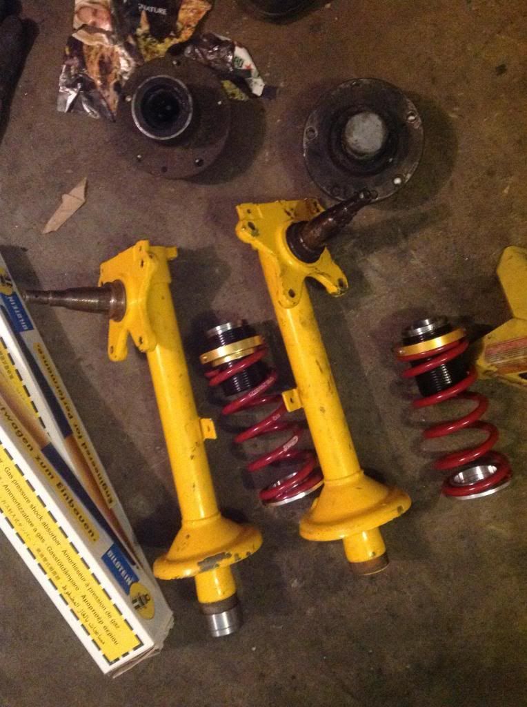

      then i purchased tii struts with e12 hubs for 5 lug swap and bilstein valved struts with 350 spring for the front
      then got a free 4.10 LSD diff son!!!

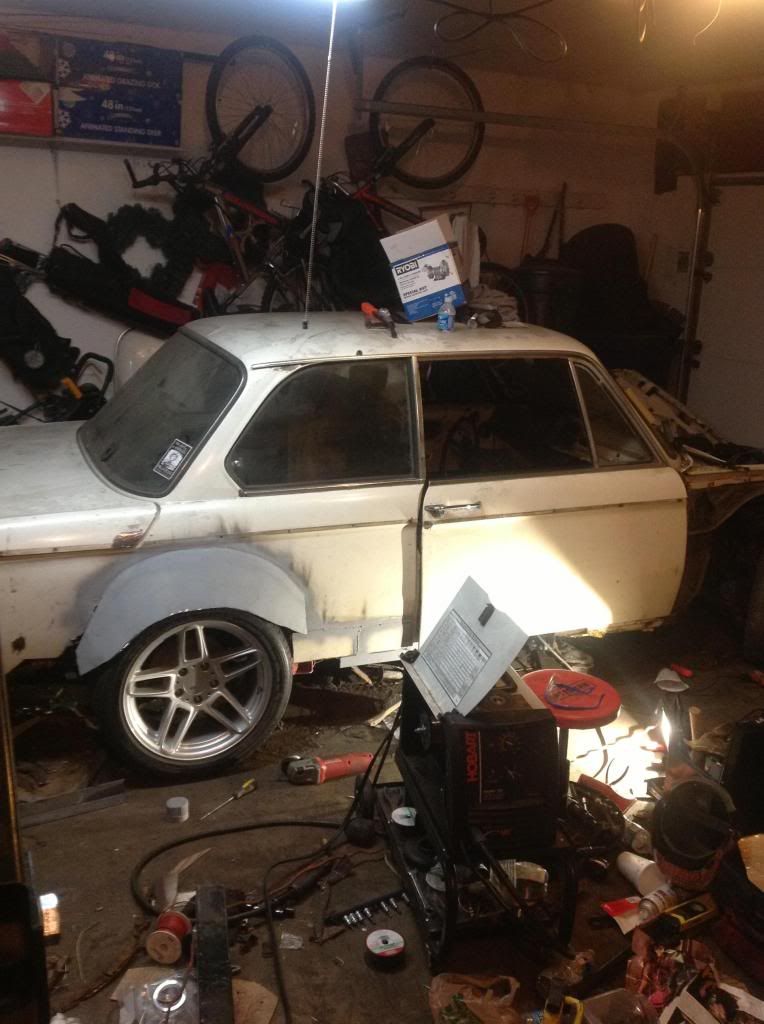

      how it sits now

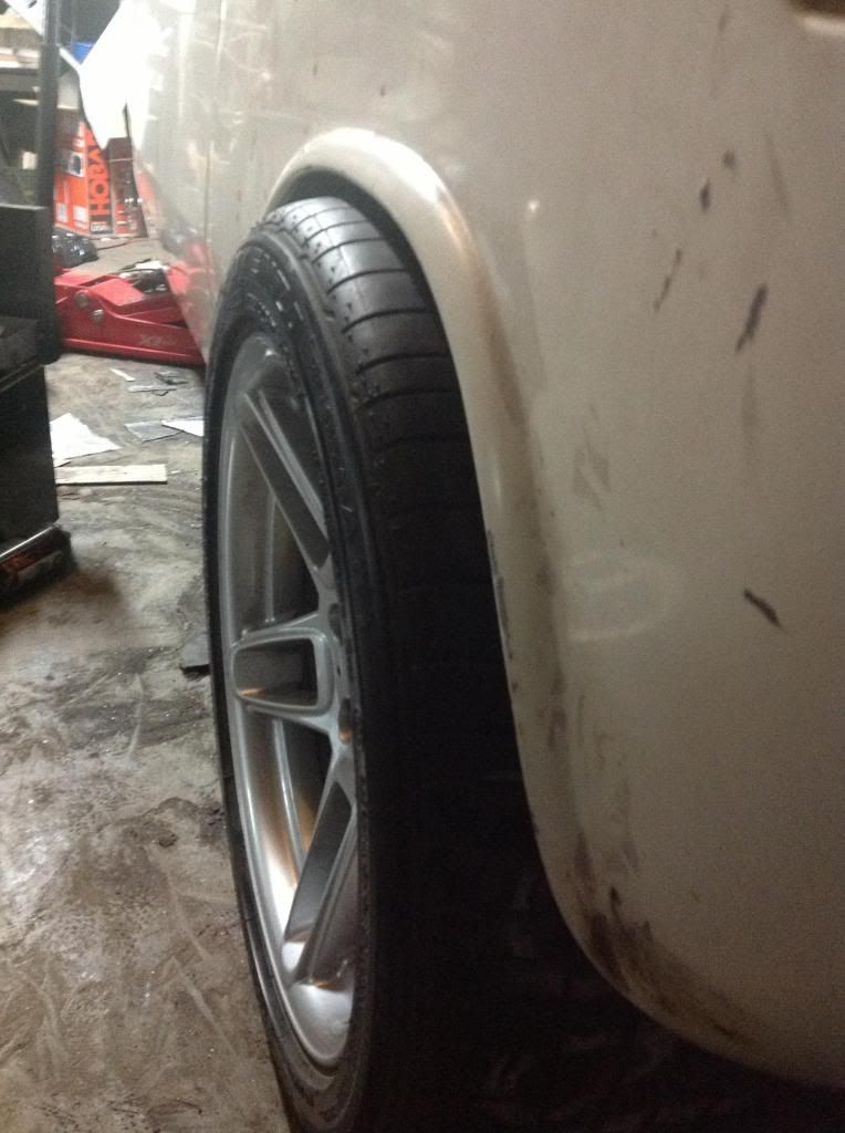

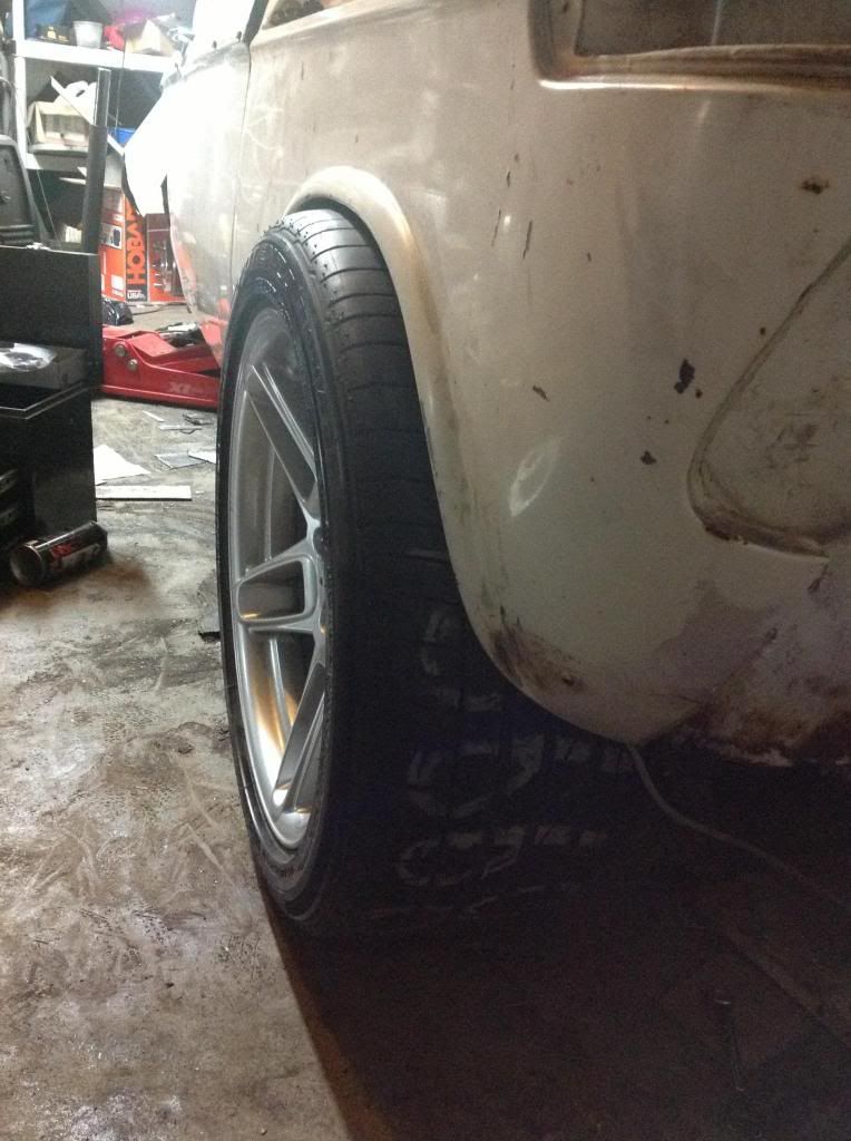

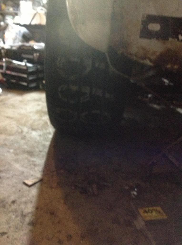

      reverse rake son! oh yea i also made flares... they go out 3 inches still not finished i am going to extend them and make them look nice
      oh yea its on ac shinzters type 3 17x8.5 et14 wrapped around 255 tires
      and the front will be the same wrapped in 255 aswell

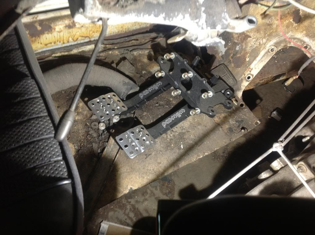

      oh yea inside the cock pit
      i need to mounts these one day :(

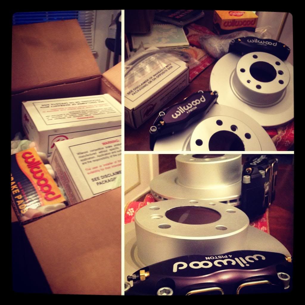

      Today i just ordered a 300mm willwood big brake from ireland engineering for the front so i should get that in a week.

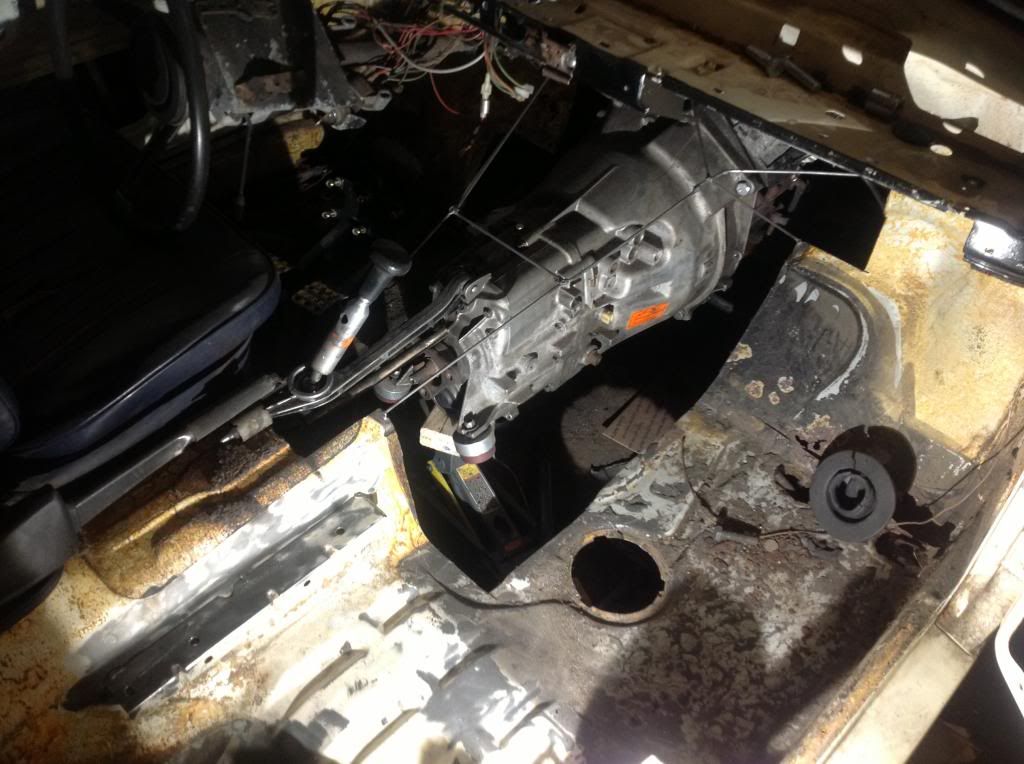

      fab a transmission tunnel

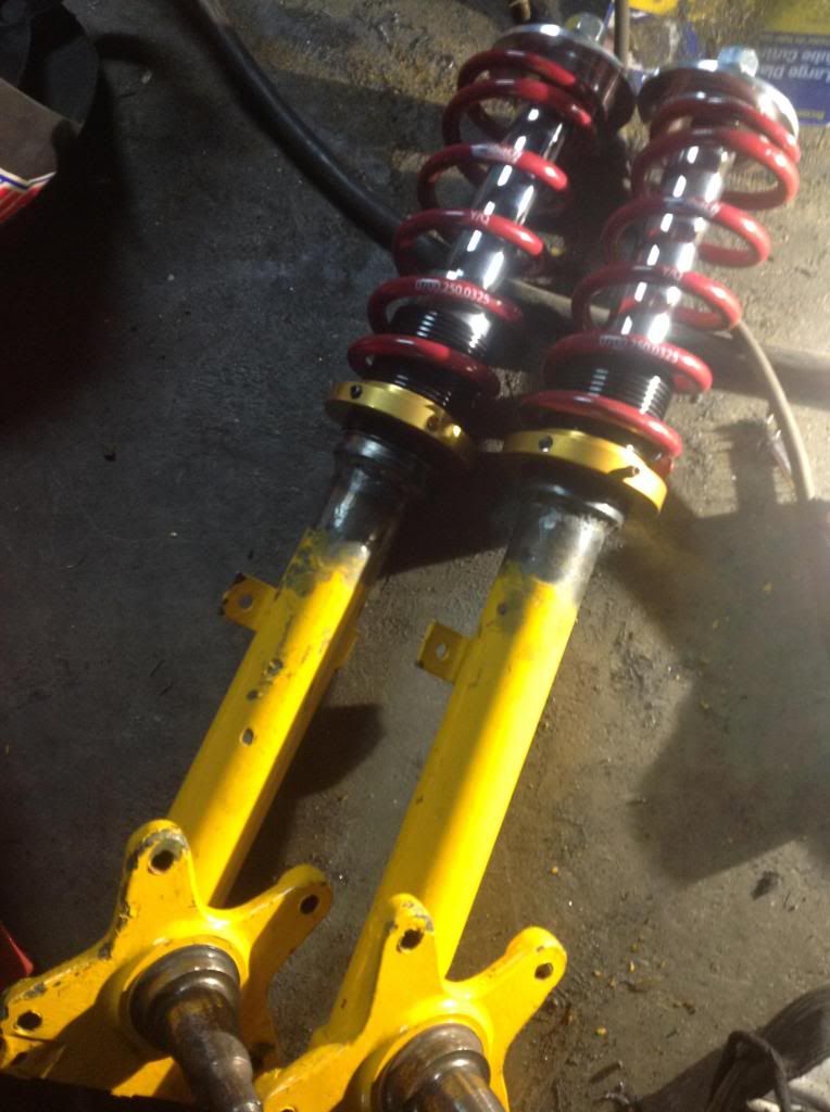

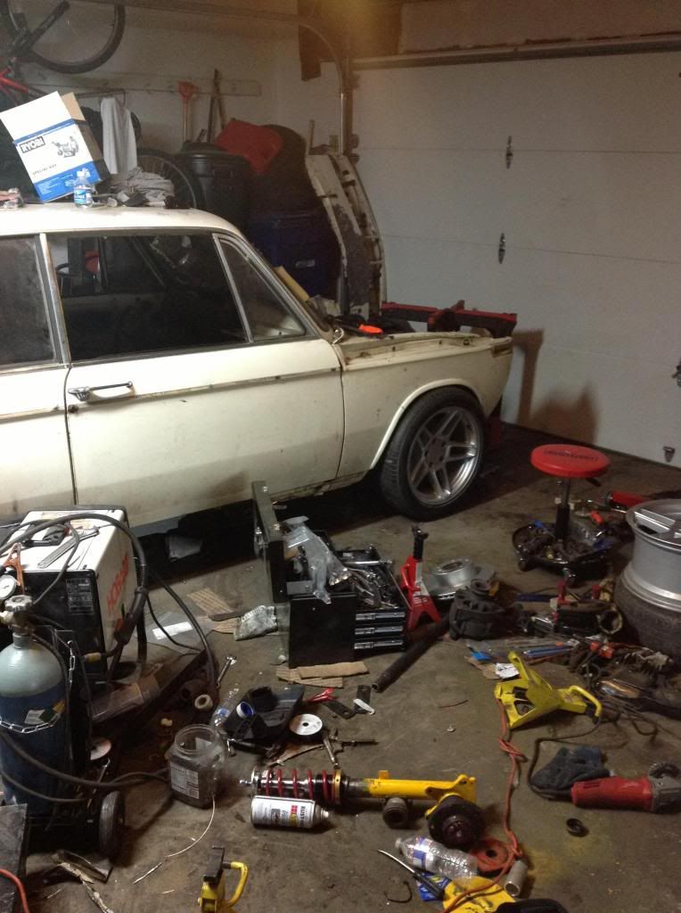

        i was pretty lazy this weekend and didn't do much except for the shortening the struts, them came out decent. enjoy :D
        just got to buy new bearings for the 5 lug hubs and press in the hubs and install 300 mm will wood brakes that are on the way from ireland engineering! those guys are awesome.

                  #38
                  This build is sweet
                  The flare looks a little awkward, but its all a work in progress.
                  I would have ran at the first sight of rust, but it seems like your doing a pretty decent job of restoring this thing. Good Luck man! Can't wait to see more progress
                  haha thanks!, the flare does look a little awkward i will finish it soon, if it doesnt come out well, plan b is to bite the bullet and buy group 2 flares which look some thing like this

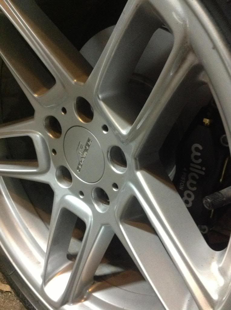

                        • knuklehead92
                          • Aug 2011
                          • 732
                          #42
                          just received my 300mm bbk from irelandengineering!!! i am so excited to drive this thing.
                          255 tires in the front :D
                          Trust me it stock :yawn:

                            #43
                            Dude the brakes. Sex
                            What are you using to get 5 lug at the back? Sorry if you already said. Also love how your fabing up the trans tunnel.

                              #44
                              PS We have the same welder and tool box. No homo lol
                              haha thanks!
                              for the rear i am using a e30 subframe and just using a 18mm adapter from 42 drafts very nice quality, i was going to do z3 hub and brakes but i think e30 brakes are enough, its still a upgrade from stock 2002. Plus i really didnt want to take off the hub and press in a new one. Ive done it before its such a pia, so i just went with adapters for the rear. ive auto x and tracked with the adapters on my buddies e30 no problems for a season so far.
