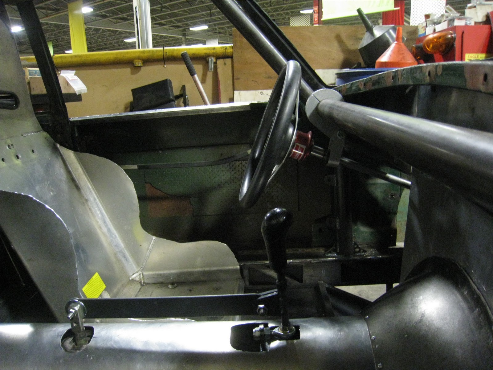

        So far the engine looks like it will fit..... not really, looks like i might have to hack up the firewall. The s52 sale is pending. I am thinking of just selling the s52 so i can avoid hacking up the firewall.... annnnnd goin f20c.... My other option in use the stock e36 oil pan but that will buy me only a few inches. Not enough for what im doing. I need to think about how im going to proceed.
        another issue would be shifter location... it would probly be far back....
        maybe something like this would work.... I feel it wouldn't work as well....

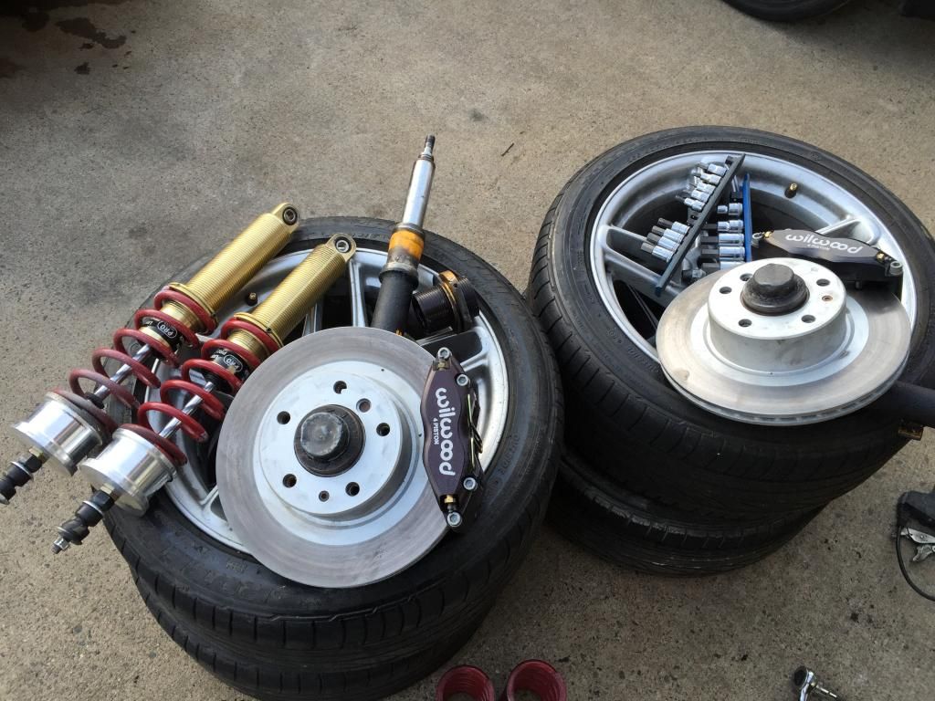

                    disassembly...
                    its kind of sad...
                    my monster rear end
                    4.10lsd, ca tuned axles, large wheels bearings, e46 brakes....
                    braking power was awesome....
                    my front suspension coming off... tii struts, bilstein sport struts, eibach springs, 300mm bbk
                    back to the s2000 chassis.
                    s52 is a long engine, the way the s2000 chassis setup comes into my favor here.
                    Its a a longer chassis by ~ 4 inches
                    Meaning strut mounts are forward by 7 inches compared to the 2002.
                    The Electronic power steering sits forward and sub frame stretches far back for mounting.
                    I will need to cut the fire wall slighty to fit the large lump.
                    The s52 is ~ 53 inches long... from the teeth of the crank pulley to the shifter.
                    which is about 3-4 inches behind the stock shifter position not to bad.
