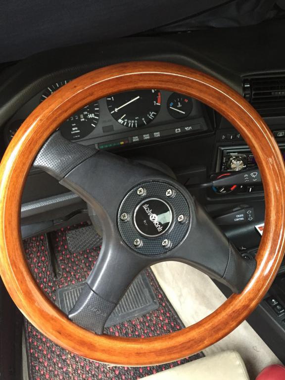

            yo, jeff ... i read early in this thread that you were fitting your cabrio with an italvolanti steering wheel ... & then later you posted the pic below ... can you give any additional info about this great looking wheel ... like the size, model, & if it would easily fit in an air bagged cabrio ... plus any observations you may have had during the install ... thanks
            '92 alpinweiss 5spd cabrio w/mtech appearance package & factory hardtop
            '95 alpinweiss 528iT
            '88 dodge ram 50 sport cab
            • jeffnhiscars
              • Jun 2011
              • 6011
              #231
              That's the wheel as installed in my Cabrio which is a non airbag car. It's a fairly common 6 bolt patterni so I purchased a Momo hub on eBay for I think $72. The hub bolts to the column using the stock hardware. There was no ground wire from the italvolante horn ring so I drilled a hole in the hub and made a pigtail. I thought I posted a pic of that. The 6 bolts that came with the wheel were too long so I went to HD and grabbed some SS replacements.
              Yesterday was the first time I've removed the wheel in an airbag car (what a pain in the ass) and I don't see why it won't work other than confirming how to properly delete the airbag and I've read that the levers are in a differnt position due to the depth of the wheels.
              The wheel itself is 350mm. I was initially concerned about the lack of mechanical advantage but power steering is power steering and it doesn't care what size crank you have. The fact is the smaller wheel requires less arm movement for the same arc, so in a subtle way, it does make the steering feel a bit sharper. Keep in mind I also run e36 racks.
              The only downside is that it cuts the top off the gauges, so I have to duck to co firm my highway speed. Th good news is that 80 is at noon on the dial so I don't really need to see the numbers.
              Bottom line is the wheel is stunning IMHO and takes the interior to anoth level. There are wheels out there that ar stock diameter that I am tote by, but not enough to want to touch this one. Plus I love the Italian name staring at me. Gives the car a certain flare - capiche ?
