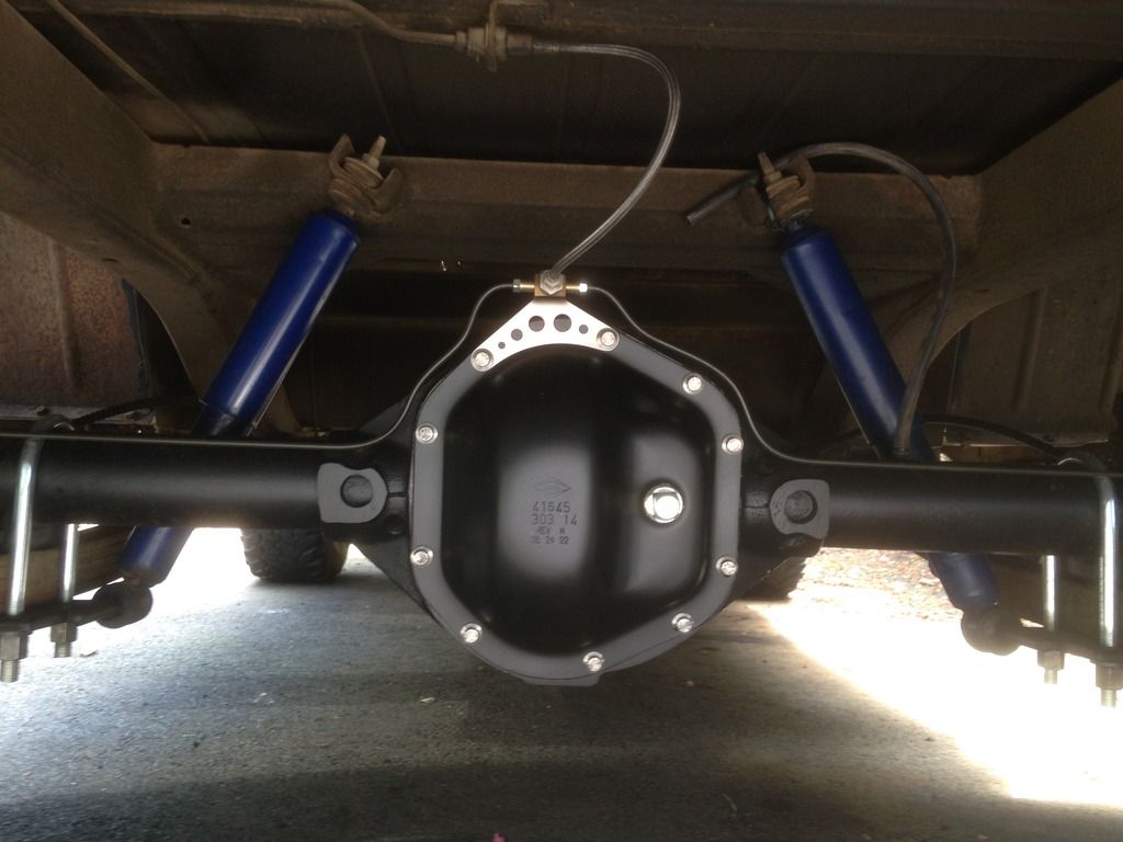

    A little deeper than i wanted to go.
    Axle housing was rusted on the inside of the tubes, fabbed up a flap sander and scotch brite plus nylon brush. All clean now.
    Ready to setup.
    Late 70's Scout II and Ford F150 share basically the same brakes so i bought a Ford caliper (smaller piston) to see if it would clear the front knuckle more and allow me to clearance less.

                  That sure cleaned up nicely. What on earth does an axle spreader do ?

                    Originally posted by LJ851
                    Picked up an axle housing spreader to make life easier, made in America yes please.
                    Same question - is this like the well known board stretcher, which is used extensively in construction?
                    Very nice looking finished axle housing by the way.
                      Lol !
                      The carrier or diff housing is installed with about .015 inch preload and the axle housing spreader spreads the cast housing to make it easier to remove and install the carrier.
                      Here i am measuring the housing as i spread it.
                      Edit: wow that picture is lousy, sorry.
