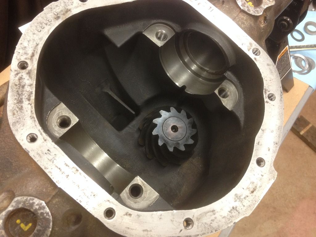

    Made a tool to remove and install the LSD clutches.
    Rebuilt LSD with ring gear reinstalled.
    Pinion installed with setup bearings.
    Carrier installed with setup bearings.
    Checking backlash.
    Checking/adjusting gear pattern.
    After getting everything where a wanted it, permanent assembly with the new bearings.
    I'm changing the oil level in the axle with a different rear cover so i blocked the original vent hole in the axle tube.

                      Set up bearings are used so i can remove and install the bearings/races by hand instead of using a press and pullers and risking damage to the bearings and the adjustment shims underneath them. I can change shims much faster as well.
                      I used steel brake line and bend it around various things like sockets and tubing. I have a 2" rod of delrin with a notch cut out of one end to bend the line right out of the flare nut like at the junction at the top of the diff cover.
