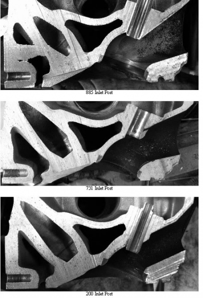

    Originally posted by jute91
    yeah. Air flow should remain same direction. If you are going to install your ITBs upwards, its going to add curve that changes your air flow direction. Original manifold flange doesnt continue inline with ports..
    bmw heads need this, expecially adding material to bottom of the ports
    Looks like two of your attachments didn't make it

      ahh, there is only one attachment? I had see the two other Xs and thought there were three.
      That looks like an interesting read, what is that from?

        Here is another... that text is from " A. Graham Bell- 4-stroke performance tuning 3rd Ed. i got the 2nd edition on finnish book, but i downloaded 3rd on pdf via google search. it gives lot of ideas!
