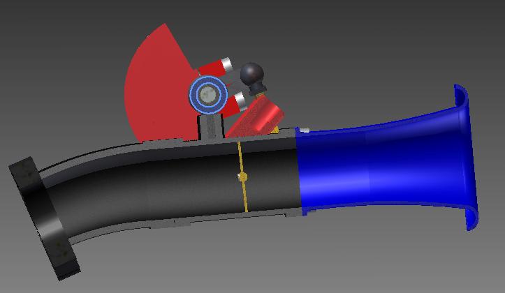

                      Small updates:
                      The aluminum tubing showed up a couple days ago, so next week I'll cut a couple pieces and get them tacked on to the manifold in order to check clearances. I also made up a set of stainless steel spacers to space one set of throttle bodies...
                      I'm still considering what approach to use to extending the throttle sync tabs. Right now I'm thinking that since it's only 8mm they have to be extended I will just build them up with weld and then just grind them back down to the proper thickness. If that doesn't work I'll have to cut off the current tabs and fashion a small piece out of flat bar that can be welded on...

                        Do you include intake port to your plans? You are now doing just another "curve" to different position. Notice that intake channel has already 2 curves as it should be one tightening curve to accelerate air flow
                        Here how it should be done.
                        And my own drawing
                        Also found on Facebook - Juuso Tero, Tampere
                        https://www.facebook.com/JuusosGarage

                              Originally posted by jute91
                              This is very interesting.
                              Giving good thoughts for my own itb project..
                              Are you talking about modifying the intake ports in the cylinder head?
