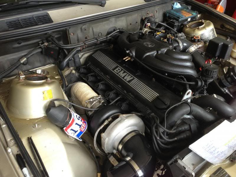

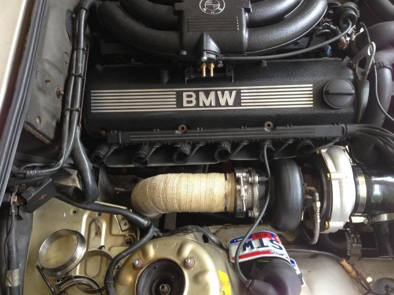

                              Update: The oil filter hits the OBX manifold adapter, lame lame lame. not a major issue should have it figured out tomorrow and the exhaust is almost done, so should be off the stands soon :) pics tomorrow or monday
                              Build Thread
                              • slow325isedan
                                • Mar 2013
                                • 113
                                #75

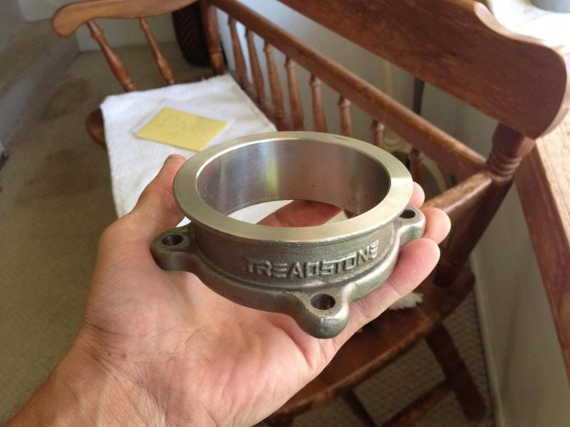

                                Steel BOV flange came in, got that all welded up and finished the charge pipes.
                                Also got my 4 bolt to v band adapter for the turbo so i can finally get started on the downpipe/exhaust

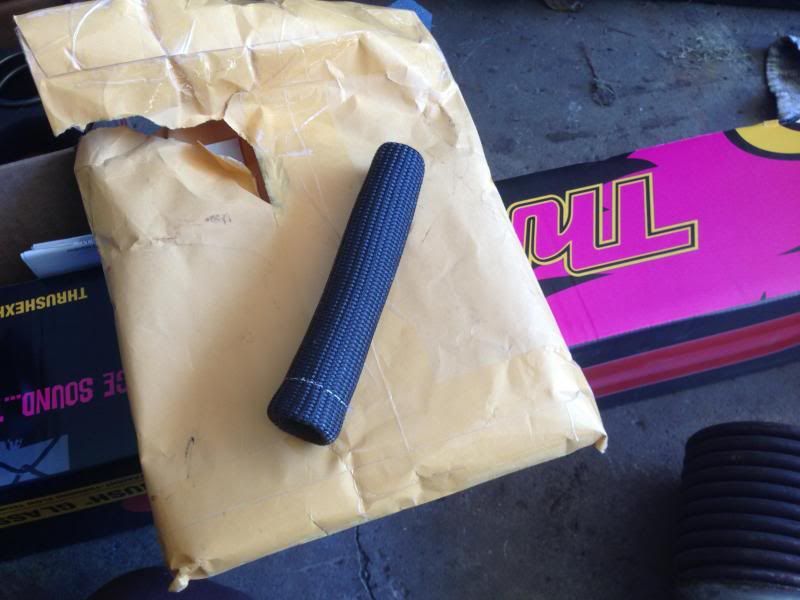

                                Heat sleeves for the plug wires! great product

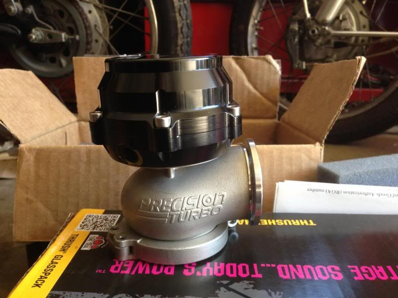

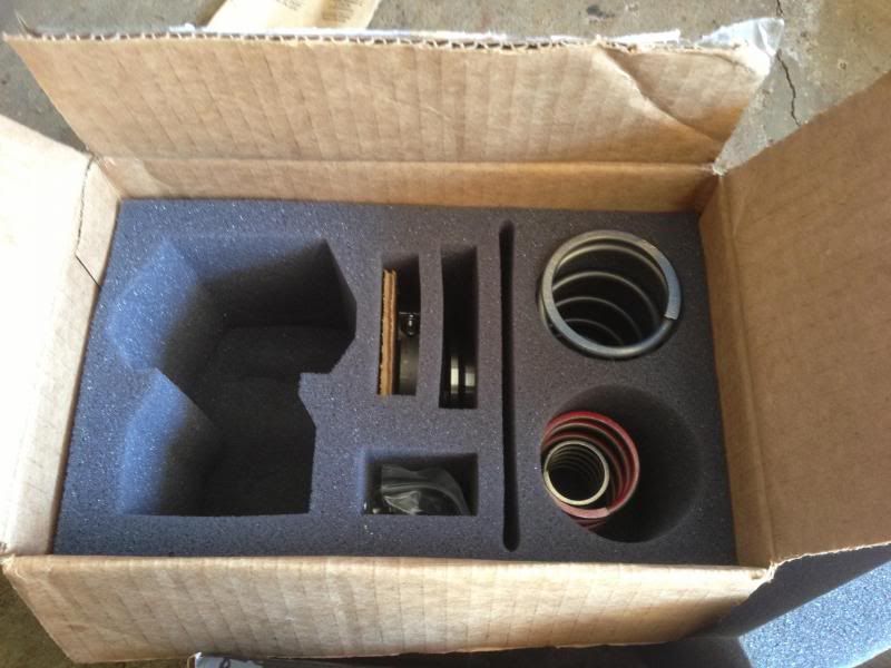

                                I was mildly worried about boost creep so i sold the tial 38 that i had and bought a precision 46mm, Should not have to worry anymore lol

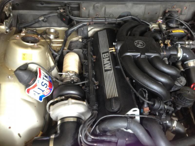

                                And with it all together, starting to look pretty good! Im so happy with the way everything is working out,

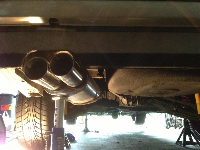

                                Began building the rest of the exhaust yesterday,
                                and when i left lastnight it was complete and i painted it with some black VHT turned out really well!
                                Build Thread
