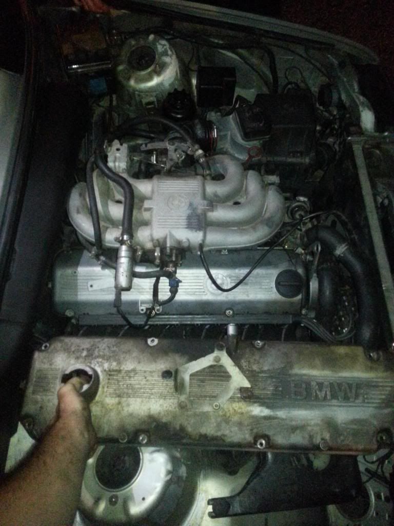

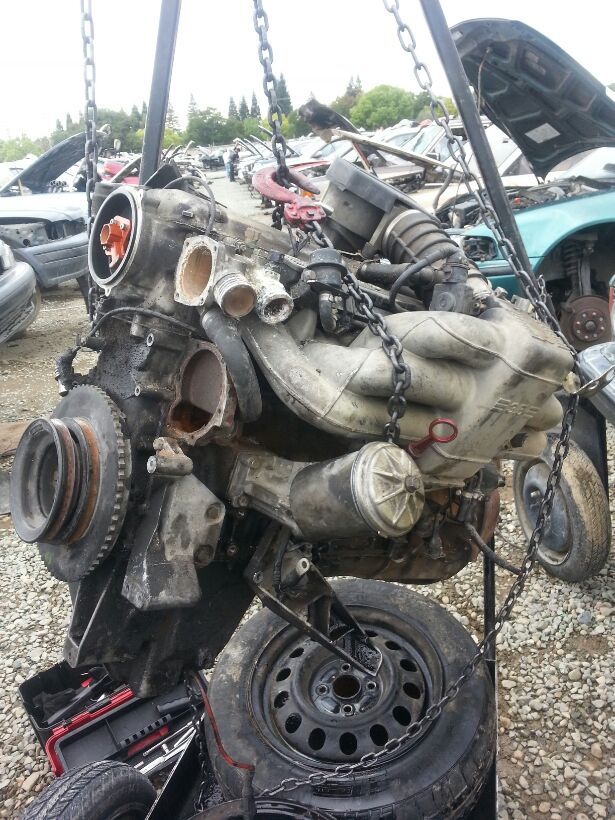

          I picked up a m30 3.5l off a 735i today I'll post pics soon.
          Float like a cadillac sting like a Bimmer!:)
          • Bimmer_man
            • Jan 2013
            • 1477

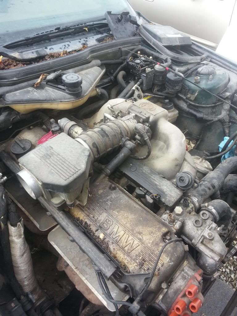

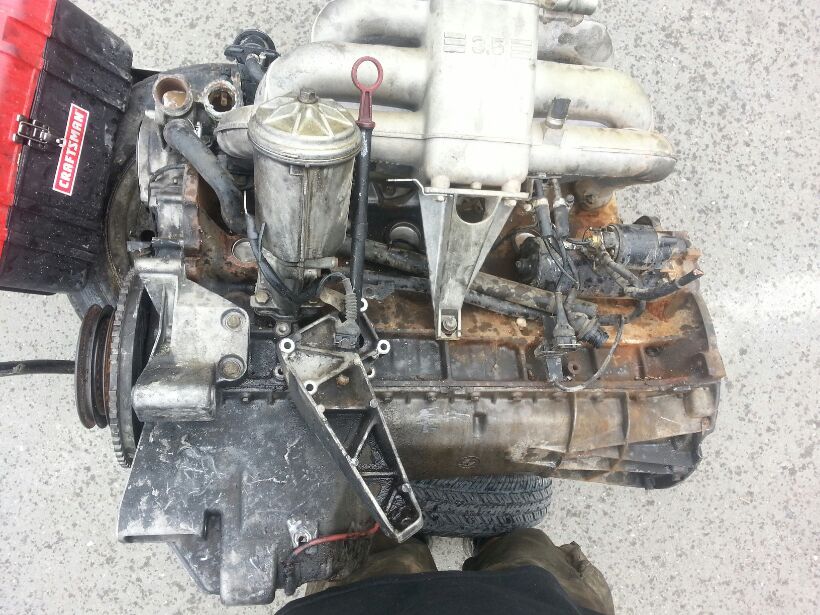

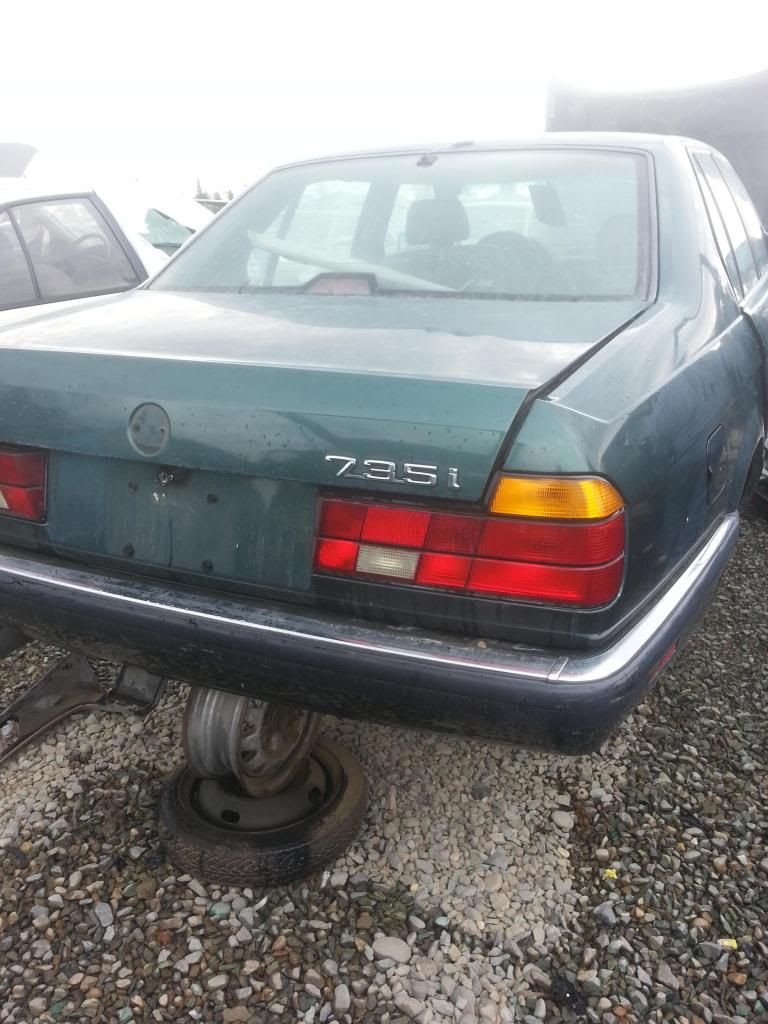

            Here are some pics of the engine i grabbed
            the donor car
            The engine as it sat in the 735i
            Pulled it out and started taking off everything i didnt need
            Ready to load up and take it home
            yeah this engine was sitting for a good long wile before i came to it. I am thinking the car may have had an overheating issue cause ALL of the cooling parts looked relatively new.

                Originally posted by golde30
                rat turds on the valve cover??
                it was sitting for a long time and its kinda hard to argue with $90 for a engine. even if i need to replace a lot of stuff i still have a head and block.

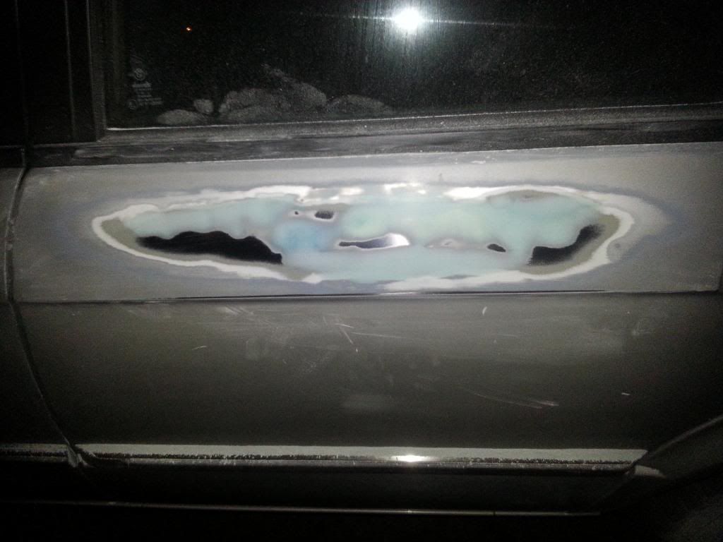

                      So i decided that i have the engine im waiting on an engine stand ......lets start on the body work. So i got some good quality body filler and went to work. Here is what i ended at for the day.
                      to explain why there is such a large cover area is cause there where a series of small dents and they where dang near side by side.

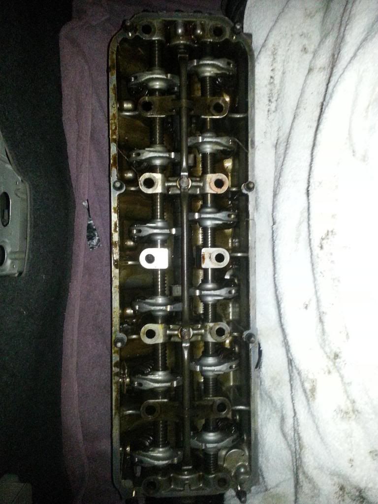

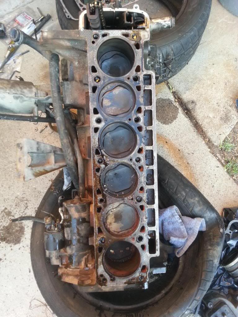

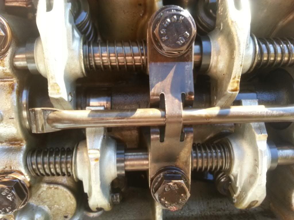

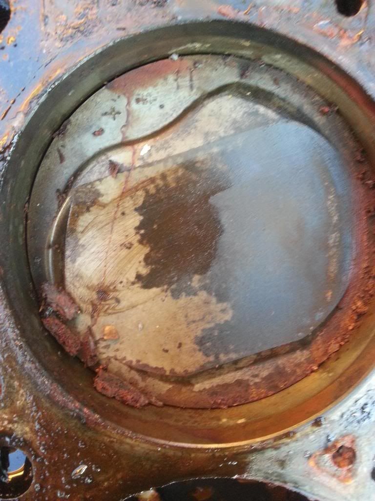

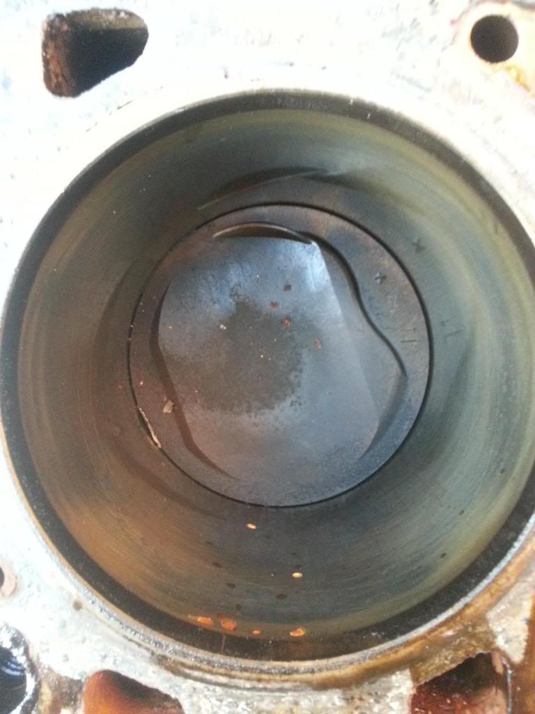

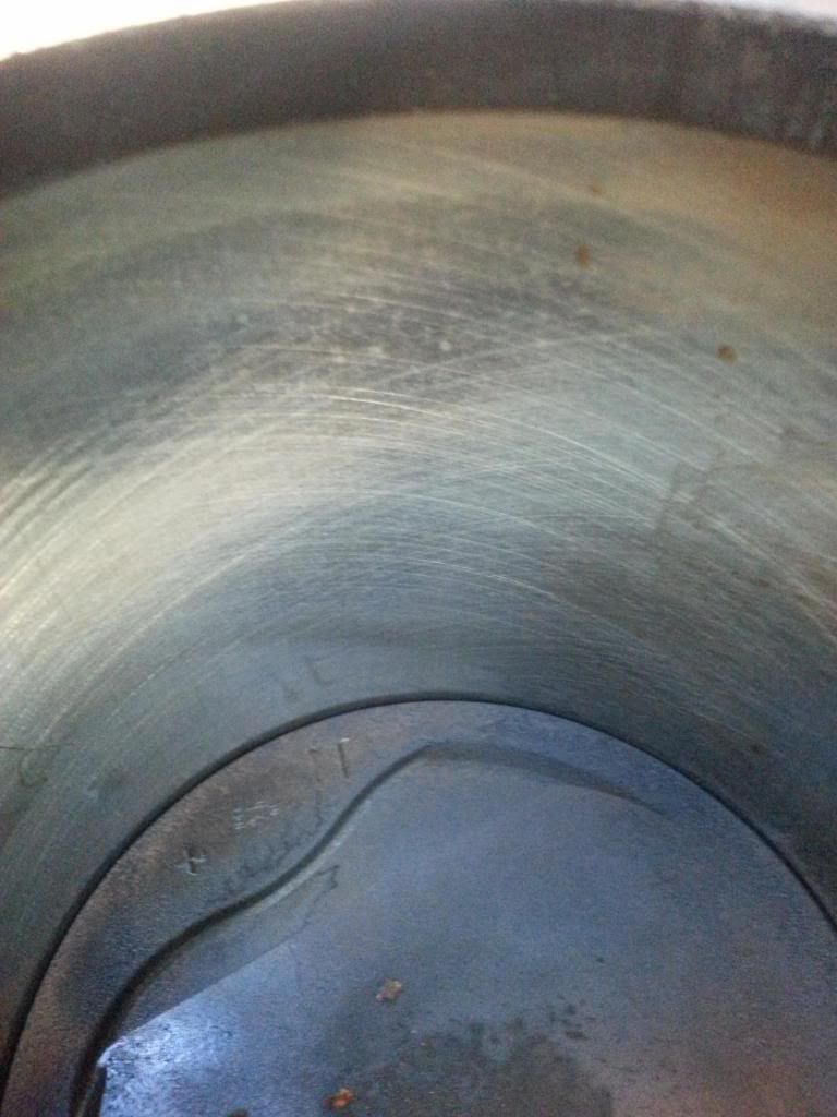

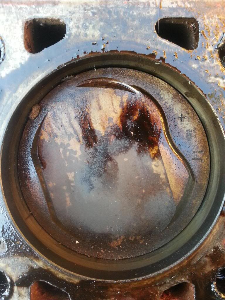

                          So i started the tear down on the engine last night i took a few pics. I was more curious what the damage was to the engine and i got to say i am one lucky SOB with this. My suspicion was right. All that was wrong was a head gasket. I am still going to rebuild the engine for obvious reasons but as far as best case scenarios this is a pretty good one for an engine that only cost me $90.00.
                          Comparing the two wow what a differance
                          Valve train looks healthy
                          Well im going to get new valves anyway haha
                          can you guess where the head gasket blew
                          well thats surprising
                          looks cool haha
                          Not so cool yuck
                          it looks cracked but its not its a rust stain. Im going to have them cleaned and inspected at my local machine shop and see if i can reuse the current pistons i doubt it though.
                          Close up shot the cam dosnt have any scars at all.
                          And im going to be throwing the head in a cover and throw it on a shelf till i can send it in to bimmerheads for them to do what they do best. So in my down time i will be doing the body work to the car ripping the paint off using body filler on a few small dings on the car. There is one dent on the driver side door thats just too deep to even think about trying to get at with body filler so i will do one of three things, Pay a shop to pull the dent out, do it myself with some guidance from my friends dad, or just say fuck it and replace the door. Replacing the door may be cheaper but more work than paying a shop.
