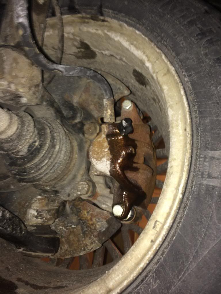

    Went to go get the car inspected today, but it failed..... It needs a new passenger front tire (Just gonna get 4 new ones), there seems to be a leak on the passenger front caliper again. They claim it's the caliper, but since the caliper is less than 6,000 miles old I'm thinking other wise. It looks like it's coming from the hose, but I'll fix that this weekend. It also needs a new exhaust because the current one has developed some holes in it. Not really sure what I'm going to do about this. Maybe find one in a junkyard or just go ahead and bite the bullet and get an after market one. I'm thinking scorpion. I like the sound and the fact that it's stainless steel. Also the price doesn't hurt either. I might do that plus the rear half shafts in the next month. Until then my buddy says he knows a shop that will help me out with inspection if I get the break fluid leak sorted out.

              I visited home this weekend to try and get some of this inspection stuff sorted out. I got all new tires, kumho tires all seasons (They were the cheapest I could find). I was going to buy a new exhaust, but I found this exhaust putty and tape that supposedly fixes exhaust holes and leaks so I decided to give it a shot. It seems to be holding up pretty well, but its only been a day so who knows...
              I also decided to try and work on the brake fluid leak. I cleaned everything up and pumped the pedal a couple of times and found that the leak is coming from the bleeder screw. I took it out and put a couple of new ones in that my dad had laying around. None worked and they all leaked just the same as the first, so I'm thinking the threads inside the caliper are screwed. So I think I'll just buy a new passenger front caliper (The calipers are only 6,000 miles old so it kind of pisses me off I'm already replacing one.)
