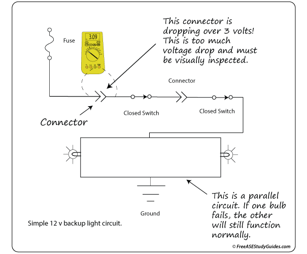

                    Does your dad have a multimeter? Make sure you're getting voltage to the power terminal and solenoid terminal of the starter, also check for voltage drop.
                    Here's some basic guides for this procedure, you might be able to find something better on google:
                    When the starter is slow to crank, check the battery an d perform a voltage drop test on the starter circuit. How to perform a voltage drop test on a starter circuit. Volatage drop test the positive and negative cable.
