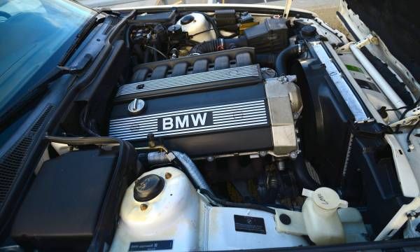

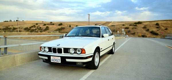

            Im thinking of grabbing this one. Looks super clean and well taken care of. Only adult owners with records. $3000

              Do it! I just traded my e30 for a 1994 530i 5 speed! =) Not a touring but I want one!

                  New cooling system, just like I said. In my experience there was no oil in coolant, it was just eating coolant and filling cooling system with air. Steam from exhaust when at operating temp, and top coolant hose super tite and expanded. I suppose if you have a coolant system pressure tester that would be the best way to know.

                      I bought a CO2 test kit so I can test for CO2 at the radiator. Ill check for smoke as well. If it has a head gasket problem maybe I can talk them down a lot.
