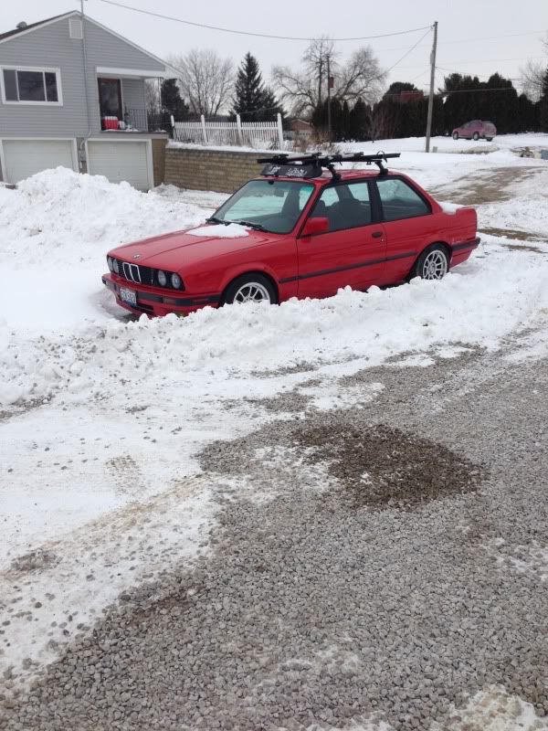

    Well the car has been driving great for the last few days. No real issues to speak of. So here's a few photo's of the exhaust wrap up on the car.
    How do I get my whole unattached exhaust to the shop with my car? Roof rack of course!

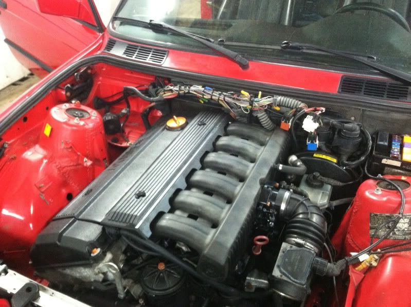

    And that's about it till I finish up cleaning up the wires in the bay. It pulls nicely, sounds good but the idle is a bit lumpy. I'm suspecting either a dirty ICV which I'll pull and clean or the injectors which I was planning on getting a refreshed set anyways. I need to order a skid plate soon too, already bonked the pan once. I was lucky and found one of my extra 403 DME's I picked up had a Dinan chip in it. Swapped out the stock 402 for the chipped one and the difference is quite noticeable. Much better response and the top end feels a lot stronger.

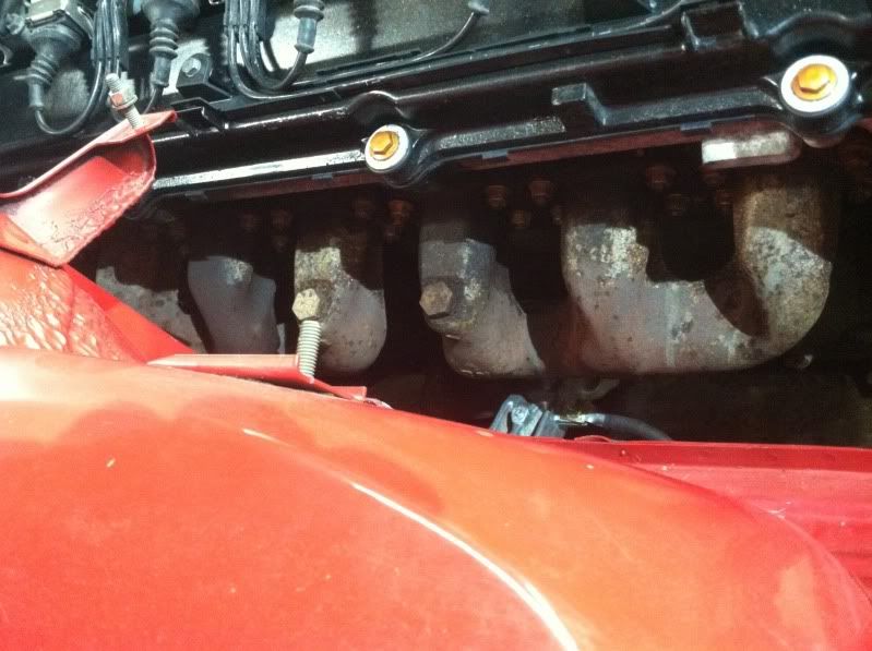

    Just cross referenced part numbers for the OBD1 headers and I was correct. The front set of headers is a different part number between the E36 and E34's but the rears are the same. Oh well, picking up some OBD2 headers from NickL this week. Another one of those "should have done in the first place" things.

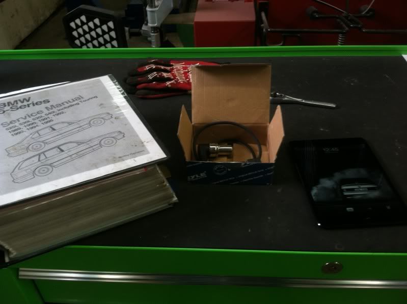

    So stoked it fired up today. I started out by putting the new Crank position sensor on.

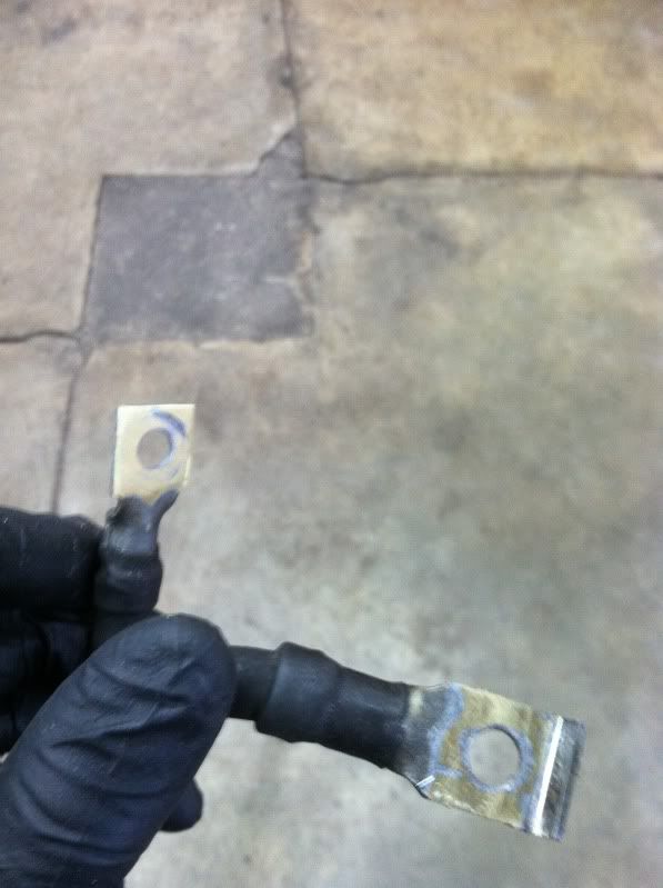

    Then I took all thr ground wires off, filed everything to nice fresh metal. Not sure if this really had an affect but can't hurt.

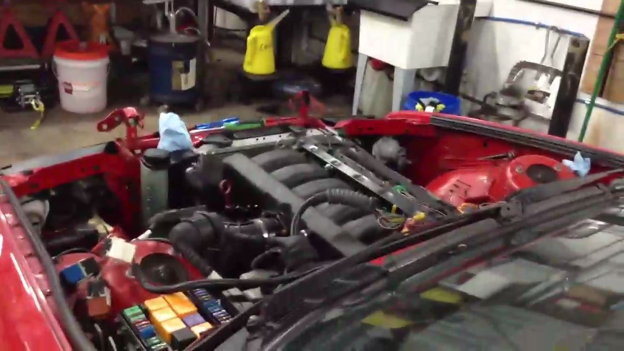

    Then, well..it started. Sweeeeet. Video if you click the image.

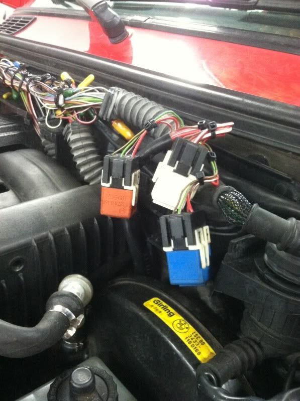

    Started cleaning up wiring and zip tied the harness up to the firewall. Need to figure how to get the relays to sit in their little holders. Ordering the m3 firewall cover for the passenger side.
    Went to hook the exhaust up. Using obd1 manifolds from an e34. The y-pipe I had is from the e36 the motor came from. For some reason they don't line. I cut the y-pipe into individual pipes and the front header flange doesn't seem to line up at all. Is there a difference between e34 and e36 manifolds?
