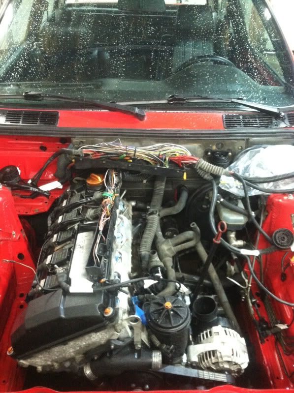

    Hey look, I actually did something!
    Didn't think to take too many pictures, was working alone. Thankfully my friend showed up right when I got there to help me push it in. We got like 3-4inches of RAIN yesterday so even the gravel driveway they have was absolutely soaked.
    First I replaced my blower motor because why not with everything off the car? My old one sounded like rocks in a blender. Although it seems to be slightly rubbing on the right side, no matter what I did it didn't seem to change. I assume this isn't normal?
    Again, forgot to take pictures of much of what I was doing. New exhaust gaskets and all new studs. Did this with the motor in the car. Highly recommend doing them while it's out. It wasn't that hard but the last few were a tight squeeze.
    Totally forgot to heat and extract a broken stud which means that front manifold will likely have to come off again. Sweet. (the furthest one away)
    Up in the air. My buddy bought this insanely bright LED light on a tripod which made working under the car so much better.
    Time for clutch stuff. After finding the F1 14lb flywheel and gripforce OEM M50 setup I bought was too big for the G240, I opted to go with the OE M42 dual mass and a new M42 clutch. Have read of a few people running this and seems to hold the power of an M50 just fine. Will eventually upgrade down the road.
    Flywheel on.
    Clutch on. I got a bit nervous at this stem because I've never done a clutch and no where was it labeled "flywheel" side. After looking at it for a second I noticed that one was it would hit the flywheel bolts and the other way it wouldn't took a stab in the dark and mounted it up.
    Mounted the pressure plate but didn't bother with any pictures. I'm still nervous if I did this right, haha. My euro 320 linkage was supposed to have shown up but is a day behind so I didn't mount the drive shaft yet so I can install that this week. Then I wrestled with getting the transmission mounted by myself. Had a trans jack but it was still a process and am really sore today, haha. One thing I noticed I hadn't read anywhere is to mount the G240 to an M50 you have to remove one of the guide for one of the bolt holes on the transmission as the engine has one in the exact same spot. After I finally got it in place, I couldn't get the input shaft to catch the pilot bearing. Another 30 minutes of messing with it and I grabbed a big C-clamp vice grip, found a couple flat surfaces on the trans and engine and squeezed and it popped right in. What a relief.
    Next I got the starter in, started running a few of the coolant hoses and the wire harness.
    On the firewall, the inlet and outlet for the heater core. Do I have these mounted up correct? The top one is the spider hose, the bottom is the hose from the back side of the engine. I've you can do some good damage if you mix these.
    Started plugging some of the connectors and mocked up some stuff basically leaving me here. My linkage should be delivered tomorrow and after tomorrow, I don't work till Jan 6th so I'm trying to get this thing done ASAP.
    Till next time
