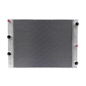

    The m5 uses a very odd radiator as it is actually two radiators stacked on top of each other. If BMW designed it that way we would love to keep it. But one issue is the m5 radiator is too wide.
    Sometimes you have to cut...
    The cut part will be completely boxed in.
    And there we go...

            Wow that radiator is nuts! Looking good though, keep it up

                  Wow crazy! Is the radiator two stage? In and out the top, then in and out the bottom then back to the engine?

                      Even stranger than that. It is actually two radiators on top of each other. Two inlets and two outlets and two drains. Each side of the engine uses one section.
