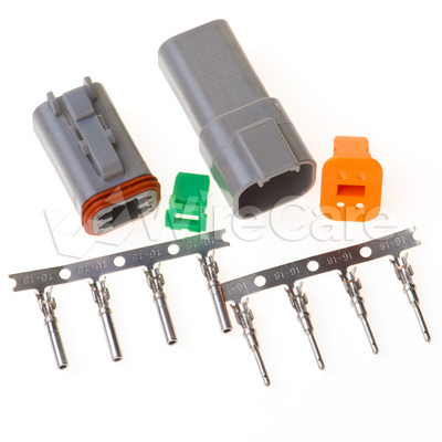

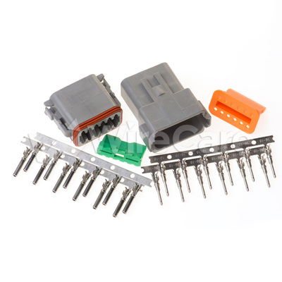

          i got two deutsch 12 pin connectors, one in black to replace my c101 (the c101 only needs 10 wires to be fully connected, no reason to have a bulky c101 that's only half used) & one to place the si thingy in the glove box (the connector won't fit through the oem hole so i'll need a connector to make it fit)
          i also got a 4 pin connector to essentially replace the c103 and to route the check engine light to the cluster. and then a 2 pin connector to add the oil level sensor to the check panel. it's time to clean up the sorry excuse of an engine bay that this car has.
