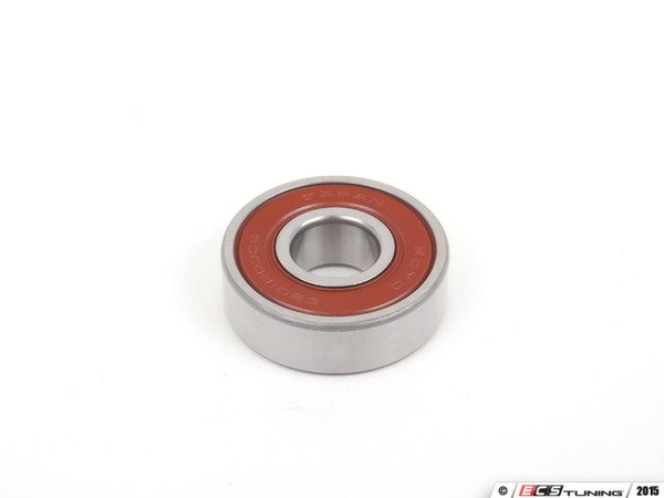

      I also noted that the pilot bearing doesnt have any casings around the actual bearing...I thought that was odd. I bought this one through blunttech but ordered a new oem one in the hopes that it has casings on the bearing.
      The one I got
      The picture from ecs for the genuine bmw part

                  Awesome work! I agree the pilot bearing should have dust seals, I've never seen one without them.
