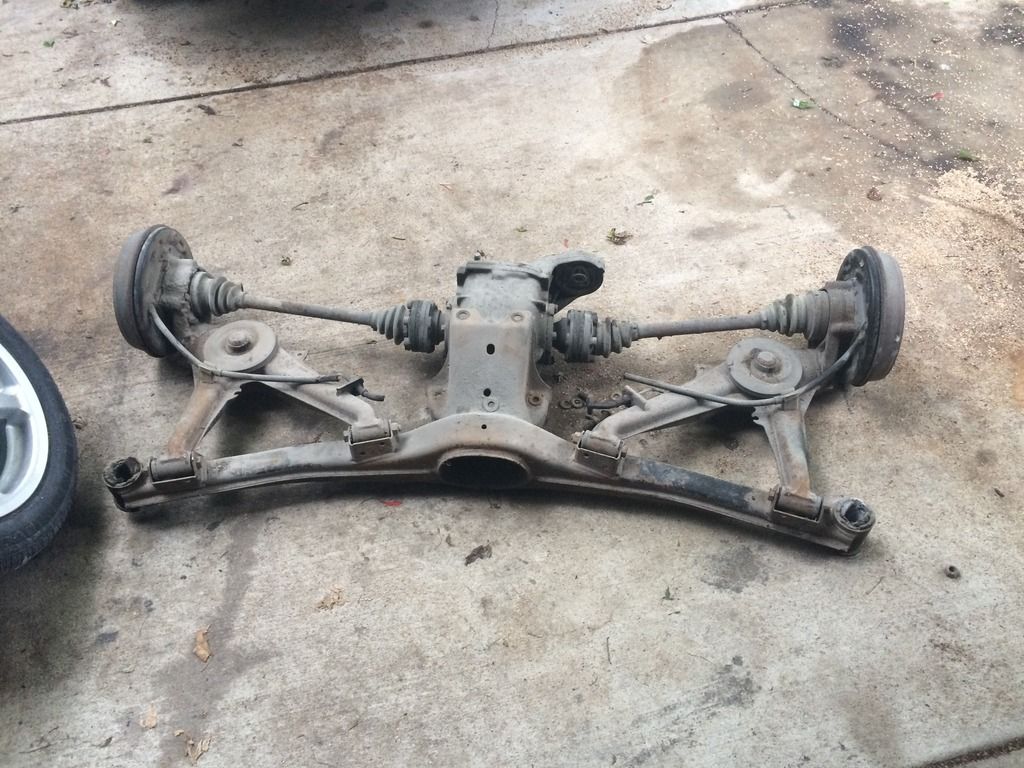

Today I finally dropped the rear subframe. :)

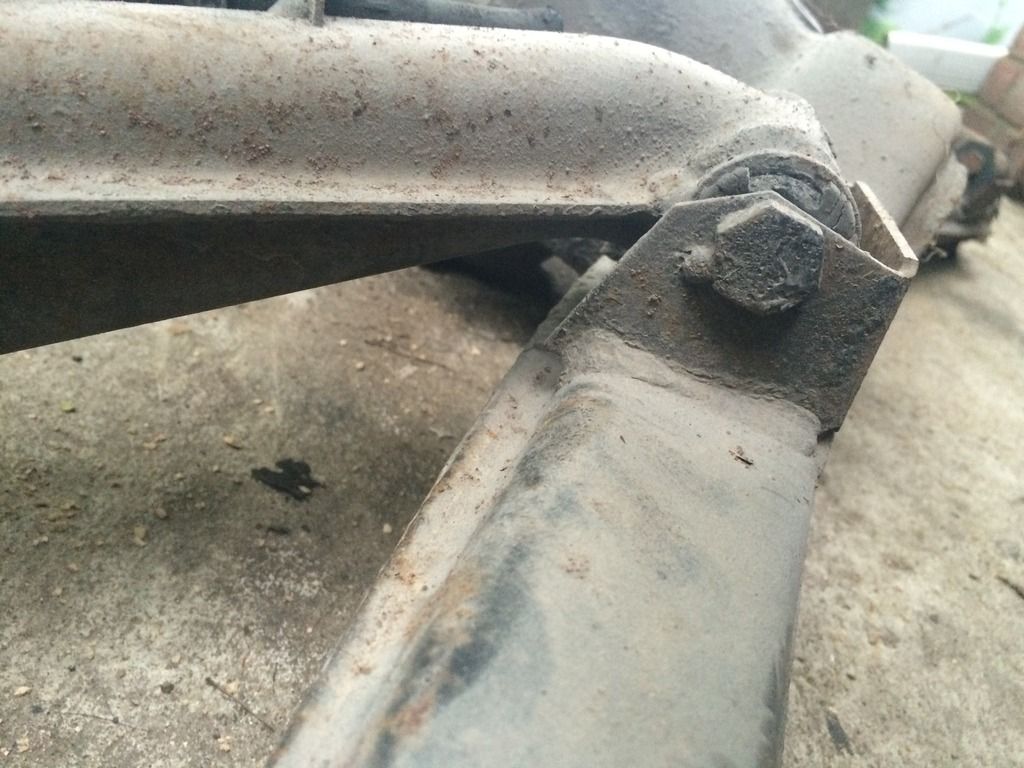

I started to look at it and noticed someone at sometime welded the nuts AND bolts for the trailing arms the bolts are tacked, the nuts how ever are welded out :hitler: the only way i cant think to save the subframe is to order eccentrics so they are on the way from Igor at CAtuned.
Once the subframe is sorted I will put it back up with the 2.93LSD, Koni adjustable shocks and ground control coils
I also finished all my undercoating and put my fenders back on with a new hood seal and did the trunk while I was at it. I hope to Reinforce my trailing arms tomorrow put the bushings in and get them prepped for install then its a matter of waiting on parts...

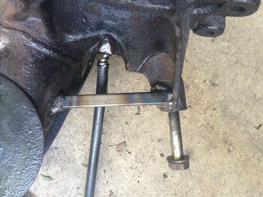

Today I spent most my time dismanteling the subframe and burning out the subframe bushings. Once the reinforcments get here I'll weld them on. I also Reinforced My trailing arms just cuase I felt like it haha. I waiting for some help so I can use the 20 Ton press to press the rtabs and sub bushing in.

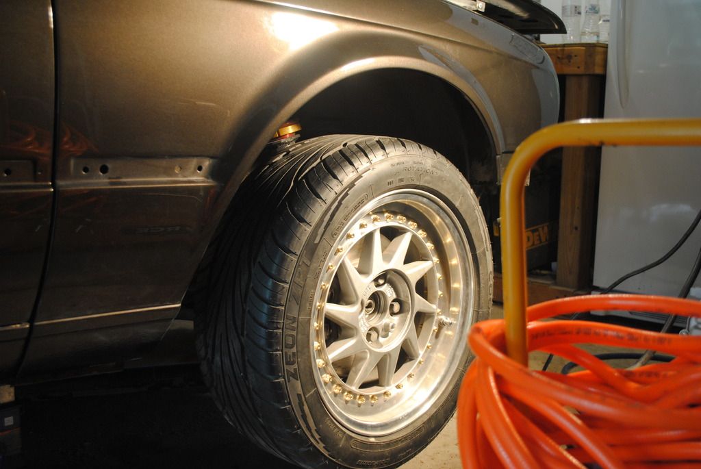

So I put my rear suspension on finally. I love the way it looks. Just one problem. For some reason I'm gangster leaned out. I got my springs seated and they are correct gc rear springs. They adjusters are level with each other but for some damn reason I'm stuck with this.

Fixed the gangsta lean by dumping the driver side spring adjuster. When I rolled car into the drive way some more it leveled out. Then when I dumped the adjuster it level out perfectly. From bottom of the wheel lip to fender lip is 21 1/4 inches on both side.
