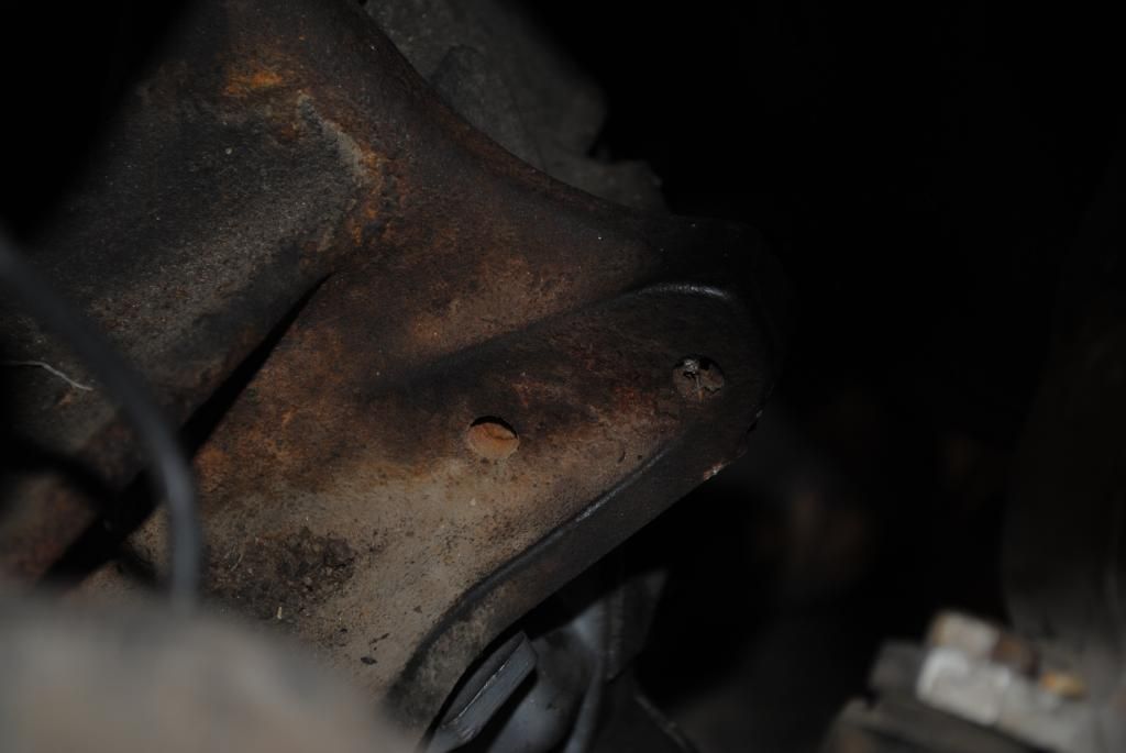

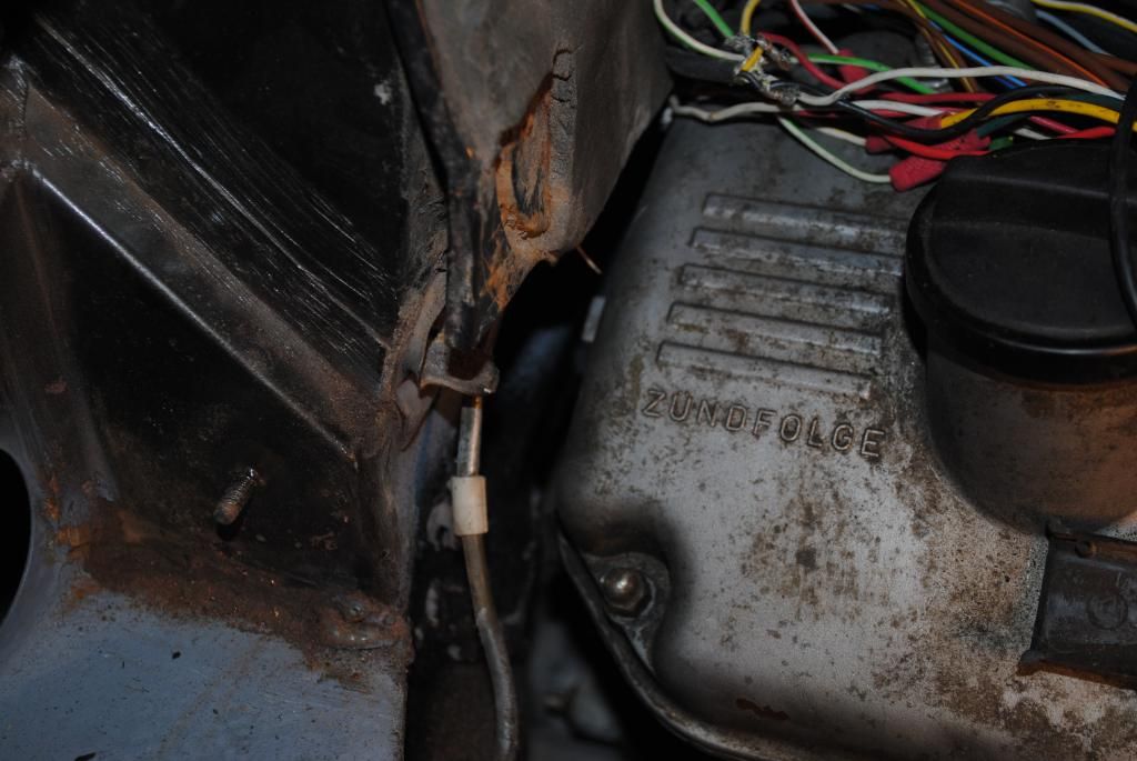

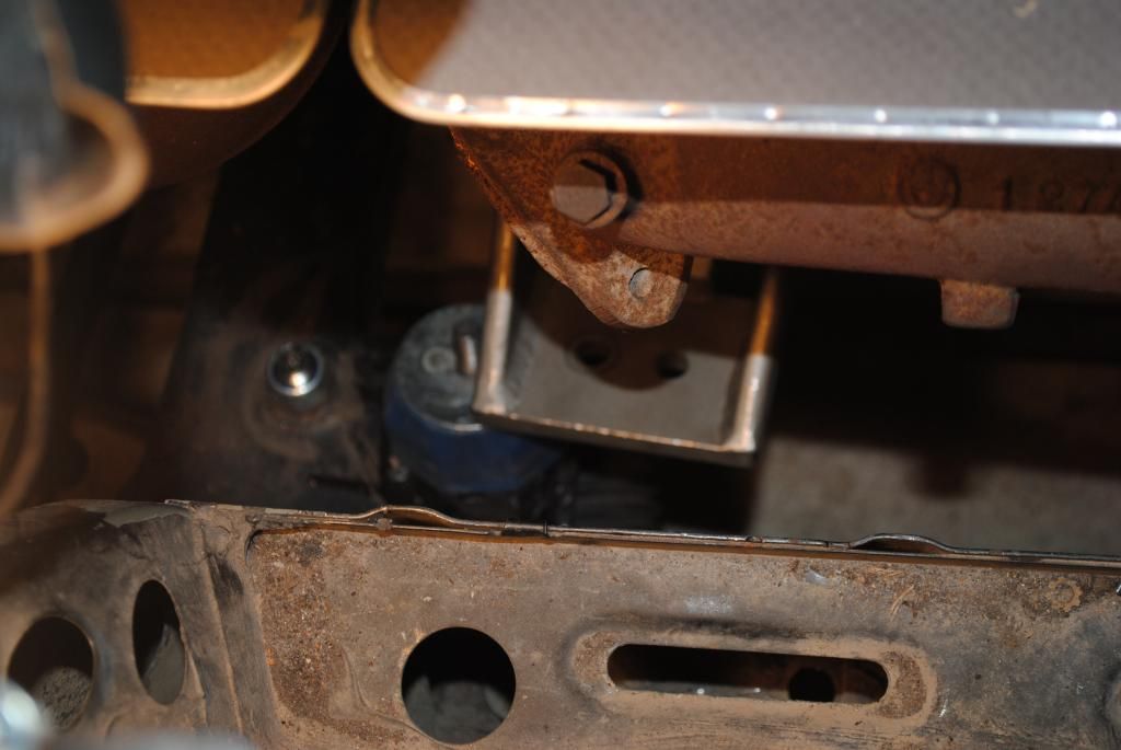

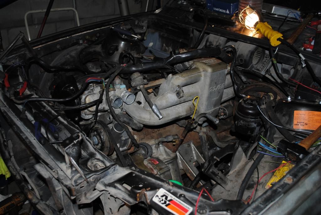

So today was attempt number one on dropping the motor in and it was an epic fail. Turns out to get a m30 to fit is euro spec cars you need to bang the firewall in about 5 spots not 1. I'll let the pics explain..
I'm as far back as i can get with out more firewall modification and still need to go back this much more....
Valve cover clearance

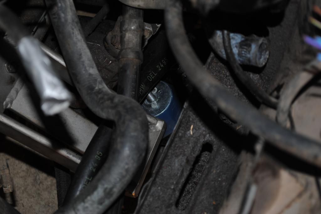

there looks like room to move back but there isnt because this stupid ass thing
it protrudes out about an inch past the block and tranny and it is part of the block the damn thing cant go back any further unless i bang my tranny well to allow it to go back. I ultimaley gave up for the night tomorrow I'm gonna bang the firewall more and try and get this bitch in idk why I'm struggling this motor swap has become the swap from hell i swear...

I'm in position two with the motor all way to the front. I just got done banging the floor wells and the firewall some more for clearance. Idk if anyone else with euro cars has done this but from what I'm gathering and how this motor is sitting I'll be able to run a fan clutch I'll have like 4 inch gap between my rad and motor. Rual take notes from me haha I bet you run into very similar problems with your 320i.
All e30 engine bays are the same euro and US as length.Projects Hartge,Alpina & AC Schnitzer Builds.http://www.r3vlimited.com/board/showthread.php?t=280601

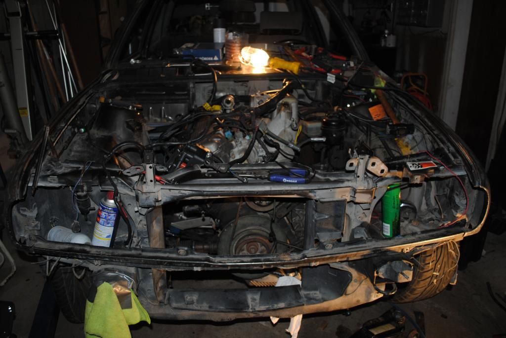

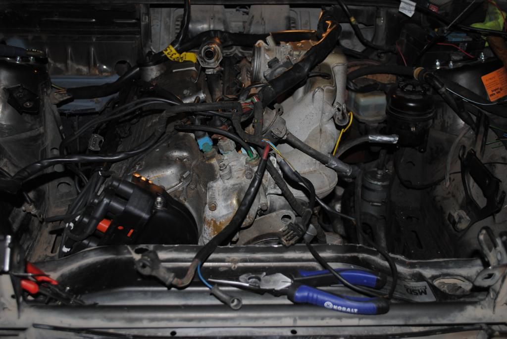

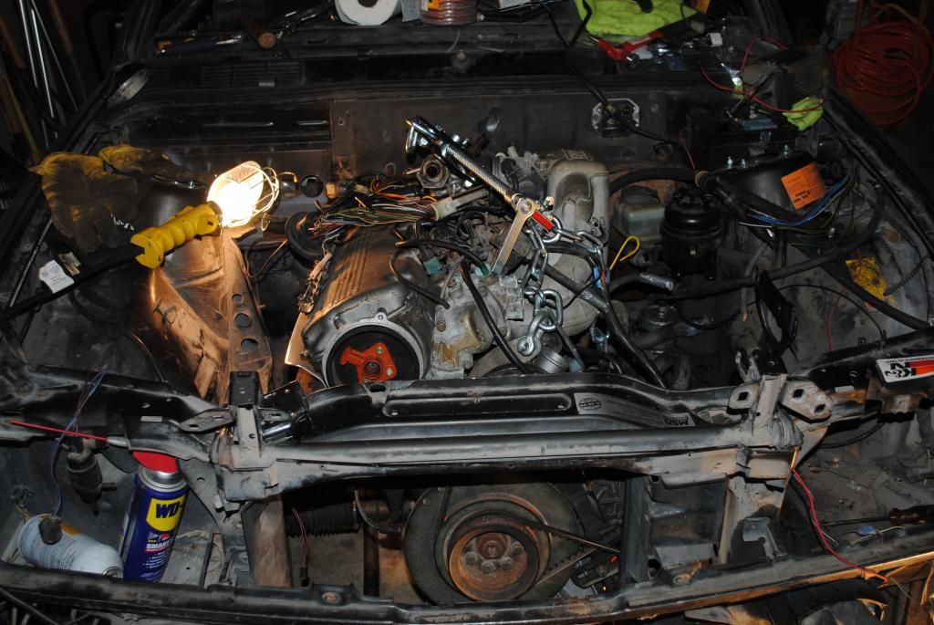

Update.
MOTOR IS IN!!!!
after much cussing kicking and screaming the motor is now in....
I do have to say that m30 looks damn good in the bay.... I got the old 1.1 motronic wiring harness taken off and started mapping out the late model harness i can tell its gonna be a headache. I need to find a bunch of m30b35 sensor to get the harness to connect rightGot the radiator mounts in to fit the mishimoto. I'm have troubles getting the tranny to sit on its mount its seem to want to sit cockeyed in the tranny well. also waiting for shifter assembly to get in from my man Steve at blunttech so i can get that fitted and assembled. Since the motor is in my dad is gonna start the sanding and doing the bondo work since I hate it and hes good at it should be ready for primer by the end of july.
