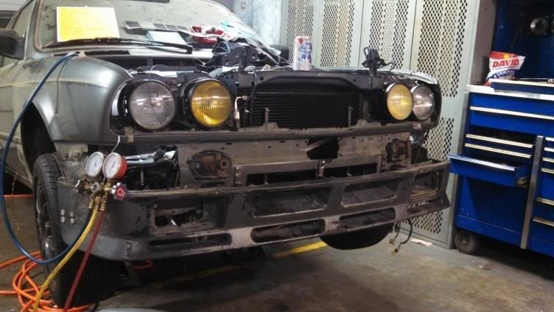

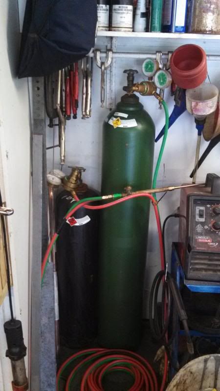

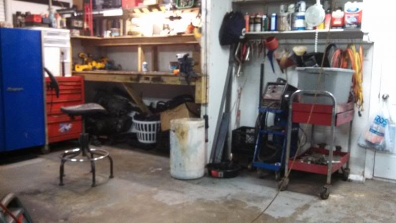

                    Finally got a chance to work on the car again. Been busy at work jumping out of airplanes, lol. 2 late nights in a row. Put the a/c system under a vacuum and found it has a slight leak. Very slow, I may have to charge and run with dye to find it. I have a feeling its my terrible welding on the low side futtng on the compressor. I ciukdbt get it air tight with flux core wire. Cleaned up my garage for 3 days on and off. I really let it go.

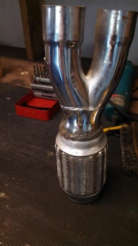

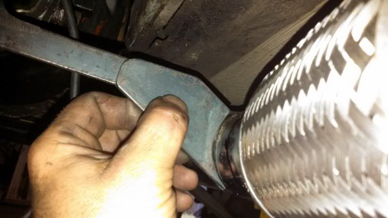

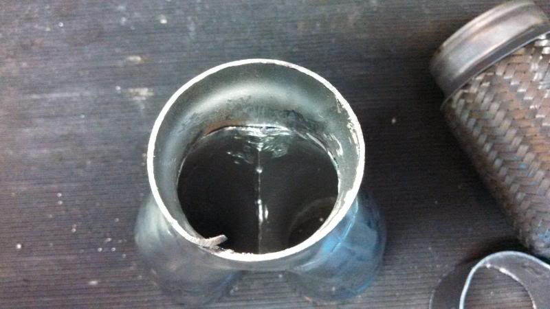

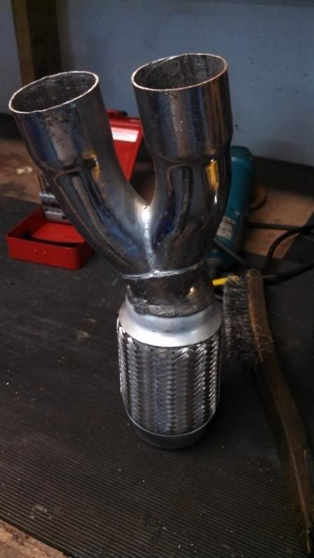

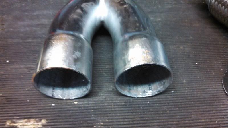

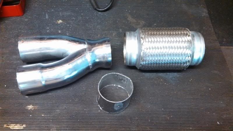

                            new addition to the shop
                            start with a shitty pilot/autozone exhaust tip. Flip it over and.....BAM, a 2-1 merge collector
                            cleaned it up a bit
                            add a flex joint

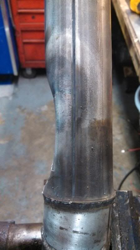

                            had to make the first bend to make the 2 runners parallel. made the second bend to make them equal height after it has installed, no pics of that sorry
                            Had to make a squisher jig
                            here is a mandrel bent 2.5" exhaust

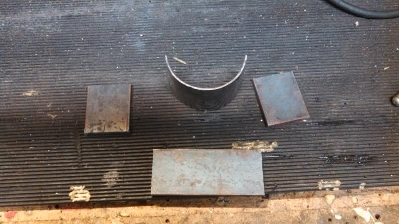

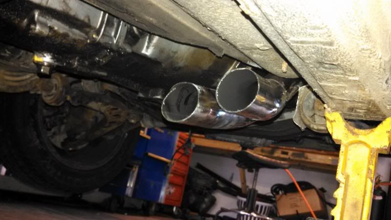

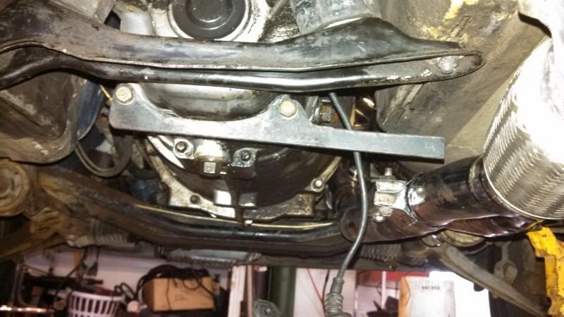

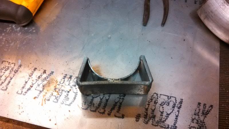

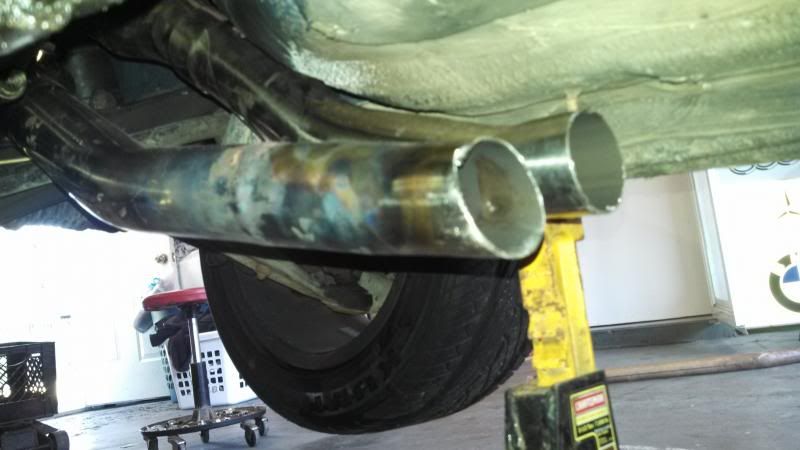

                              #44
                              got the header supported, o2 bung installed, clamps tightened up. i also painted the exhaust. it will be ready for the ground after i re-bleed the clutch. i can say that a flowmaster 40 is way too loud. even with the resonator. i need to get a new muffler. i would like another offset inlet, any suggestions?
