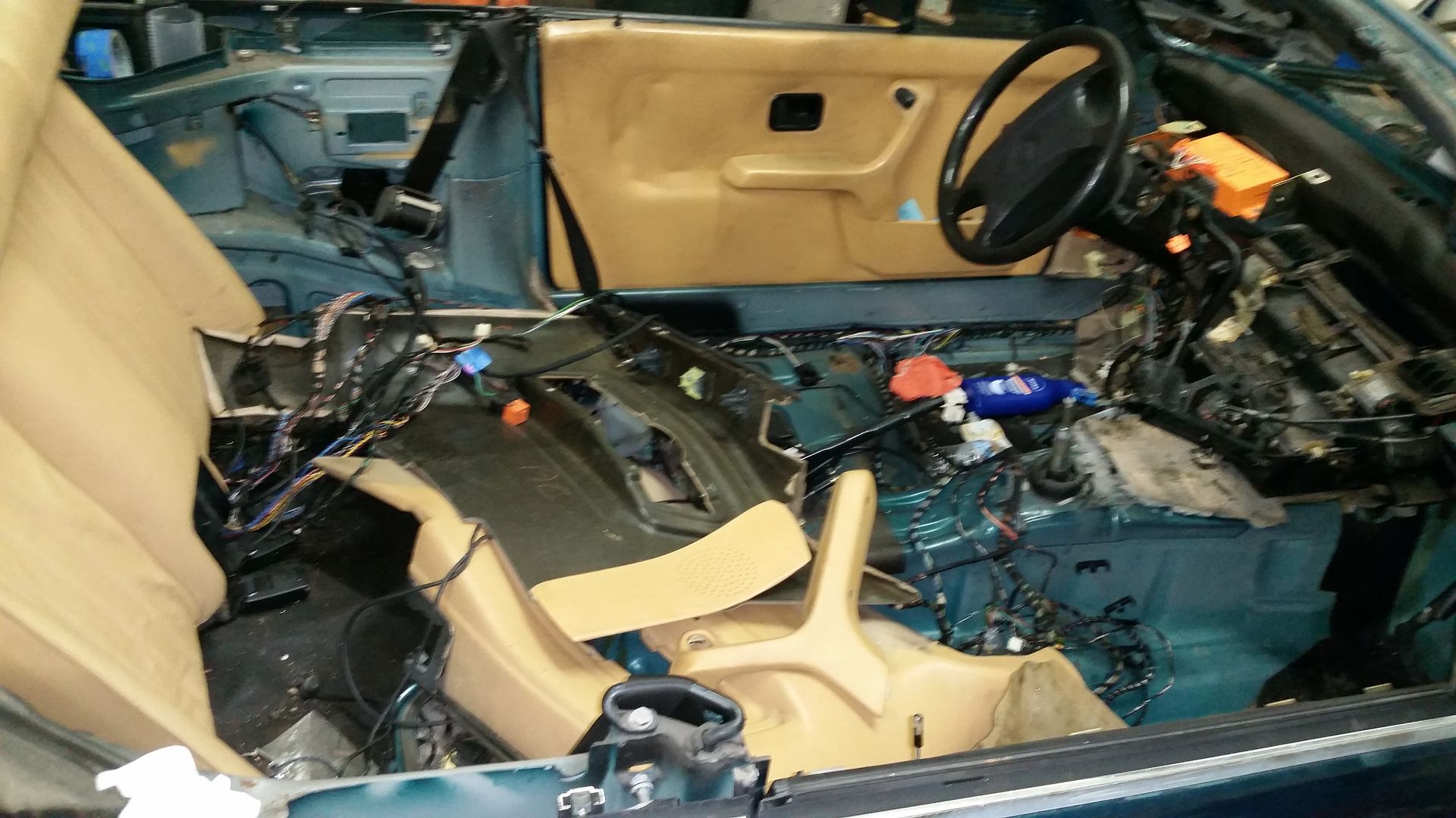

      If all goes well I will be getting this parts car tomorrow. Sadly, I think it is in better starting shape than the current project but I don't want/need to take on another project at this time.
      Not sure what I will do with it. The short list of parts to pull/save for the current project or as spares are:
      • Any interior parts
      • Rear window assembly/regulators
      • Both front doors
      • Both front fenders (one bent)
      • Rear subframe
      • Front strut tubes
      • Wheels, tires, spare
      • Top frame/cover
      • Cluster
      • Axles
      • Fender liners
      • Brake lights
      • Trunk liner parts
      • Battery
      • Antenna cable
      • Seat belts
      • Door panels
      • Blower motor
      • CAB brackets, control arms
      Other parts that I don't want to send to the scrapper:
      • Brakes
      • Pedal Set
      • Bumper brackets/sliders
      • DME
      • Mirrors
      • Exterior trim
      • 3rd brake light
      Tentatively trading the driveline, motor, trans to irish44j for some parts he has for me.
      What else is worth keeping?

        Pull the wiring harness and keep it intact.

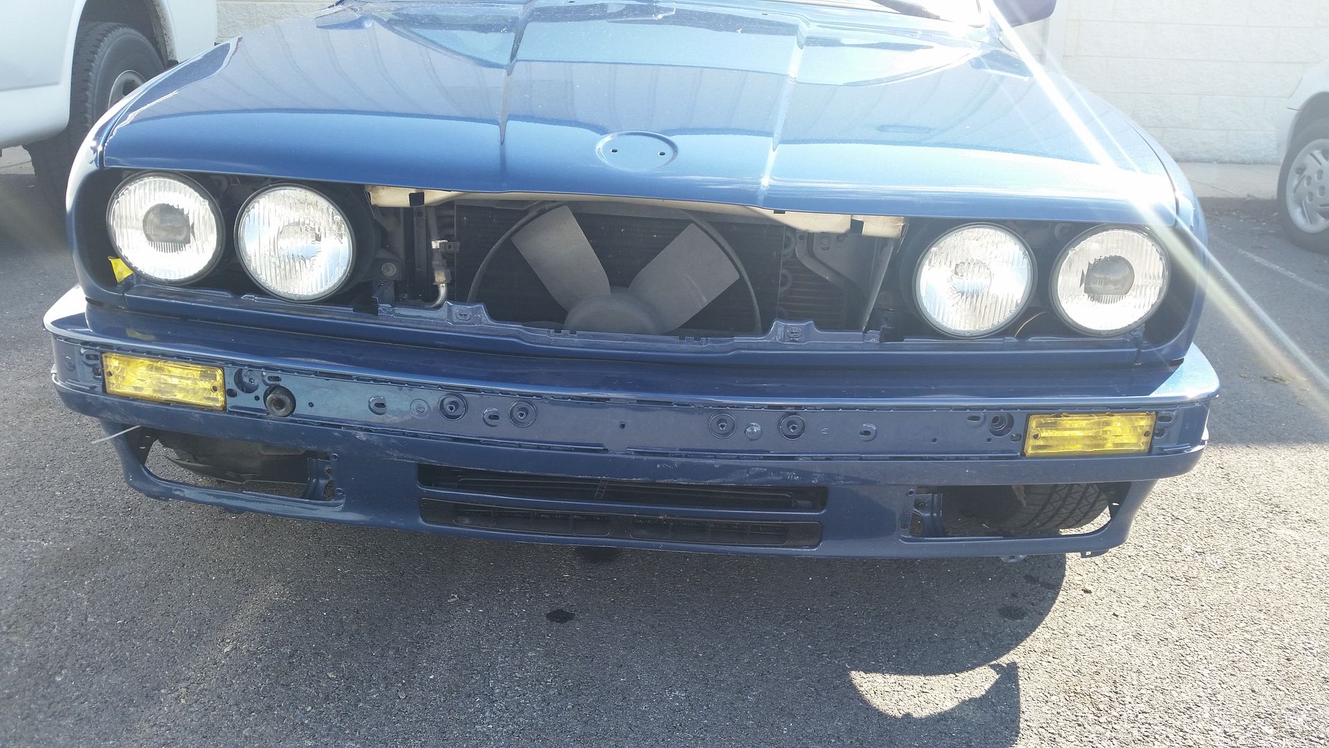

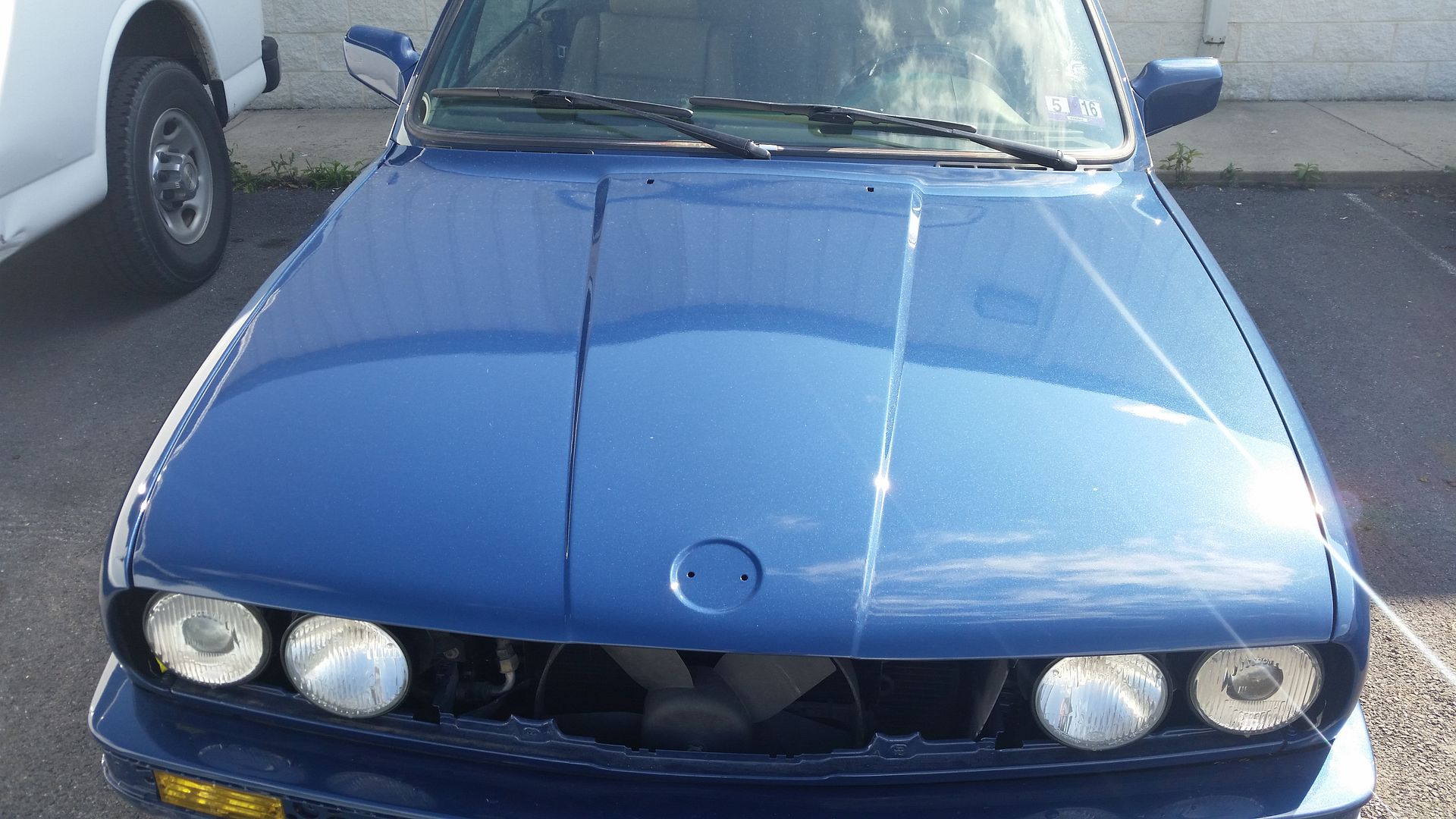

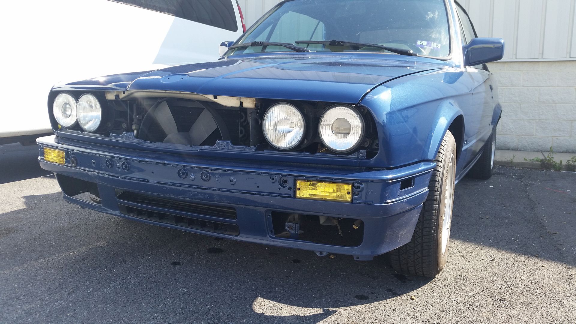

          Stopped by the body shop (day 20) and checked progress. Still a few things to do but the new hood is on and painted:
          Patrick Henry

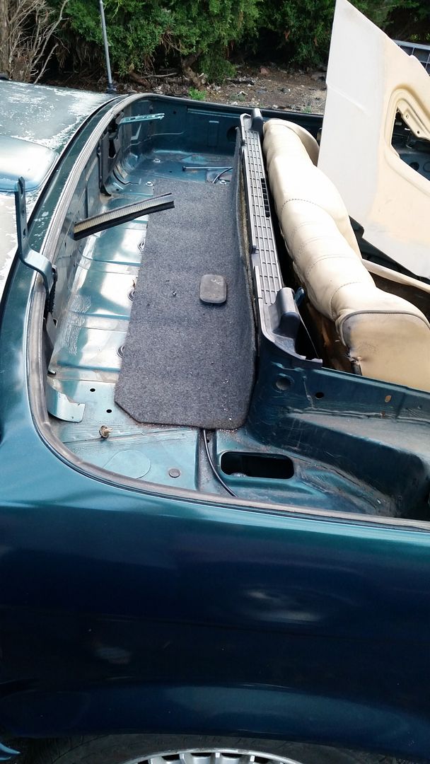

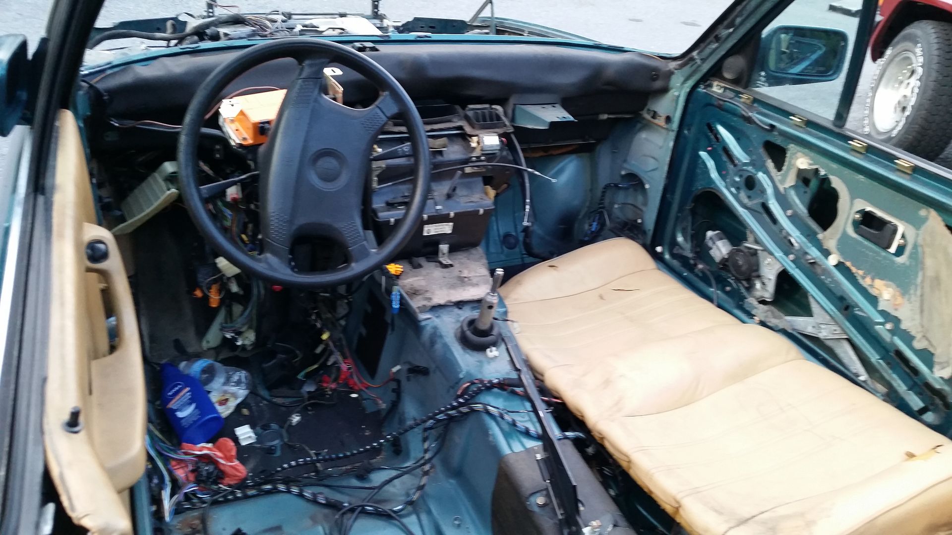

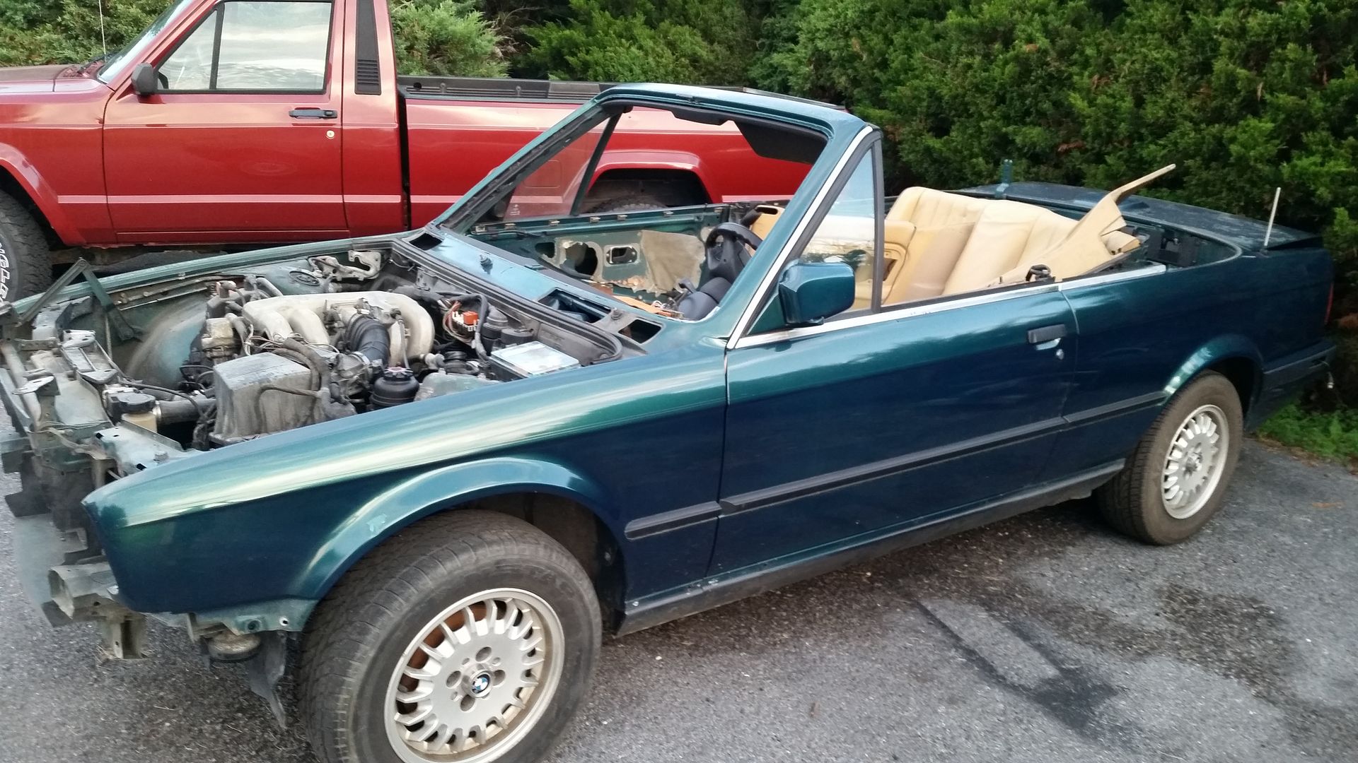

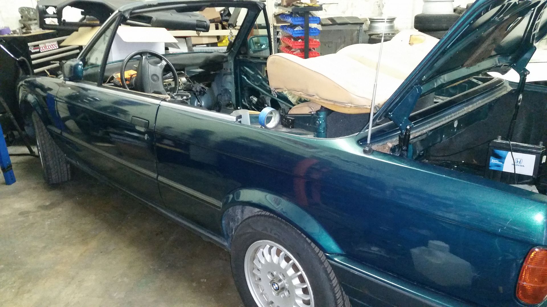

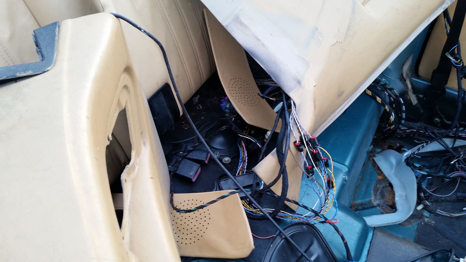

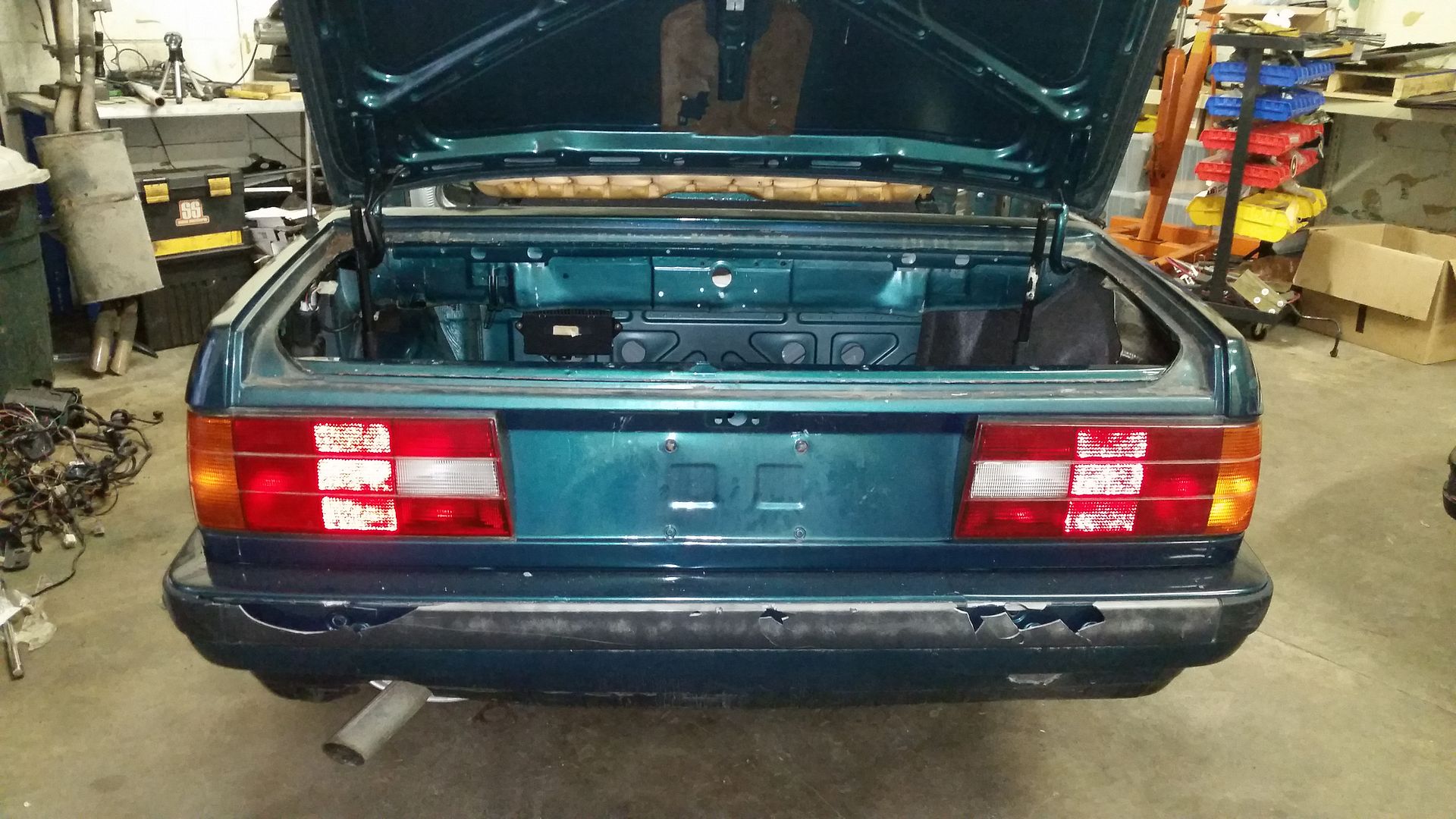

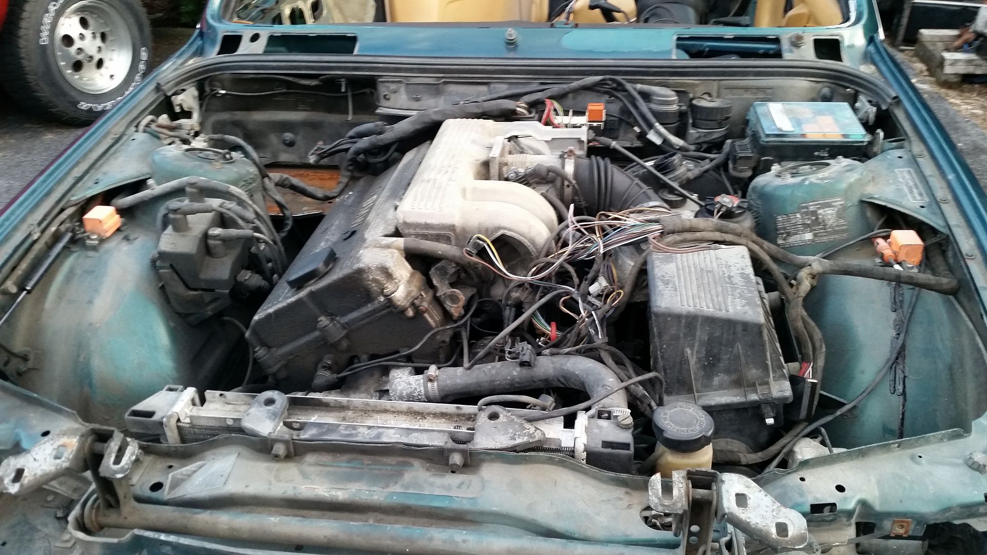

            Parts car arrived!
            Trunk is also full of other parts, which I have not yet searched. He arrived late last night and I had to get my kids to bed so I tarped it and will look through it later this week/weekend.
            Patrick Henry

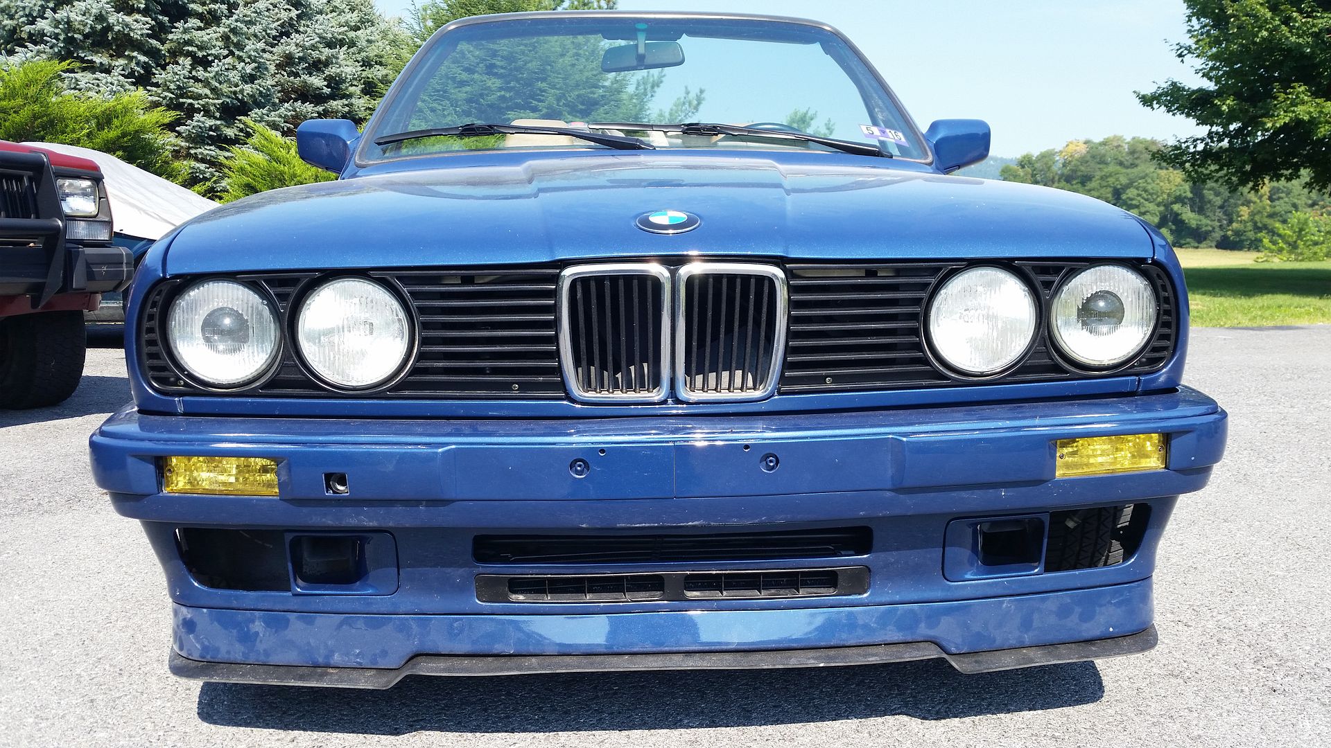

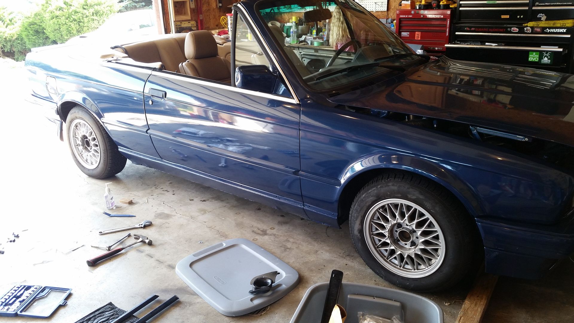

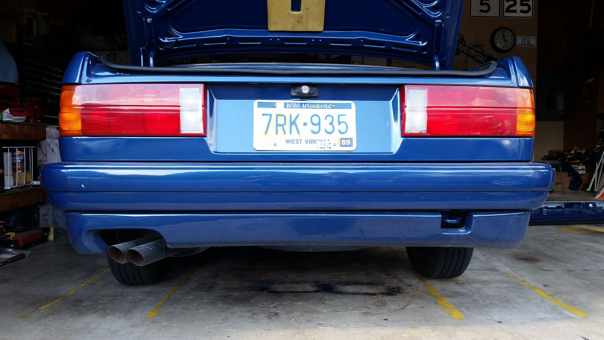

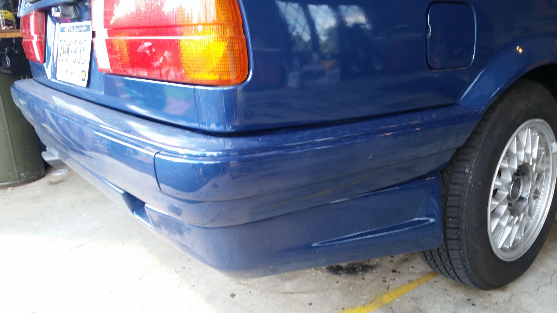

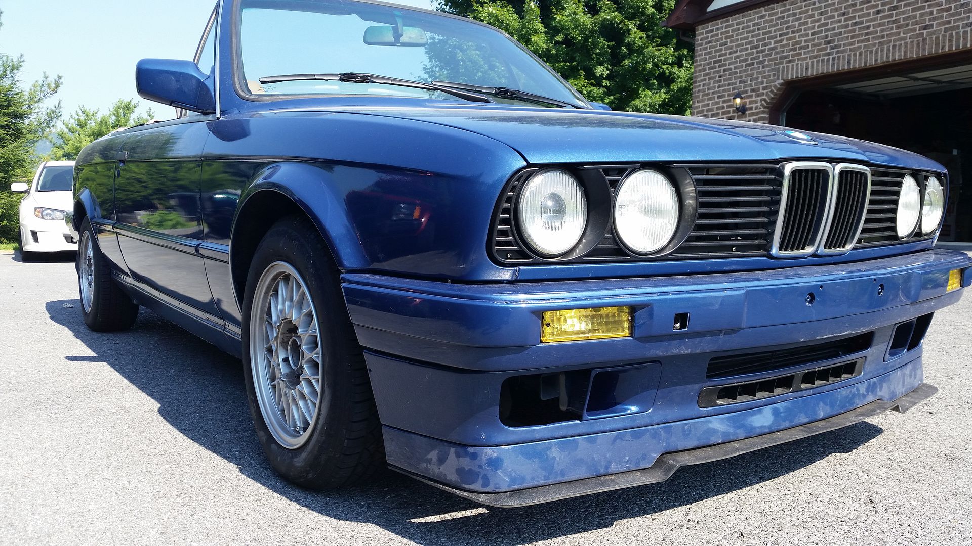

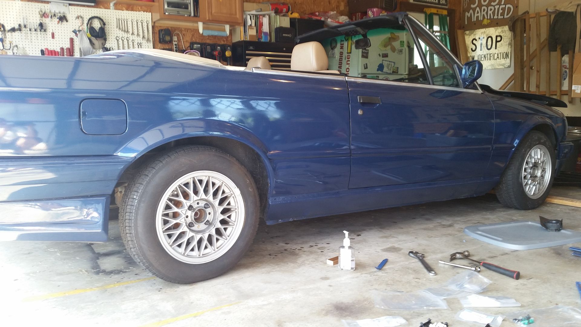

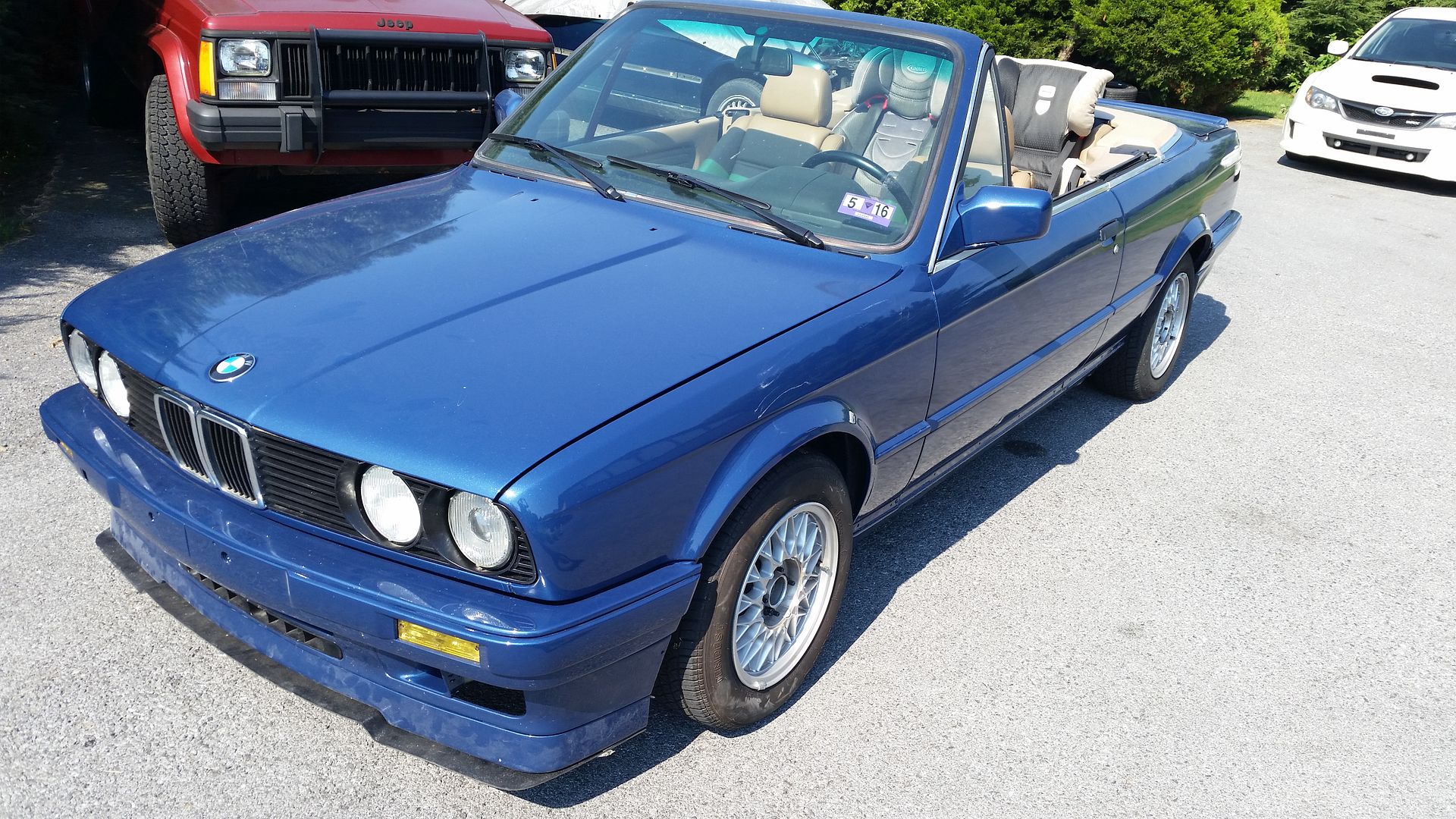

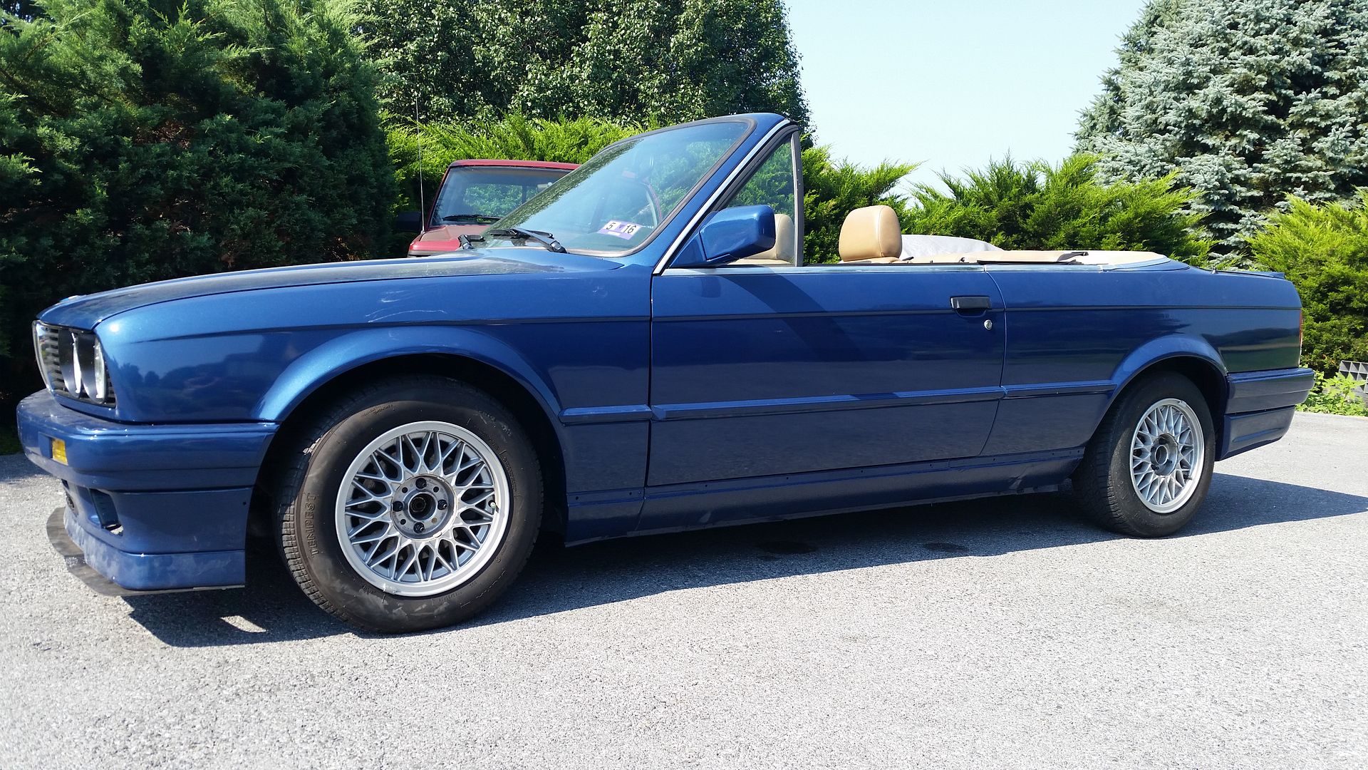

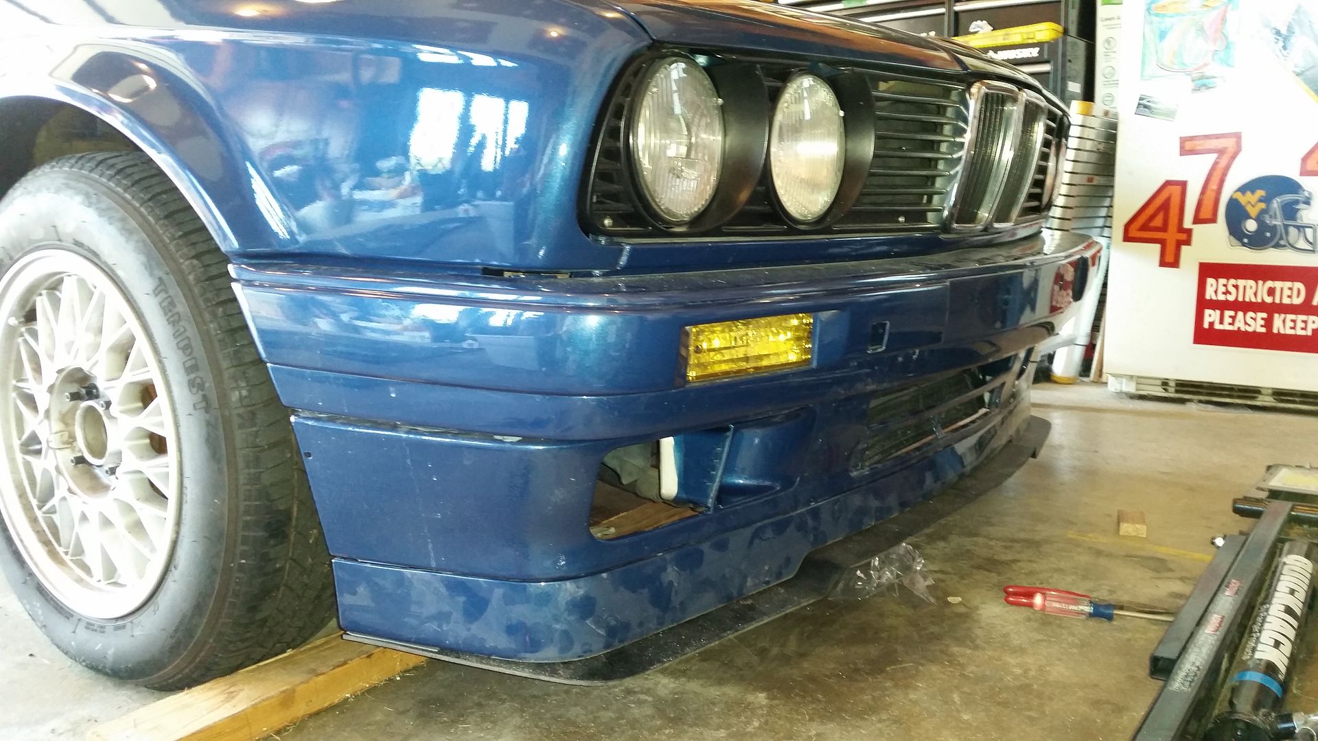

                                So some good news and some bad news- I got the car back from paint but it still is not right. What was to be a 10-day job to fix a documented list of 10 items took 24 days and 3 were still not done. I checked the car Monday and it was down to 4 items. I called Thursday and it was (supposedly) down to 2 items. I called Friday (I was out of town) and I was told that it was finished. I had my wife drop me off Saturday and 2 items were still undone. I am so tired of NOT being able to drive the car (and I had no other ride) so I took the car and will speak to the owner upon his return from vacation. I did not sign anything saying it was done so I have some element of protection.
                                The good news side of things is that I got to do some reassembly. Overall the car is looking good but still has some work to be done.

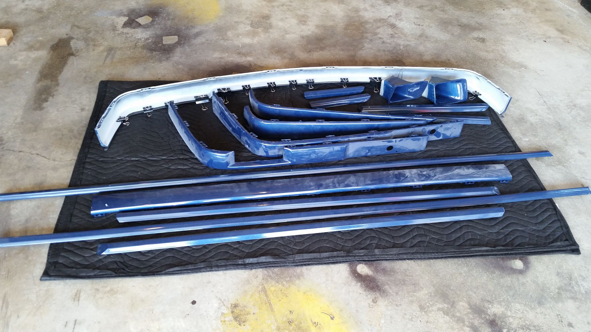

                                Parts ready for install:

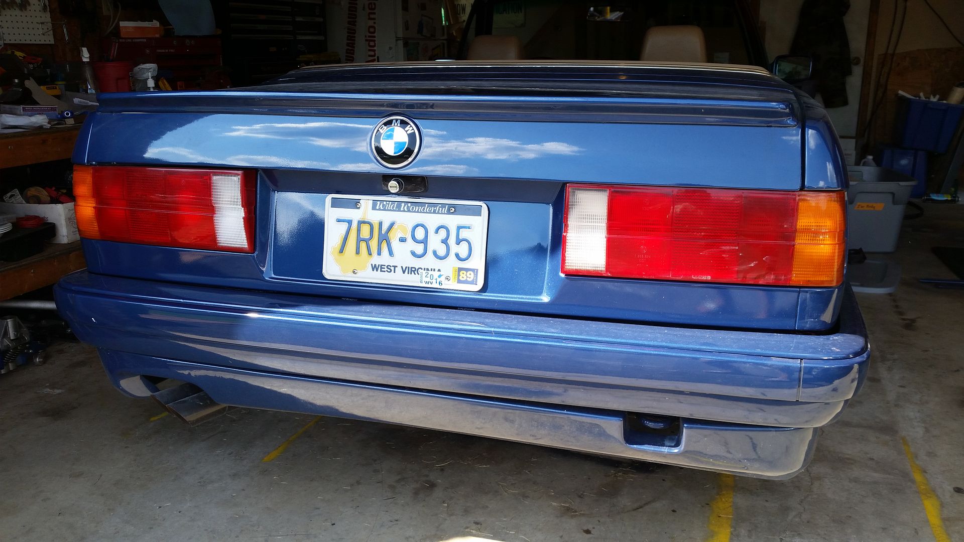

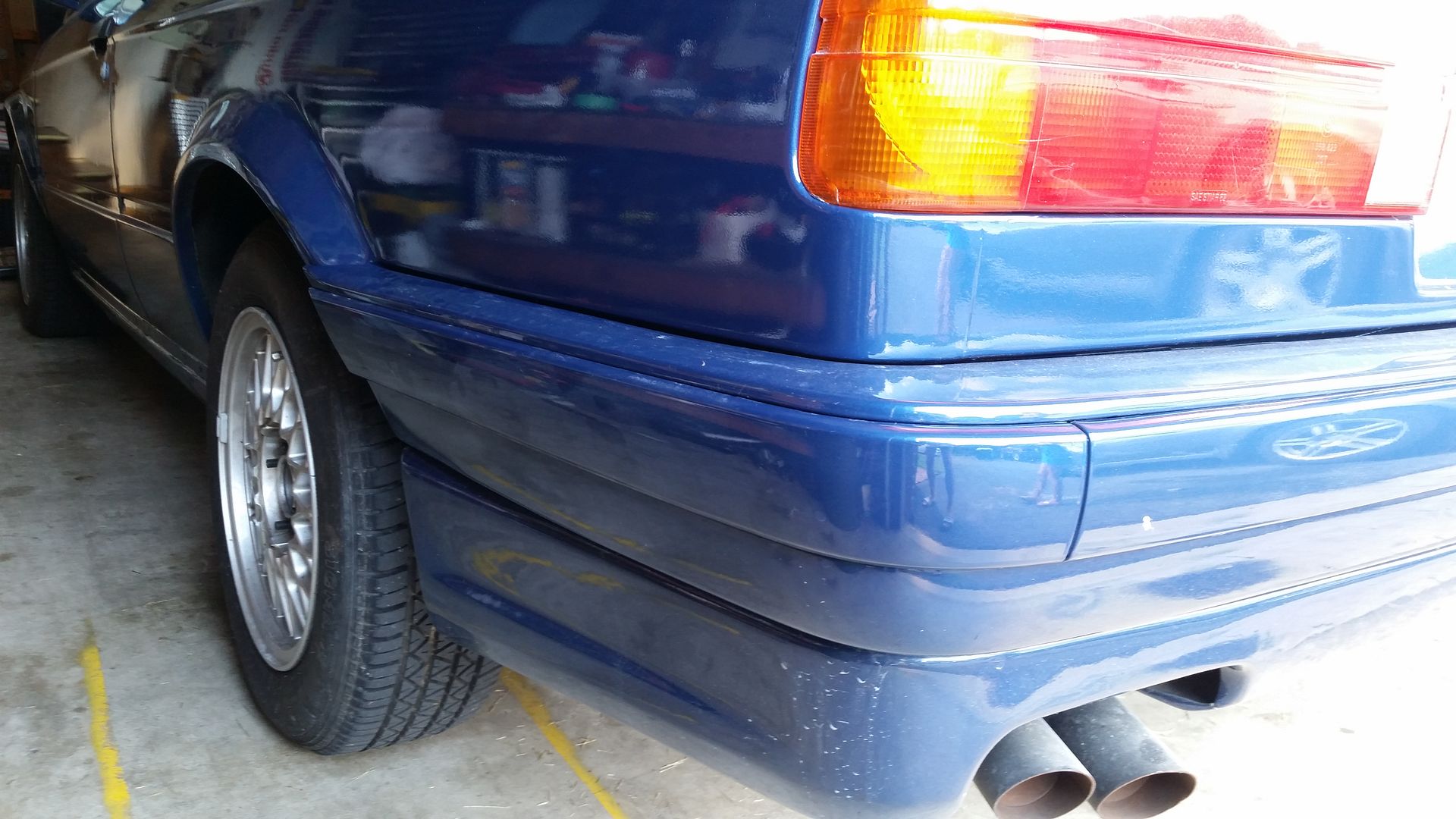

                                Rear trim installed:
                                And with Roundel:

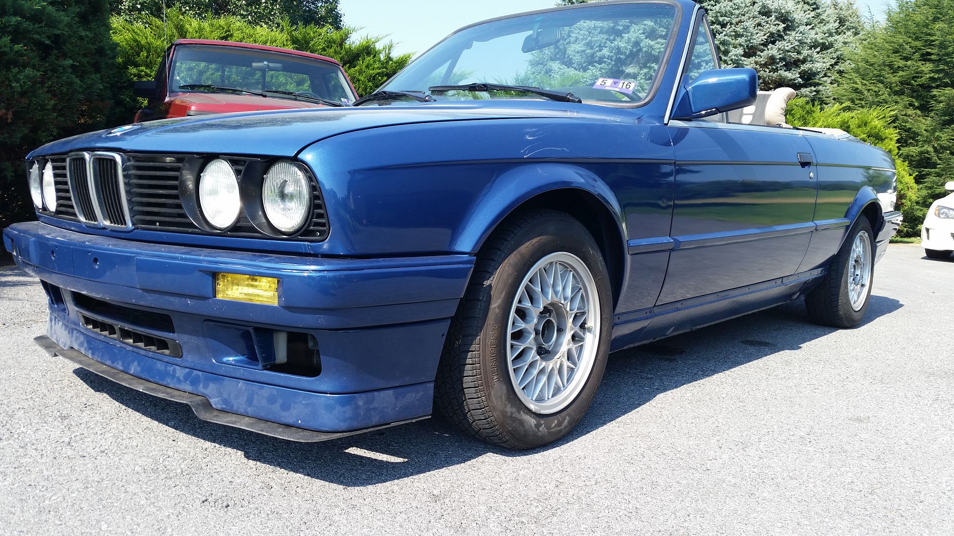

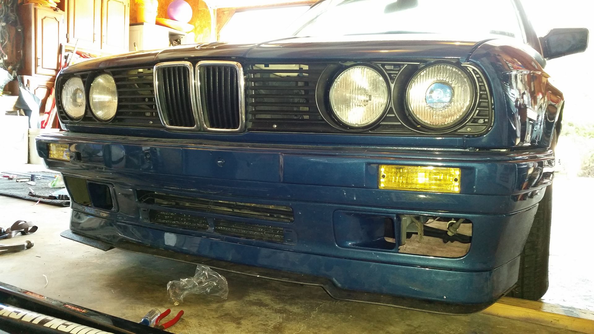

                                Front trim installed:
                                Side "waist" trim installed:

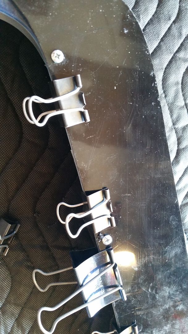

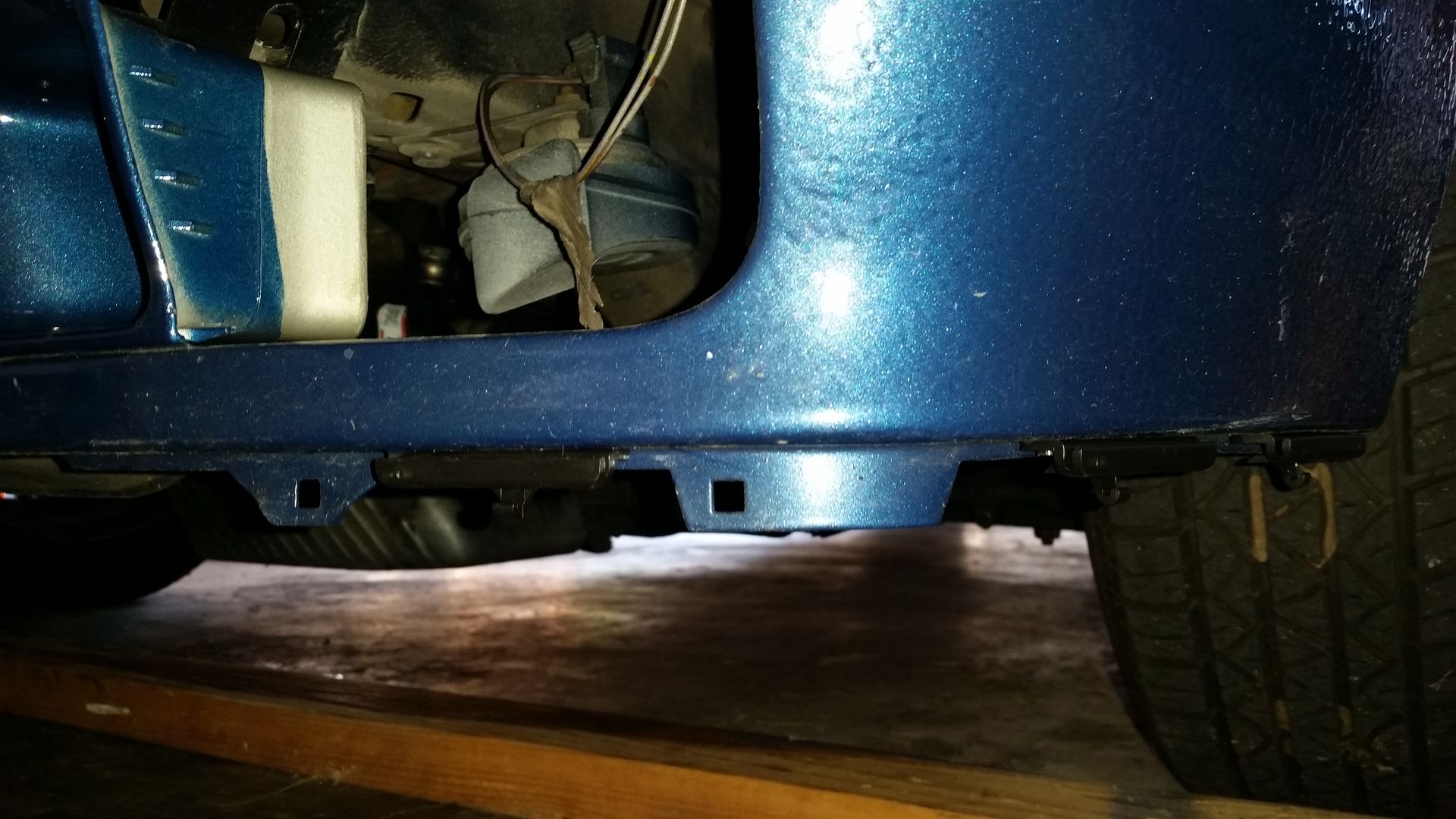

                                RyanG Splitter alignment:
                                DO NOT install the clips this way. it is BACKWARDS!
                                Now turned around and with the "is" lip and RyanG splitter installed:

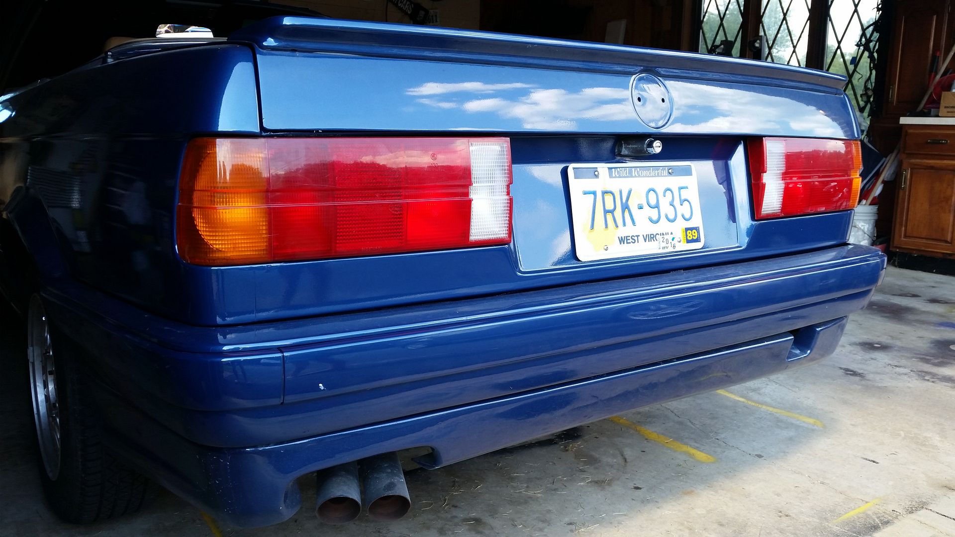

                                A few other shots:

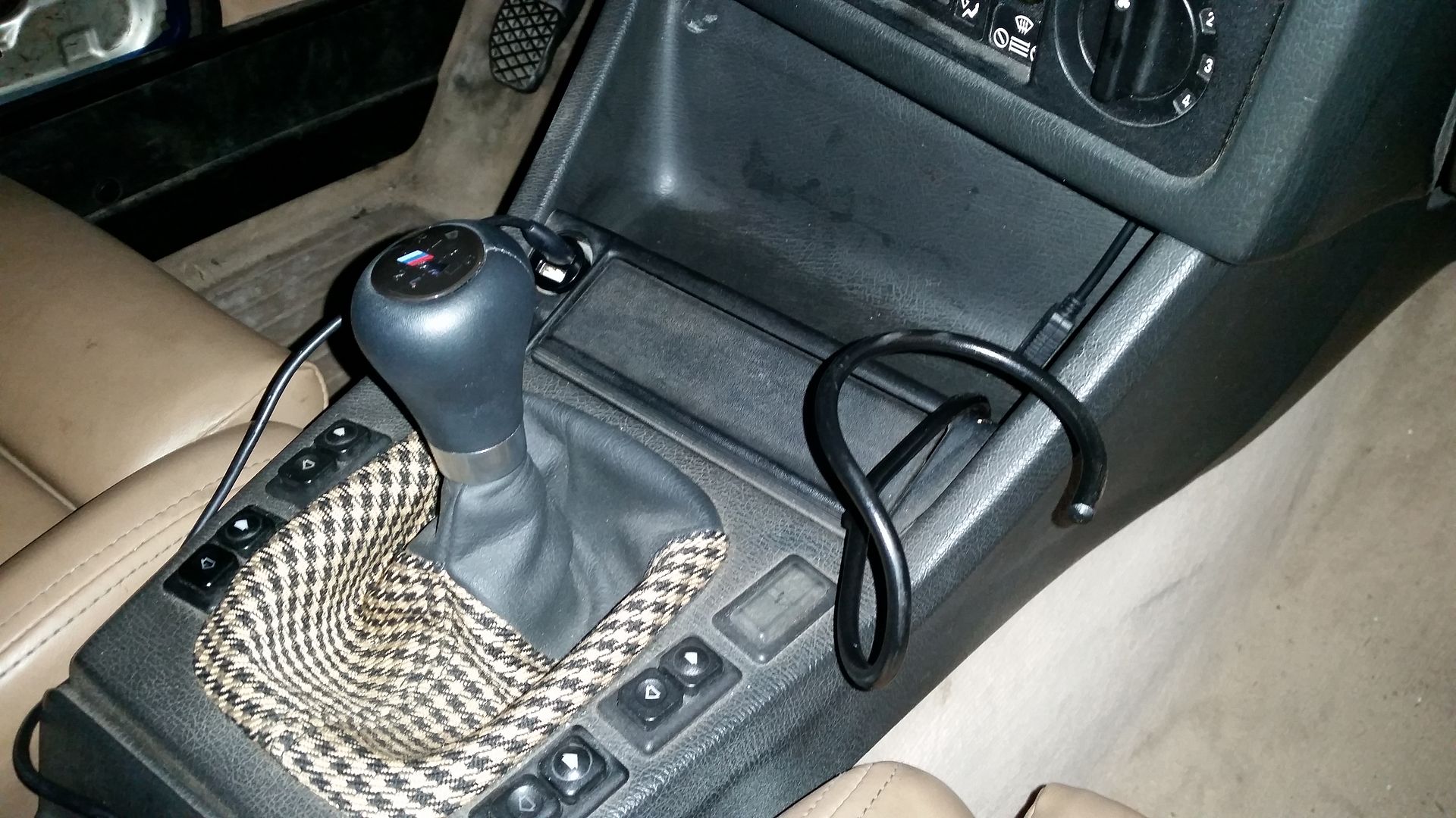

                                I installed the cupholder from a few pages back. It required a little bending but it did fit. I still have the console cupholders as well but this is a nice one for easy reach.

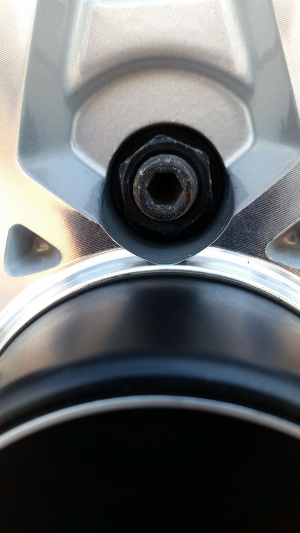

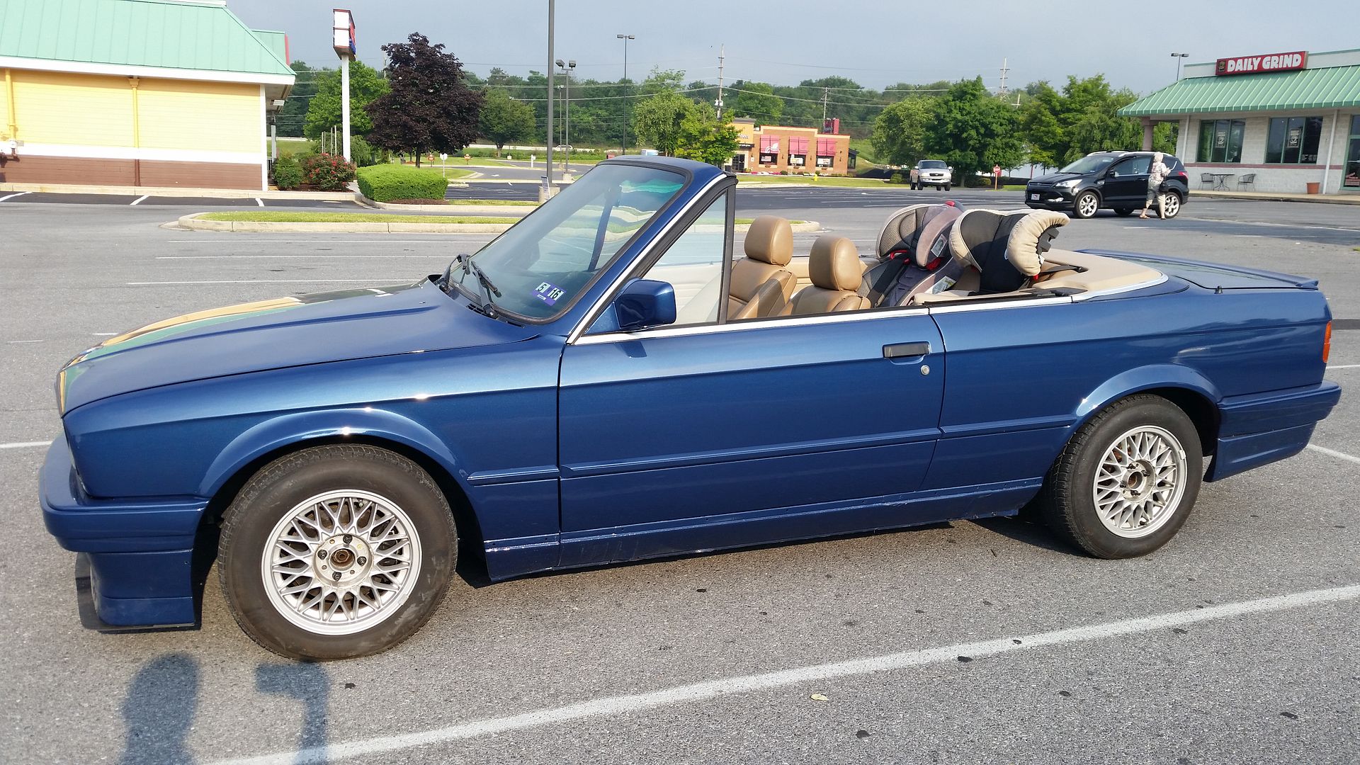

                                A little more bad news: The Drag DR-20 do NOT fit on the e30. The 10mm offset puts it at the reasonable limit of what will fit with 205-55-15 tires and without fender work (at least when lowered on H&R Sport). I was so pissed/dismayed I forgot to even take pictures. They looked great but if they don't fit then it is all wasted.
                                First off, I had issues fitting the Motorsport Hardware lugnuts on the wheels because of the small lug valleys. I have some Gorilla tuner lugs "came with the wheels" but I like the wheel studs.
                                I finally found a very thin-walled 17mm socket but then...the wheel spokes rub on the calipers in the front so it looks like I am back to the drawing board for wheels.
                                I ordered a set of 15x8 ET20 last week (they arrive this Friday) but I don't know how to handle the wheel fit issue, particularly since I had planned on the Drags with A/S Kumhos being my "winter" setup (I also have the WRX and a Jeep) and the other set of wheels with the Yokohama S.Drive as my summer setup. With the Kumhos being so cheap ($65 for all 4) it is hard to not keep them (the Yokohamas were ~$400) and return the Yokohamas and the Drags but since the Kumhos are already mounted I need to call Discount Tire Direct to see how they want to handle it.
