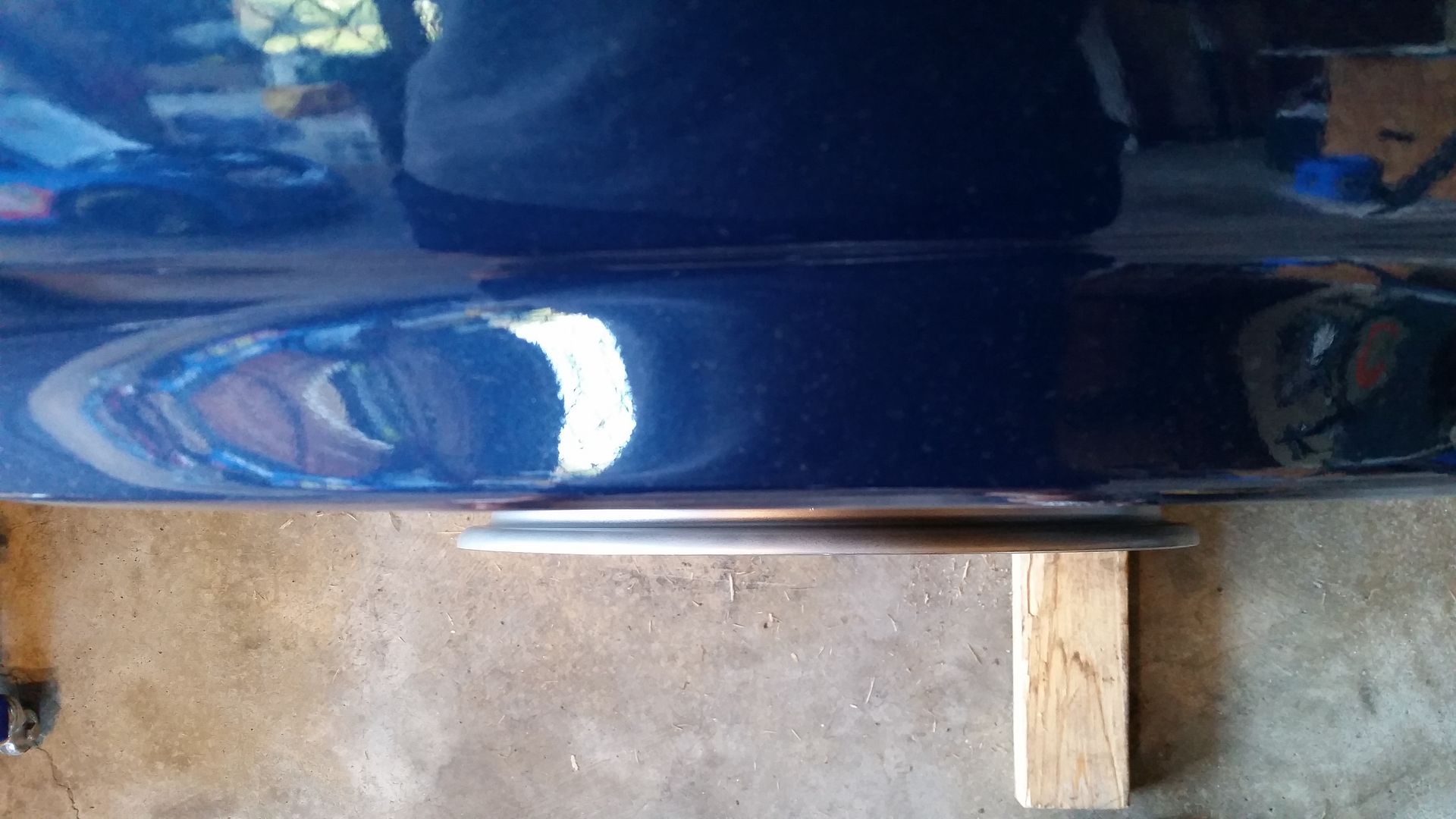

    Related, while I was working on the assembly my daughter decided to take one of the old Roundels and do this:

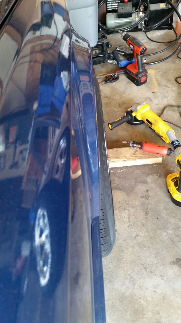

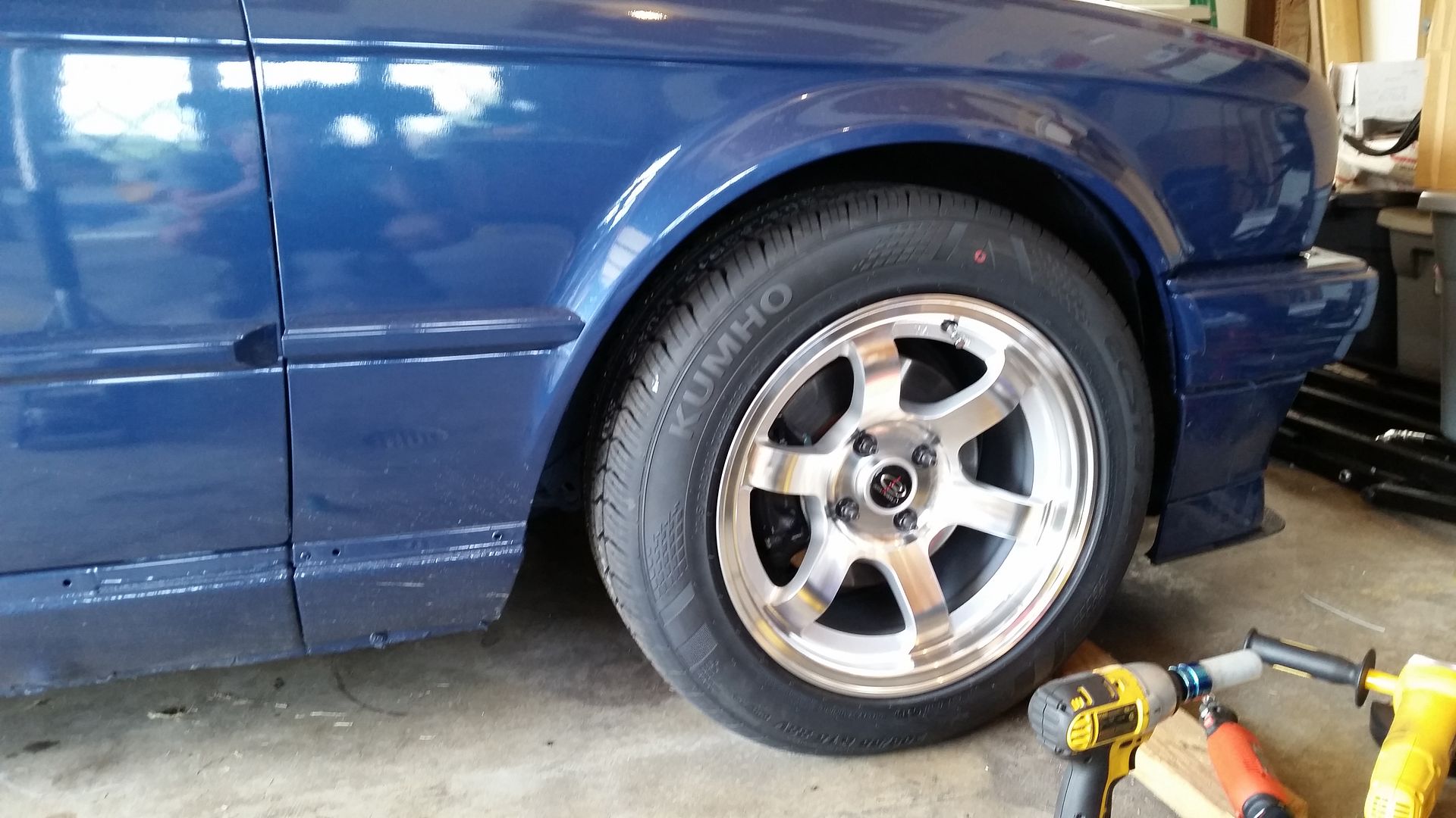

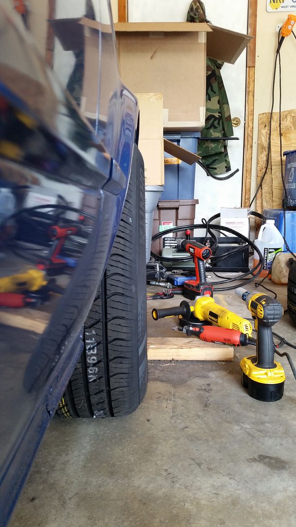

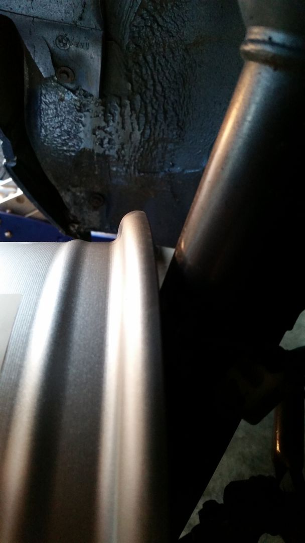

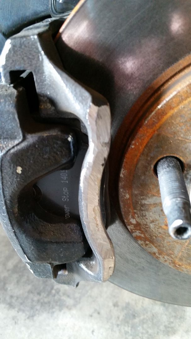

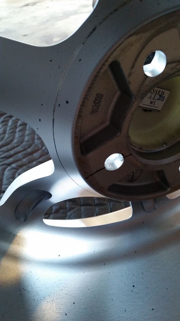

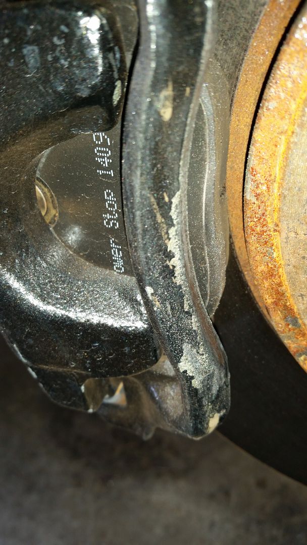

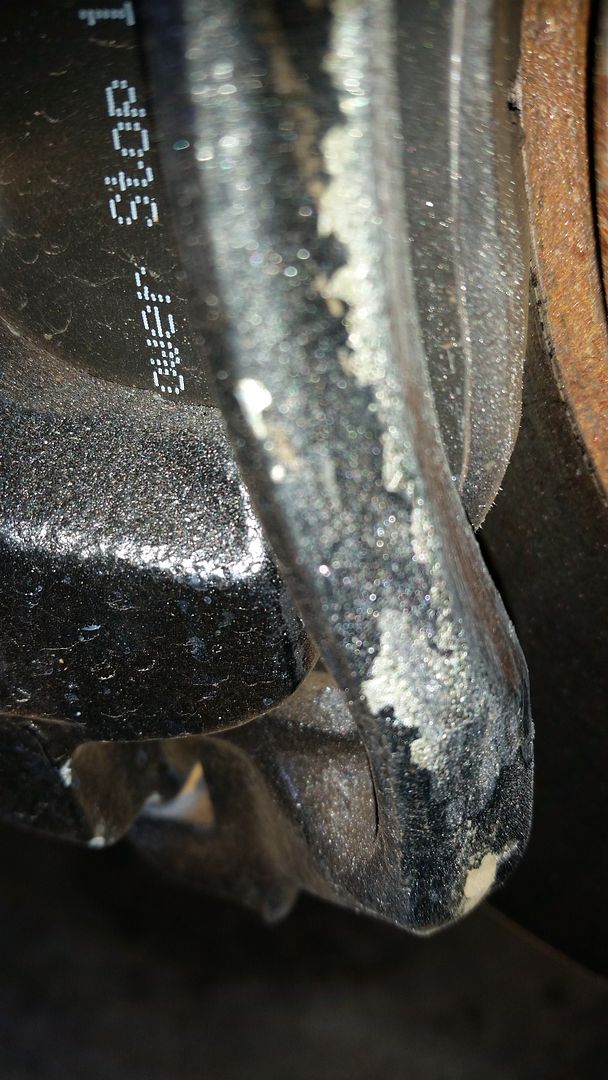

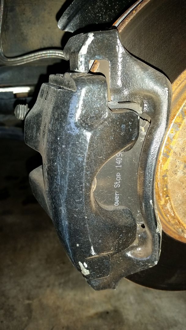

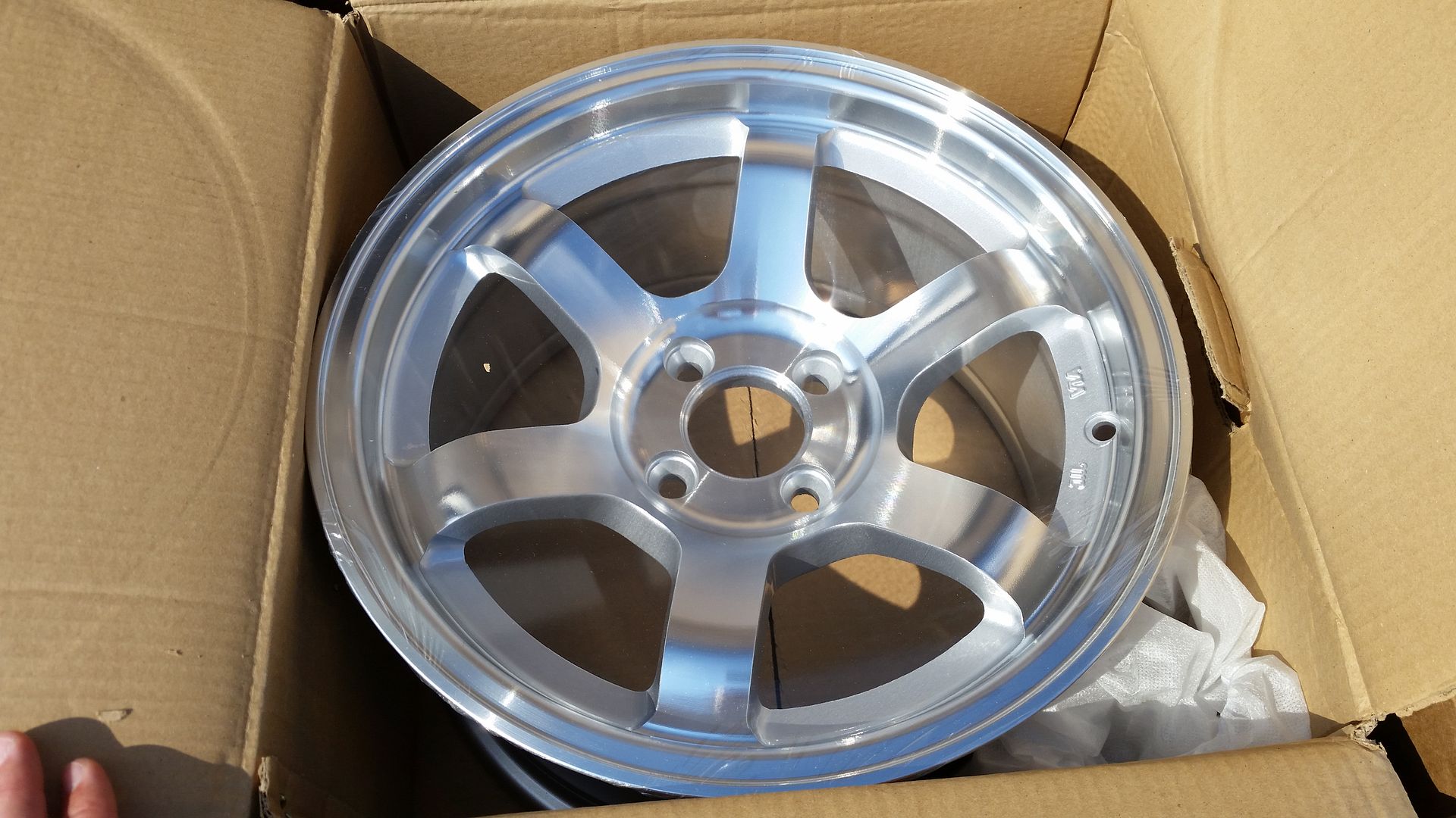

                  So the wheel situation has finally moved forward. After the Drag DR-20 wheels rubbed on the caliper body I decided to abandon the summer/winter setup (whoich woudl have only neen A/S for winter anyway) and to just do A/S on a single set of wheels. This is partially because my A/S tires were $65 for the set and the summers were $475.
                  So Discount Tire was willing to take back the Drags and my summer tires, since it was their mistake.
                  I ordered some new 15x8 Rota Grid Concave wheels as my year-round wheels. I have always like the Grid design (Rays ripoff) but so many Subaru guys run them that I never put them on my WRX. And the 15" Grids never looked good- too flat. But the new Grid Concave has a better "dish" look, so I went with them for the e30.

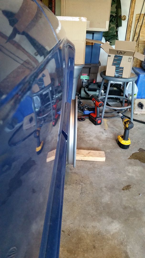

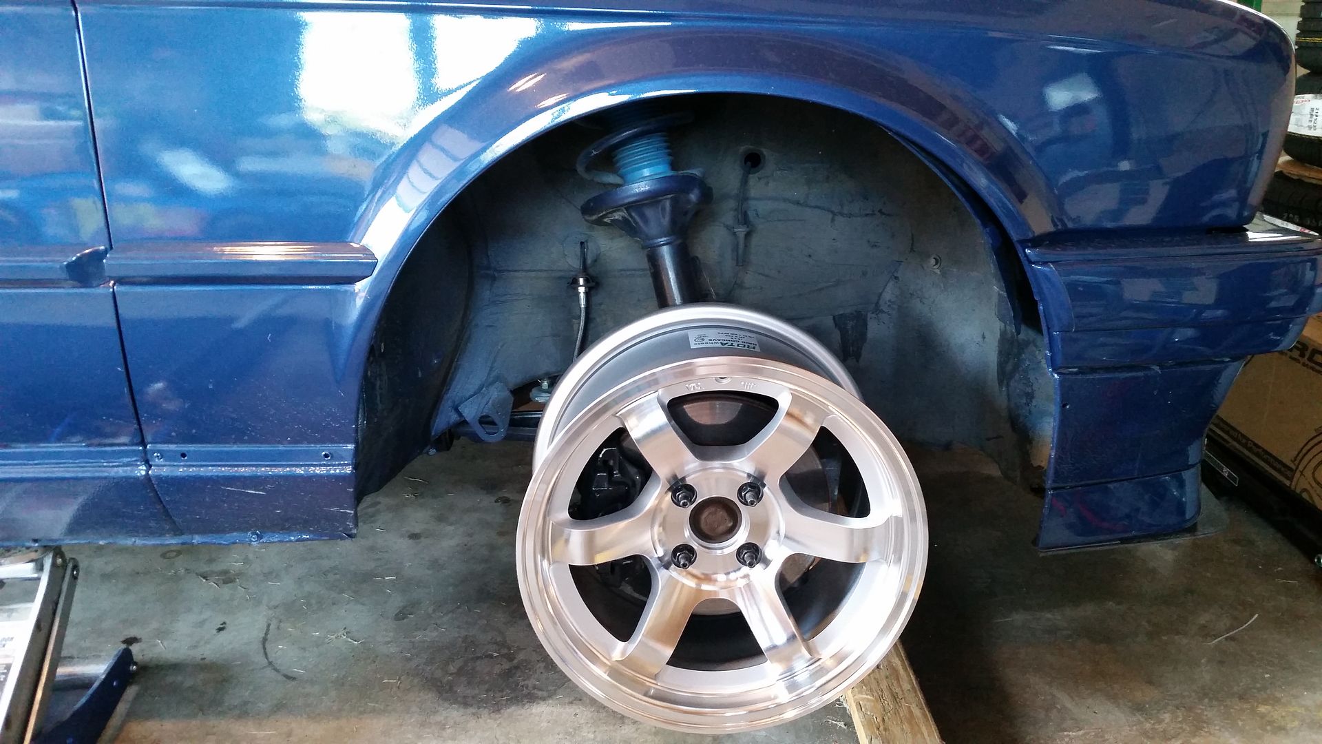

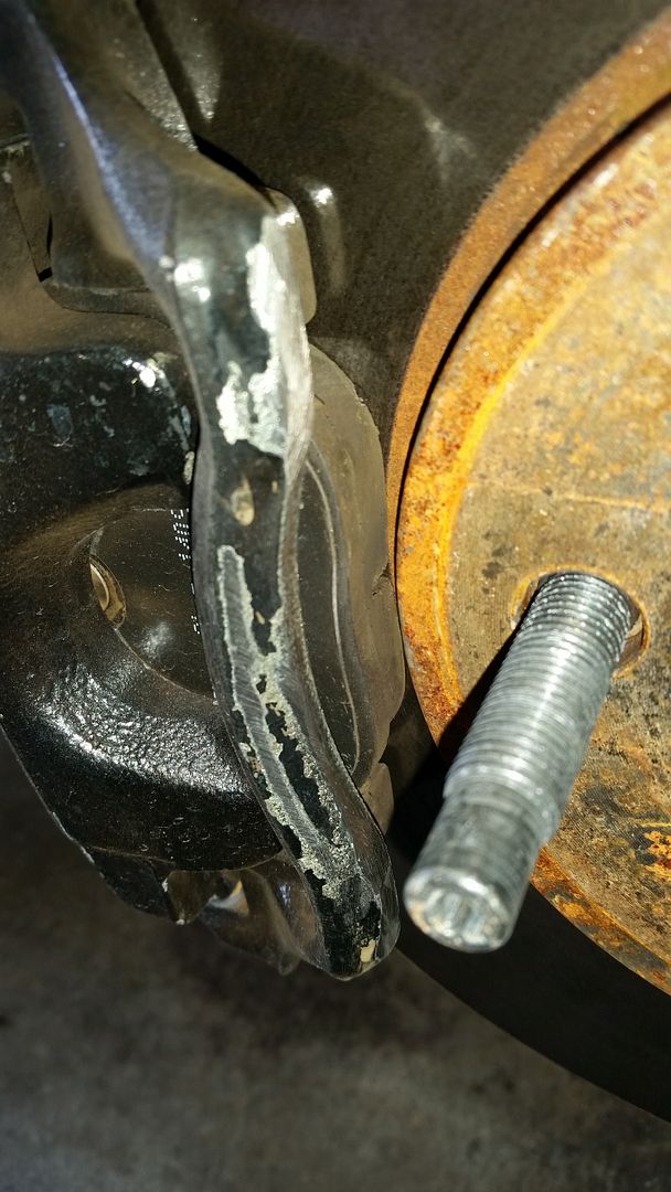

                  So the good news is that I got the wheels and really like the look. The bad news is that while the wheels fit the car there was still interference- this time on the caliper bracket.
                  I swapped in re-manufactured Ate calipers in place of the Girling calipers but that should not make a difference. In the end, 10-15 minutes of grinding, use of nail polish, adjustments, and the result was that they fit.
                  Wheels and hub rings:
                  Some test-fit shots:
                  BARELY clears the strut:
                  Caliper bracket interference:
                  Back of the wheel:

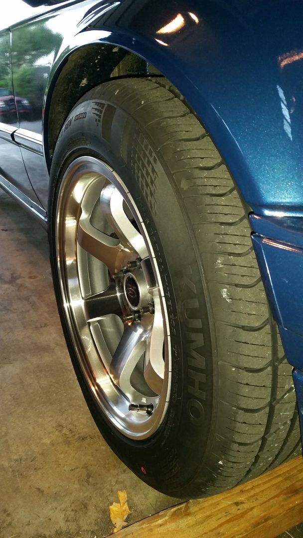

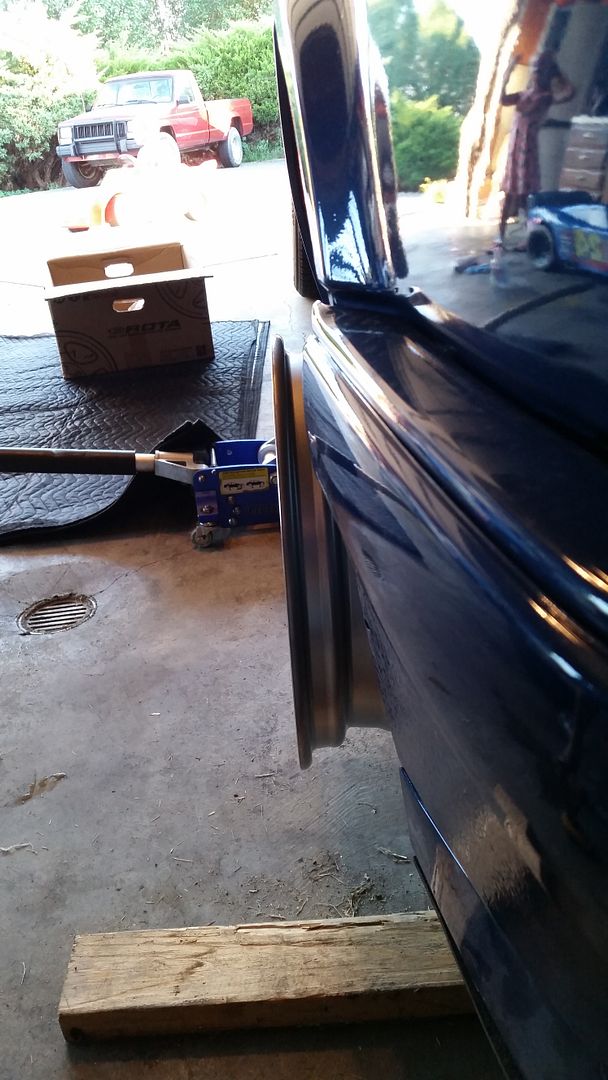

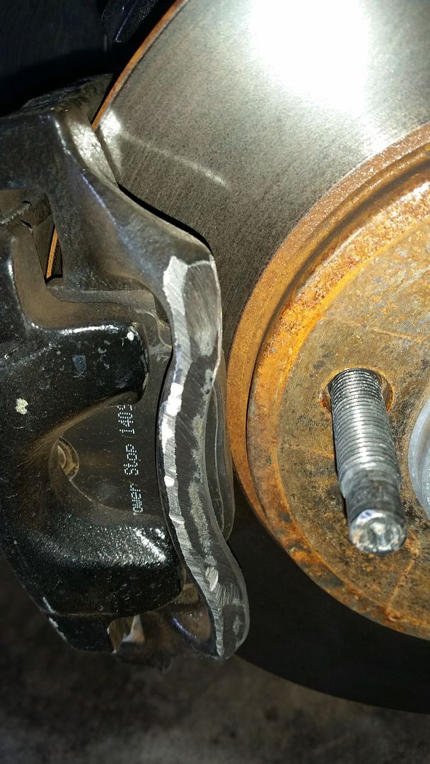

                    Caliper grinding:
                    It fits!

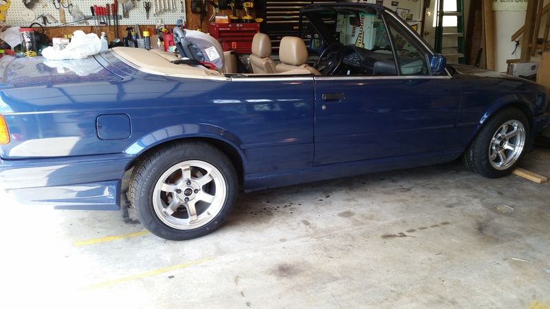

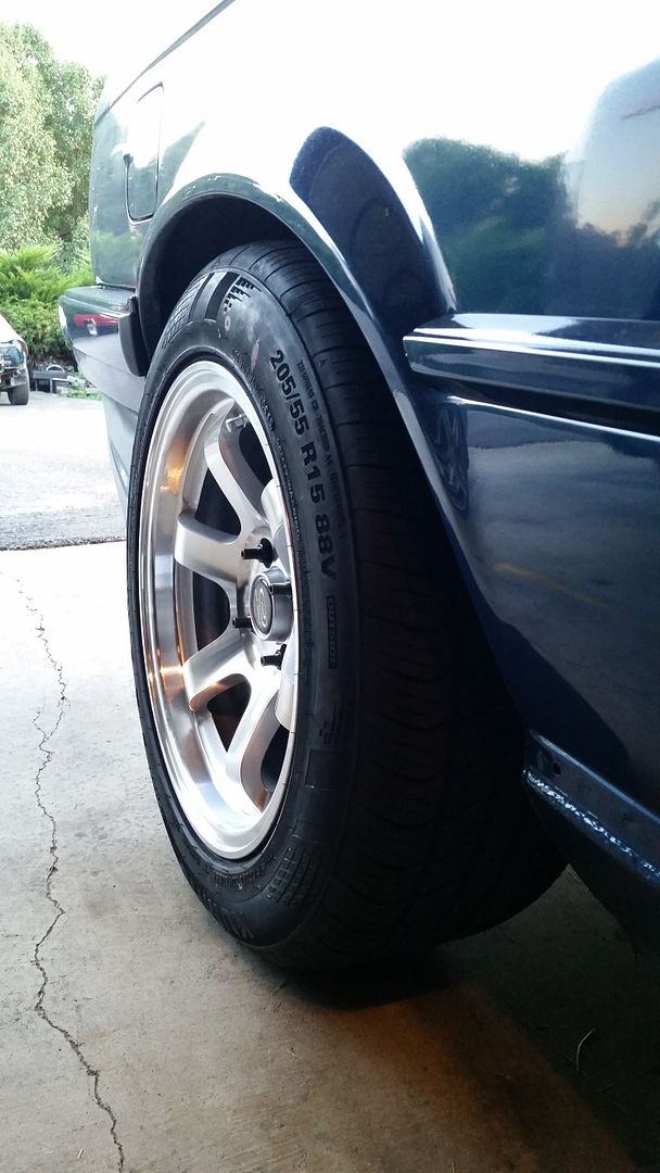

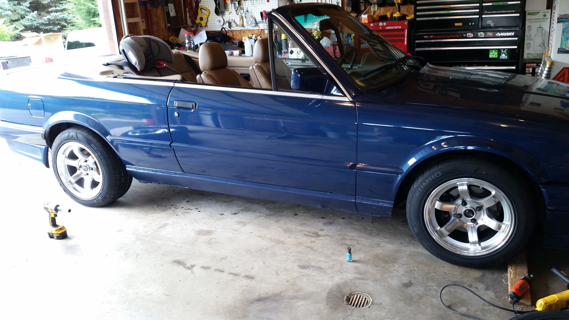

                      Outside, before settling:
                      And after:
                      15x8 ET20 Rota Grid Concave Full Royal Silver with 205/55/15 Kumho Ecsta 4xII tires on H&R Sport (convertible) springs, 15mm drop hats, Bilstein Sport struts/shocks.

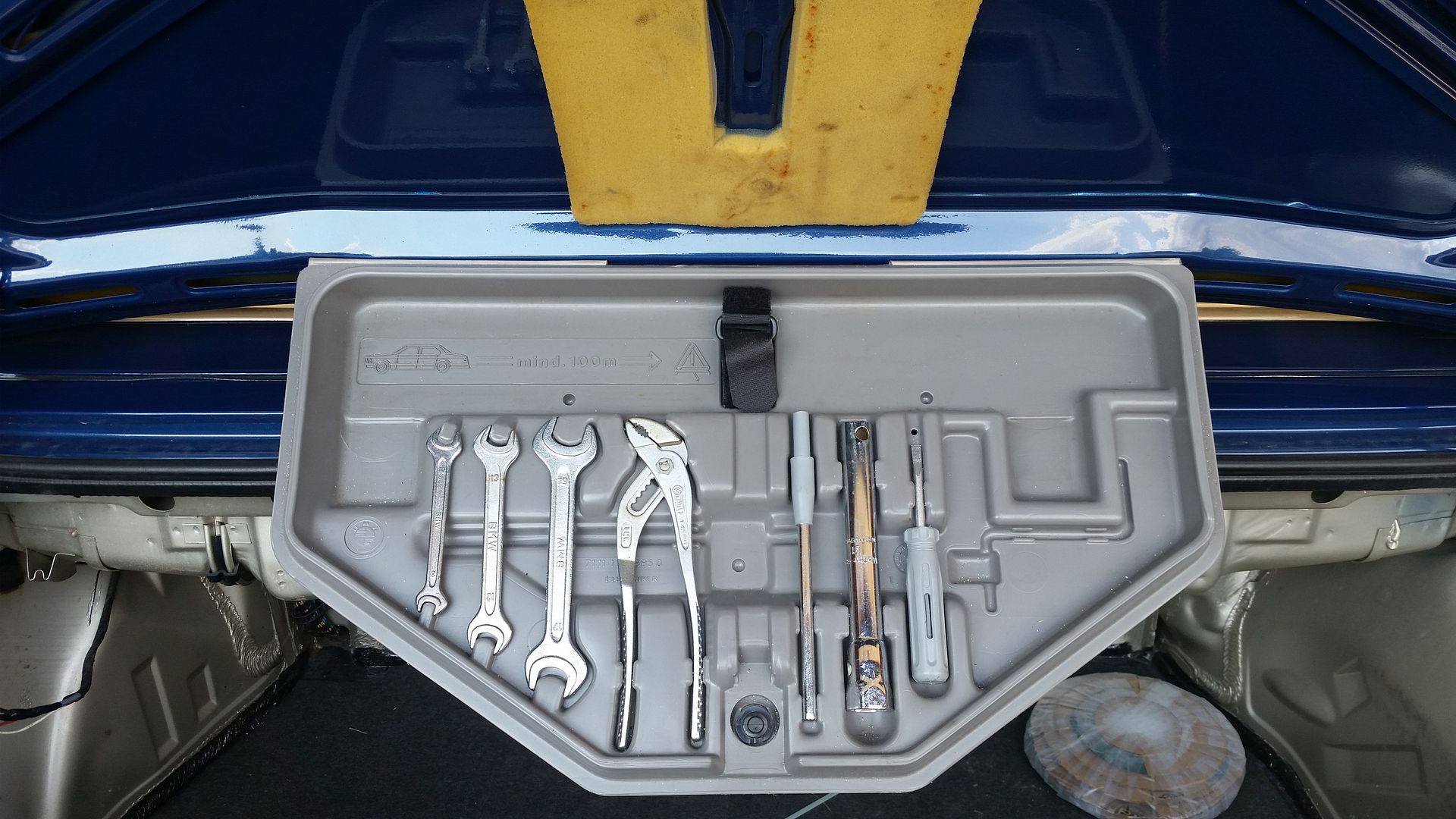

                        I also installed my nearly-complete "large" tool kit.
                        Realized that I am missing the strap but that can be easily replaced.
