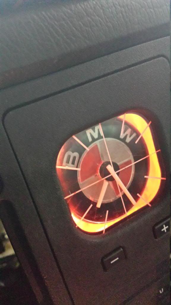

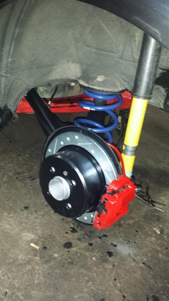

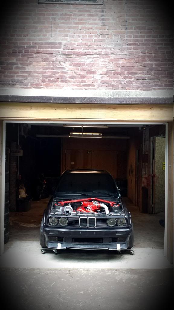

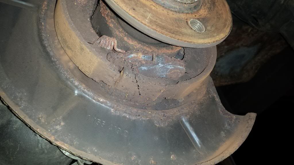

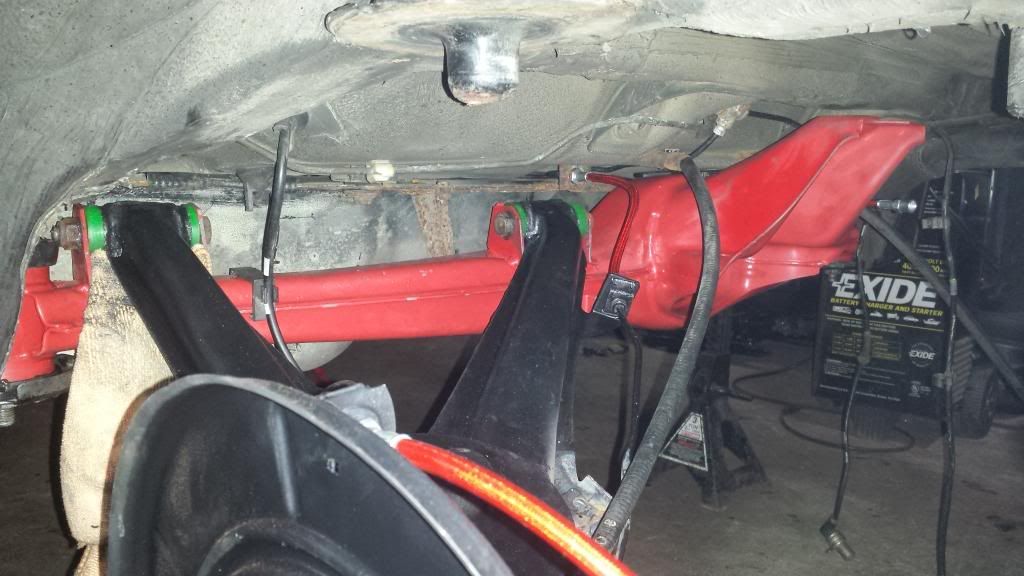

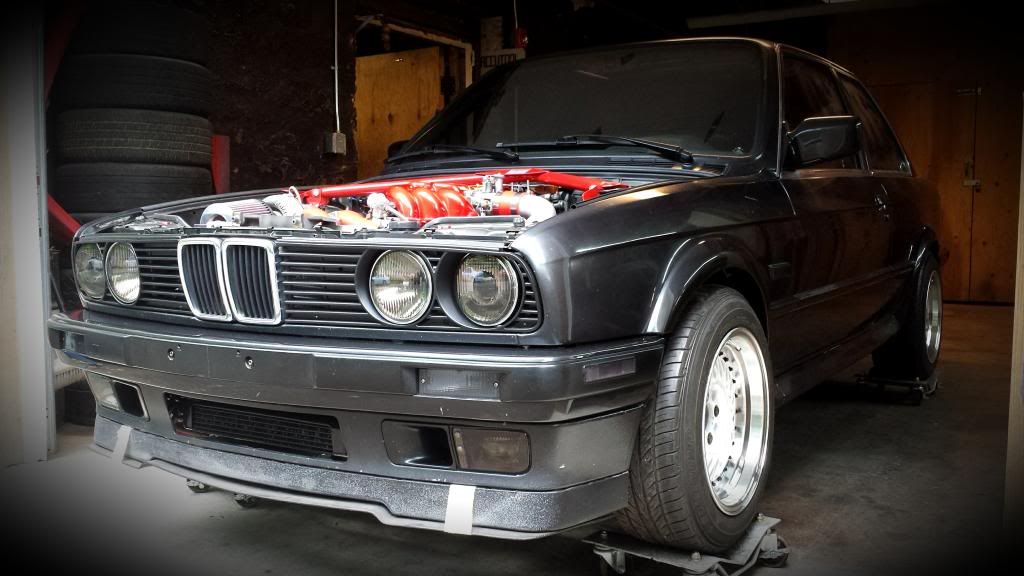

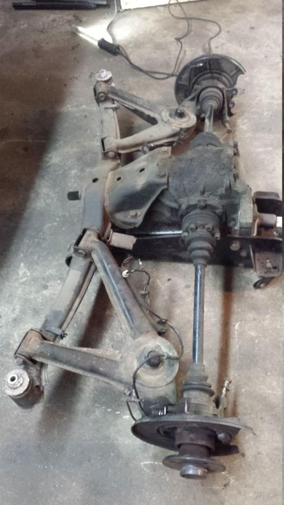

        Clock installed. Needs red led.

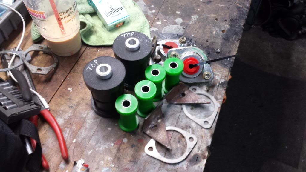

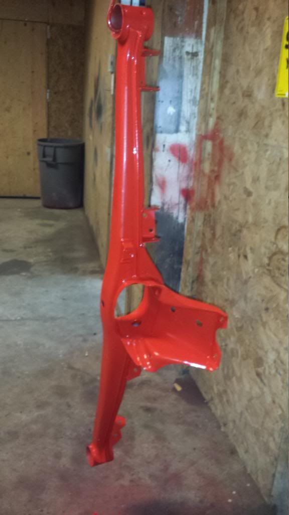

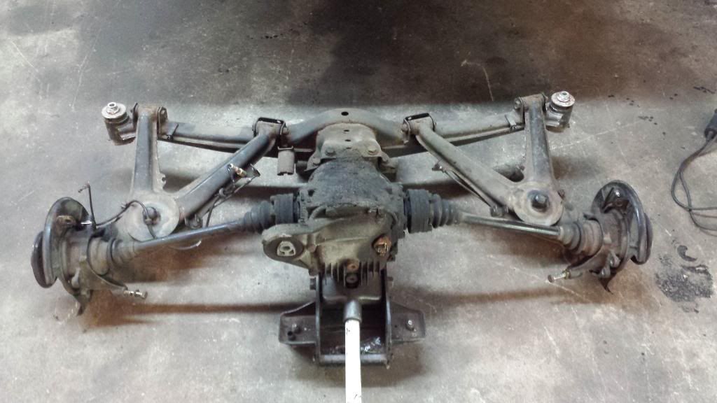

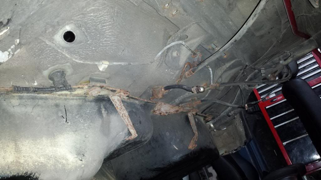

        Removed subframe for massive amounts of work.
        Lines to replace

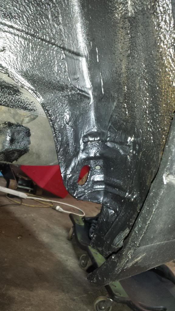

        Rust repair
        Sandblasted stuff

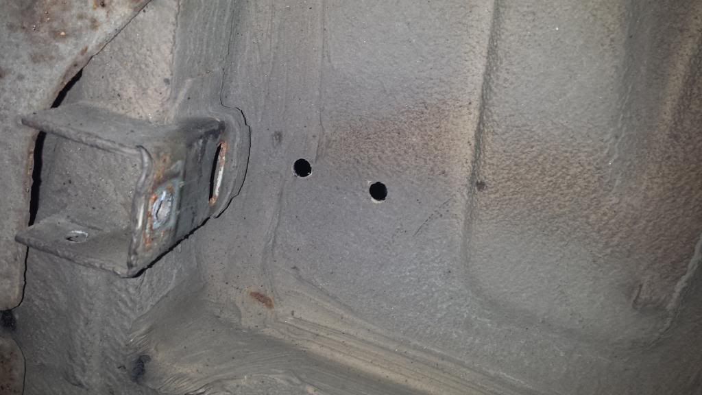

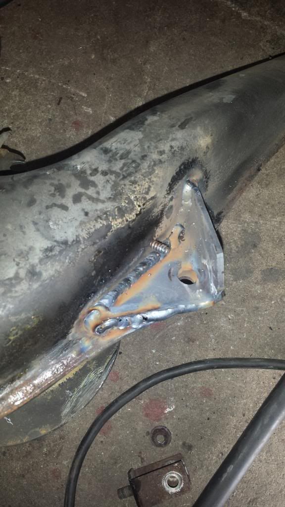

        Welded swaybar reinforcement tabs for 19mm bar upgrade
        Holes drilled for upgraded swaybar reinforcement

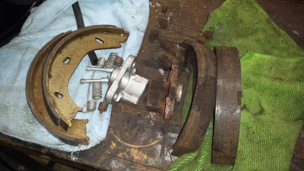

        Rusty ebrake shit is gonezo

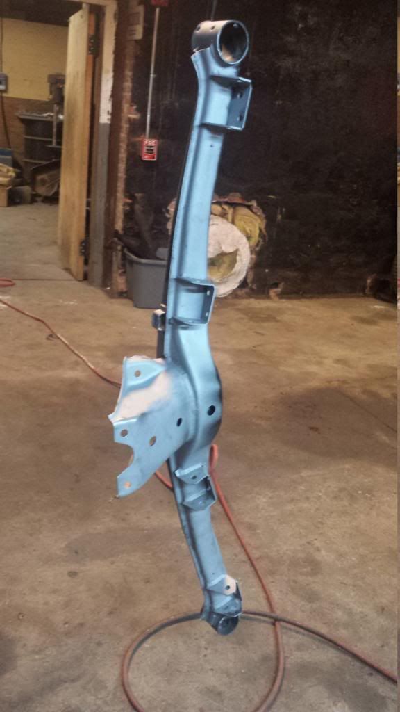

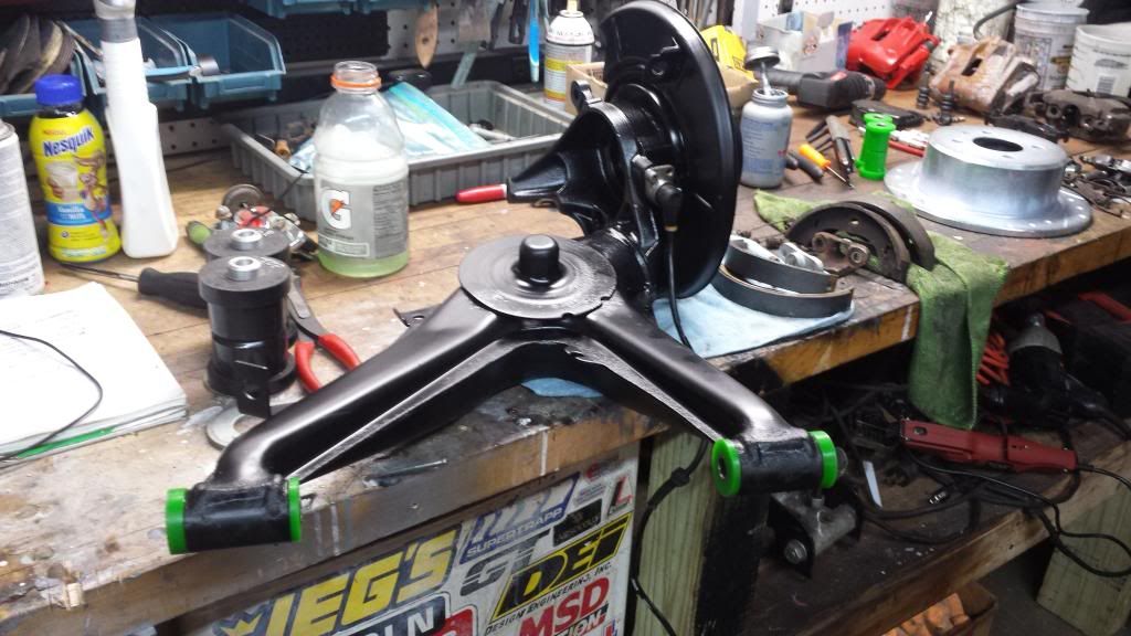

        Everything lined up rebuild sandblast paint and replace
        Old vs new.
        Powdercoated and stuff installed

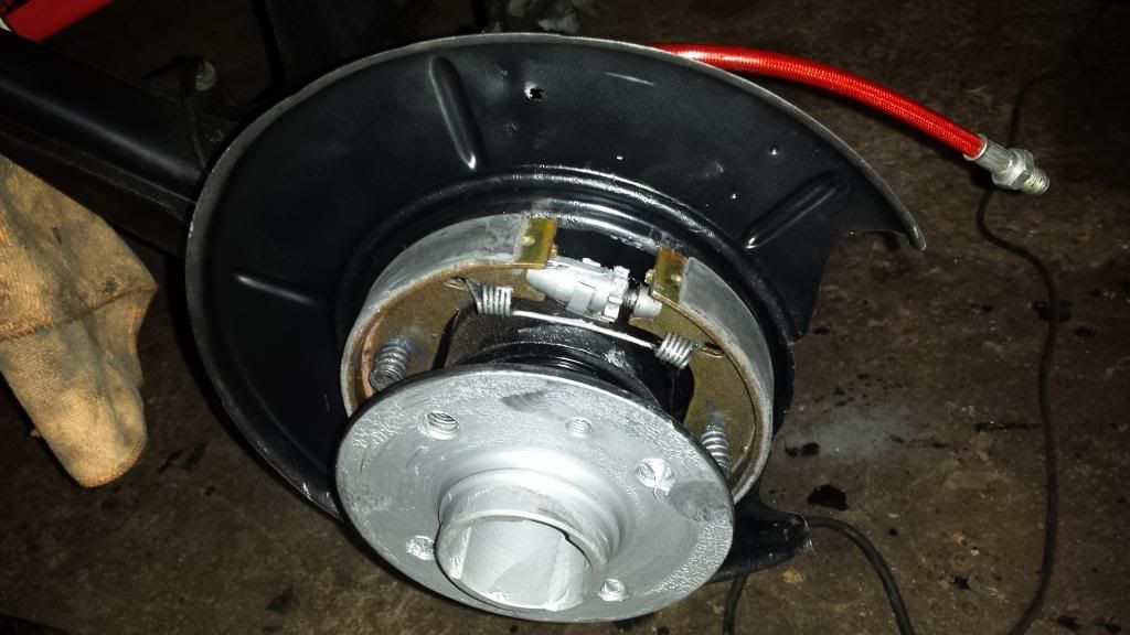

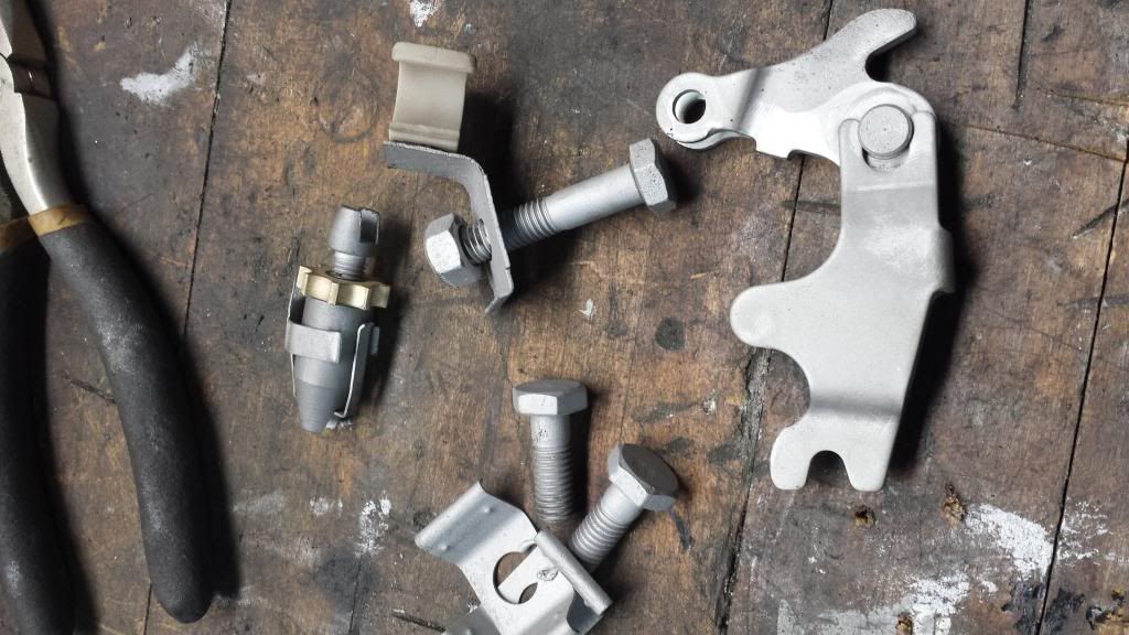

        Installed, greased, new lines

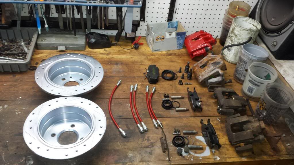

        Ebrakes adjuated night and tight

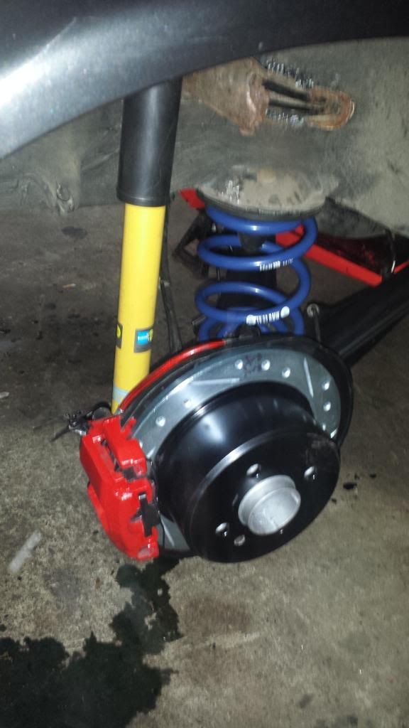

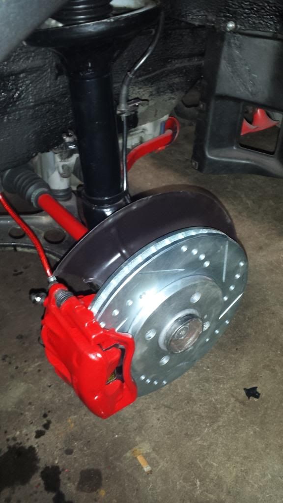

        Brakes rebuilt 100% new seals, boots, hardware amd bled with ate super blue
        Now off to bleed the clutch and thats done and done! Time for glamor shots
        Dont mind the tape holding on the lip, all bodywork repaining will be saved after everything's been completed.
        Enjoy folks, gonna get to getting this old girl fired up for the first time, will try to link videos once all the odds and ends are sorted. Thanks for watching

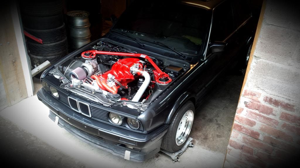

                Amazing work, sub'd for sure. How did you make the switch to the smaller expansion tank?
                  It's the radiator/expansion tank from an m42 318iS.
                  Great work dude! Everything looks amazing. BTW make sure you put the fan shroud back on, the mechanical fan is very inefficient without one.

                    very nice! I bet you could grab more power with an intake box around your filter
                      I have piping I am still fabbing up that will bring it lower/further from the turbo. The brake duct will have a tube pulling air directly up into it with some bafffles to block water in case of rainy days but still push/pull air efficiently. Filter is there at the moment for looks only.
