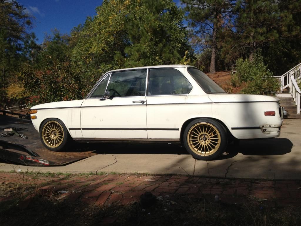

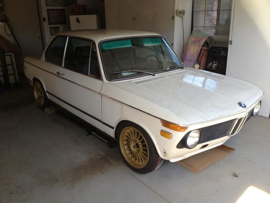

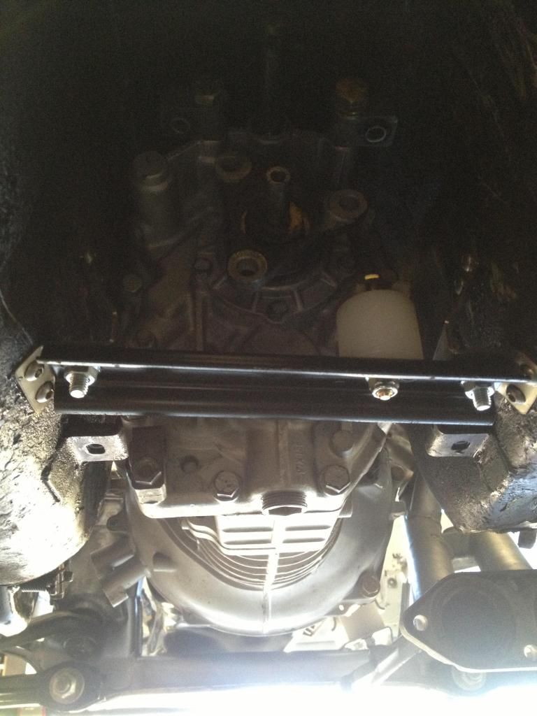

      Got to work again on the 2002 the last two weekends. I was trying to get it tow ready so I could move the car closer. This way it wouldnt be as difficult to get away and spend some time working on it.
      The first goal was to get the 5 speed bolted up for good since the last test fit went well. First up was to refresh the rear main seal and the pilot bearing. Popping the old rear main seal out was easy, getting the new one in wasnt as simple. I covered the outer and inner portions of the seal with some non hardening gasket sealer and it made the install a little easier. My old pilot bearing gave some resistance also, but a little slide hammer action and out it came in a few whacks. Re-installed was the updated sealed pilot bearing.
      Next up was the flywheel, clutch, and pressure plate. No surprises here. My flywheel had been lightened previously, albeit only a couple pounds, so I decided to use it for now instead of going to an aluminum unit.

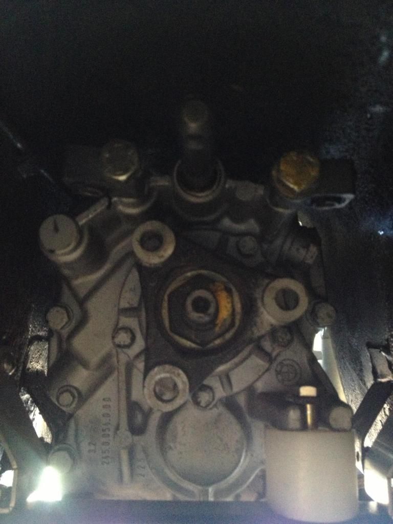

      The throw out bearing and arm were installed on the transmission, as well as the slave cylinder, and up it went.
      It took some shimming to get it seated perfectly, but I finally got it all level. I didnt snap a photo at this stage since I was thinking about getting the shift plate and UUC EVO3 shifter in.
      I bought a new BMW foam ring to seal the space in between the shift plate and the trans tunnel. Easy enough, it just slips on top of the shift plate. Getting the plate bolted up to the trans was tough. I didnt install it onto the trans and lift it up as one assembly (the foam and some hardware hadnt come in the mail yet). The shifter installed with some new early model E30 hardware that I had left over. Hopefully the added increase in shift effort seen in most short throw kits will be minimal since the transmission selector rod and the lower mount on the shift lever itself are perfectly in line.

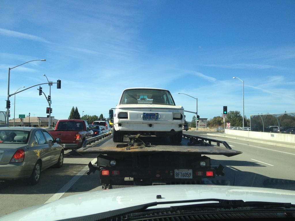

      Finally, I hooked up the track rod and the tie rods so the 2002 could be loaded up onto the flatbed. I misplaced the castle nuts, so I temporarily installed some nylon locking nuts to secure all the steering components. Before the tow I filled the trans and the diff with the appropriate Redline oil to keep everything nice and lubricated.
      I think I went a little overboard snapping photos during the tow but it has been a while since the car has been out in the sun!
      And dropped off at its new home:
      Whats left:
