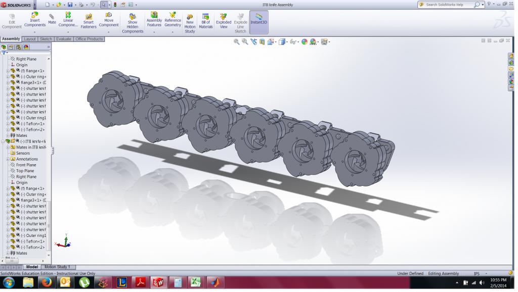

    those itb's look sweet.

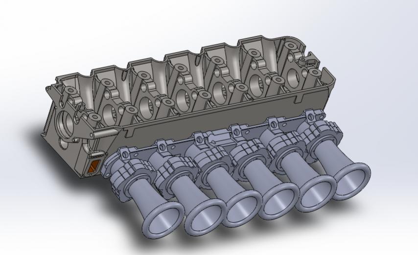

      Where did you get a 885 head on solid works?
      I may bother you for that later on down the road for some projects I have in mind.
      • TehRaydarlover
        • Mar 2013
        • 544
        Thanks
        I found it online somewhere. I just use it for a rough mock up, a lot of the dimensions are wrong.
