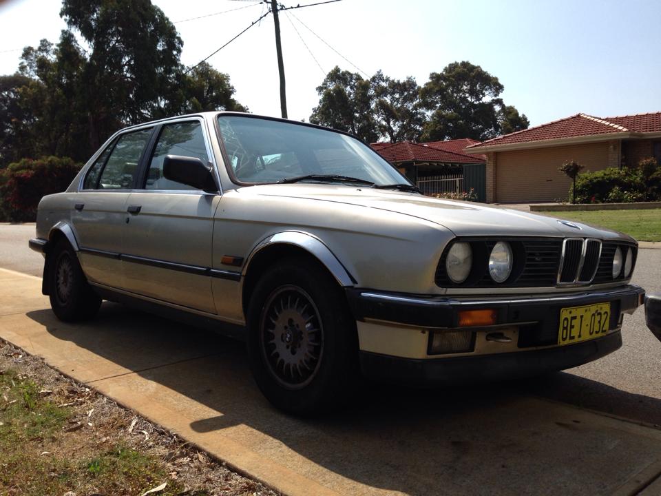

    I've recently purchased a 1985 bmw e30 3.2.5 e for the purpose of drifting it.

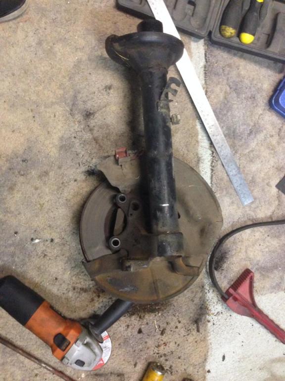

    Here is the tear down of the bmw, what an ease this thing was to pull apart!

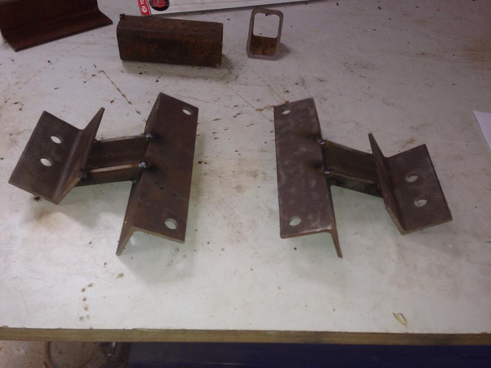

    The engine mounts I made thanks to e30v8 for supplying the blueprints! (just tacked together)

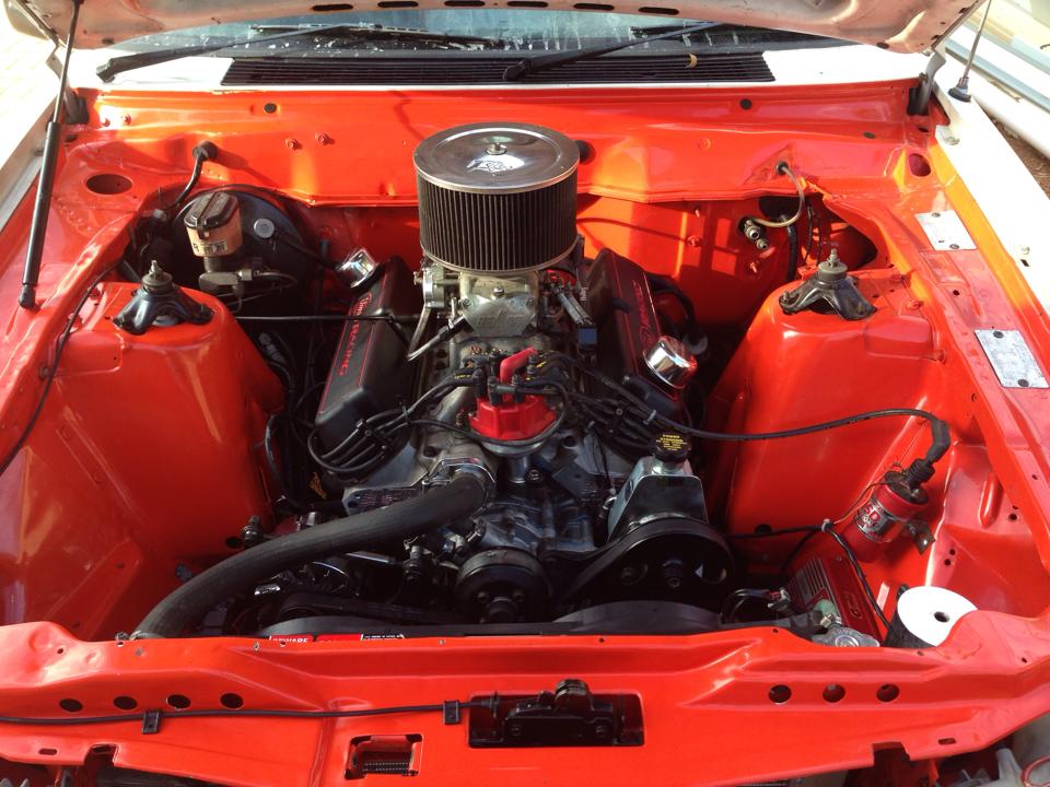

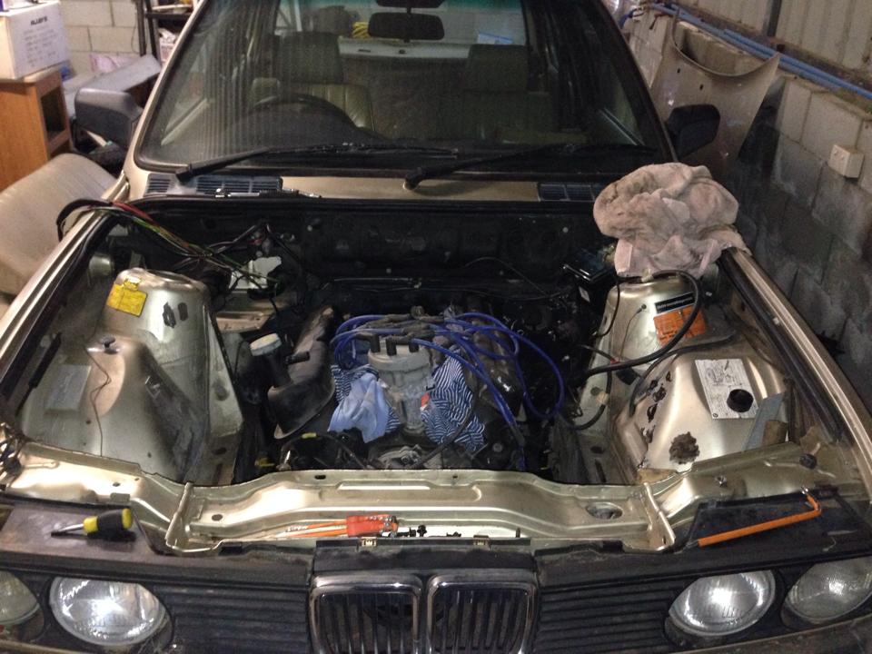

      Here it is with the mock up engine in. fairly roomy but the exhaust will be interesting. I'm dedicated to run twin pipes and haven't seen it before on this conversion.

            Cheers guys, the idea is to aim the extractors forward (like most people do) but have each side run under the crossmember and steering rack. and yes this does mean my exhaust will be lower than my front bumper but I'm not going stupid low and the lowest point is inline with the front wheels so this should help.

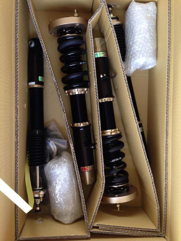

                    Had a very productive weekend. Ticked off 2 major things on the list. That is weld the diff and put in the coilovers. Heres the pics.
                    I don't think this will be breaking anytime soon...

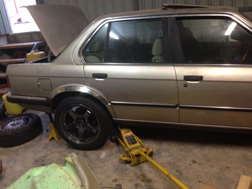

                            borrowed some rota's of a mate to test fit (even though i couldn't actually lower the car on them as only one stud was in).
                            their 17 x 9 et 25.

                            so it looks like I'll be going with these bad boys.
                            Front: 17 x 8.25 et35 - 215/50/17
                            Rear: 17 x 8.25 et20 - 235/45/17
