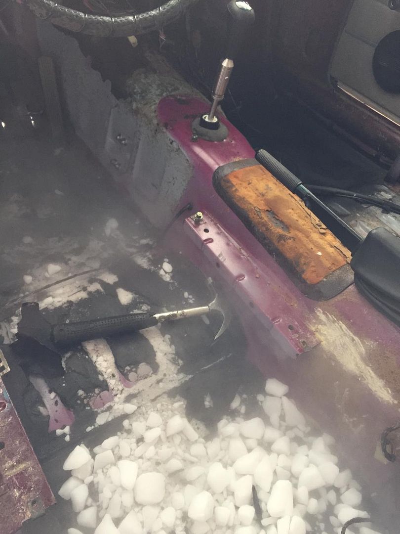

                            So I lied... again. Still no start with the S14. I spent my last free days with a few non essential items that were just on my mind.
                            While the carpet was out, and to shave a little weight, I grabbed some dry ice and a scraper to remove the sound deadening material on the floor boards and trans tunnel.
                            Easy process, cost was about $12 in dry ice. Worked it over each section until the material started to creak. So far, just from sound deadening material the car is down 34lbs.

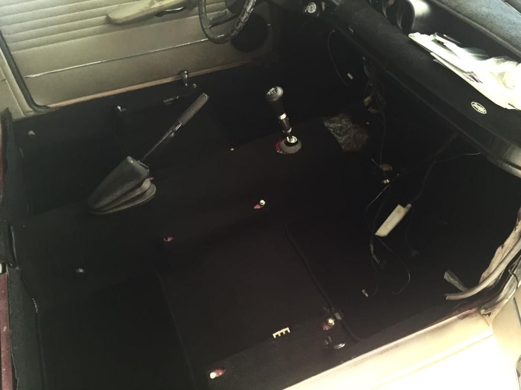

                            I was planning on tossing the 41 year old original carpet but upon closer inspection it didnt look too far gone. After hosing it down and scrubbing it with laundry detergent I was glad I saved it. Off to the hardware store for some fabric dye and here were the results. FWIW, the carpet originally was green-ish with some black in it and the floor mats were dark gray. I think it came out halfway decent. I used the same dye technique that I used on my E30, Rit dye to get the deeper fibers and then the aerosol gloss black dye to finish it off.

                              That carpet looks fantastic!
                                Thanks! I'm glad it came out well. You can see there is a section cut out in front of the shifter since this 2002 had AC from the factory. I'll get crafty and build a cover for it once I build the custom center console.
