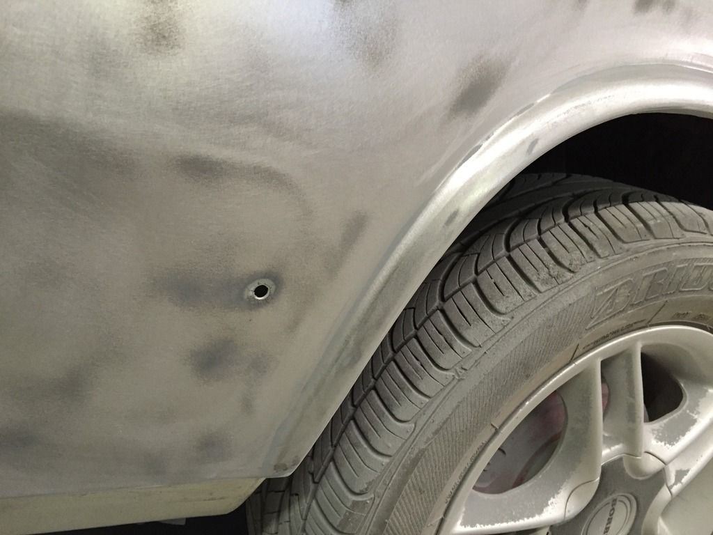

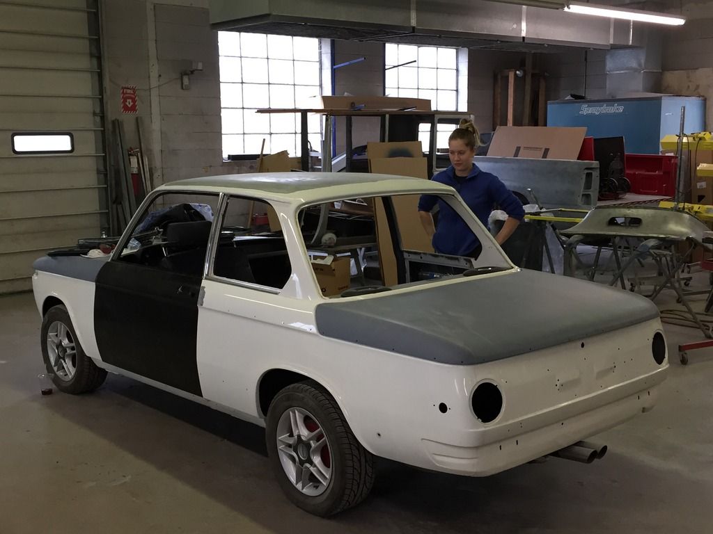

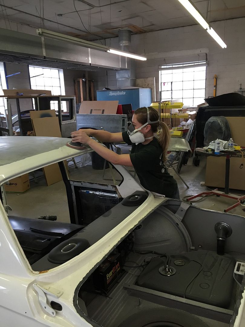

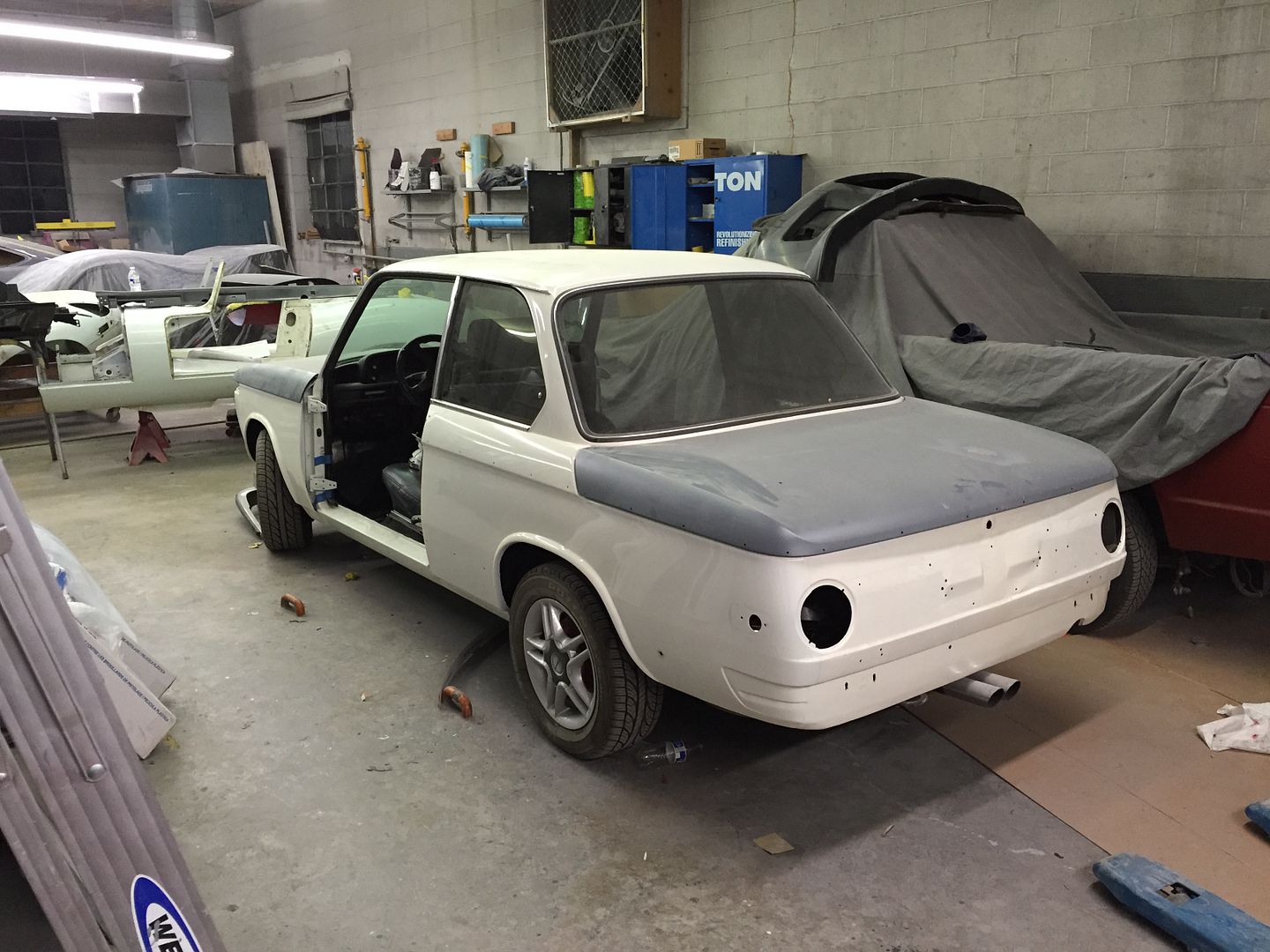

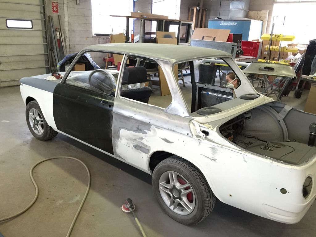

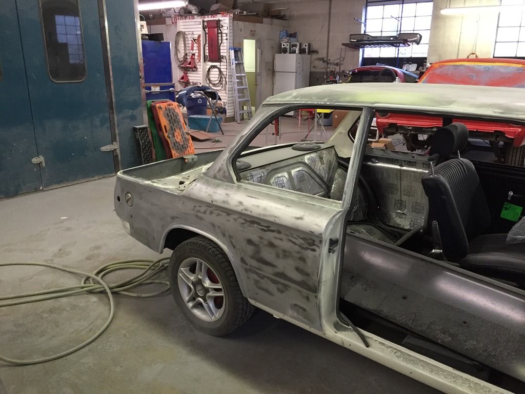

                                Long time with no updates but now we are back at it. Since the primer used in the original respray was not very high quality my freind at the body shop recommended taking at least the outer painted surfaces down to bare metal. This was obviously hard to stomach but we didn't want to risk having the paint bubbling after the all the trim was back on so we started sanding and sanding and sanding. Here's some progress, note the new drivers door has been hung but the hinge is not in the correct position so the door is not aligning. The hood and trunk lid have been sanded down (about one full day of labor in each panel!) epoxy primered and temporarily installed to see how they are lining up.
                                Now you see paint...
                                Now you don't!
                                One positive out of all this is we know there is some really nice metal under that paint
