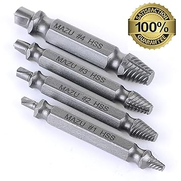

              use the drill side (left) to drill a hole where it's stripped, then use the reverse threaded side to bite into the head and remove it.
                This or see if you can get a screw extractor kit. The snap on one works wonders.
                    This. With this style of allen head you can usually use a center punch to rotate it. I've had good luck that way because the head is so big. Hit it between the socket part and the o.d.. I would try this first.

                                If the screw extractors don't work, you could take a dremel with a small cutoff wheel and cut a slit into the top of the bolt so you could take a drive impact with flathead bit to it. That has to get it loose.
                                One of these: http://www.homedepot.com/p/TEKTON-3-...Q&gclsrc=aw.ds
