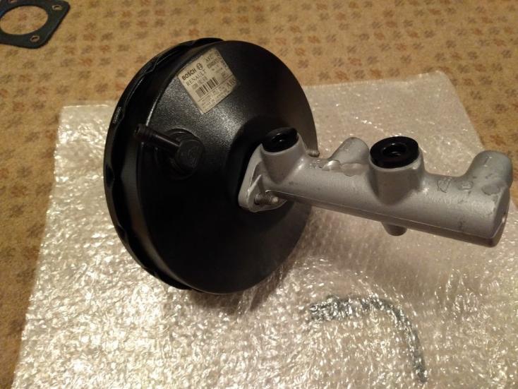

E32 brake master cylinder came in the mail. Here it is mocked up with the Clio booster:
Should there be a gasket or something between the MC and booster?

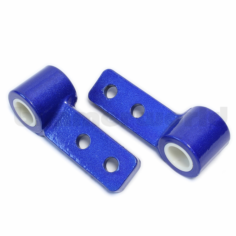

- Front M3 offset bushings

No gasket needed between the MC and the booster.
Looking good man, two more random suggestions get the small billet style m3 offset bushings they will give you more down pipe/exhaust clearance.

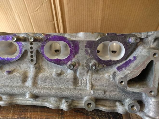

Work on the engine has finally begun. Head is getting a port and polish, as well as a few bits widened as part of the VE conversion from fwd na to rwd turbo.
Progress pics:
Next week the block is off to the machine shop to get the sleeves installed and just a general clean up.Last edited by AusScare; 10-15-2022, 04:51 PM.
