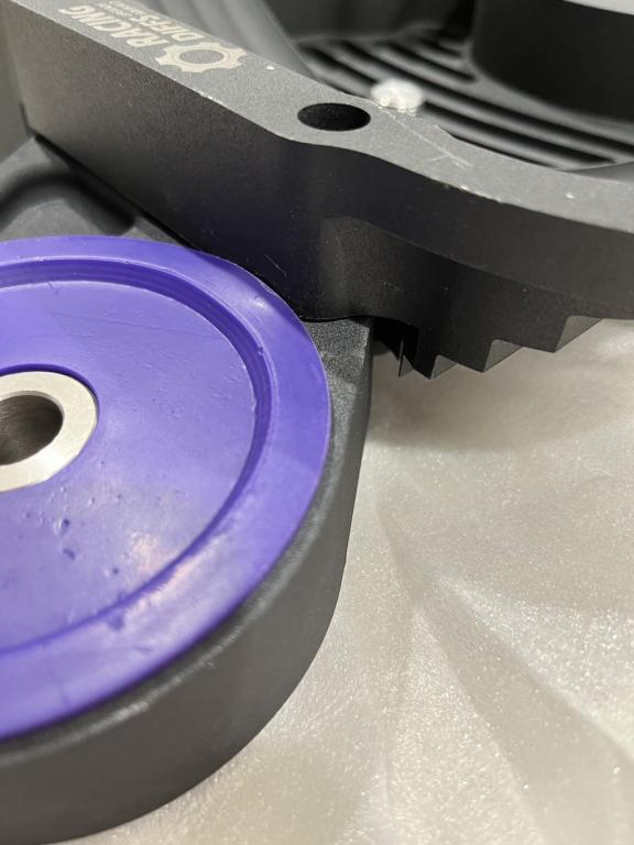

    So I haven't been super pleased with the Racing Diffs (RacingDiffs) billet e30 medium case diff cover. Granted this was their first batch of the product, they did advertise that they had done thorough R&D and testing on it.
    Fill plug doesn't go in all the way as the hole hasn't been correctly threaded:
    Poly bushing hitting the cover:

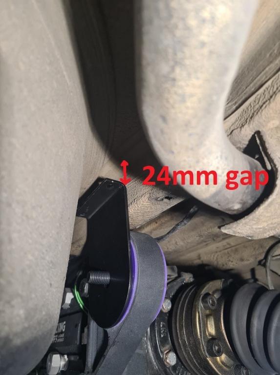

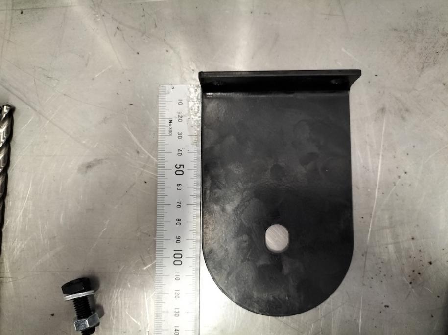

    Brackets to connect to the body were too short. This meant the car wasted time at my mechanic's shop while waiting for Racing Diffs to send out some spacers (not the correct sized bracket):

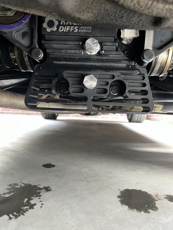

    And finally after it had been installed and given a run, on highway speeds it's pushing a lot of diff fluid out of the breather. After I took this photo my mechanic added a coiled extension to the breather port which has fixed 80% of it, but it's still leaking, so it's back to the shop for more solution finding:

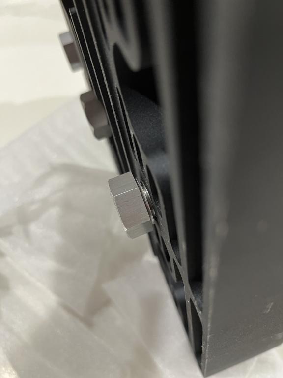

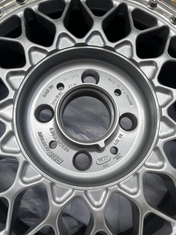

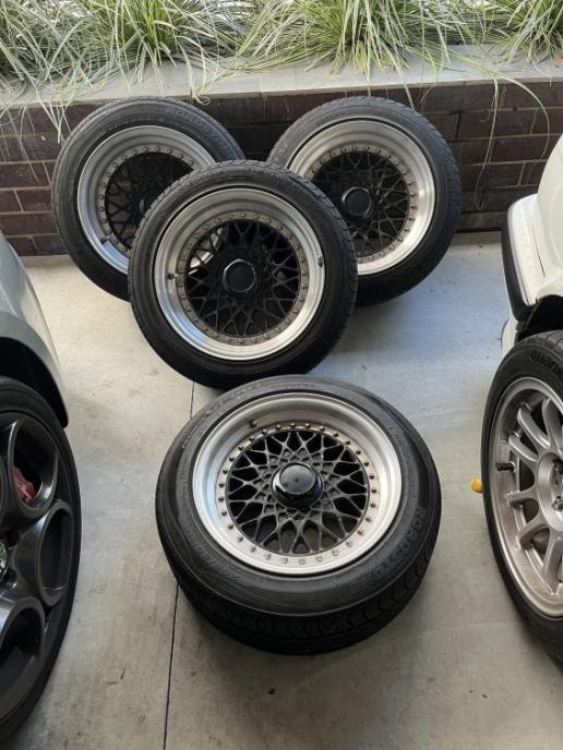

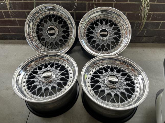

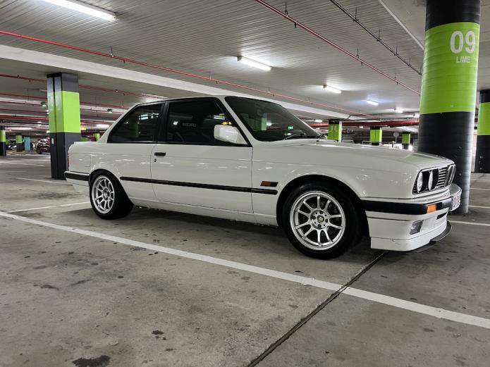

                BBS RS 071 wheels are back from being rebuilt. These are 15x8 +18 and 15x8.5 +12
                Summary of the work done:
                • Barrels painted black
                • Centres painted nogaro silver
                • Waffle plate painted nogaro silver
                • Polish hex caps
                • New titanium bolts
                • New polished valve stems
                • Reassemble​
                I also picked up some cheap 'BBS' emblems and valve caps, but I'll need to get some genuine BBS emblems as these don't fill the space correctly.
                A reminder of the before:
                Now:
                Test fit:

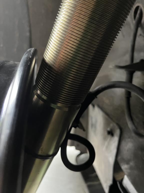

                Clearance is super tight to the KW V3 coiler strut. I might have to run a 3mm spacer - I've had to run this with the TRM C1's and 225/45r15 tyres, as they seem to rub slightly compared to the stock spindle/strut assembly.
                Clearance too tight or will it be ok with a 205/50r15 tyre?
                '90 318is
                • AusScare
                  • Jun 2014
                  • 220
                  #113

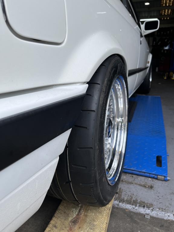

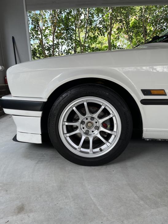

                  Tyres fitted today. Went with Nankang CR-S in 205/50R15 front and 225/45R15 rear. The current tyres are Hankook RS-4 in 225/45R15 all around.
                  These Nankangs are HUGE in comparison.
                  Front 205/50:
                  Click image for larger version  Name:	IMG_5612.jpg Views:	0 Size:	68.2 KB ID:	10073223
                  Rear 225/45:
                  Click image for larger version  Name:	IMG_5609.jpg Views:	0 Size:	45.1 KB ID:	10073222
                  Fronts are fitting fine (ride is high to save my oil pan for now), but while the rears do roll like this, they will hit the guard on bumps, so I've taken them off for now and will raise the rear and add more negative camber.
                  Looking forward to getting the fitment sorted so that I can take it for a proper drive.

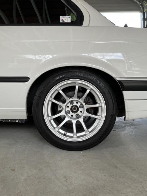

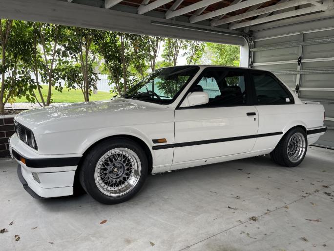

                        Got the height sorted and an alignment at the same time. I'm happy with it, as it's not super low. If I ever get the car painted, I'll get them to clearance the guards to allow for a more aggressive height in the rear.
                        This wheel/tyre combo would actually be better if the BBS was its original 15x8 +18 in the rear, as it would have the guard clearance on the outside. So another option if I want to go lower is to have the rear wheels returned to their original spec with a half inch smaller lip.
                        In saying that, the roads are always going to be the weak link - you never want to be so low that you can't drive the bloody car, or get it in/out of driveways and over speed bumps!

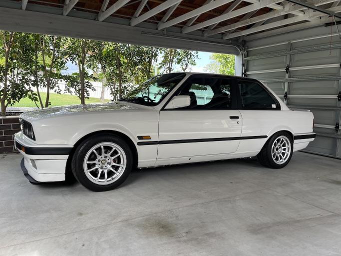

                            Agree that wheel spec is perfect for 205/50 front and 225/45 rear.
                            Went to the local cars and coffee on the weekend, car drove great and it looks like my diff is no longer leaking... not sure how, maybe the fluid level has dropped a bit where it's no longer an issue. I'll listen out for a badly worn LSD now :')

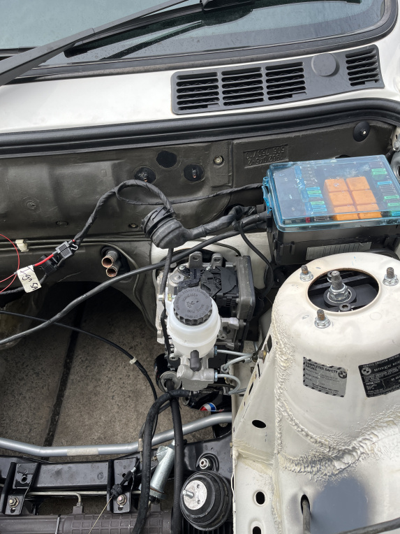

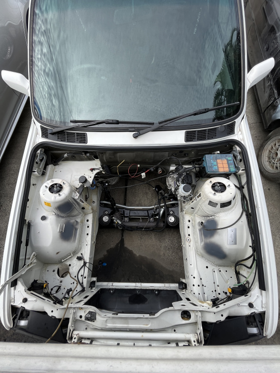

                              A few months later at the start of April, I was driving home from cars and coffee and the car started making pretty bad noises - a loud knock when revving and the idle was bad, seemed like a misfire. Diagnosed as no compression in 2 cylinders and a bottom end knock. The motor was dead!
                              Click image for larger version  Name:	IMG_6140.jpg Views:	0 Size:	192.2 KB ID:	10094948

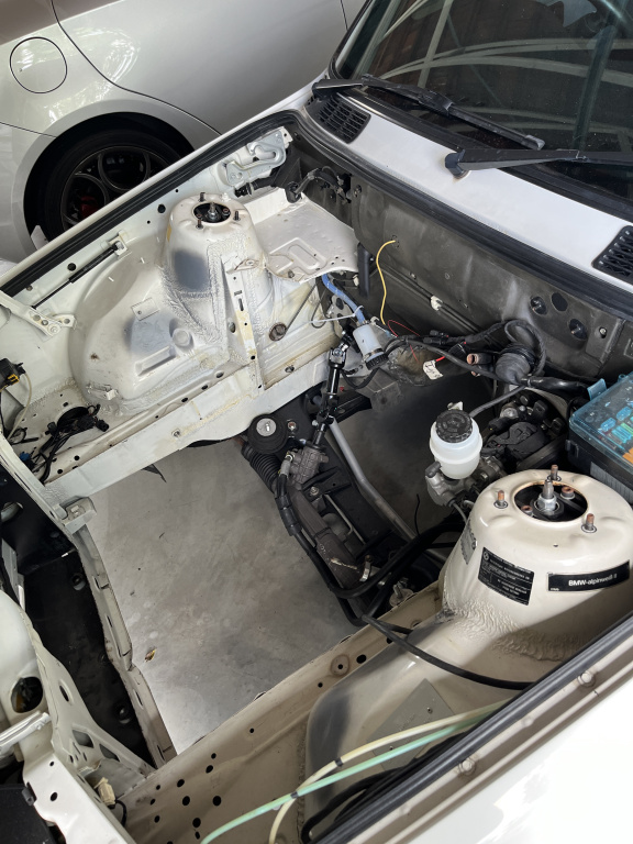

                              So out it came, and I had some other work done at the same time:
                              - Brake booster/mc replaced with a Bosch iBooster from a Tesla Model S (rhd)
                              - Aircon related items removed
                              - Diff breather adapted to a larger line (still cautious of this leaking)
                              - Steering linkage replaced with an LPSR linkage as the Astra/Vectra linkage I had was dead
                              - Excess brackets removed and primed
                              Thanks to GreshM Performance for their work on the car.
                              Click image for larger version  Name:	IMG_6253.jpg Views:	0 Size:	215.3 KB ID:	10094949
                              Click image for larger version  Name:	IMG_6257.jpg Views:	0 Size:	200.5 KB ID:	10094950
                              Plenty of room for the SR20 exhaust manifold now hopefully.

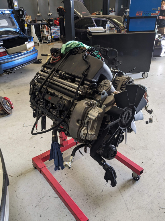

                                Ok so bit of a change in the project direction.
                                I picked up the SR20 that was being built and took it to another shop for a second opinion and for them to finish it off. They inspected and measured everything and came back with some pretty bad news. The work that had been done was pretty average to say the least. Bores out of round, scoring in the bores, porting of the head runners was bad, etc. they listed off about 10 things and said it would be cheaper to just start again with a new block and head. Pretty disappointing since I'd waited so long and paid so much already for this long block to be built. The quote to build a new SR22VET long block was too high, especially with the cost of P11 heads these days, which is $3-5k if you can even find one.
                                So, I asked my e30 mechanic GreshM Performance to source a new motor for the car and he was able to find a S54B32 in a running track car. The cost of a S54 is actually less than just the SR22VET long block.
                                I then started to sell all of the SR20 swap gear. Most is new and it's a common motor here, so it's selling pretty easily.
                                The S54 swap goal is reliability for light track duties and weekend driving. Only modifications will be a Karbonius airbox, tune and obviously an exhaust to suit.

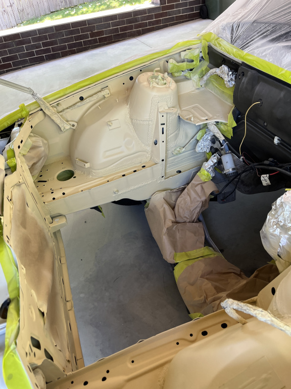

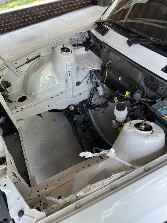

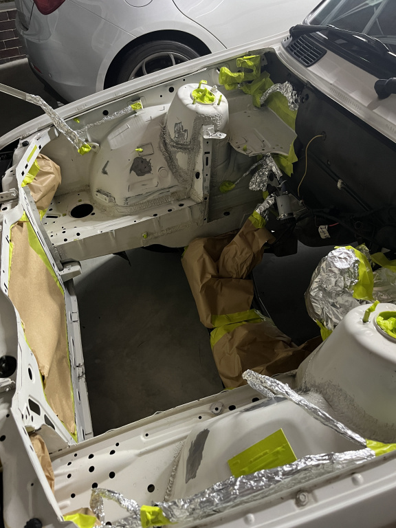

                                Over the Christmas holidays I painted the engine bay in Alpine White II and 2k clear. It turned out great. The stock paint was in pretty poor condition so anything was going to be better.
                                Original condition, cleaned, with a few brackets cut off and spot primed.
                                Sanded with 400, then 800 grit as well as some scuff pads for the hard to reach spots. Everything taped, covered in al-foil or paper. All bolts removed and cables cable-tied out of the way.
                                Primed, then given a light sanding. A few spots missed, but still better than what the factory did - you can still see the dark factory primer in the corners.
                                With rattle cans, 3 coats of Alpine White II base, 3 coats of 2k clear, 4th coat of clear on the towers. All pretty light coats since this was my first time painting a car and I was mostly concerned about runs in the paint.
