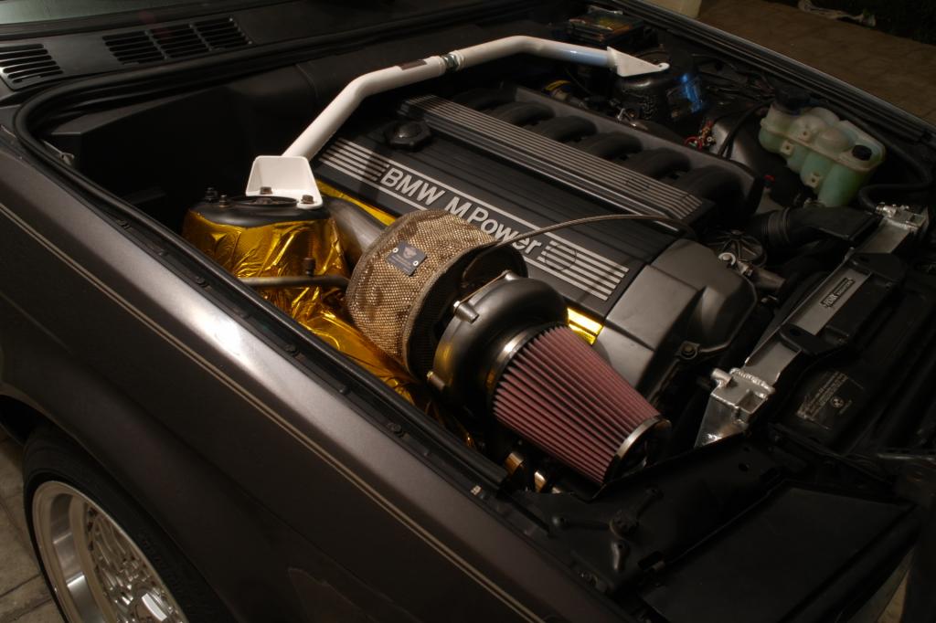

  • E30NJ
    replied
    Not my photo, but this is what Mesarina did with that gold wrap:
    More here: http://www.r3vlimited.com/board/show....php?p=4297824
