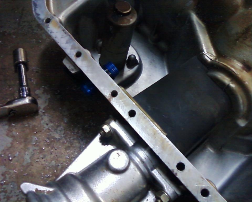

    I guess I never saw your message. I am planning on running the coil to get it up and running. I may go COP later but there is no real need to change it at this point. I got my vTPS wired up and it runs fine now. So much torque though! On the top end it was running out of steam at about 5000 rpm (I'm at altitude so probably later than at sea level) due to the stock cam and head. I also had the stock exhaust on there which I am sure is restrictive on an engine 25% larger. Your oil drain looks more professional than mine, I threaded a fitting in there with thread locker and then put a nut inside the pan. We put it in the same spot to clear the oil pickup. Mine doesn't leak though! ~2500 miles on the engine so far.

    Put the turbo drain in today
    First time tig welding aluminum but I think it turned out ok
