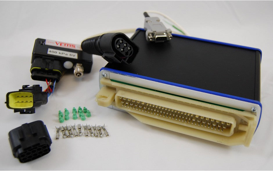

                Have you looked into VEMS?
                EFI Motorsport is a company dedicated to providing quality upgrade parts, hardware, software, tuning, and service for a range of European vehicles.
                You can source it through Gunni from GSTuning for cheaper. He builds these to directly plug into M5x 24v motors even with knock control. Last I remember he had been developing it for M52. I have the pnp for M50 and am liking it so far. It's a pretty user friendly interface and even a noob like me was able to tune it to idle very nicely and map it well.
                Another good one I see the Swedes using is Autronic SM4.

                  I've always viewed VEMS as a megasquirt competitor, and I'm not really interested.
                  From what I can see, the current gen Link and ECUmaster offerings seem to be highly regarded in most communities besides the BMW ones(which seem fixated on megasquirt for the most part.) It's about as good as you're going to get for the <2k range, unless you're also considering getting into like a high end MoTeC or Bosch MS unit for significantly more.
                  Not sure if I'm going to go with it yet. Big potential for drivability issues if I ditch the stock ECU, and I'm not sure if I like that. Plus cost. It all comes down to how well this setup works once I get some tuning done.
