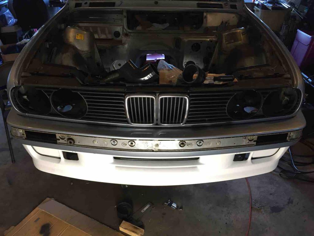

                  Here's a refresher for how much space I have above/below the fmic... not much.

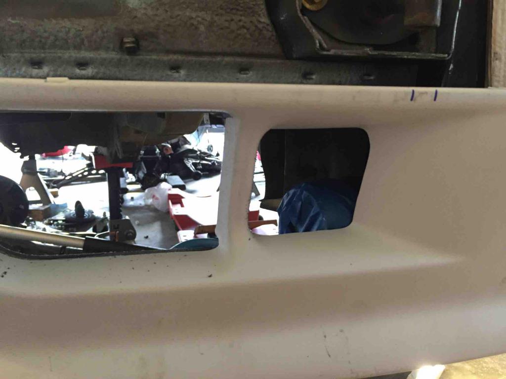

                    Maybe it isn't worth trying to fit one there... I could cut the valence/bumper some more for airflow and stuff a generic shaped one in front of the driver's wheelwell above the brake duct(which I want to retain)

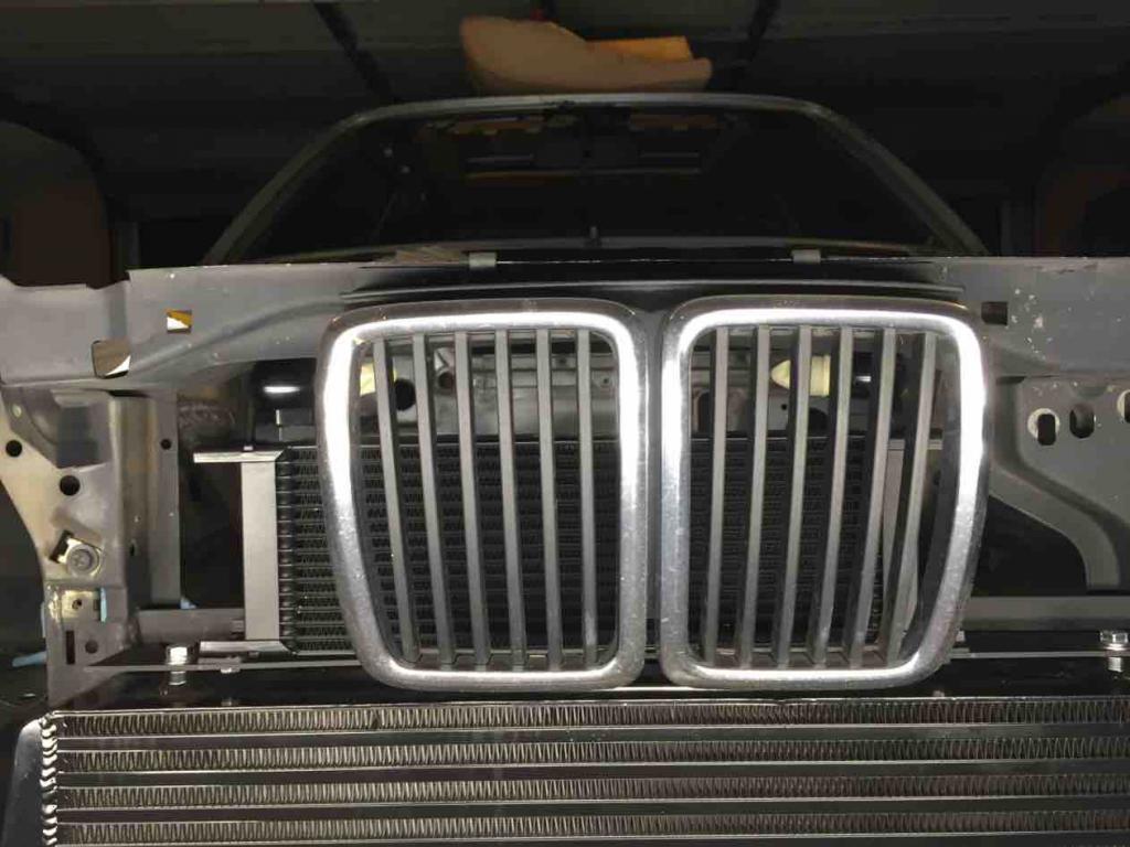

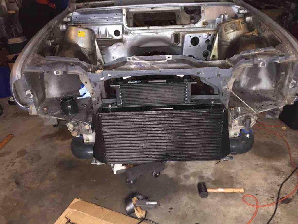

                          Northern's S257 + M52 325is
                          Here's a quick shot of the oil cooler I'm going to run on my E30 with a turbo M52. I have a new S54 oil filter housing and VAC AN adapter for the ports on the housing. Car is in paint now so haven't had a chance to hook it all up. I'm using the low profile Setrab fittings on the cooler itself and it juuuuust clears the underside of the top of the core support.
                          EDIT: It's a Setrab Series 9 Oil Cooler, 15 Row, M22 Ports

                            ^ That's exactly how I have mine - behind the kidneys.
                            We also welded 45's to my intercooler for a precise fit to insure I can run fogs and brake ducting. Yours looks nice. :p

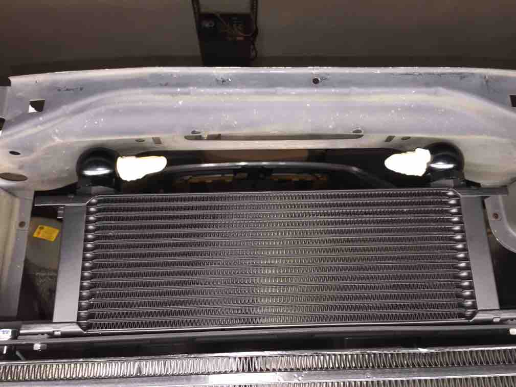

                              Thanks man. I might look into getting some extensions/angles welded on to my IC once I get the car back, put the engine in, and mock up the charge piping. As it sits right now I had to shave a lot off the back of the brake duct inlets on my MT2 valance to get them to clear the elbows and even then they still make contact but it's slight. I mean I pretty much shaved the ducts down to the back of the valance. Looks a little funny but it works. Click image for larger version

                                Sweet - as long as long term they don't cut any silicone that's dandy.
                                The convenient thing about the welded 45's, besides precise routing, is that the t-bolt clamps are much more accessible with the turn of a wheel now.
                                Couple of pics, one with the oil cooler like yours. I ran my oil lines under the unit because I think the AC stuff was in the way iirc.
