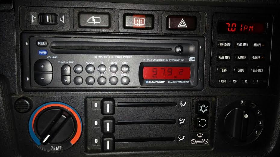

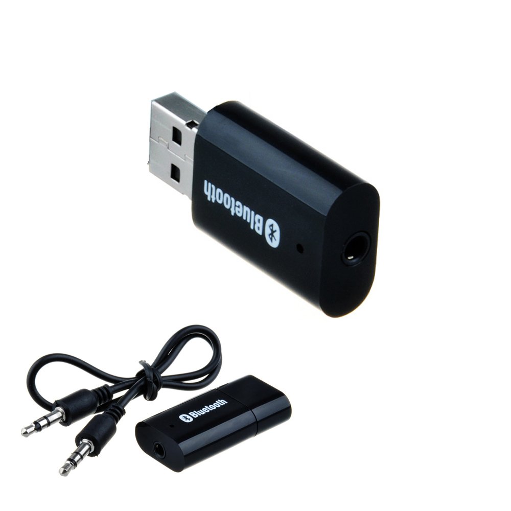

                  In between some of the bigger stuff, I stumbled across a radio solution I couldn't pass up. My car is already wired for my existing Blaupunkt Toronto RDS 126, and I found a good deal on a Manhattan CD 148. Seller says it was purchased as NOS in 2014, and it looks to be in good shape. This should plug right in to my existing wiring, and has an integrated 1/8" input jack ready to go.

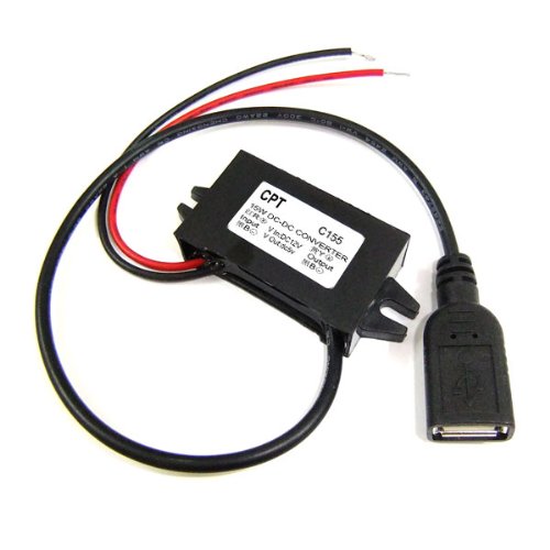

                  In order to utilize that auxiliary input, I'm going to integrate a 12V to 5V DC/DC converter, and a simple bluetooth A2DP audio adapter. I've used this bluetooth unit in previous "radio deletes" using motor cycle amplifiers, and it works well. Should only require connecting the converter to switched 12V and plugging in the bluetooth behind the new headunit, and voila.
                  Going to look for a 318ti antenna conversion as well.

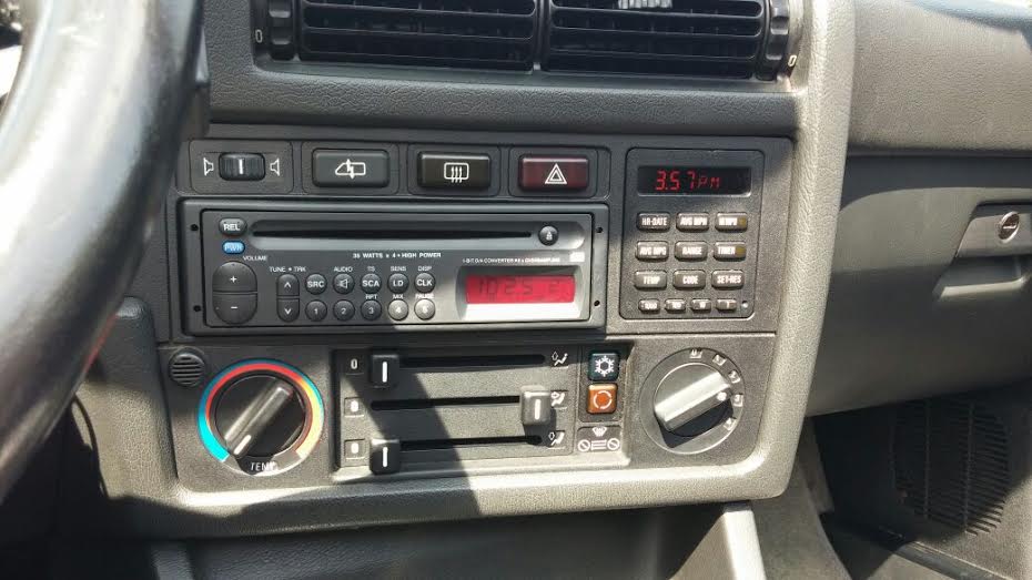

                    Got the radio install finished up today. Wiring plugged right up. I cleaned up/recovered a few connections (Thanks for the duct tape, PO :P), and wired in the 12V/5V converter. Bluetooth plugged right into the aux on the Manhattan, and voila. $20 Wireless input, awesome sound, and it doesn't look like a disco circus on the dash. Seller for this radio installed a tinted filter and the illumination looks 99% factory, picture doesn't do it justice.
                    Once the power antenna is gone, I think I can call this done.

                      #190
                      What did you do with your minty window circuit breaker button?
                      How to remove, install or convert to pop out windows
                      http://www.r3vlimited.com/board/showthread.php?t=297611
                      Could be better, could be worse.
                      • 318aye
                        • Jun 2010
                        • 895
                        #191
                        Lol previous pics were from the seller. My minty window circuit breaker button is still down on the shifter surround.
