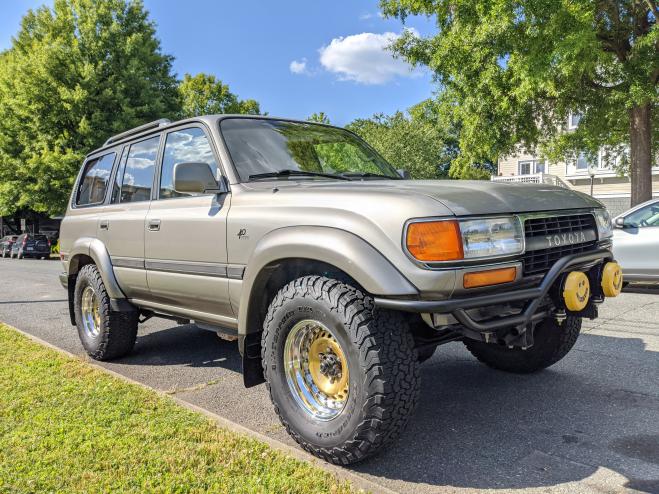

                    Dropped the HRE's off at EWW last week, looking forward to getting them back soon.
                    Got the new DD FJ80 sorted and took on rehabbing a wayward RX7 for a friend.
