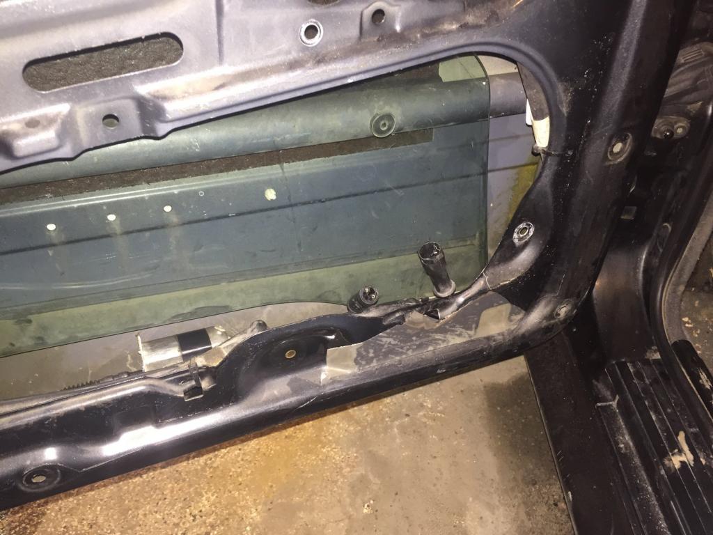

    Drivers window doesnt move, but I can hear it trying. Also found this when I was doing the lock...any idea what this is?

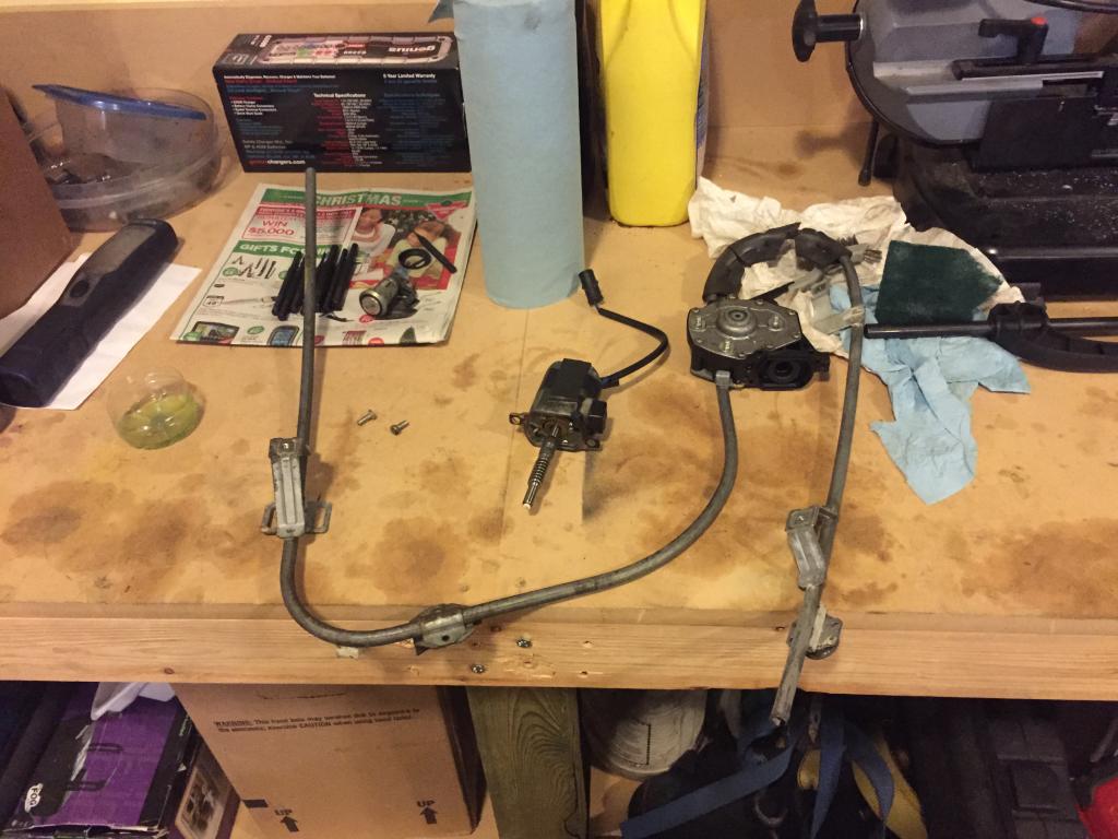

                    Finally got the window regulator out tonight. Man that seemed like a pain. You really have to contort the thing till it feels like its going to break. Separated the motor and plugged it into the door electrical connector and no go. Not sure if I want to attempt a rebuild or just order a new one. Anyone know the cheapest place? Pelican lists them as NLA...?

                            So I pulled the front drivers window motor, and tested it plugged in to the rear door, and it works. I also checked for voltage at the front driver door, and it switches to +/- 12V. However, front driver door resistance across the plug poles is infinite while the rear door is something like 36 ohms. Does this mean I have a bad connector and/or stripped plug somewhere?

                              If it reads infinite resistance, it means that you have an open circuit between the two nodes of the plug. So there must be a break in the circuit somewhere between the two, maybe a cut wire or loose fitting.
                              also you can still have a voltage reading without have a complete circuit
