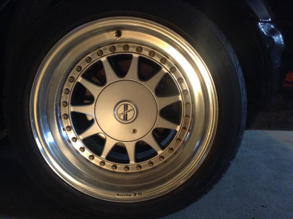

                      #130
                      Originally posted by bradnic
                      yeah yeah yeah. unicorn pics :-)
                      those are the holy grail I guess (17s?)
                      *16x8.5:devil:

                        LOVE 16s but whoa.. how do you get 8.5s under the front fenders????? I can't get anything more than a 7" wide wheel up front on a stock car. 8.5" in rear with a high offset = no problem.

                          #132
                          Very small tires:)
                          Major fender flare the rear

                            #133
                            pic is of rear wheel of staggered set.....front is pictured earlier in thread...
                            ...front & rear centers look cosmetically the same, but are completely different.

                              there's plenty of room on the inside of the wheel in back - 2" or more clearance to the side of a stock tire... so a high offset wheel works great back there, no fender rolling..
                              definitely not the case up front. I'm running 15x7 stock euroweaves with less than 1/4" clearance to the shock tower!

                                #135
                                Originally posted by 2002jm
                                very small tires:)
                                major fender flare the rear
                                jm
                                235 45 16 .......6.5 barrel 2 lip.......offset 26....fits under car and does not stick out
