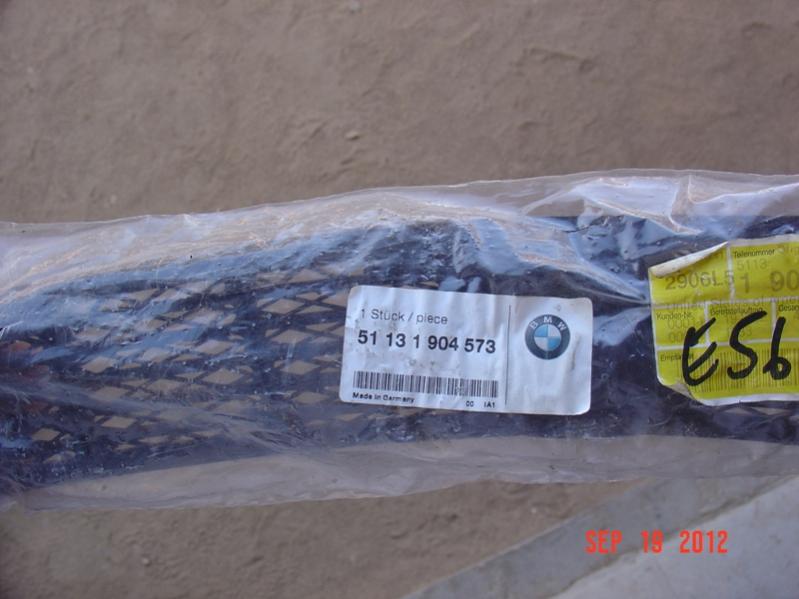

Originally posted by TimeMachinE30 View PostECS has the cowl cover for about 18USD. Shipping is another 10 for me.
51131904573
Will they allow you to purchase since the restrictions were put on euro parts?
Originally posted by TimeMachinE30 View PostSure looks that way. Went all the way to checkout but waiting to see if FCP Euro can add one to my order.
The way ecs works is they will let you order it and pay the cash and then call you in about 2-3 days saying you cant buy it. They always did that shit to me. So i just went to blunt.
Ordered the cowl cover from FCP Euro. They price matched ECS price. I had a basket full of bits anyhow... so all shipped free.
It was not listed in the site but they quickly got back to me that the part was in stock. He, too, was surprised with the euro part being available. I wonder if BMW only has the limit on certain PNs?

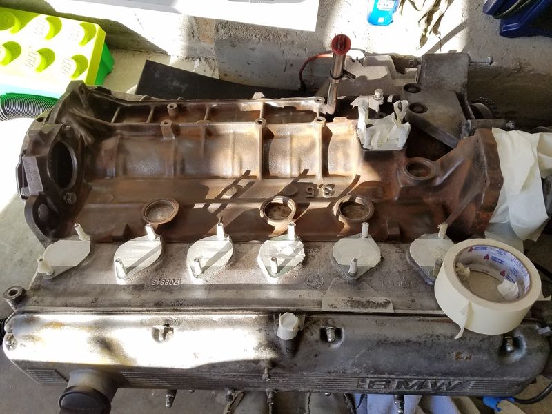

Cleaning the block for a coat of paint.
Chasing all the threads and getting as much work as I can done to the motor. I have the new banjo bolts but need their washers 11421252343. Do valve adjustment soon.
No word on the powdercoating. I told Dave no rush. Wishing I would have sent out a few more pieces.. may still try and get them in...
