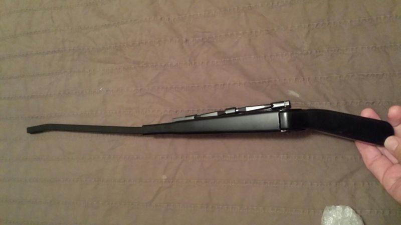

        ACS mono wiper?
        1991 318i 4dr slick top
        Mtech 2 turbo restoration
        • TimeMachinE30
          • Jun 2014
          • 3749
          #184
          Yessssss.

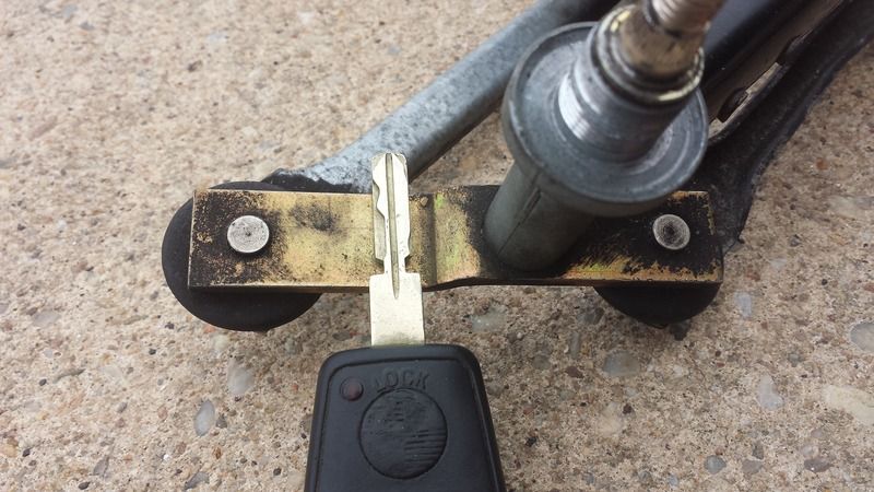

            Welder friend is good for the wiper linkage work, too. That is perfect as it involves bartering. I will drop it off tomorrow for his work to begin. The gist is: cut the arm along the where the key rests and add in 10mm, lengthening that side of the arm 10mm.

              Linkage dropped off today for modifying.... glad to hand that over to someone more capable than I.

                  Is that the only mod needed to make it wipe the whole windshield?
                  • TimeMachinE30
                    • Jun 2014
                    • 3749
                    #189
                    That is the minimum modification necessary. It seems best advised to add a support tab near the LHD driver side, as some of these tuner cars had.
                        Here is some great work done by a fellow r3v'er:
                        I'm still waffling on the PS, rack combo. I need to do it before the motor goes in.
                        Cool I though it was more involved than that. I might bust out the mig welder and try it myself. Installing the linkage though.. Huge pain
                            Once it returns, I will begin piecing the cowl together. I need a driver side cowl vent cover from a RHD. Any of my European r3vr's have one laying around? Think they are still easy to get via ECS.
                            Thats basically what the PO did to get mine to be a legit mono wiper. (not sure exactly the amount it was extended)
                            51-13-1-904-57
                            Ive been working on trying to get the RHD cover myself. Havent tried too hard, but lmk if you have any luck

                                10mm of length added is the magic number.
                                And yes, part number is:
