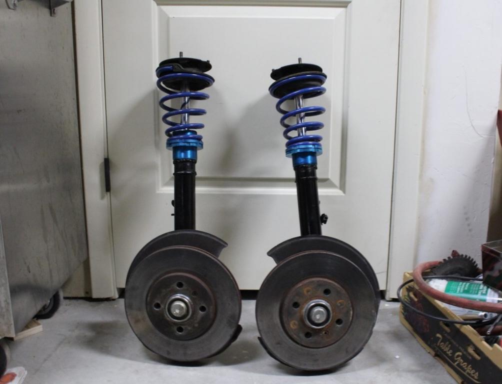

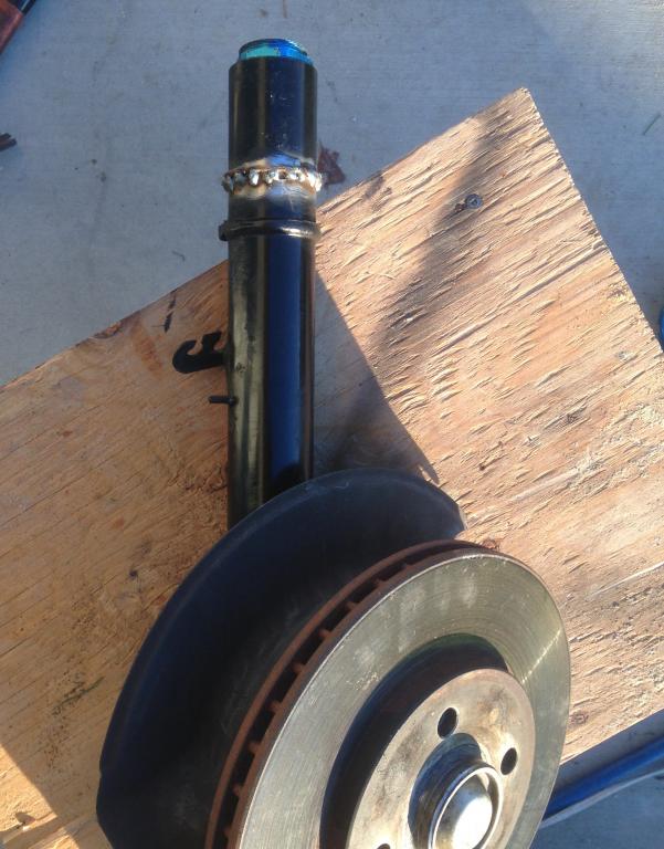

        So , I removed both of my strut housings and cut the perches in prep for a suspension setup I bought from " Achtunge30 "
        I then Tac welded a little support under the collar to insure maximum safety ;D
        Repainted the housings and got everything finished for the night.
        I know , I know . Your asking yourself "why would he buy a used JOM suspension ? "
        And my answer to you is , " this was to good of deal to pass and these should do me fine till summer."
        I know they are not GC's , but they are a lot better than my previous setup.

          Are those collars just hanging out on those welds?
          • BECKSTER
            • Jun 2015
            • 667
            #80
            No , they are sitting on and threaded onto the piece that screws inside the strut housing , forgot the exact word for the it.
            1990 Alpine 325is
            1992 Schwarz 325ic (sold)
            • ST1G
              • Oct 2012
              • 6690
              #81
              A threaded insert?

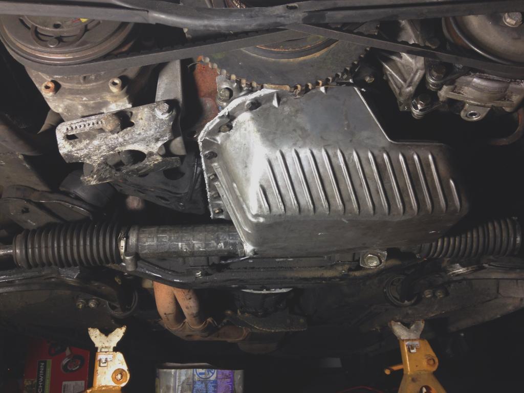

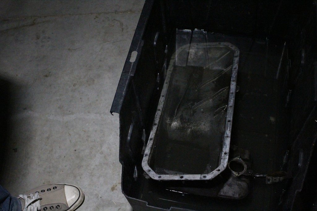

                          Hey r3v , I have good news and bad news.
                          The bad news , my oil pan has gone to be with the Lord .
                          The good news , ST1G sold me a new oil pan :ST1G:
                          Old pan off
                          New pan getting a spa treatment before install
                          New pan will be installed shortly . Also looking for a used skid plate .

                            Got the new pan up .
                            Had a few guys recommend Hondabond gasket maker instead of using a cork or paper gasket so hopefully it holds up nice . Anyone else use it ?
