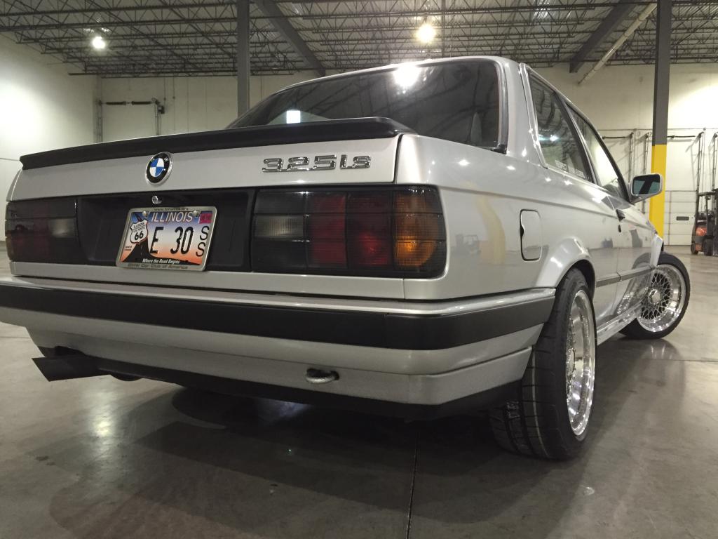

                Just noticed your plates. Now I know who got it before me LOL. But I scored pretty nice one too.
                    Haha I almost got the one you bought. I am not a huge Bulls fan but my wife is and she was a Luvable back in the day so since she bought me the car its kind of for her as well as me. Plus I am going with the black and red interior so its fitting.
