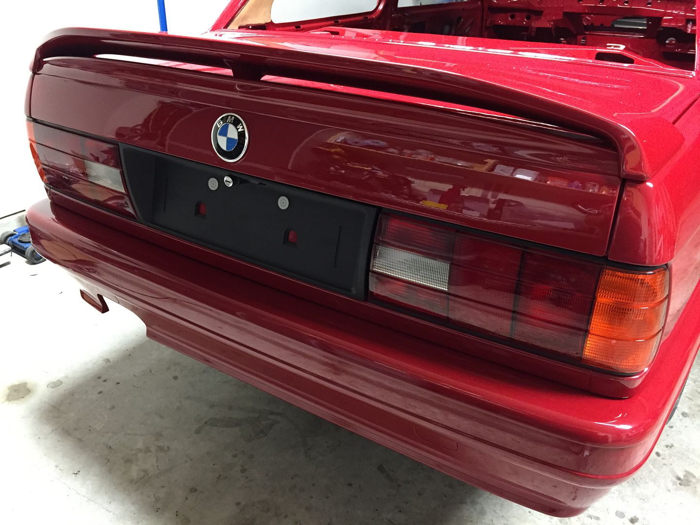

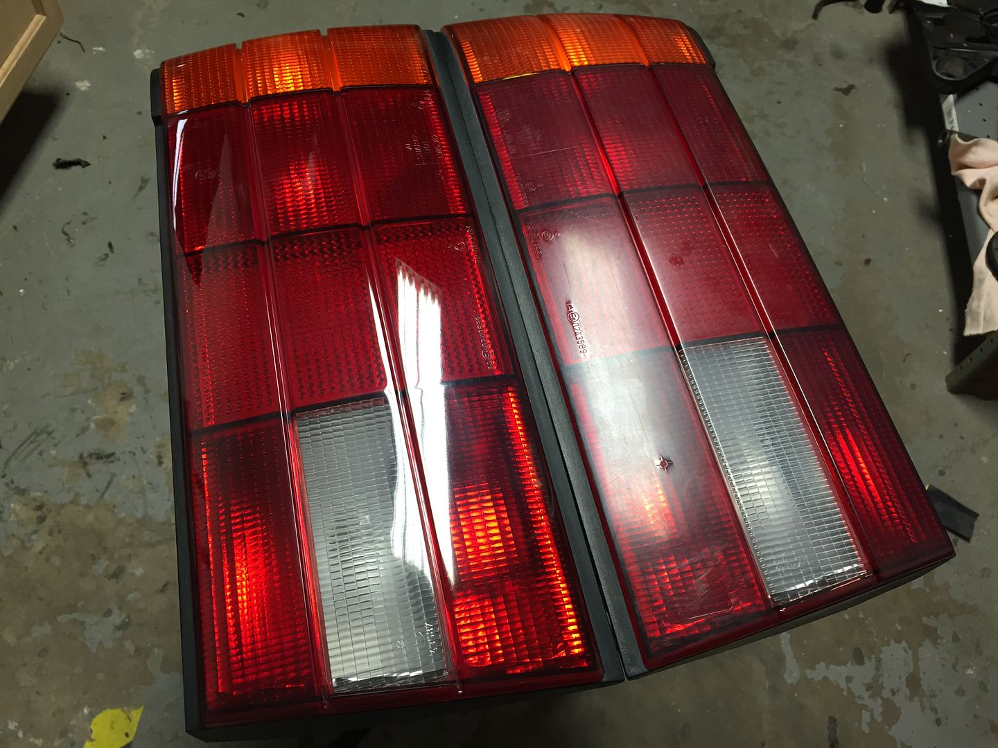

            I took my tail lamps into work today to use the pedistal buffer. We use it to polish headlights and I figured I'd give it a shot on the tail lamps. Both were in good shape if not dull from 25yrs of cosmetic abrasion etc.
            Fresh polished on the left, original on the right... not bad.

              Huge difference!

                Depending on the day, this thread either makes me get up and work on one of my E30s, or never try again! Great work! Do you use a compound when polishing the tail lights?

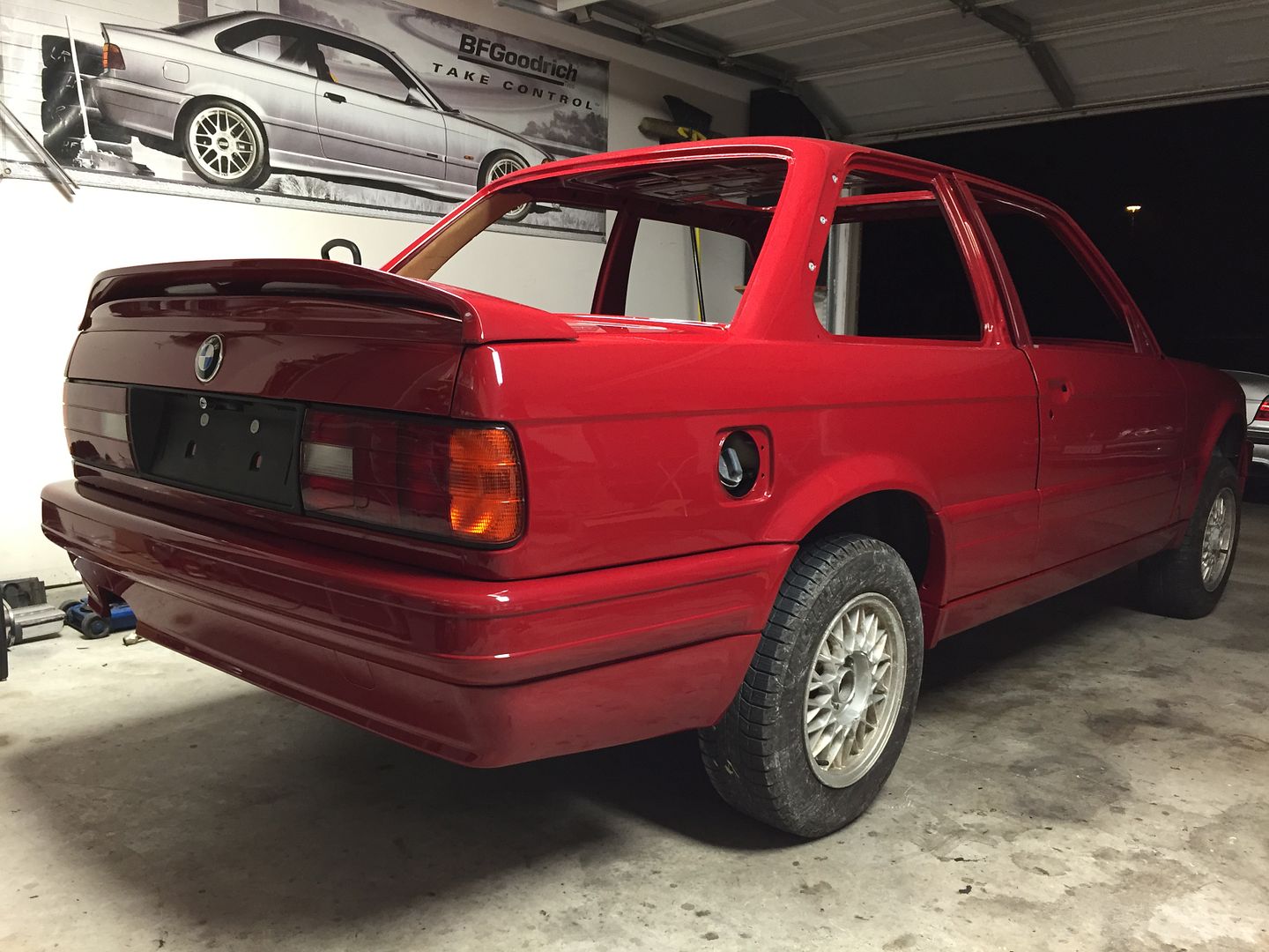

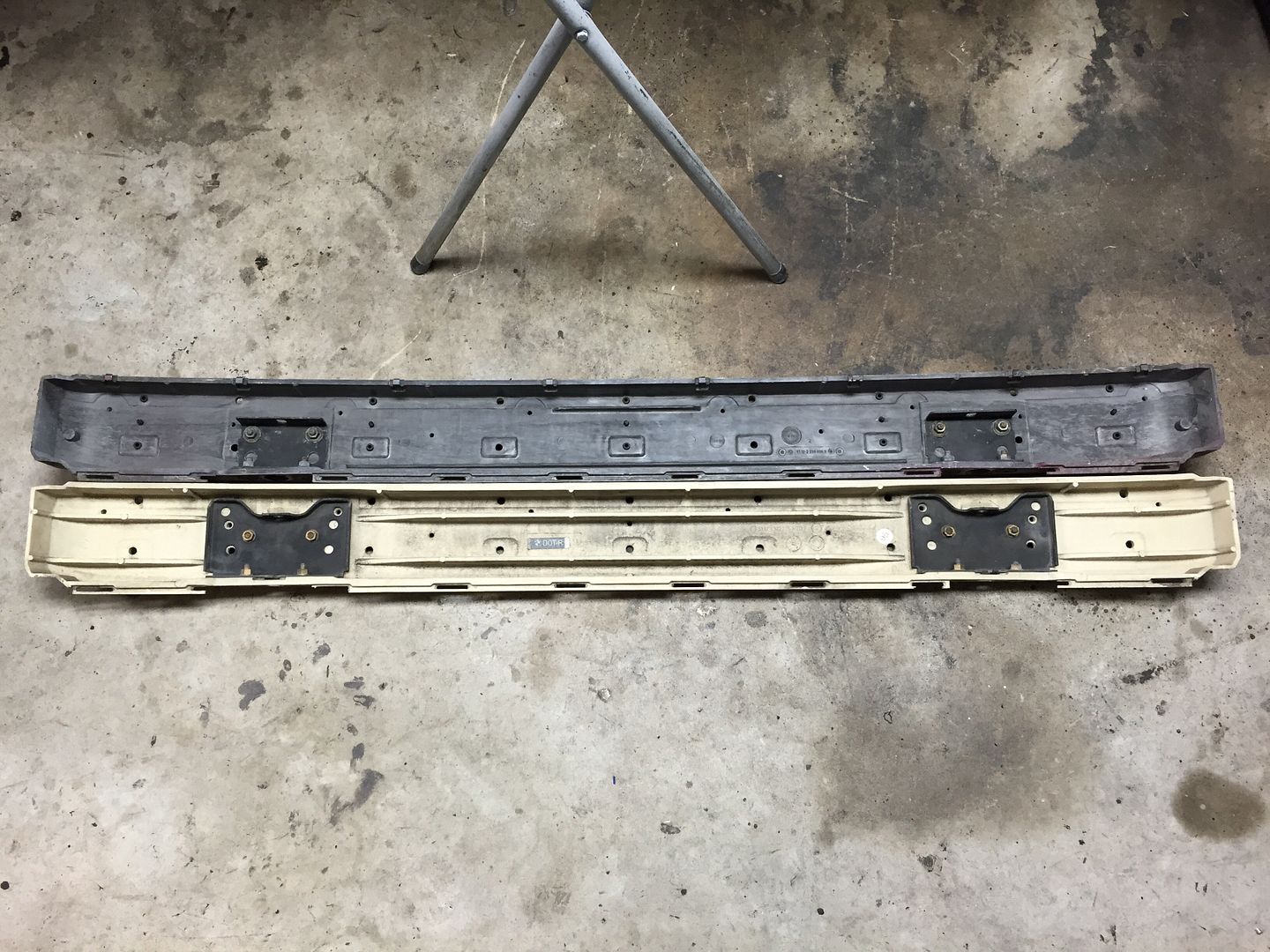

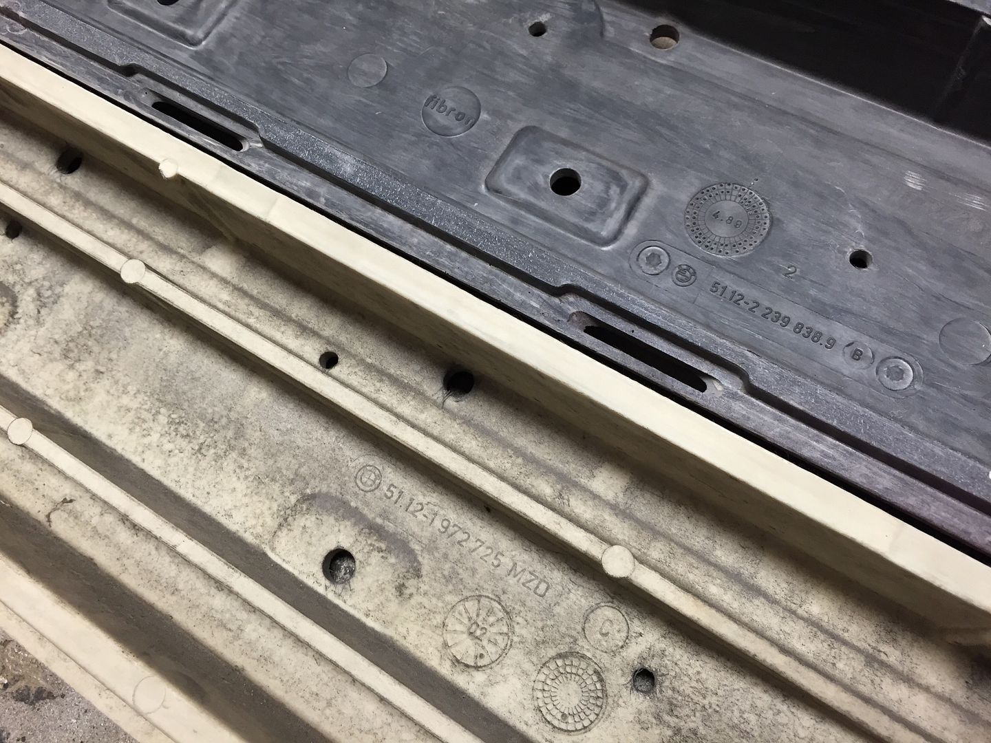

                  First matter of business tonight was to get the rear bumper mounted. I had already tried last night and found that the euro rear bumper brackets do not fit the US bumper shocks. The Euro ones are not as tall, nor as robust as their US counterparts.
                  The easiest way around this for me was to pull a rear bumper rebar/brackets/shocks from a parts car at work and put them side by side to see the differences.
                  Dark gray is euro, beige is US.
                  As you can see the US brackets are much larger, and the rebar has 2 horrizontal stiffeners. The US bumper rebar also lacks a number of predrilled holes for the MTechnic II rear bumper cover mounting hardware.
                  I concluded I would just swap the brackets from the US to the Euro. This worked perfectly and I mounted the bumper on the car without a problem.
                  I also fitted both tail lamps, and the new euro plate filler.
                  All of this took much longer than planned, so I guess I will mess with the chassis harness tomorrow.

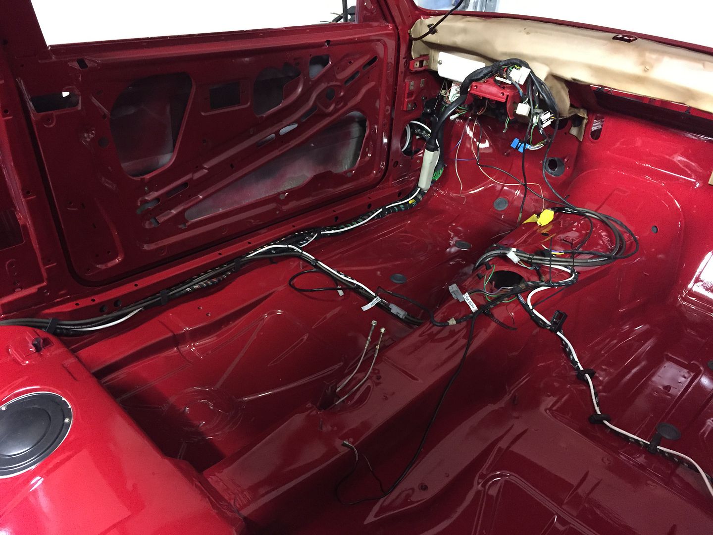

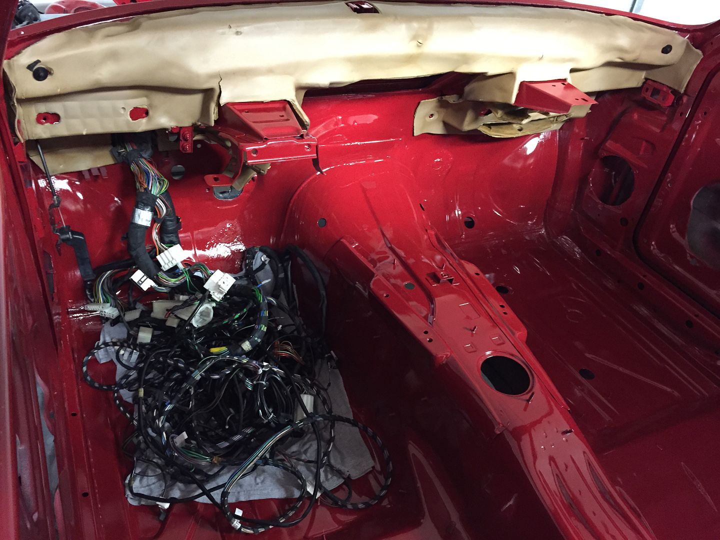

                              Last night I installed the body harness in the car. I got it all laid out into its final position(s) as well but neglected to take a picture of that.
                              I also got the under dash firewall insulation installed. I would have liked to have this new, but it is NLA. Since its concealed under the dash anyway I settled for a good used one from a donor car.

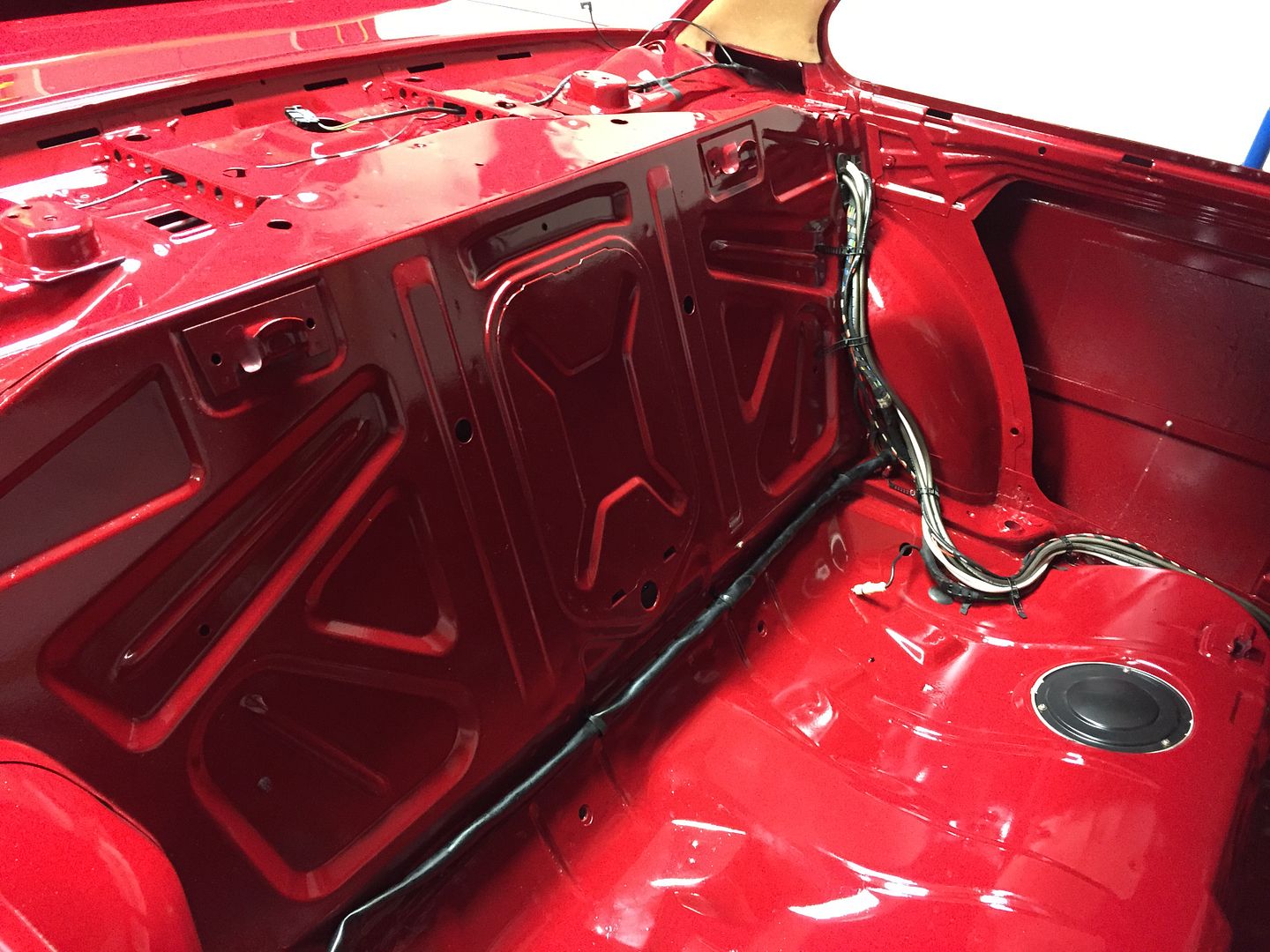

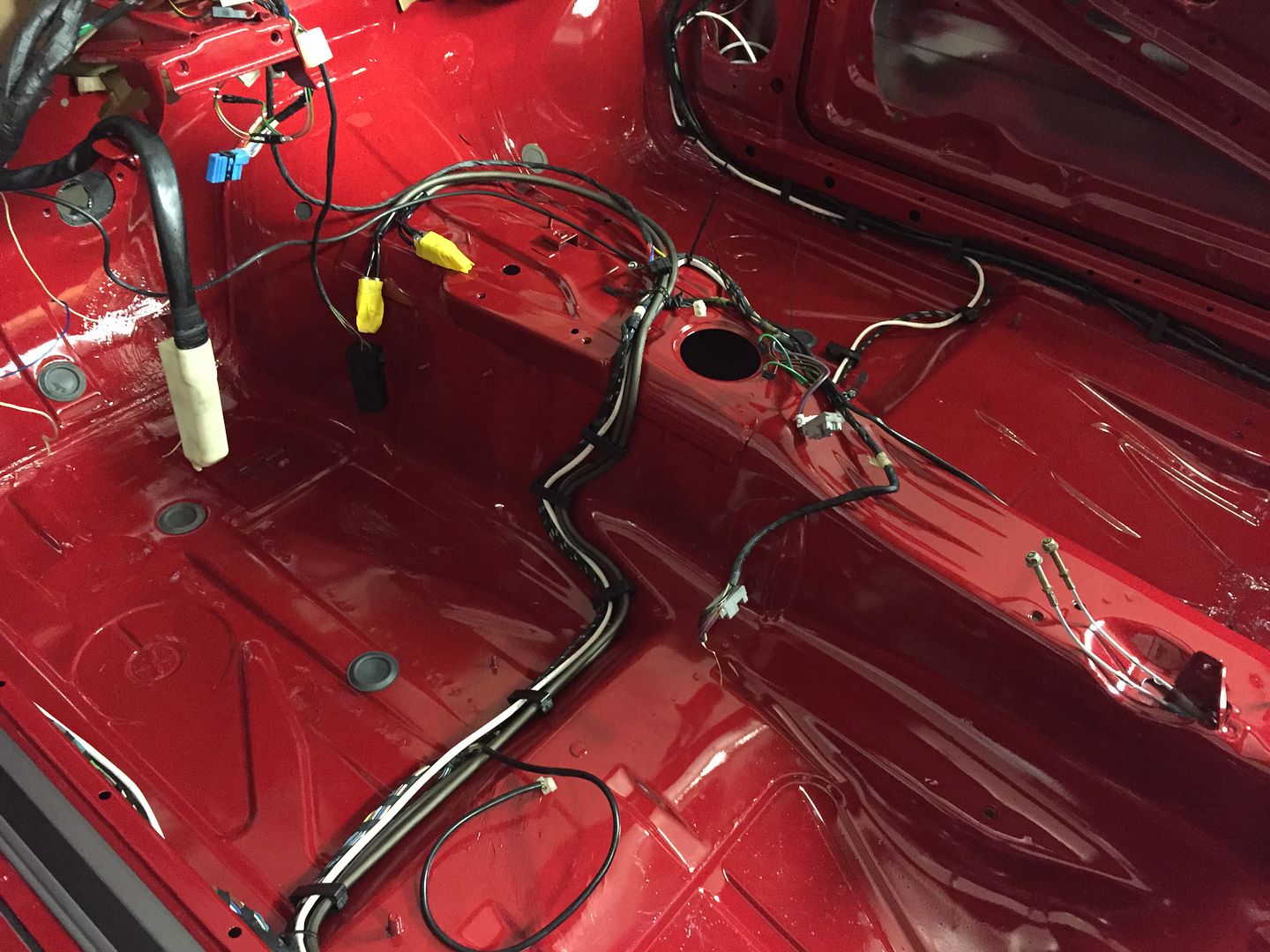

                                Wiring... so much wiring.
                                This evening I fit the wire harness to its final positions and installed of the OE clips back into place to secure it. While I'm in here I decided it would be the best time to run the 3 pair of RCA cables from the headunit area and new 16ga speaker wire to each corner. I wanted it all run along side the factory wiring for a clean look, even though no one will likely ever see it.
                                I also put a dozen or so body plugs into place, ran the large 12v cable front to back, and laid out an assortment of bracketry to prepare for the carpet to go back in.
