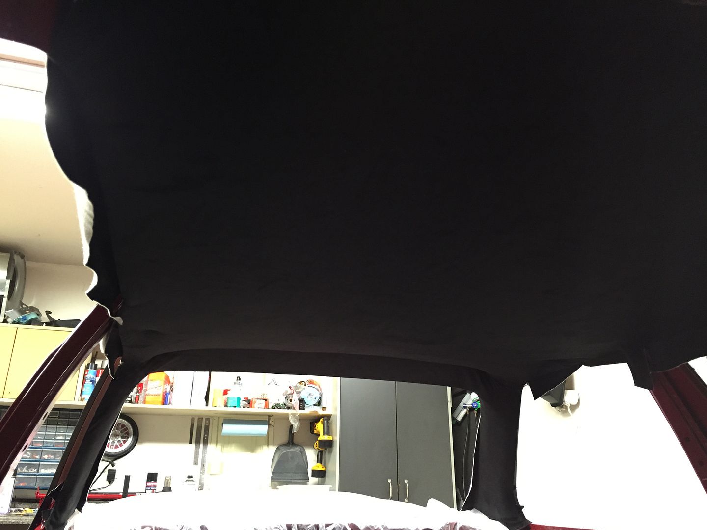

        OK so last night I did some work, but they pretty much went to sleep... and I decided to (sorta) take this evening off... so yesterdays update today!

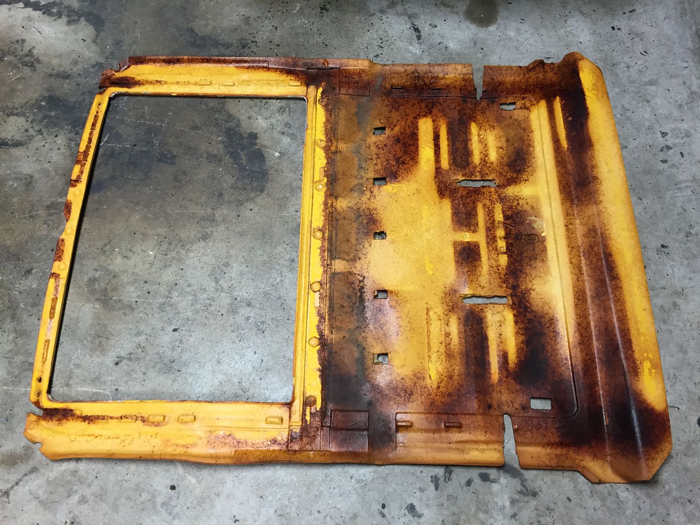

        Last night I returned home with the roof foam insert from a donor car at work. The previous owner had removed most of mine by force and left only small chucks for me to finish removing. It is removable intact although it definitely requires a gentle touch and some patience. It appears to still be available new but I wanted to not waste the $70 on this if I didn't have to.
        This foam provides a backing for the headliner, a locking mechanism for the headliner bows, and it shapes the sunroof opening contour. The burnt looking areas are the only adhesive.
        I have no idea what the factory actually used but I like the hell out of Weldwood Contact Cement. I purchased it in aerosol form for this foam.

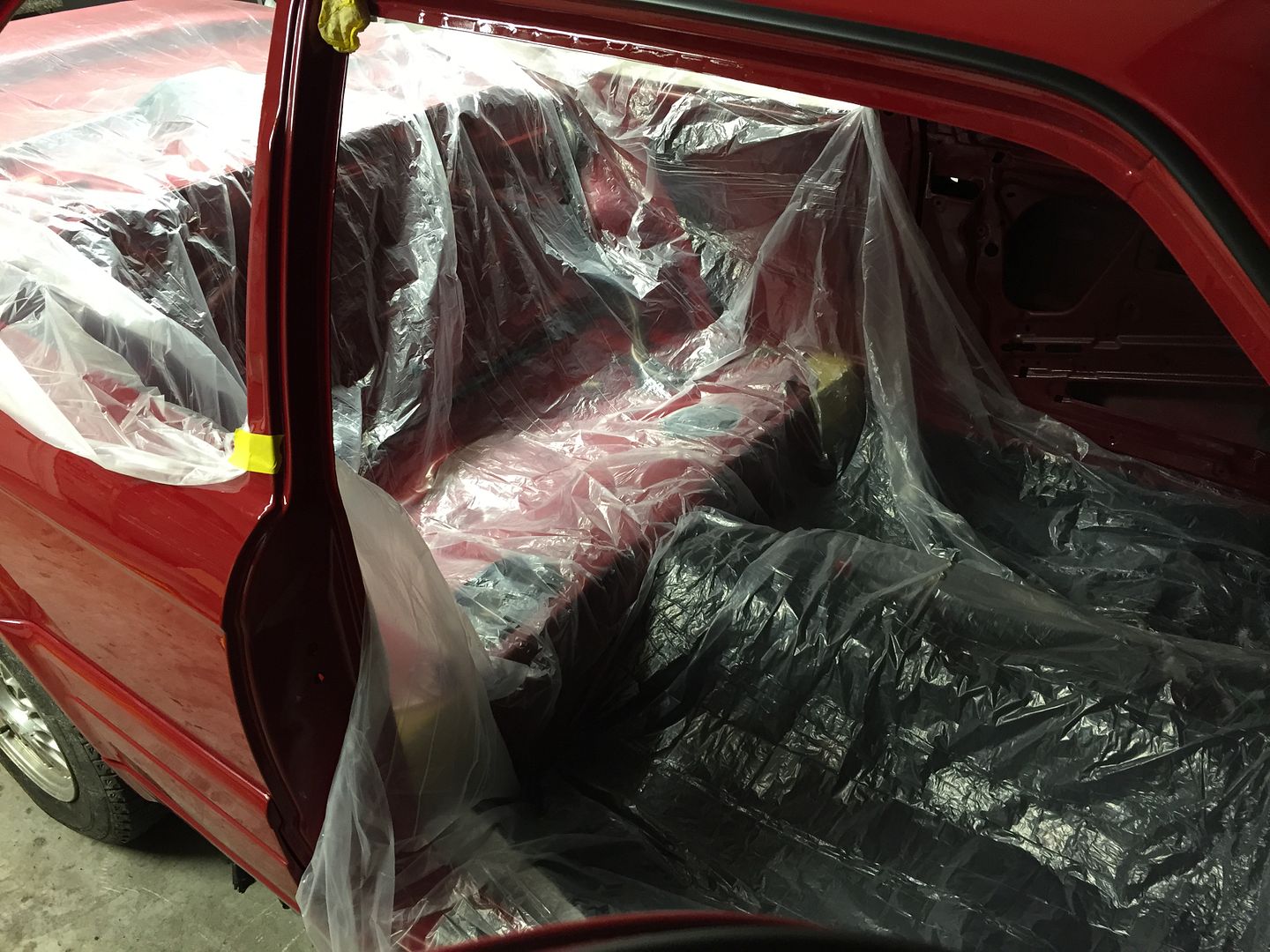

        Since I didn't want any possible overspray to settle on the carpet or paint I masked off the work area:
        I then sprayed the contact cement on both the roof and the foam, then joined the two after a few minutes. With the foam set solidly in place I unpacked the headliner.
        This headliner is a Alcantara type material, and it is made by a forum member on R3V "AK-" He will be bringing them to market as a forum offering soon, and if you're interested in one you should PM him.
        Inserting the metal bows that run side to side:

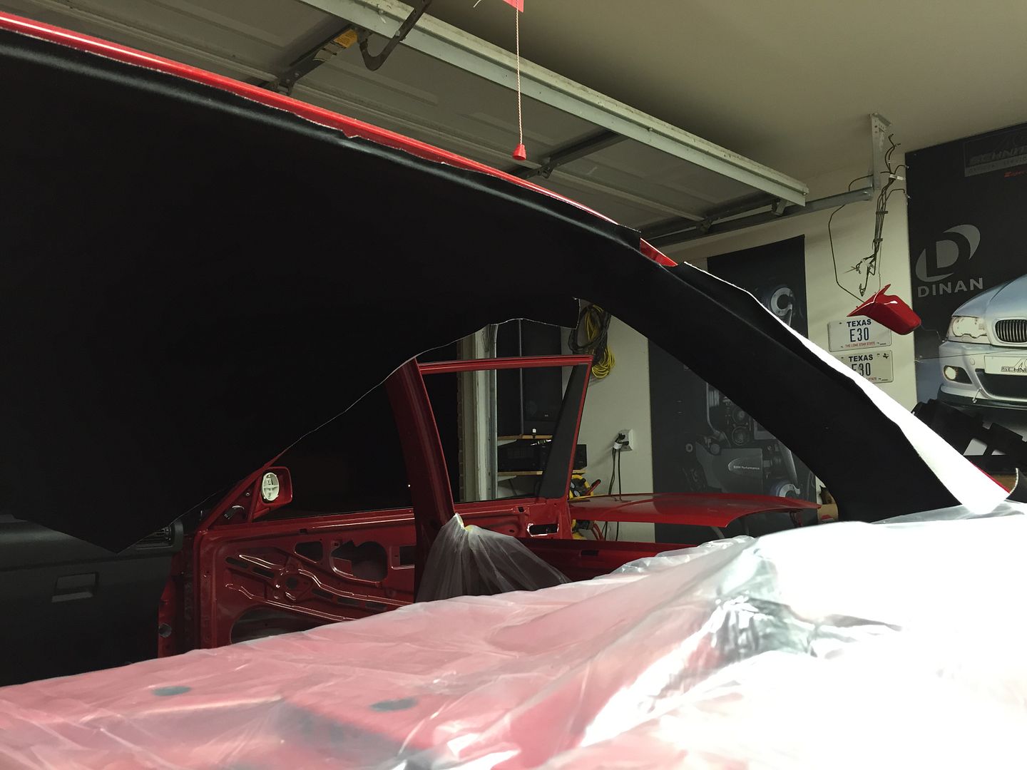

        Using brush on Weldwood Contact Cement to pull the headliner tight over the window frames and set it in place. This is the part that requires the most diligence, and you may have to pull it off and reposition as you go to get any wrinkles smoothed out with even tension. A rush job here will leave the headliner looking bad with sags and wrinkles.
        Nearly done now, save for the sunroof cutout which I will tackle this weekend:

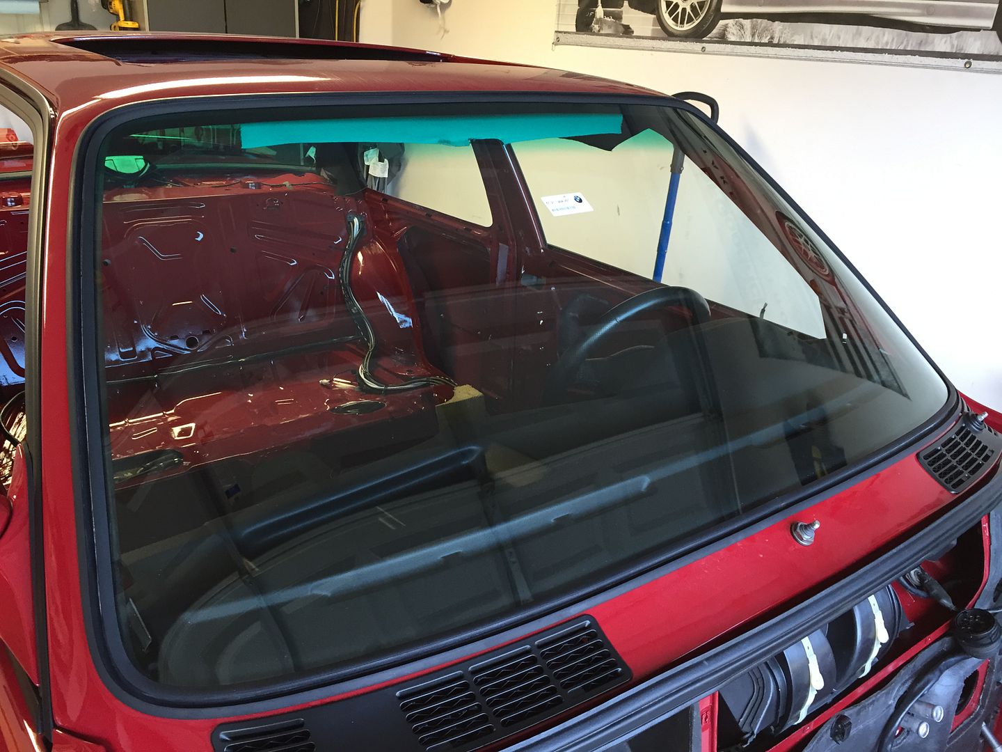

                          Rear windshield gasket and glass installed, I was reminded at length how much I hate installing locking strips while I make sure not to slip and gouge the paint.
                          OE BMW front windshield new in the box it comes in, quite well packed:
                          New front windshield installed in gasket:
                          New fuse box cover:
                          New door seals:
