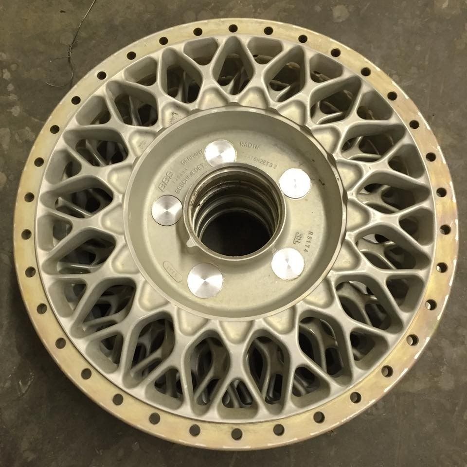

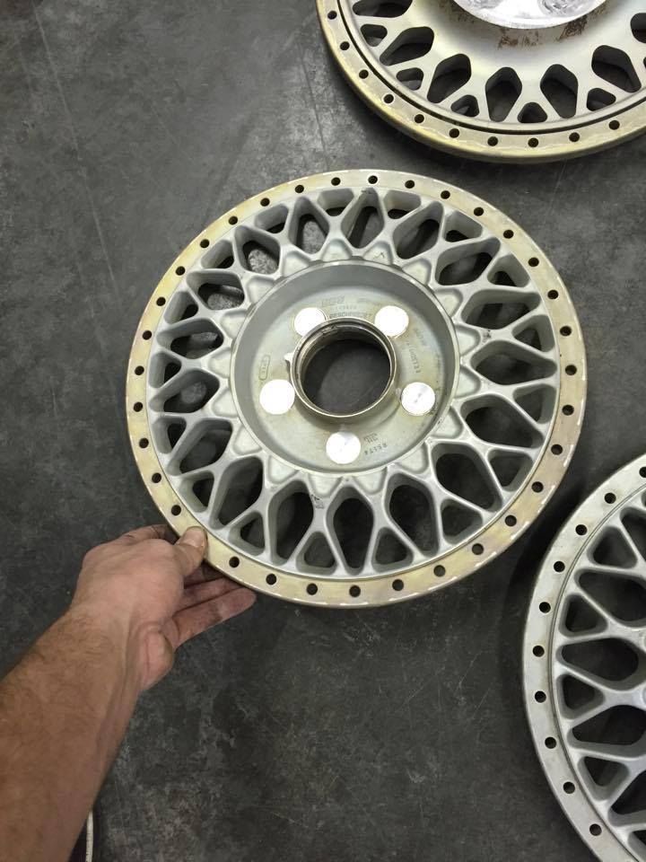

          I've been sitting on an update for Ehrlich Wheel Works for a bit, but I wanted to go ahead and post it up now. As I'd mentioned earlier Paul is building me some custom RS wheels. To make them the sizes I wanted it meant a fill and drill of some RS211 faces. Paul is an expert in bolt pattern conversions, one of few outfits that do the process with such precision.
          First Paul machines pressure fit billet aluminum plugs, which are then hydraulically pressed into the existing lug pattern effectively filling the center of the wheel and making it solid. Some vendors would stop at this point, redrill the new bolt pattern and call it a day.

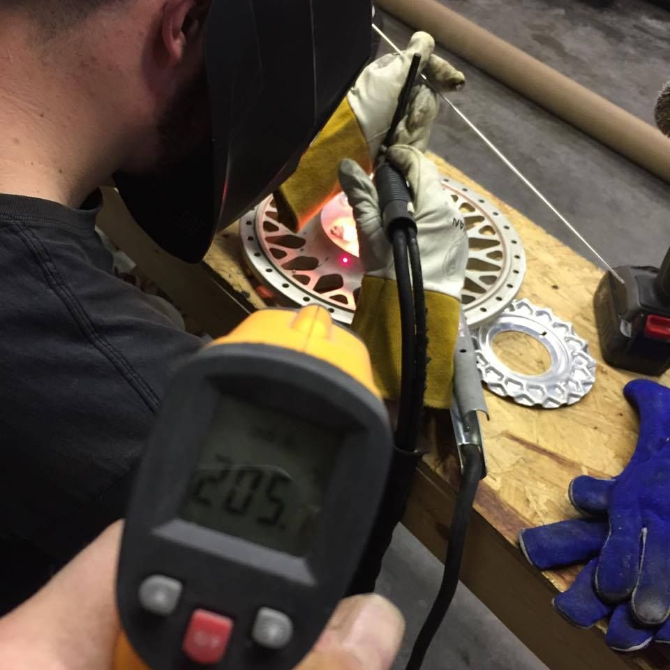

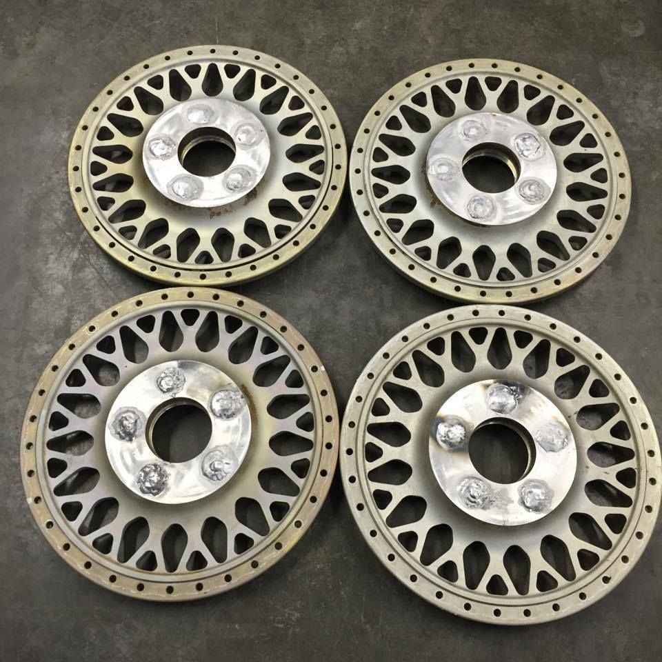

          Once the wheel is filled he goes one step further, expertly tig welding the plugs to the wheel permanently fusing them to the forged centers. This is done with finite control of the TIG arc to minimize the heat propagation into the wheel faces. On wheel temperature readings fluctuate around 200F while welding, much cooler than you can expect under hard driving from vented brake heat.
          The finish welded face can be picked up on the edges by hand immediately after welding.
          The finish welded hubs are now ready to be mounted on a lathe and milled down flat.

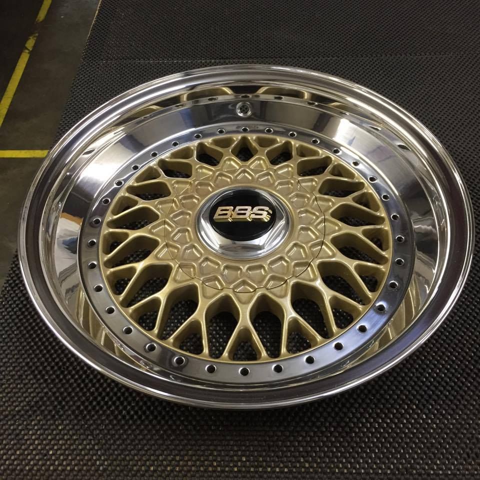

          Paul was kind enough to assemble my 2" slant lips, his custom made 1/3 height hex caps, and a black/gold 3D BBS logo onto an identical painted face to mine to give a preview of the wheel to be.

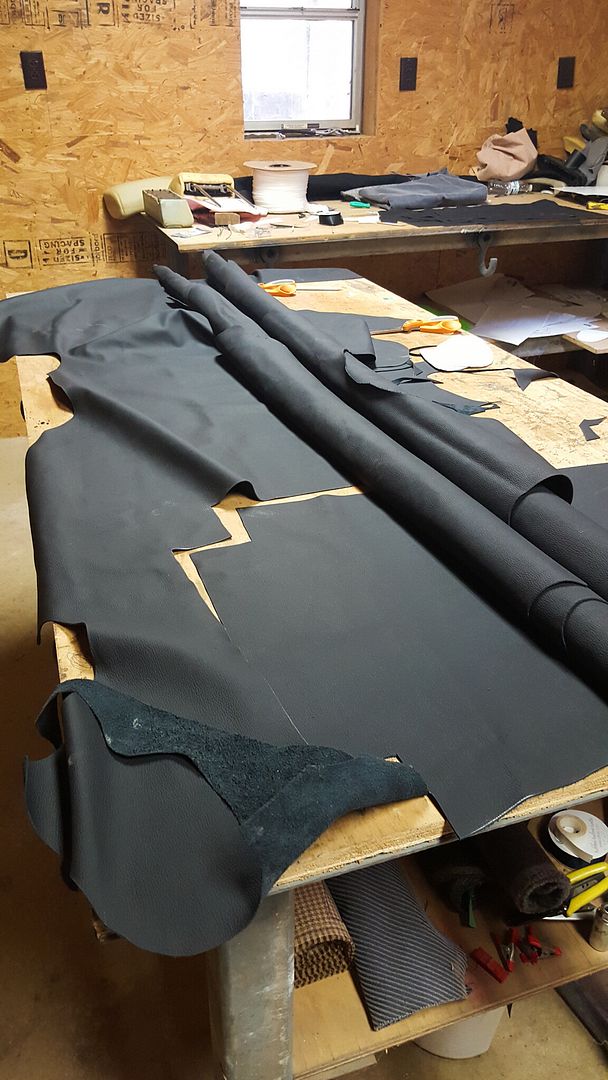

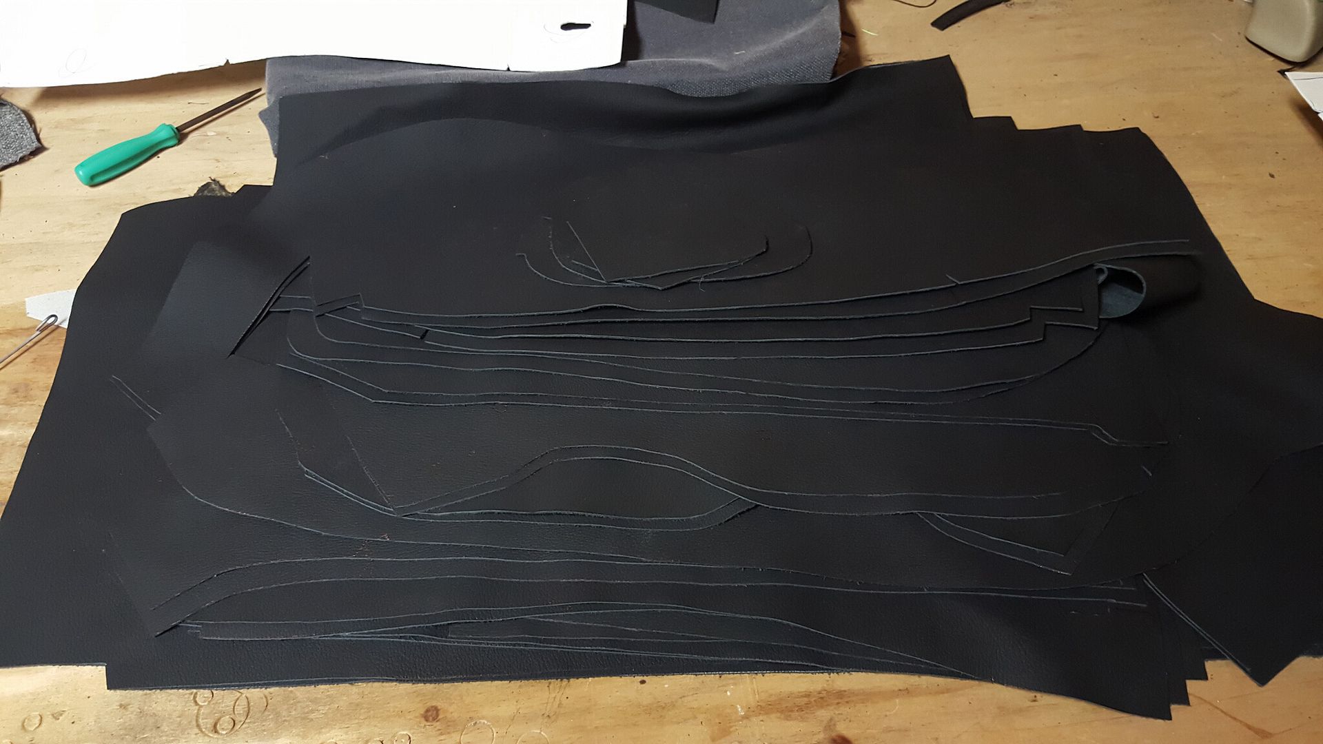

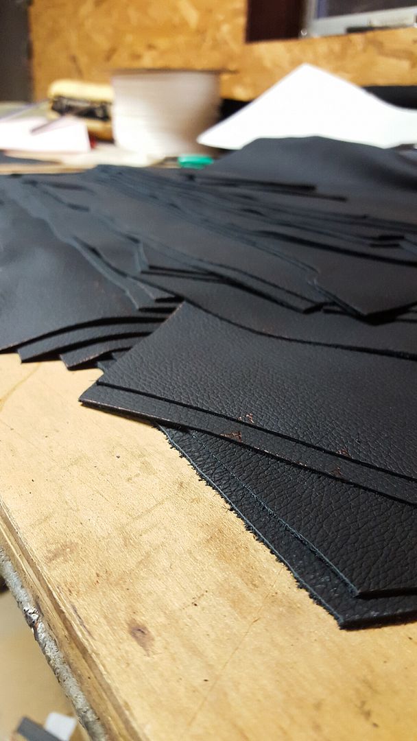

          Much anticipated progress has been made on the interior as well. I'm excited to say I'm working with Jordan @ StitchedWheels to recover the interior. By the VIN code this vehicle was originally "SCHWARZ KUNSTLEDER (0166)" AKA Black Leatherette. While black vinyl seats appropriate to a 318iS aren't hard to find in good condition I really felt this car and the quality being put into the build deserved more.
          I decided on keeping the interior black, but stepping up to leather. I worked with Jordan to source and purchase 3 hides of OE BMW Schwarz leather to recover the interior with. The hides came in a few days ago and he has been hard at working cutting out the complex array of pieces to make up the front seats. It takes one hide per front seat, and one for the rear seat with enough extra material for some small parts like a matching shifter boot, ebrake boot, and retrimmed M-Technic II steering wheel.
          If Jordan keeps on schedule he is planning on making the drive down from Mississippi to Houston to help recover the seats in person!

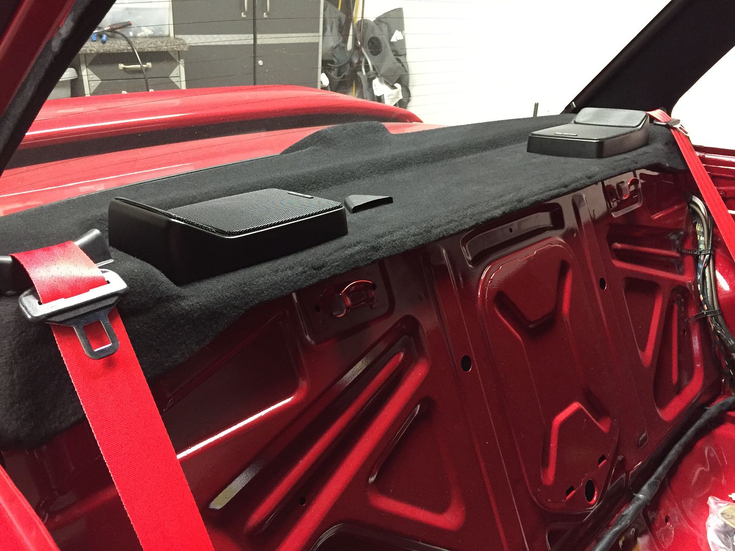

                  I got my seatbelts back from stitching today. Installed the rears, along with the parcel shelf and the premium system speakers.

                    Did you swap out the speakers and use the housing?

                      Is that a new rear shelf or was it recovered?

                        #281
                          Nope, the car still has all of the original premium sound system speakers. This car was non-premium by birth so its been upgraded. They sound pretty good when provided a clean source and ample power.
                          It was dyed black.

                              #284
                              What did you use to dye the rear shelf? I was planning on doing mine this spring when I upgrade to premium speakers as well.
