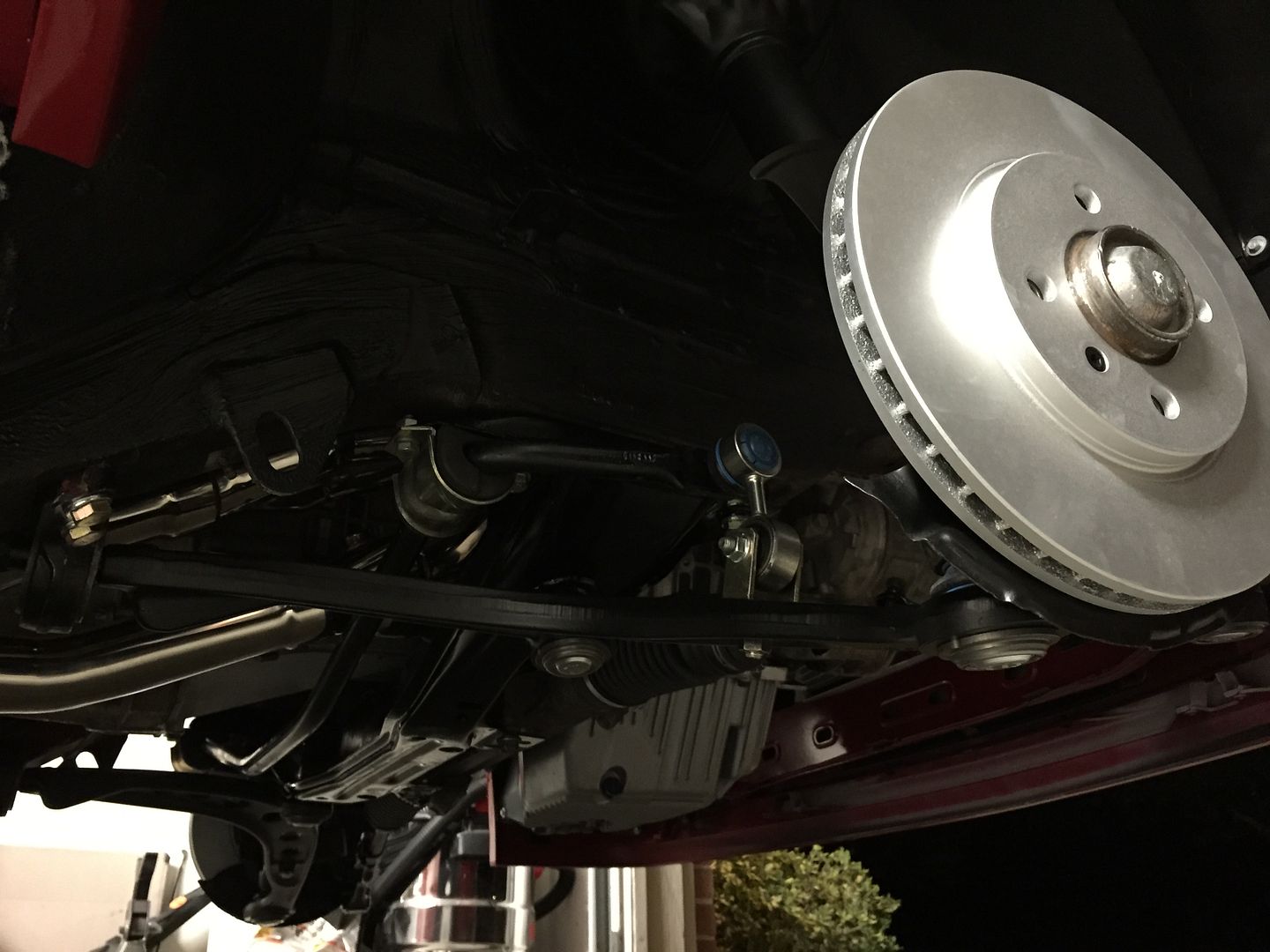

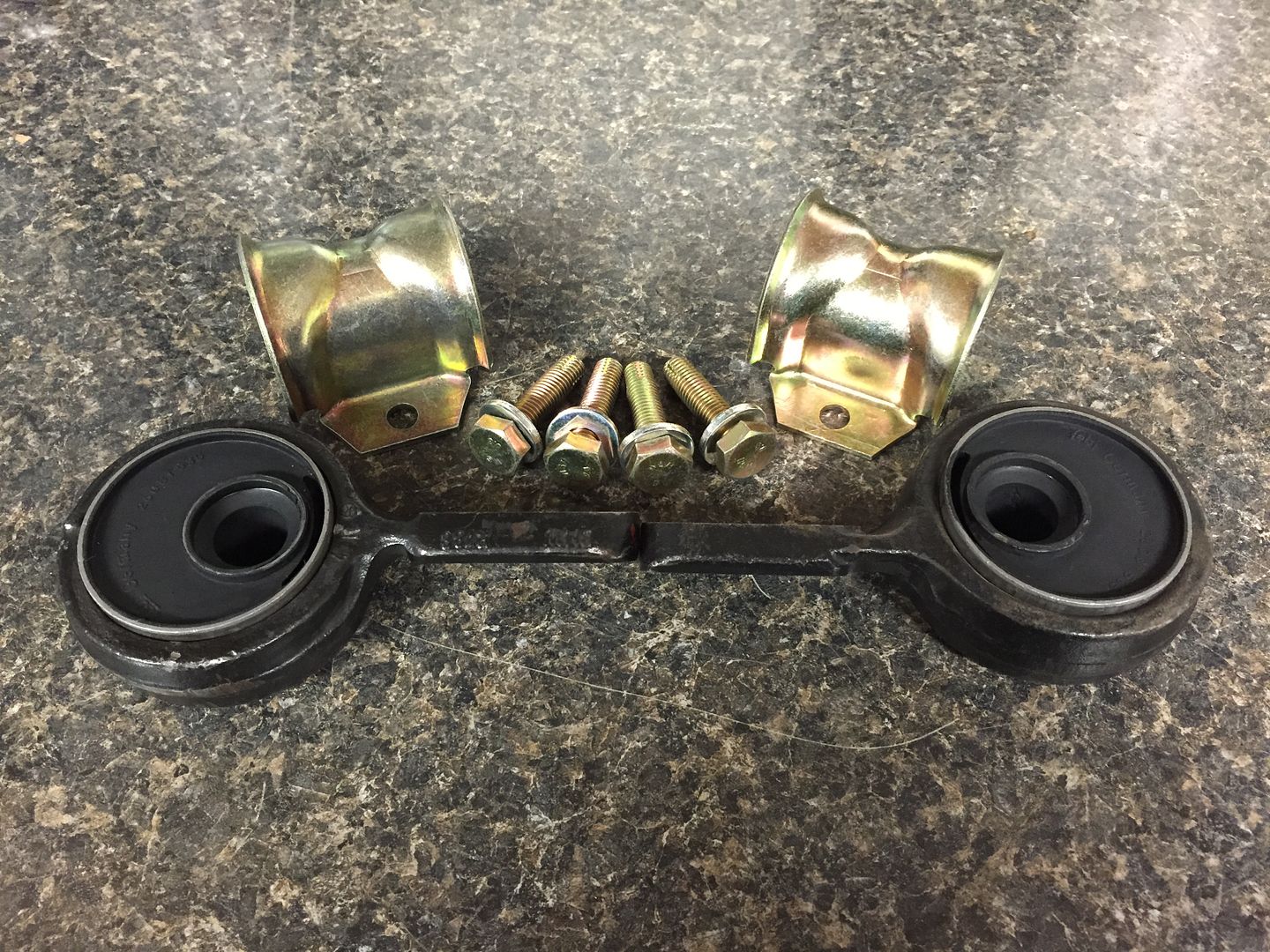

          Not much to report this evening, mainly preparing for Jordan @ StitchedWheels arrival tomorrrow, but wrapping up the front suspension got squeezed in.
          New offset control arm bushings, bolts, washers, sway bar brackets, and the E46 steering bellows with the correct crimp clamps. Upgraded to the +1mm cabrio front sway bar at the same time.

            Where did you put the jack when you lowered the car down? I'm guessing 2x4 across the core support and the jack under that?
            Looking great!
            • Jordan
              • 12907
              #336
              The 2x4 bridged the same gap across the trans tunnel, frame rails as the S shaped brace behind the trans crossmember.

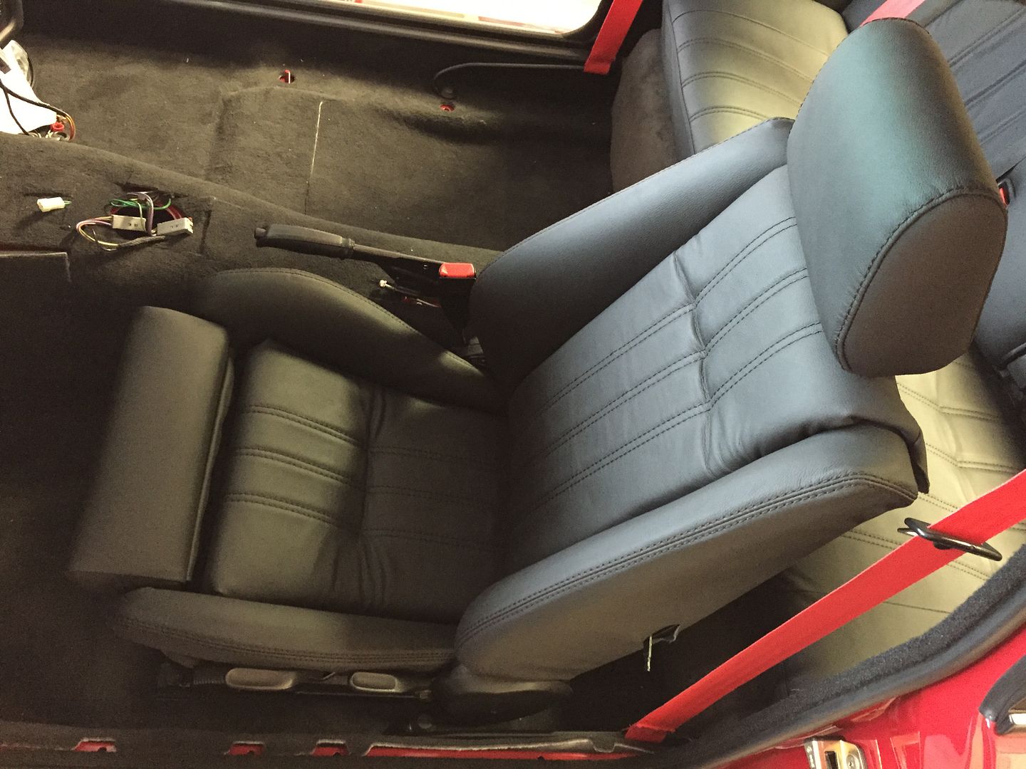

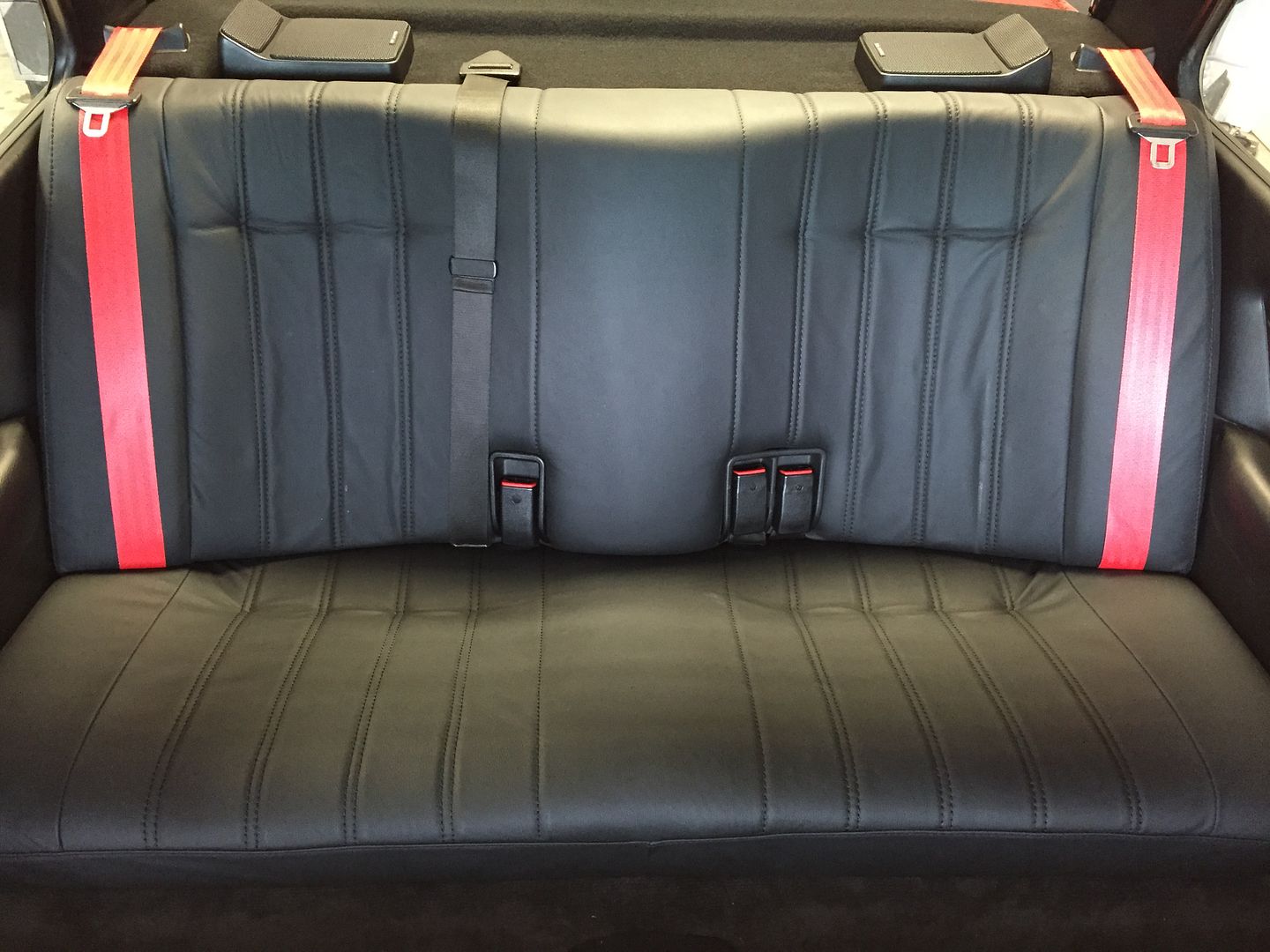

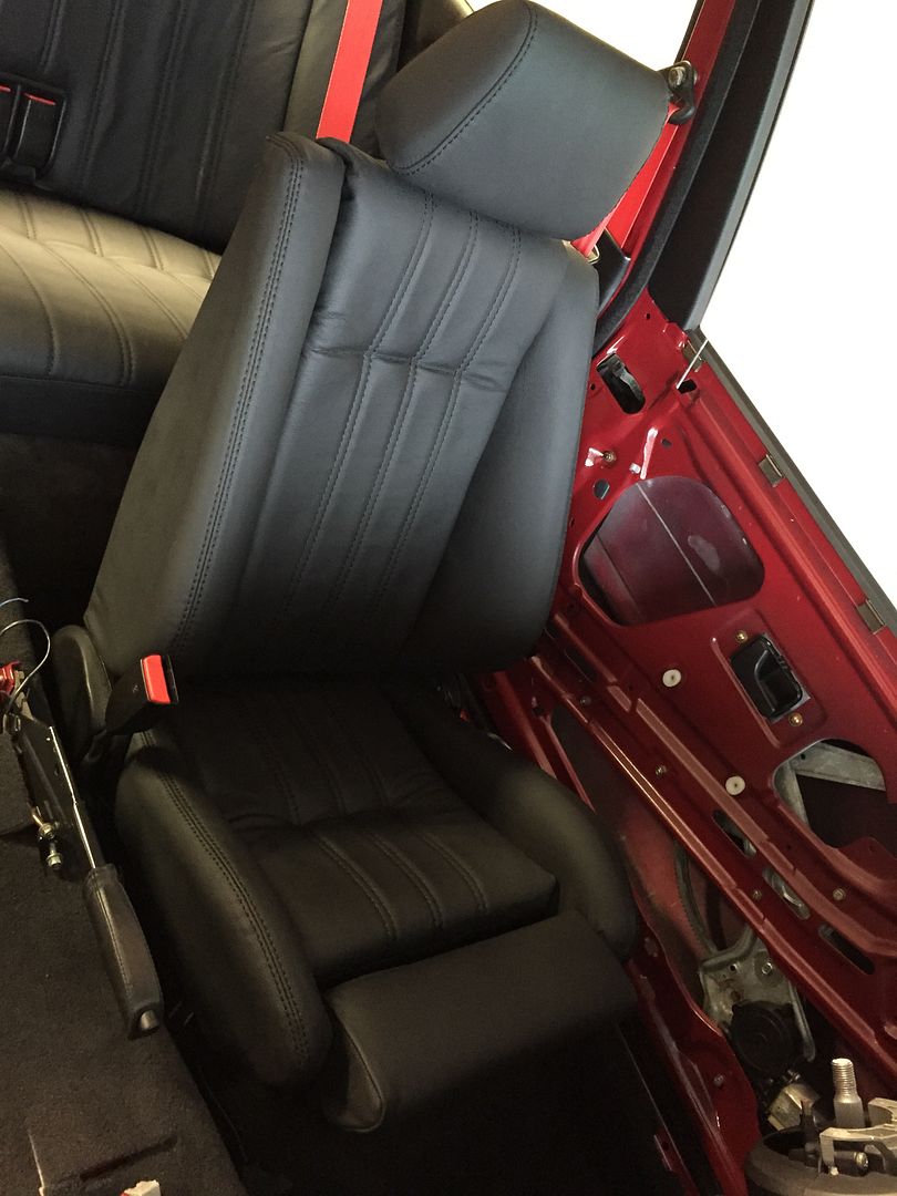

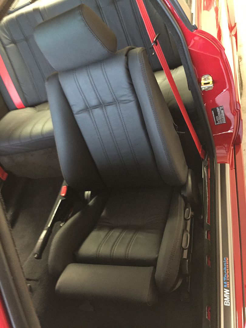

                            Those of you following along on R3V FB today got a sneak peak of the interior work going into the car. Jordan @ StitchedWheels made the nearly 7hr drive down to Houston last night and we spent most of the day fitting the seat covers he built to the seats.

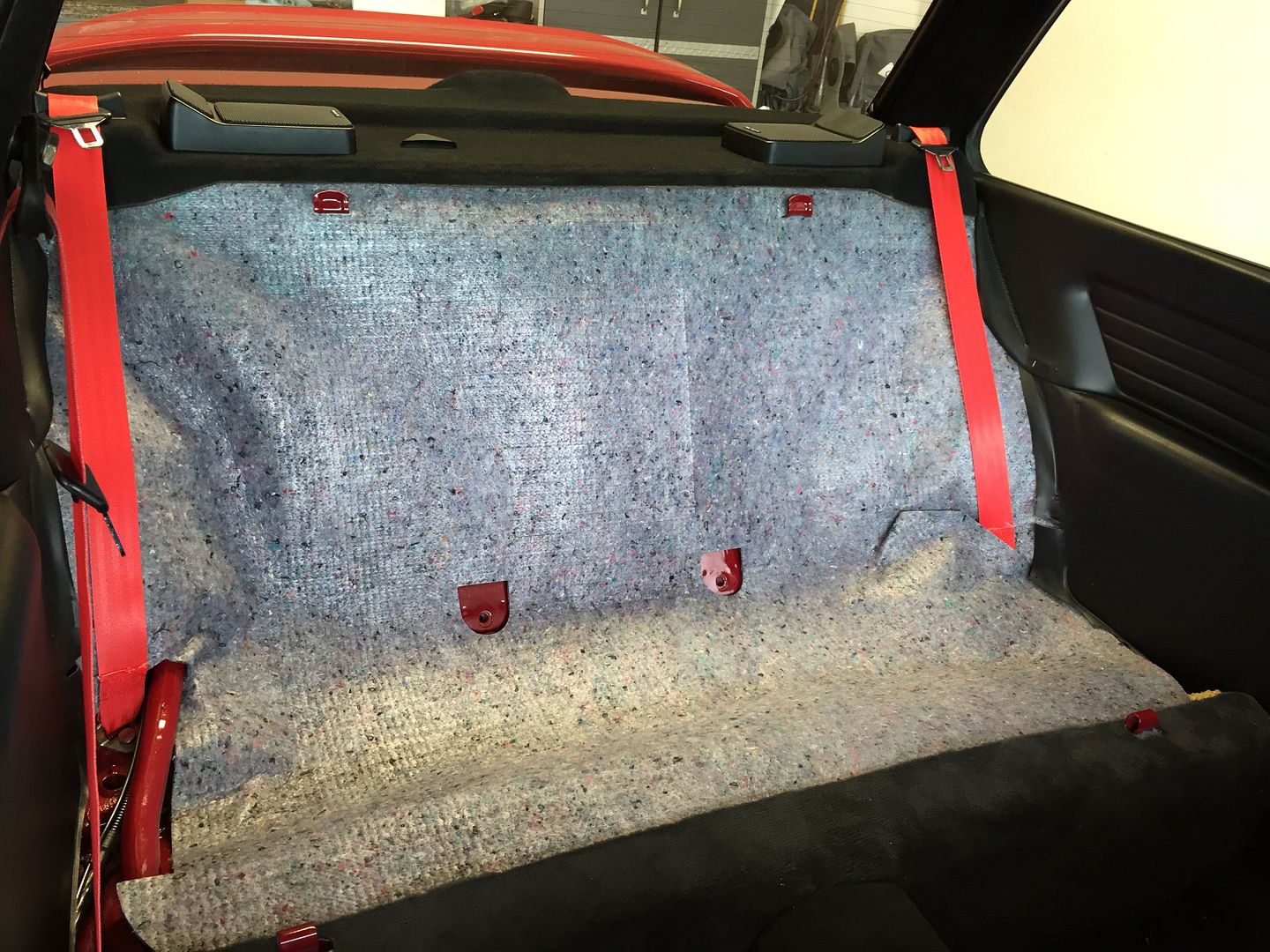

                            I started by flipping the rear seat jute around as it was inside out before.

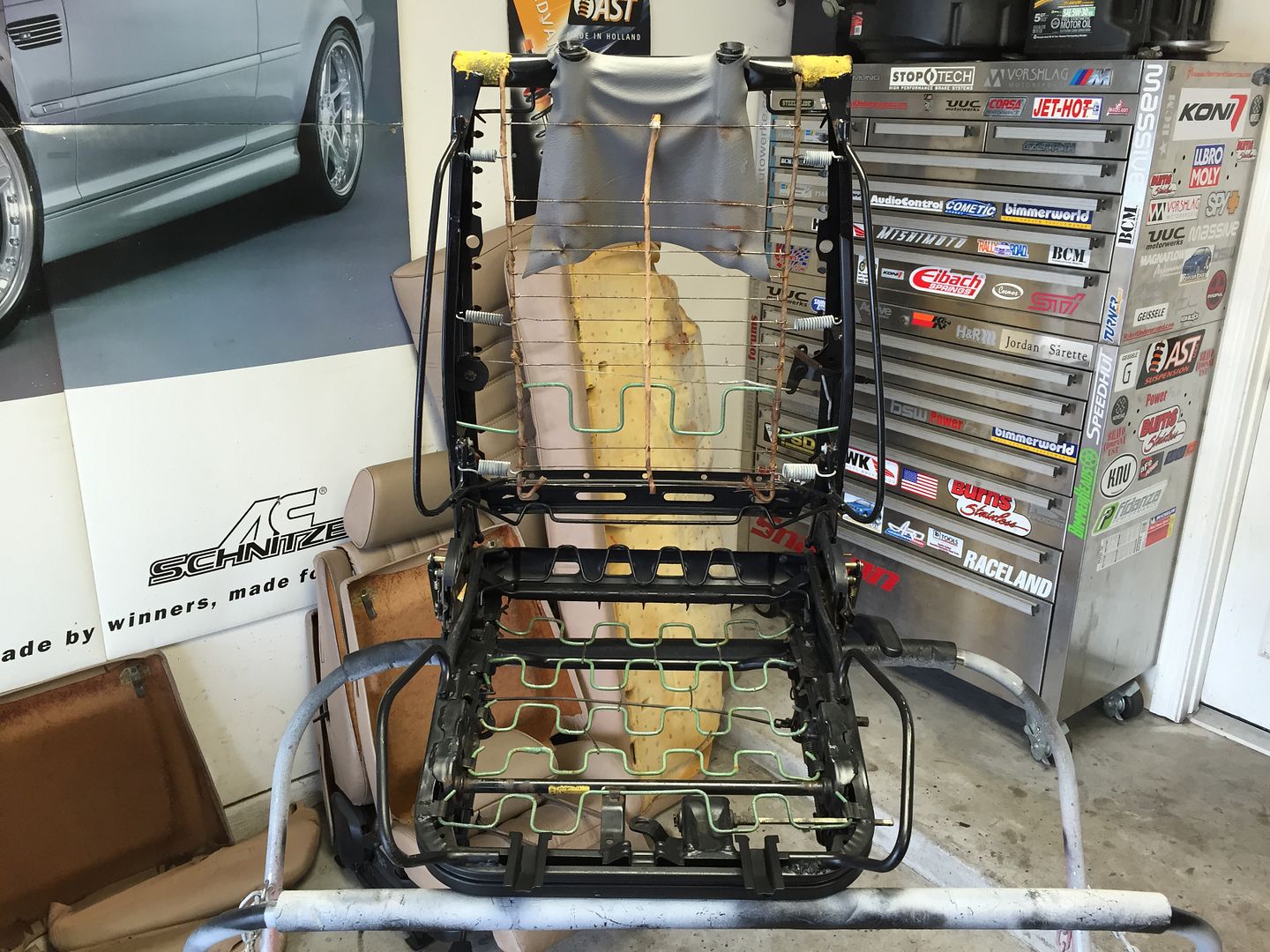

                            I then stripped the drivers seat of all of the old covering, and the foam. The drivers lower outside bolster hoop had broken off the frame so I positioned it back where it belonged and welded it up. A little bending and prying had the bolster frames squared back up to where they belong. They get bent outward over time.
                            Jordan had already taken the liberty of fitting the rear seat covers to his personal rear seat which he traded me out with for mine. This part slapped in really quick.
                            The front seats took much longer to adjust and fit and finesse to get just right, to say I'm happy with how they turned out is an understatement.
