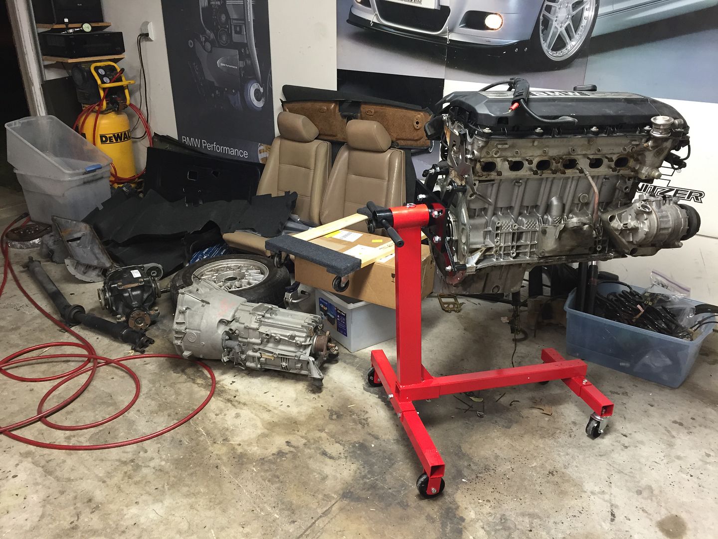

      I managed with the assistance of a coworker today, to get all the large heavy powertrain items I've had stored at work until now home. Now starts the tear down and cleaning, and I'll go over the engine top and bottom to make sure everything is in order. Change all pertinent gaskets etc.
      M54b30
      GS6-37BZ 6MT
      Z3 3.46:1 Torsen differential
      e36 M3 AT driveshaft
      E34 oil pan/dipstick
      Twinmass flywheel from a GS6-37BZ equipped car
      I hope to get most of this work done tomorrow, along with the oil pump pickup tube fabrication. The e34 pickup will not work with the M54 oil pump.

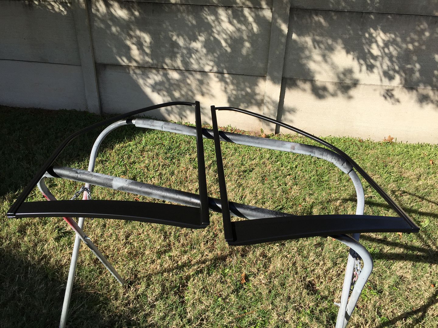

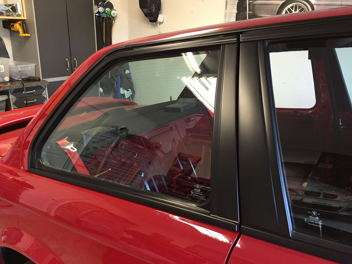

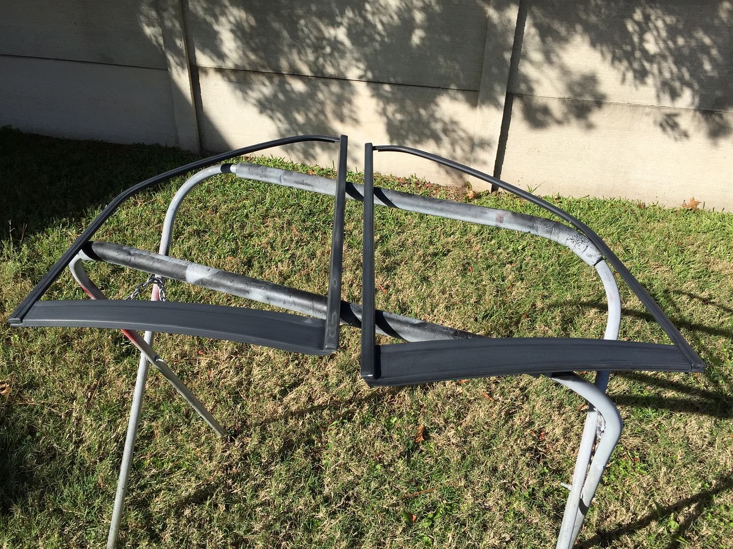

                    Not a whole lot of stuff going on today, although a local did stop by and bring me some donated rear window trims that I have been badly in need of. The previous owner bent the originals up pretty bad but these replacements are great.
                    I sanded them down to clean up some scuffs, then shot them with a fresh coat of SEM 39143 to match the rest of the shadowline. Installed the trim into the window/gasket assembly then installed those into the car. All of the matching Sicursiv glass is now installed on the car. So happy, little progress but big difference in appearance.

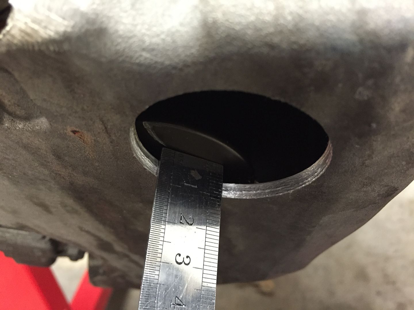

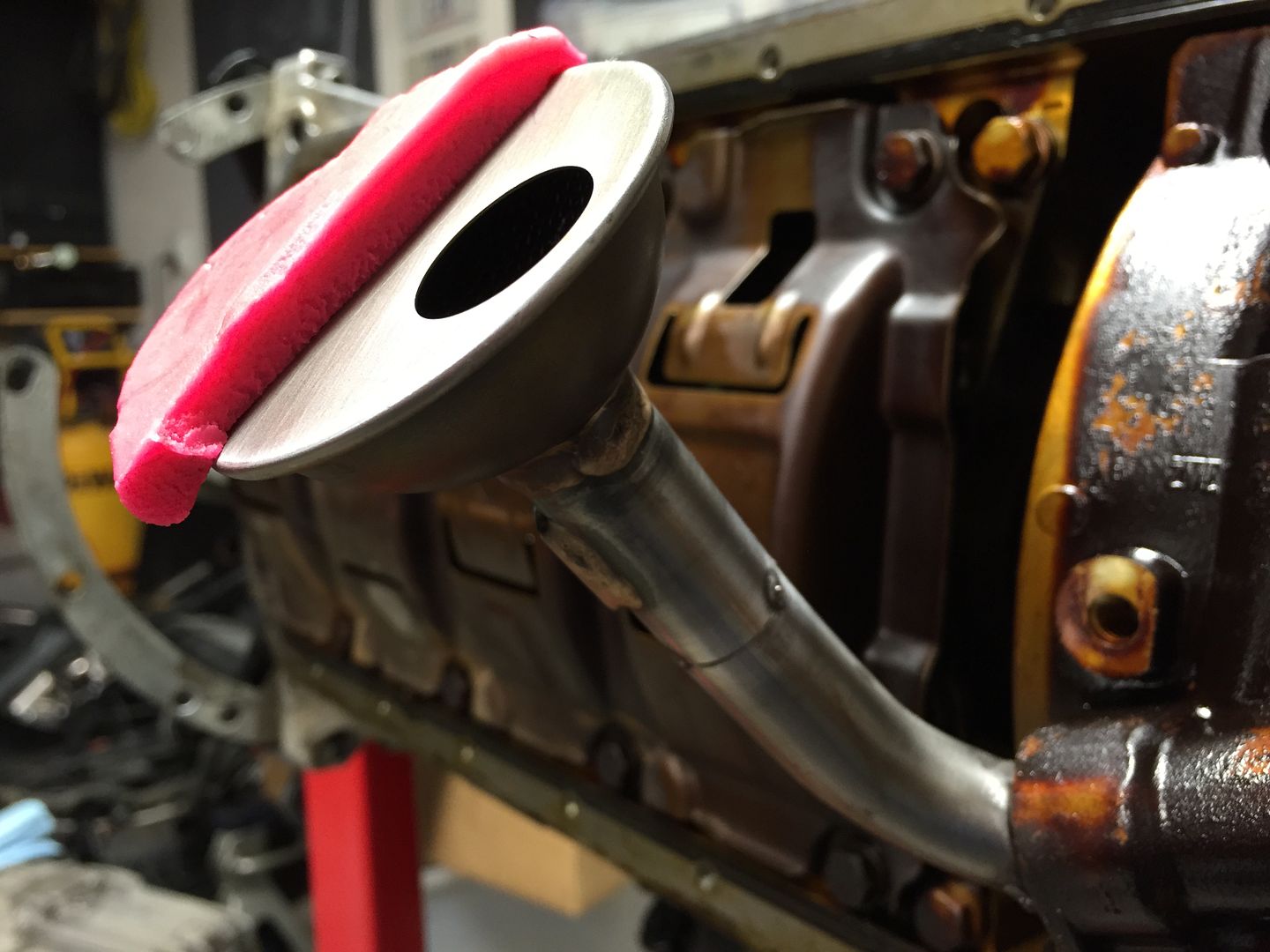

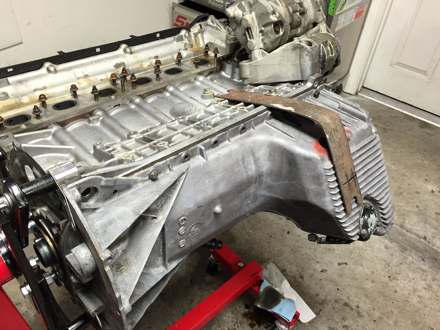

                        I had told myself I was done for the day earlier, but then I decided to go back into the garage to do some more work.
                        I set out to fabricate the new sump pickup tube as the E34 pickup tube will not work on the M54 oil pump. Nor will the E34 oil pump for that matter, leaving you to fabricate the tube yourself. I've also read that the European E38 728i oil pickup tube will work, P/N 11417503261 but my schedule at this point mandates simply making it work.
                        First thing first I grabbed a hole saw, approximated the dump pickup location and popped a hole in the E46 pan. I wanted to know how much standoff there was between the pickup and the inner bottom of the pan. Survey says 5mm.
                        Next I bent some steel plate I had laying around to create a jig against the outer bottom of the E34 oil pan. I taped a spacer to the inside of it to account for the thickness of the pan and the desired standoff.
                        Once I was done chopping and sectioning the M54 pickup down into a size that would work I test fit the E34 pan again, with some pink Play-Doh I stole from the kids on the pickup and squashed it down. End result is right on the money. 5mm+- a smidge. I'll drop this off to get TIG'd Monday.

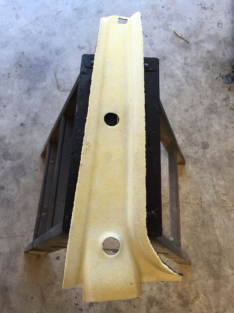

                              Part of todays goal was to tidy up the garage to leave maximum work space for when Jordan @ StitchedWheels arrives next weekend to do the interior retrim. To that end it was time to fish the trunk harness into its position, install the lock servo, install the shiny new license plate lamps, and fit the trunk liners.
                              With all of the trunk liners in place I can now store some soft parts in the trunk until they are needed, mainly interior trims. While I was in there I moved the trunk springs to the second notch detent to compensate for the added weight of the MTechnic II rear spoiler, which has conked me on the head more than once thus far.

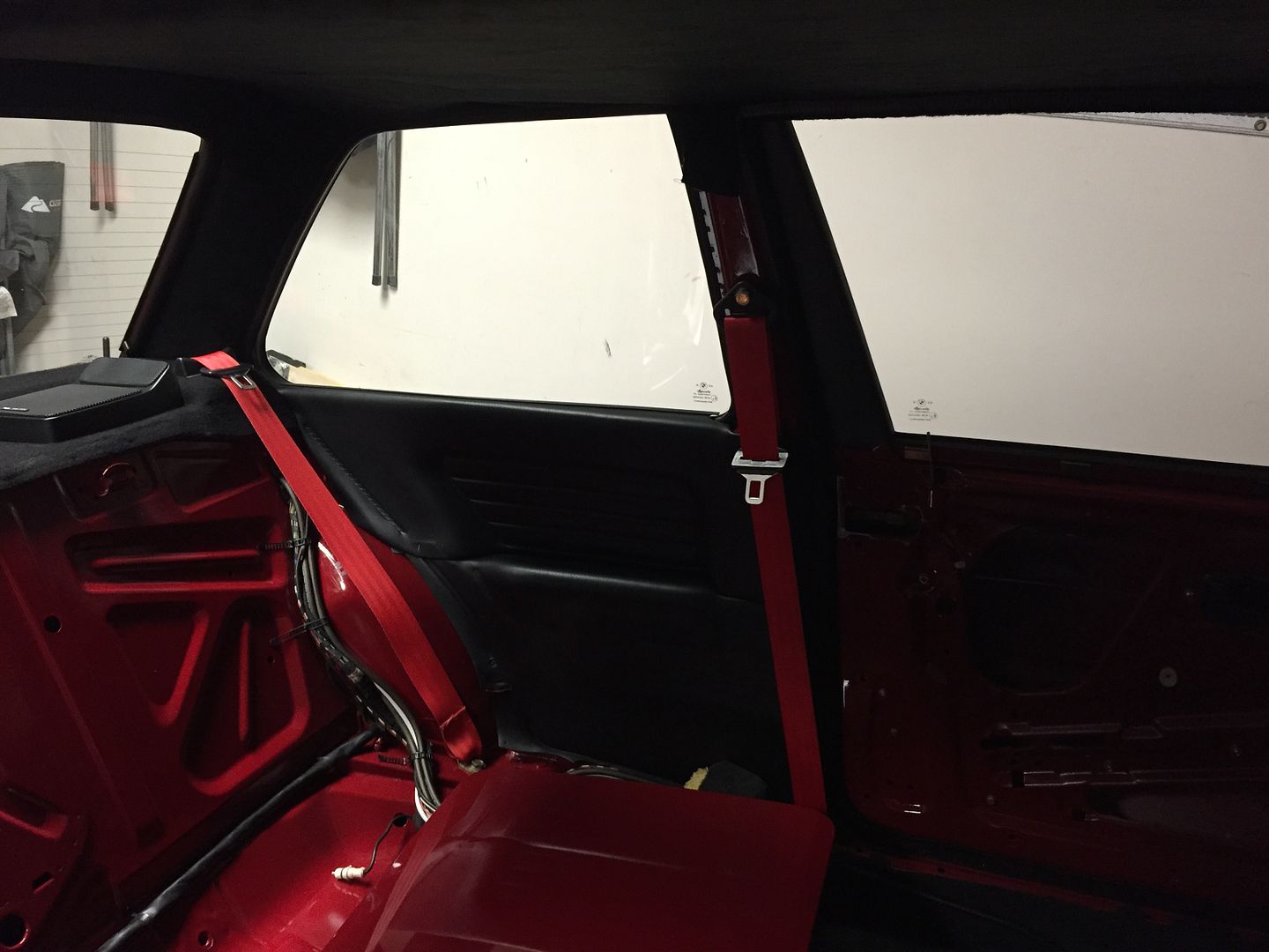

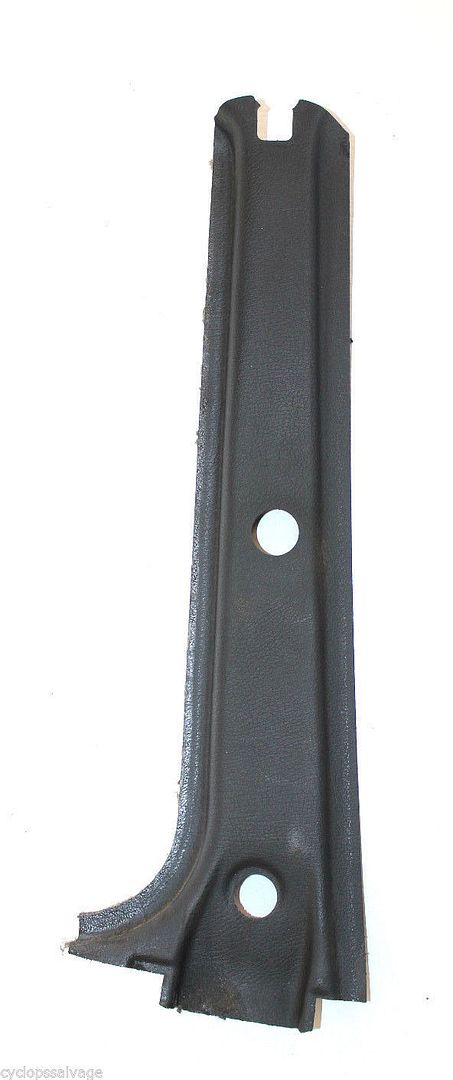

                              Feeling redeemed with the productivity I decided to install both front seat belts, which meant fitting the new bpillar trims first. These guys have an updated texture, foam backing, and they are over $100/ea new. Why they are so expensive I have no idea....but I plunked down for them because all the used ones I've seen at work are all broken at the top.
                              I tried to fit the drivers side first, which is difficult to do as it has to fit under the rear window gasket. It would have been a good idea to prefit this prior to installing the glass, but none the less I got it in.... which led to much swearing when I realized the square cutout for the coat hook up top was made in the front F*&$king spot.
                              Here is a picture of an original, notice how the cutout is centered..... now go look at the new one above.
                              Both of them are like this, and it renders them completely unusable to me. Now I need to find a good used pair.
                              As I had already bolted the seat belts into the base of the bpillar I went ahead and hung them up and snapped the rear quarter panel interior panels in place.

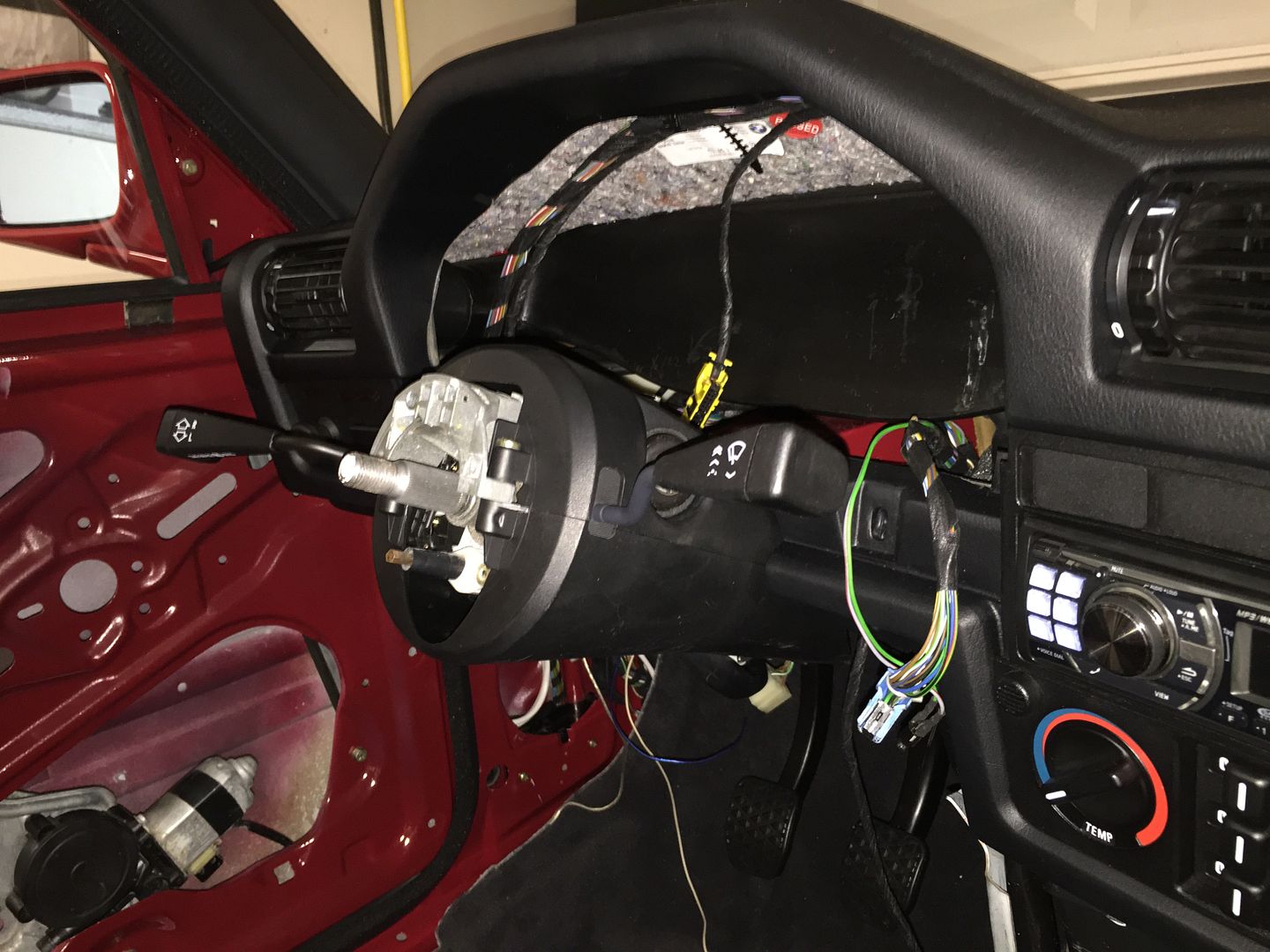

                              Done with that BS I unwrapped the brand new wiper stalk that finally came in yesterday. The fresh crisp screen printing sure looks nice. Once that guy was installed I was finally able to build the wiring block on the column and fit the upper and lower covers on.

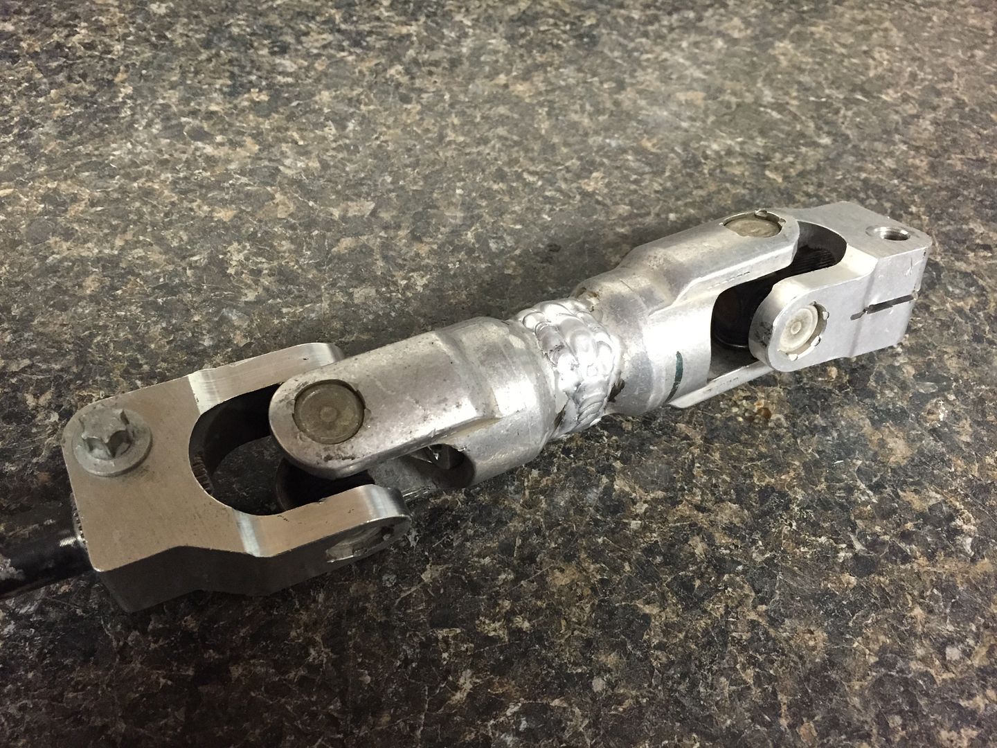

                              Oh, and here is the fabricated steering linkage, back from the welder.
