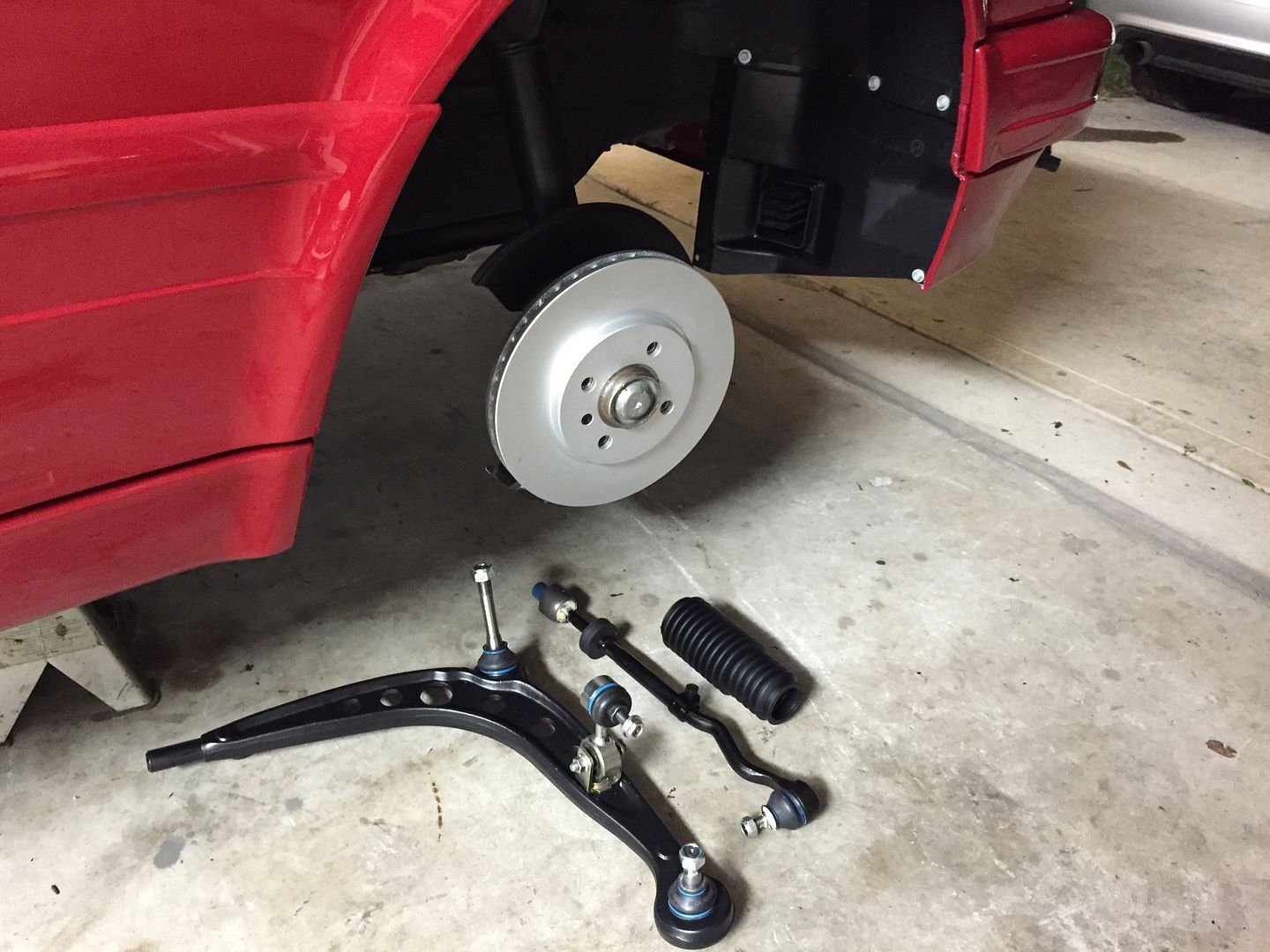

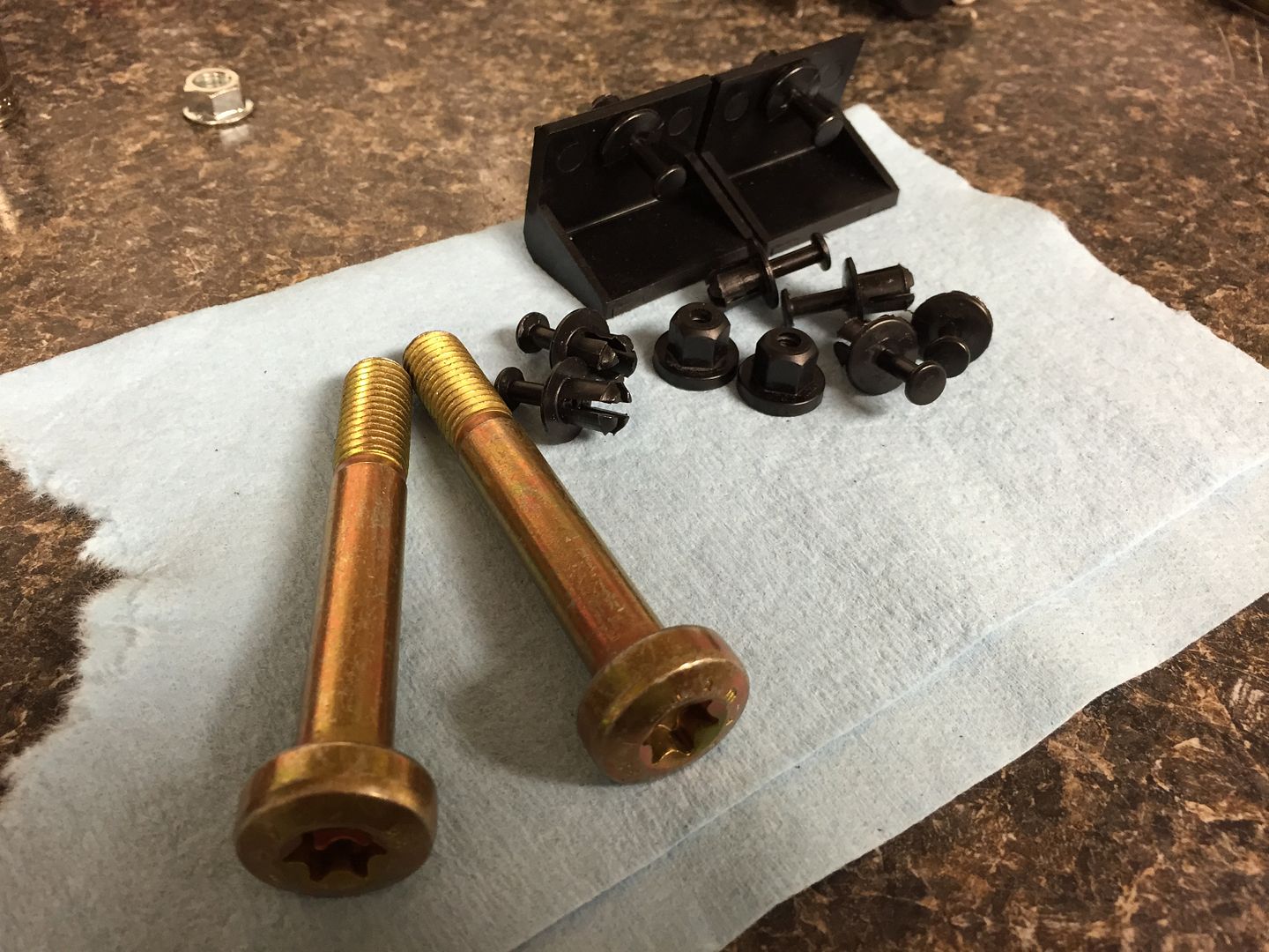

                              I was largely tied up with a customer, side work this evening but I did manage to get a little bit done. I bought new front bumper bolts to reinstall the bumper with. These seem to weather pretty poorly over time.
                              I also laid out and installed the new control arms, sway bar end links, brackets, inner/outer tierods and steering bellows boots. Much to my dismay the boots I ordered (E30 ones) do not fit over the larger diameter steering rack. I'll need to get different ones tomorrow before I can button stuff up.
