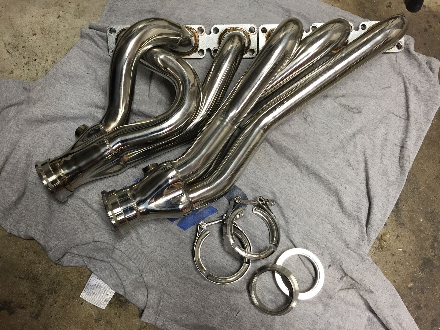

The stepped 2.25" vbands for the headers showed up:

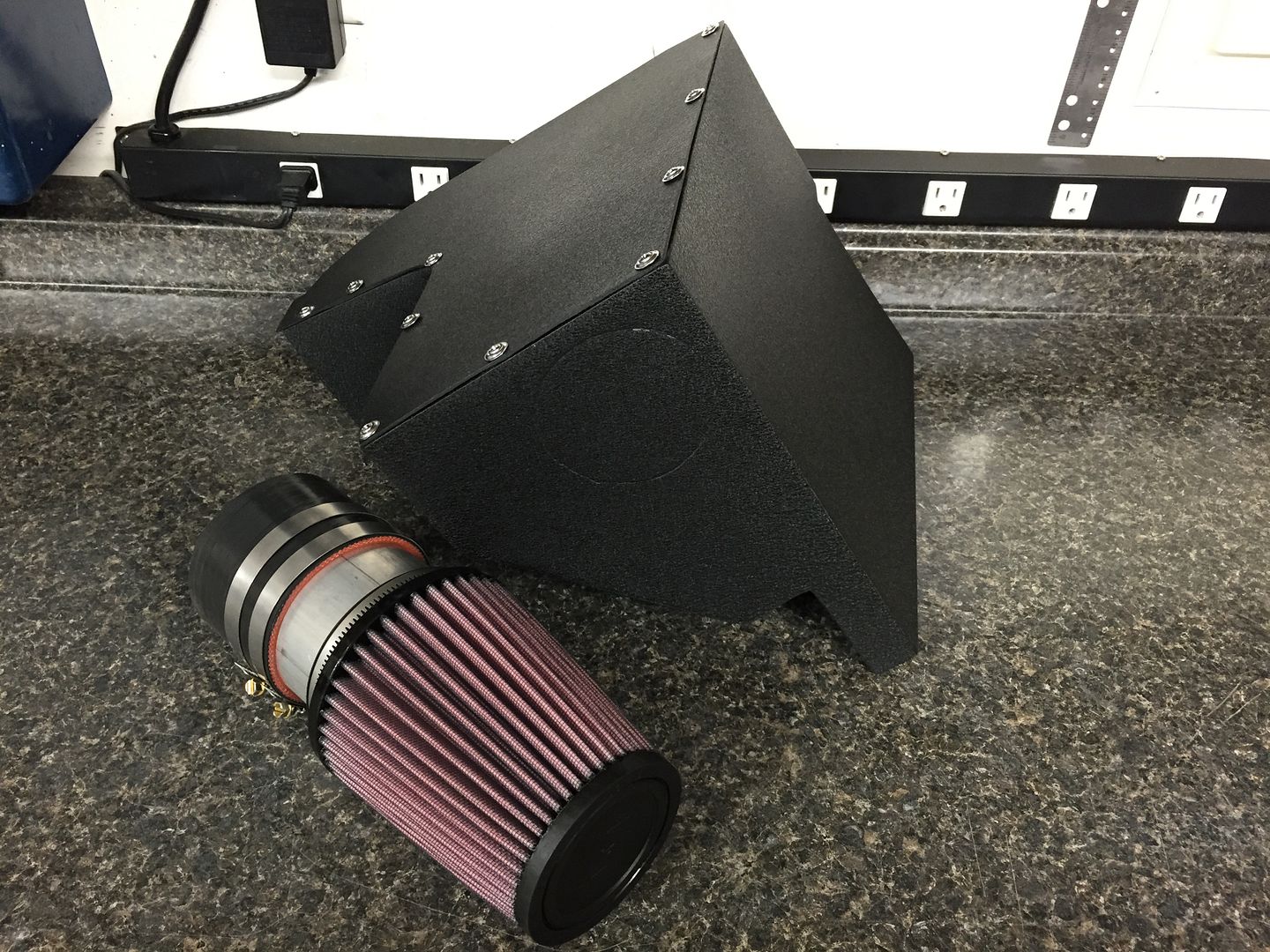

The awesome molded fit cold air cleaner box from Castro Motorsports showed up. The fit on the car is really impressive! You can tell a lot of effort and thought went into the molding of the product specifically for the chassis. I had a couple special requests like leaving the MAF uncut so I could size it for my specific application and it was delivered just as asked.

Pseudo mockup of the exhaust system to be. eBay headers chopped at the collectors, stepped vbands, catted mid section, Y resonator, and Remus muffler.
The vbands out of the headers are 2.25" and the 2 mandrel bend sections I bought for fabrication are 2.25"
The catted mid section is from a newer BMW. N54 twin turbo car. OEM Boysen catalysts are far higher quality than anything you're going to buy in the aftermarket. The pipes in and out of them are 2.25"
The Y resonator is OEM Eberspächer from a E83 LCI. It is dual 2.25" in, and single 2.75" out.
Both OE midsection donor parts are 100% stainless steel construction, and specifically selected for quality and overall fit to the car. I hope they will fit within the confines of the aluminum heat shield without handing too low. I think many of us have used the E36 mid section, OBDI or OBDII, and they both hang awfully low because they are too wide to tuck up and in.
